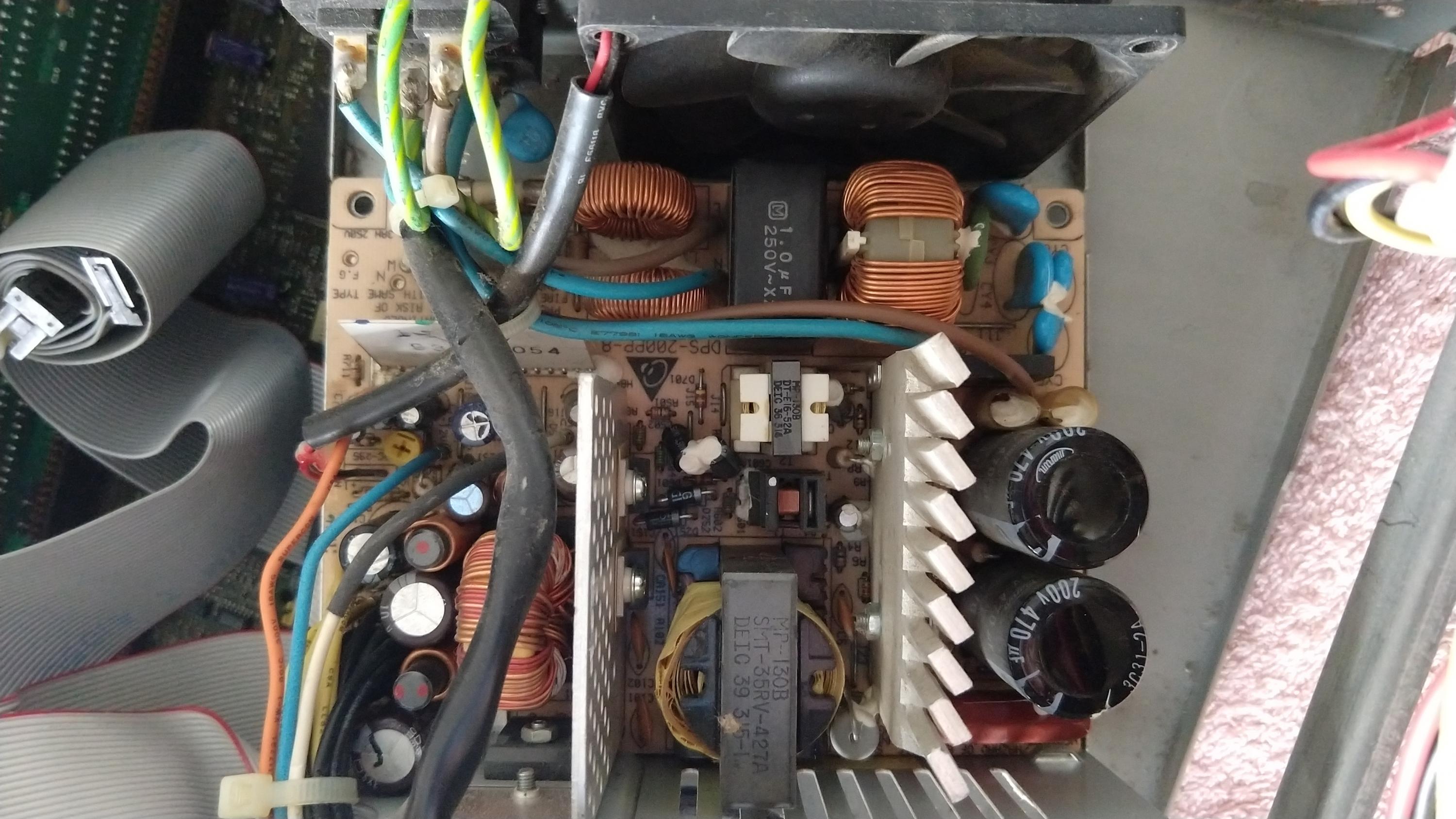

    HI!.
    I want to repair this AT PSU.
    Sometimes it works well for a few minutes. Other times it does not start well.
    When it fails, the voltages fall almost in half.
    + 12v -> +5,5v
    + 5V -> +2.8v
    When it fails, the PG goes crazy and falls to 0V.
    I was already measuring the capacitors and they seem to be all right.
    Any suggestions that may be failing?
    Greetings and thanks.

    Re: PSU AT Delta DPS-200-PB-8 half voltage.
    I would replace any small electrolytic caps in the primary (0.47-47µf around 50V), I don't know how you measured the caps but those usually cause problems and are over looked.
      sounds like a problem I ran before on a different PSU. There was a small cap near a heat sink that was bad in the feedback circuit.
        Hi.
        Thanks for answering. This weekend I am going to change the small capacitors of the primary.
        Attached image of the power source.
        Greetings.
          Check the small caps in the secondary too. The feedback starts at the secondary.
            Hello!
            Change all the electrolytic and the problem persists.
            Any other component to check? what do you think?
