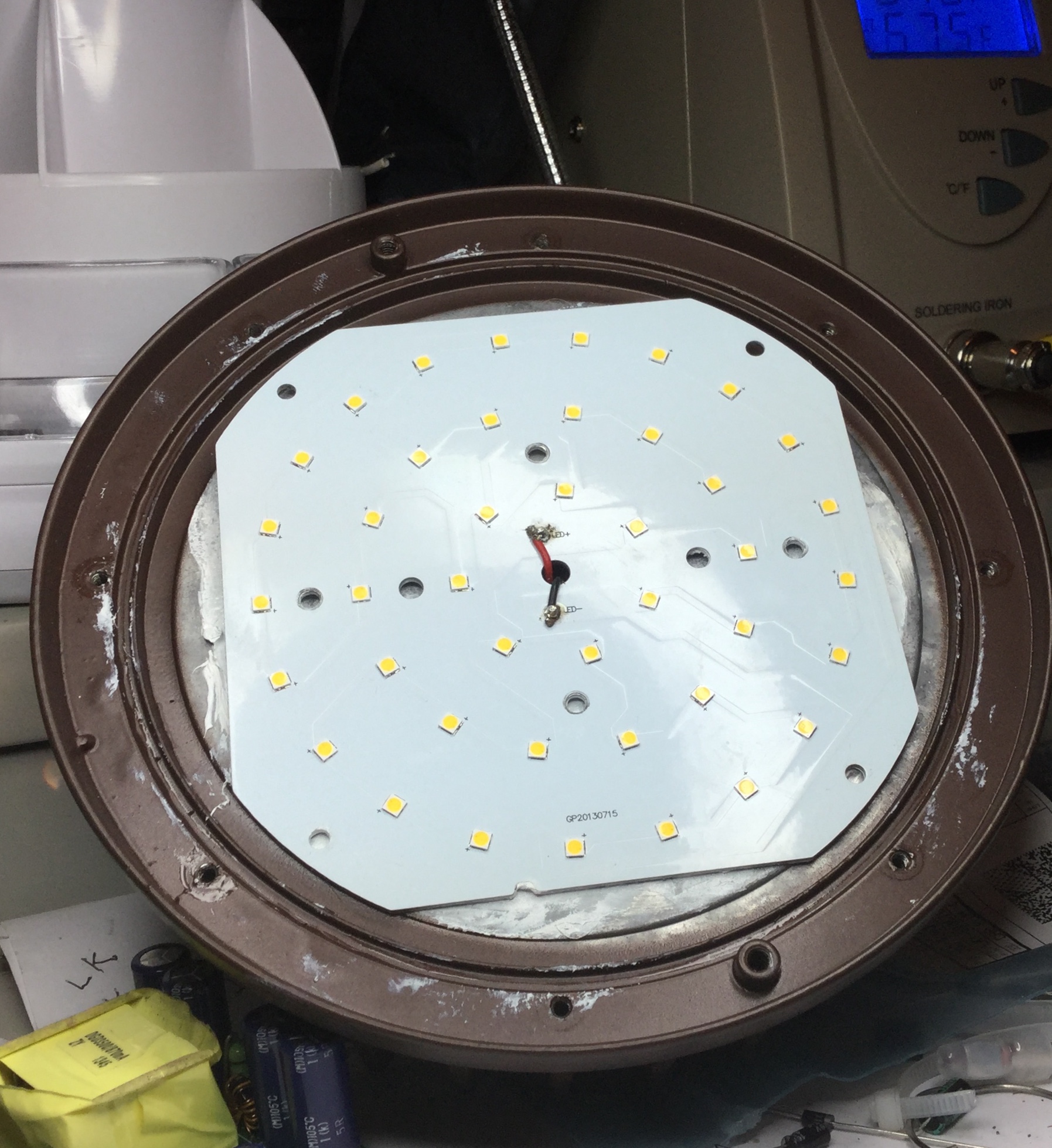

    Here is the inside of one of my LED yard lights

    red wire on the led panel needs resoldering,
    so do most of the thrue-hole parts on the psu!!
    other than that, it looks good.
    nice layout, input filtering, ncc caps.

      Re: 42 Watt LED Yard tare down recap ** How good is this switching power supply
      It looks like a reasonable build, around 1W per LED.
      I don't see how the LED board is bolted to the housing, for heat transfer.
      Some cheap chinese fixtures just use the silicone grease. The LED's burn up.

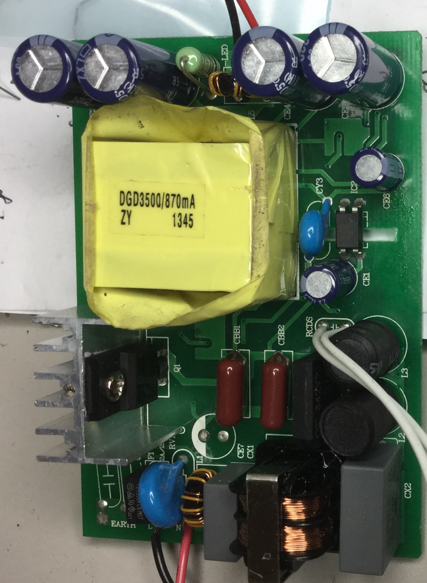

        We had a lightning storm yesterday and the other fixture does not work so I need to take that one apart to see what has happened to it
        I will post a photo of the other 42 watt LED yard light they are both the same exact model
        Here is a really shitte thing that did on this switching power supply the out caps are 220uf@50 volts there are four of them
        The output voltage 42.5 really they could have use 63 volts one or 100 volts
        I changed them to 63 volts ones
          It uses the silicone grease and lot of it
          It uses 6 screws to hold the LED Plate module to the housing
          It uses off brand name China made capacitors

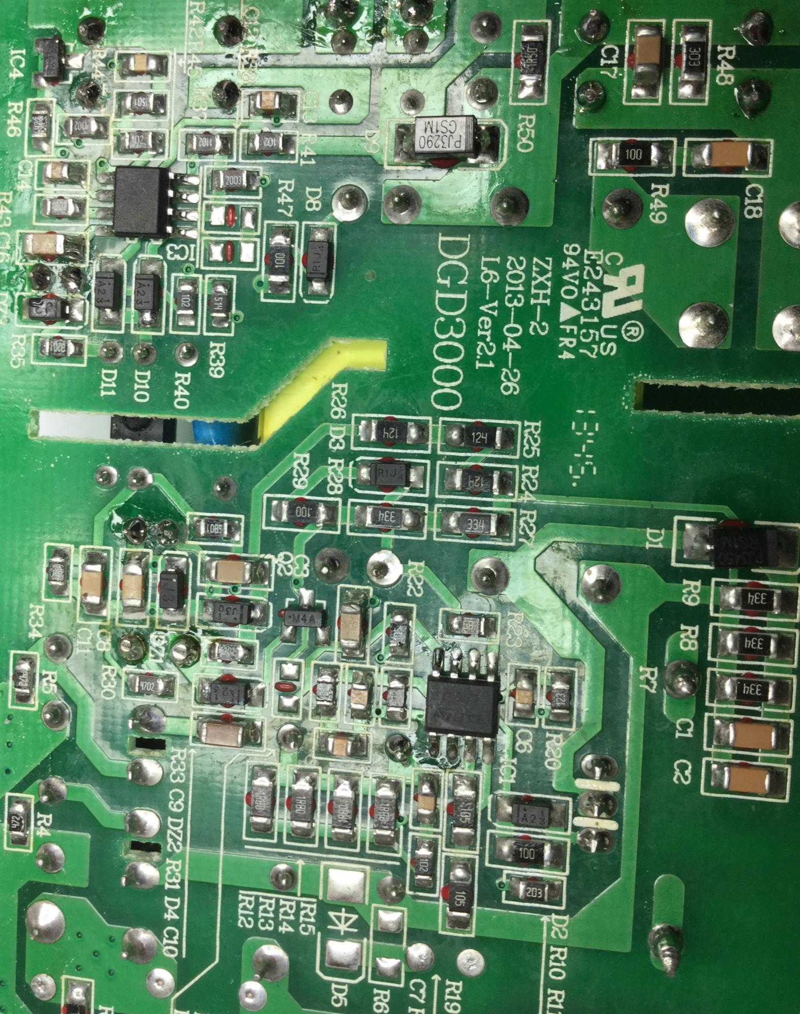

                    UpDate
                    Here is one of the chips on the backside of the board
                    https://cdn.badcaps-static.com/pdfs/...1fdeef964c.pdf
                    The other chip is a LM358. On the chip it just says ( 358 ) ST
                    The Optic Sensor is a EL017 on either side of the optic sensor there is a 47uf@50 volt caps
                    Where the rectifier are the soldering joints were very questionable also I pulled them out and checked them they had a 420 mill volts one the diode test mode
                    Look like they might be good but the area where they are mounted looks like it has gotten very warm before because it is brown looking
                    This is On the one that does not work I remove the transformer and found some very questionable soldering joints on the pins where the wires are soldered
                    I going to replace the the two 47uf@50 volt one and see what happens next
                    On the Heat Sink it has this
                    https://cdn.badcaps-static.com/pdfs/...c7a917eb6a.pdf
                      • Jul 2011
                      • 6060
                      UpDate
                      I was able to fix the yard that did not want to work
                      I remove the transformer from the board and resolder the wires on transformer it self because some of them looked very questionable reinstalled transformer
                      I frist replaced the two 47uf@50 volts and put power to it and the LED module turn ON
                      Then I installed the four 220uf@63 volt caps and put the unit back together
                      I did redo the soldering joints that looked very questionable
                      I am very happy that I was able to fix this unit
                      Running time now 20 minuets
