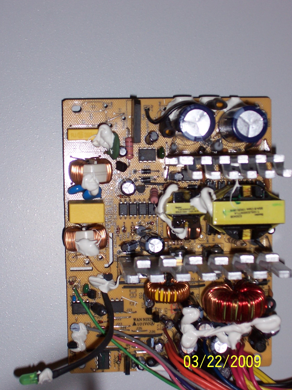

    I have seen much posted on this website that Bestec is nothing but poorly designed mobo killer. Most of the problem has been attributed to 5VSB poorly designed. I have repaired two Bestec model ATX-250 12E psu that did indeed have poor 5VSB flaw. The pc board was discolored from overheating and components failed which allowed the voltage to go well above the 5 volt level.
    On the other hand I have repaired two Bestec model ATX-250 12Z which have a 8 pin pwm chip (A6351A) for the heart of the 5VSB circuit. The 5VSB did NOT fail in either of these two PSU, and the pc board was not discolored from overheating on these two PSU. Perhaps the engineers have admitted the need to redesign - and the later model does indeed seem to have a much improved 5VSB.
    Bad capacitors can still be a problem, but that is a problem on lots of PSU. Perhaps it is time to elevate the later better designed Bestecs to a higher level of quality, especially above PowMax (aka maximum bang). I'll post some photos of one of these later models, along with a drawing of this new chip design 5VSB.

        But ...... Did the two ATX-250 Rev Z units that failed for you have the pwm chip in the 5VSB circuit (I don't trust labeling) AND if so did the 5VSB circuit fail? My concern is the 5VSB failing causing burn damage to the PSU and causing damage (or killing) the mobo.
        Of the two that failed for me, one had a resistor value change that simply shut the power supply down. The other had a shorted switcher which took out the fuse.
        I don't doubt that this is an economy (bargain basement) class of PSU. But I do think this later model is much safer, less of a fire hazzard, and less likely a mobo killer. It also has more capacitor filtering on the outputs than the infamous POWMAX.

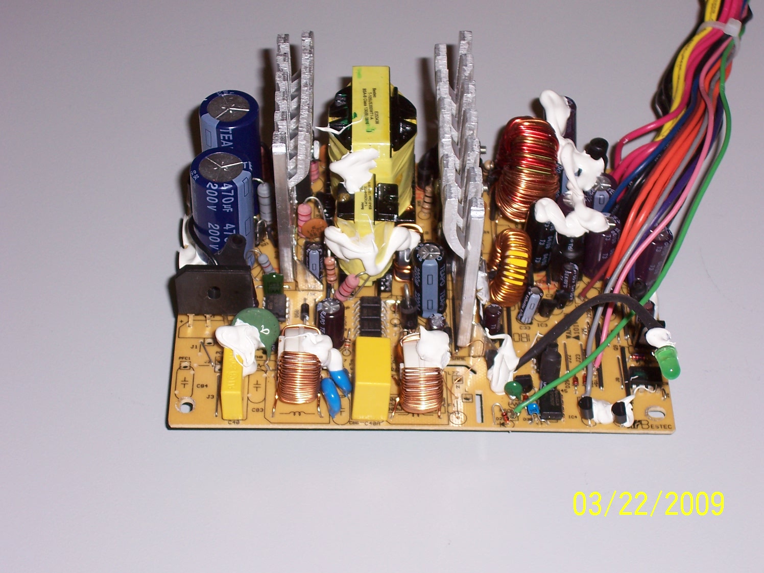

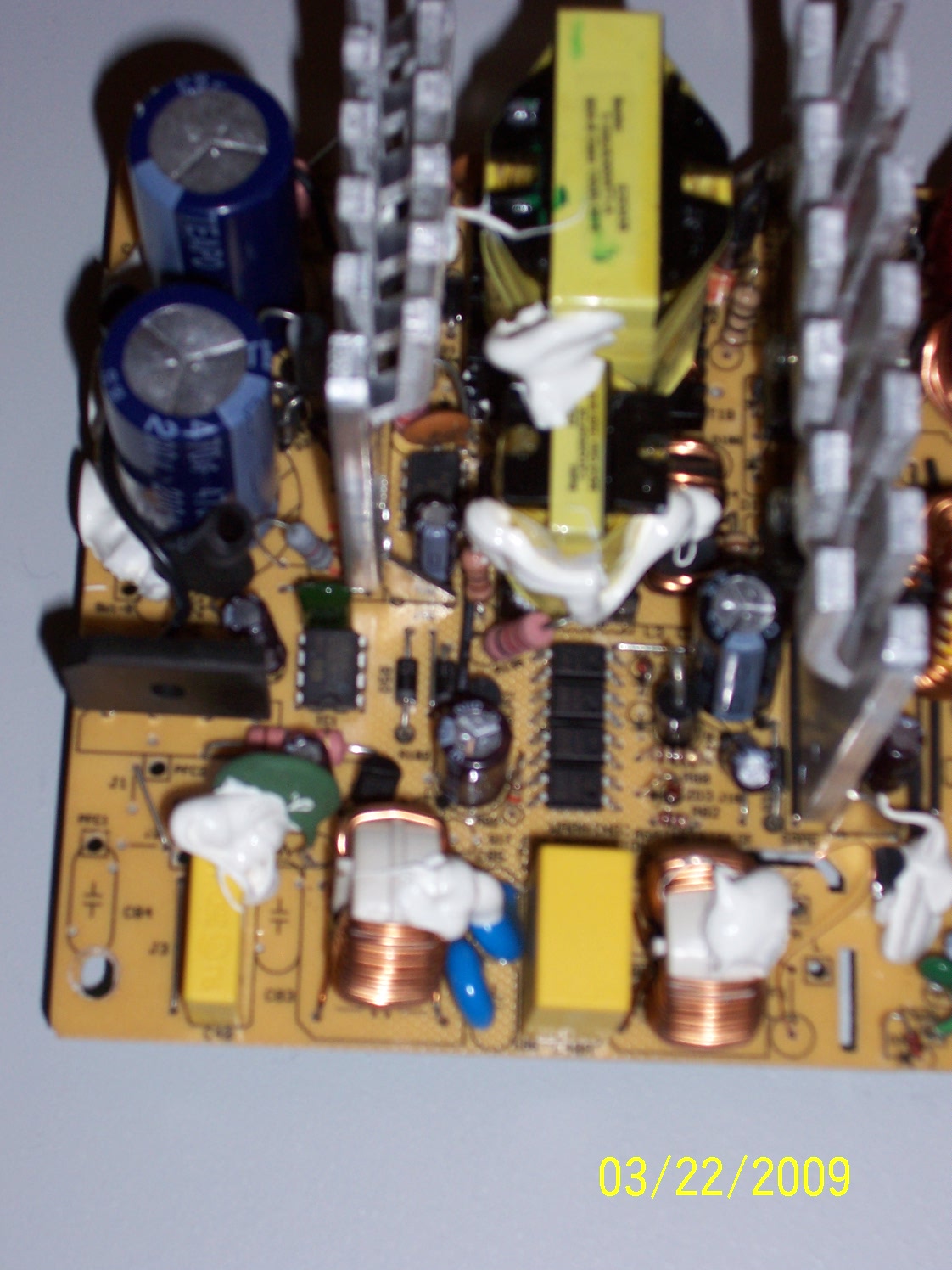

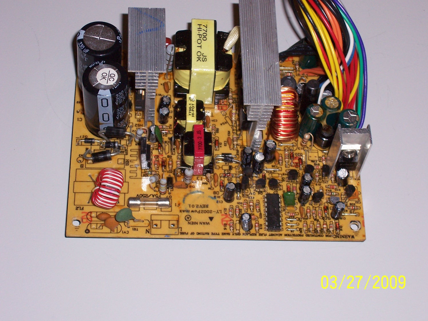

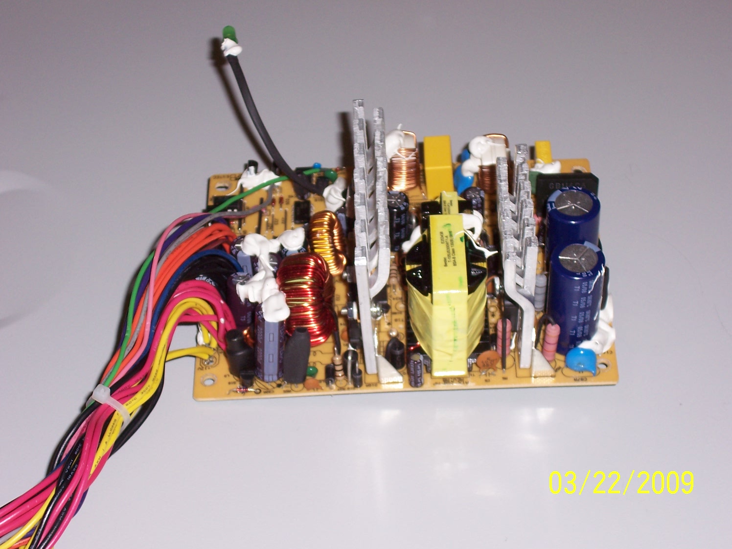

                                Just for fun, lets compare this Bestec ATX-250 12Z with a REAL mobo killer - a 350 watt PowMax that I ran for 6 years with no trouble, but didn't realize what I had.
                                Looking at the photo of the Bestec, you can see that it has two nice size toroid coils and several filter caps on the AC line input. The bridge rectifier is one piece, and a respectable size. Two filter caps 470 uF @ 200V. It uses a pwm chip UC3842, and TPS3510 supervisory chip. It has four feedback optocouplers, one of which is to protect the 5VSB circuit which uses the A6351A pwm chip. It has two toroid filter coils on the output.
                                Now look closely at the photo of the PowMax which fortunately didn't crap out. On the line input one much smaller torroid line filter. Look at the bridge diodes - four seperate diodes - of three distinctly separate physical sizes. The two filter caps are 330 uF @ 200 V. The pwm switch is the old AP494, no supervisory chip, the 5VSB circuit is just a couple of transistors, and NO feedback optocouplers. The main switching transformer is about half the size of the one in the Bestec. It has only one toroid filter coil on the output. The only redeeming thing I found is a 7805 regulator chip for protection of the 5VSB.
                                Thanks to finding this website and looking over the many posts and experience you guys (and gals?) have, I immediately pulled the PowMax out of service. Haven't decided yet on its replacement, but no more PowMax!
                                I don't mean to say the Bestec is highest quality - but for the "cheaper" PSU, it does look to me like it is far superior to the PowMax.
