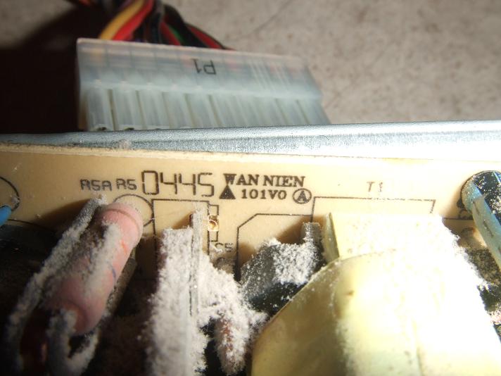

    Originally posted by jpdoe
    I remember reading somewhere that Wan Nien is a PCB manufacturer.
    I believe you're right.
    I've also seen Wan Nien in almost every L&C PSU.

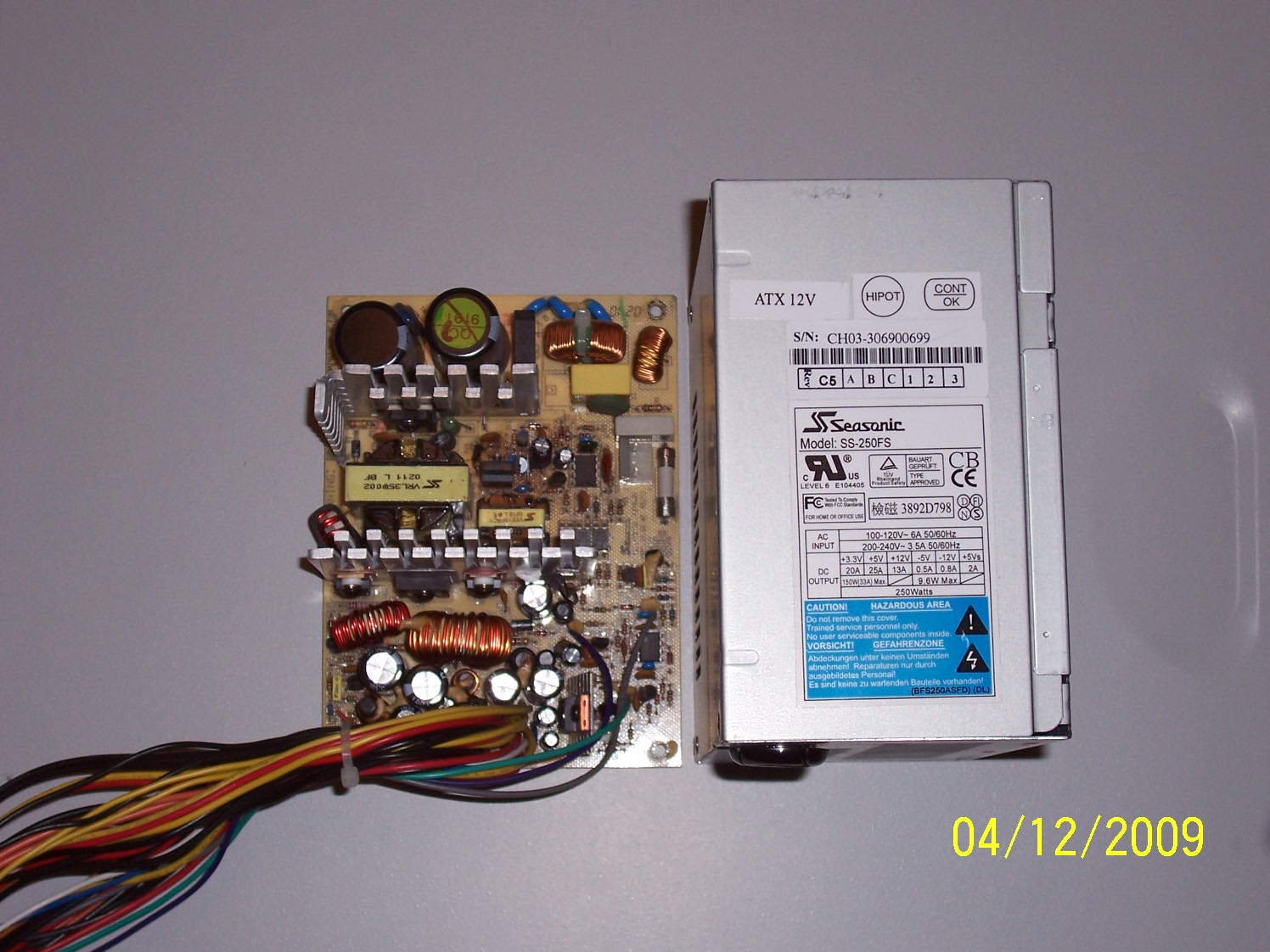

    everell - I think the Bestec and PowMax use 2 different 3.3v designs, thus explaning the lack of the second toroid coil on 3.3v for the PowMax. From what I can tell by the pictures, the Bestec seems to use a saturation coil before the 3.3v rectifier and another coil after the rectifier for smoothing the output on 3.3v. As for the PowMax, 1 of the components on the secondary heatsink could be a 3.3v regulator, most likely using 5v as a source. Check and see.
    And the different sized diodes - that's a Leadman/PowMax/Raidmax trademark . Normaly, they only use 2 sizes, with the smaller connected to neutral. On yours, however, seems they just used whatever they could find.

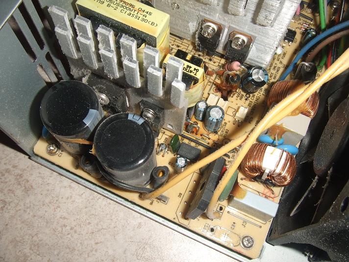

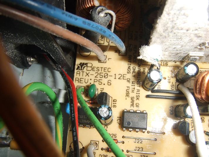

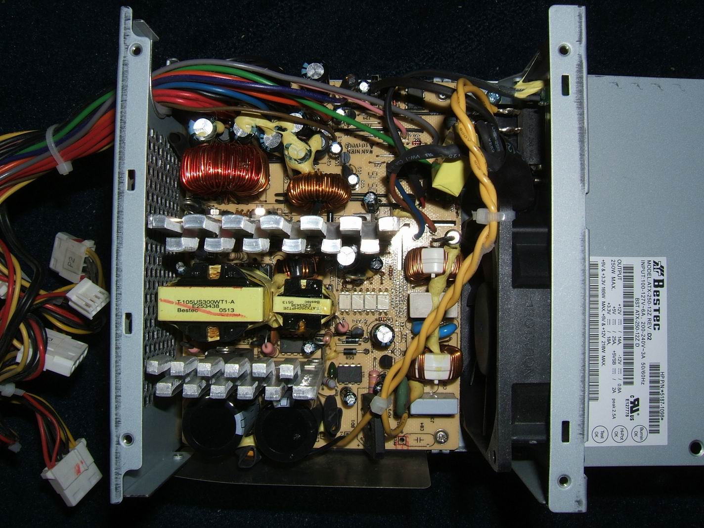

        The eMachines issued ATX-250-12E Rev. P7 is what gets all the bad press for destroying motherboards. Unless someone takes the time to separate the good from the bad then we just throw them all out or give them away to people who deserve early death computers.

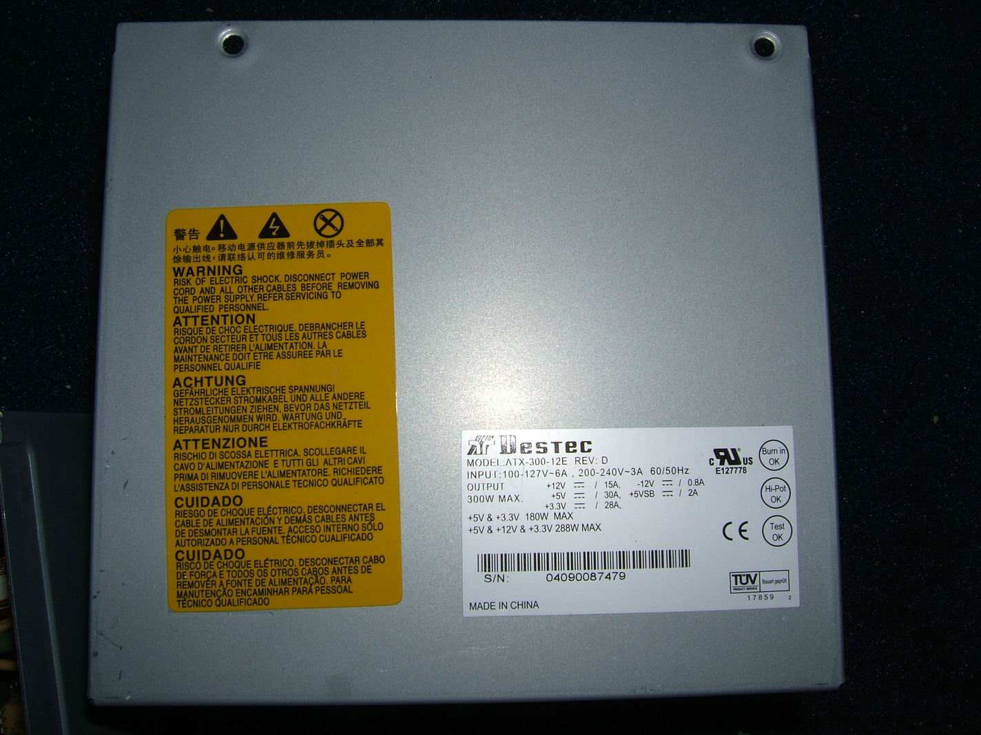

        Here is a Bestec ATX-300-12E Rev D from an eMachines. It was replaced because the AC power jack was damaged. The chips are TPS3510P, LM358N, UC3842B, and A6351A. Caps are all Jamicon and Ltec. The thermistor will under report the temperature since it is not actually touching the heat sink.
        sig files are for morons
          Re: Bestec revisited
          that looks ok.
          not crap instead of proper 5vstby circuit...
          btw. can you photograph
          ATX-250-12E Rev. P7

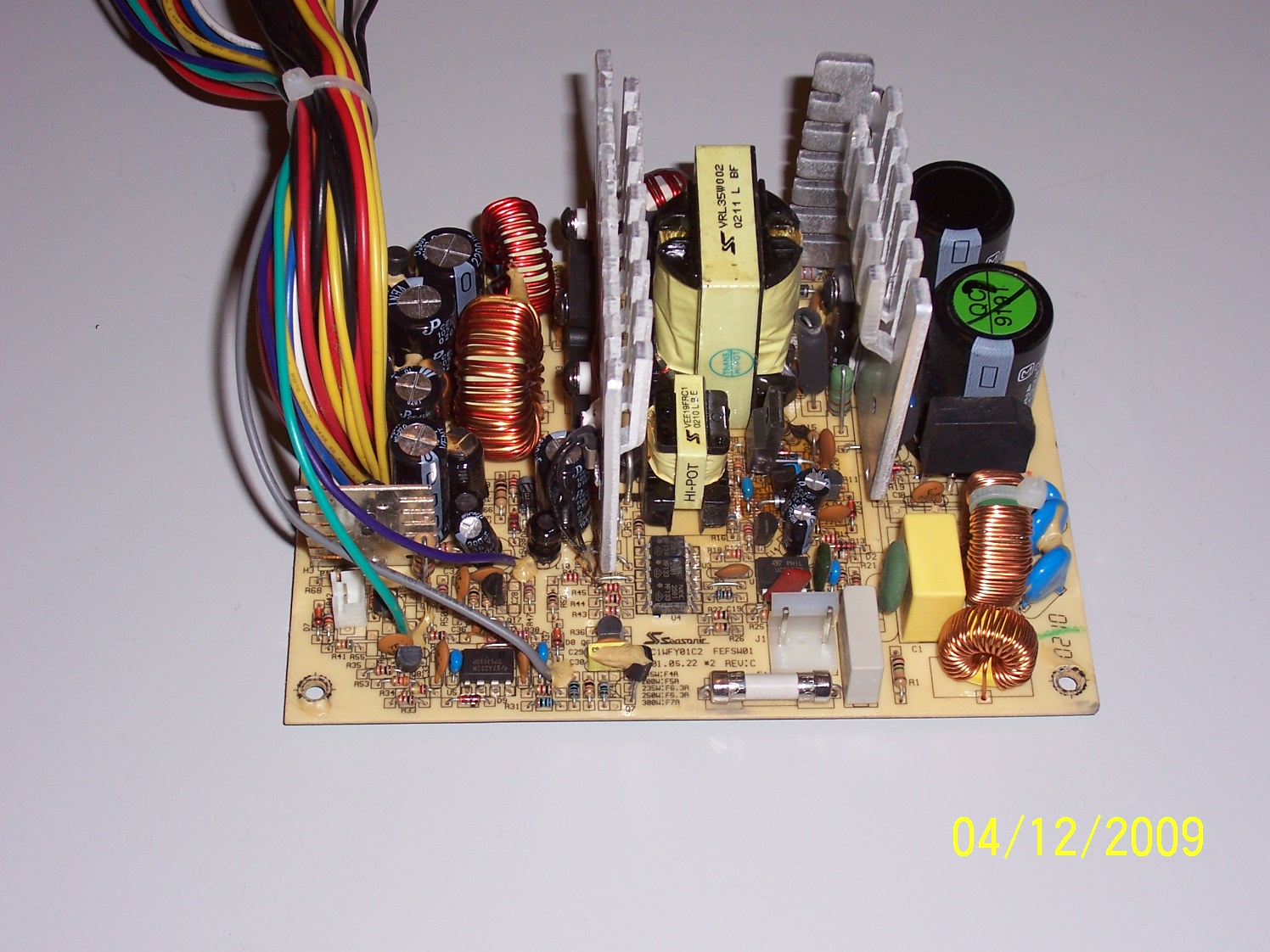

            severach >>The thermistor will under report the temperature since it is not actually touching the heat sink.<<
            Yes. I've seen that "flying goop thermistor" on several brands, not just the Bestec's. My most recent exposure with the 12Z is like Everell's pic. A nice metal cap over the thermistor screwed to the heatsink. Wow! Design improvement!

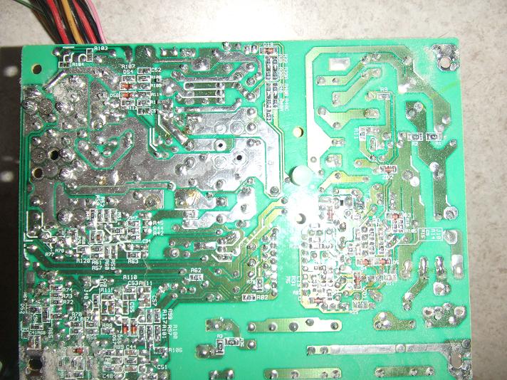

            I also liked their soldering job on the underside of the board. Nicer than what I'm used to. Very clean and sharp.

              Wan Nein is indeed a PCB house...I've seen their name on a lot of stuff besides PSUs. I seem to recall seeing them on an amplifier board for some computer speakers.
              I'm glad to see Bestec has revised their killer 5VSB circuit. The new one also seems to be using all Teapos....not great but a definite improvement.
              I can confirm without any doubt at all that that Bestec is better than that Powmax.
              While the early Bestec might be a mobo hazard, the other would set your house on fire if given the chance. I've seen loose wires, improper safety caps and even bypassed fuses in Powmax before.
              One model has a jumper where the fuse holder was supposed to be. Its rare in the US for obvious reasons.
              But with that said, if either improved, I still wouldn't buy.... I don't trust them. The revised Bestec might make a good bench test supply, but I still wouldn't trust that for day to day use...its a Bestec! As for Powmax.... those make great target practice.

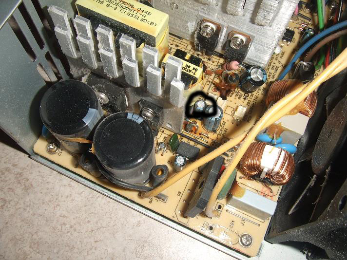

                              here is the "killer cap" circled. i use a 22@50 fc.
