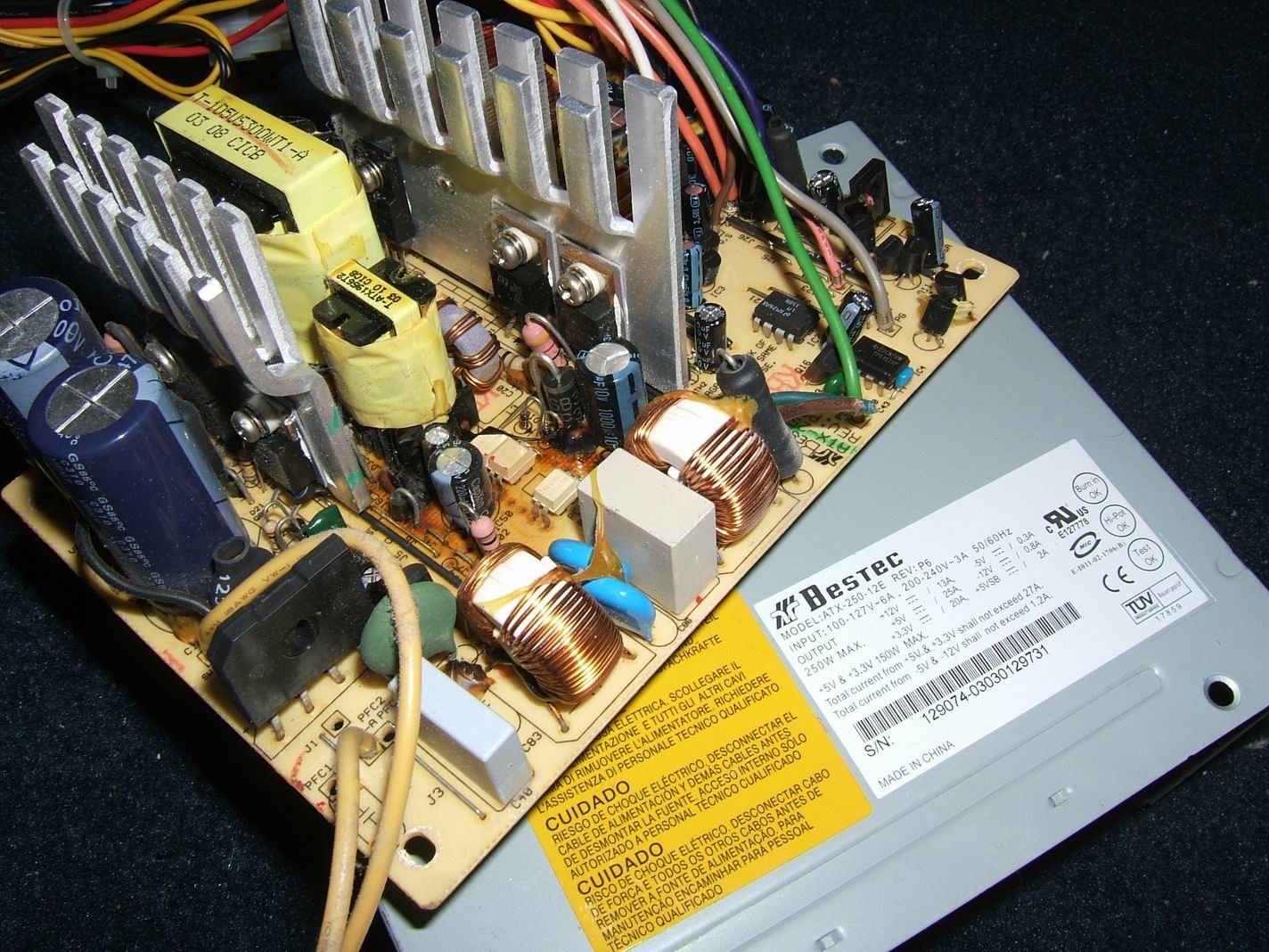

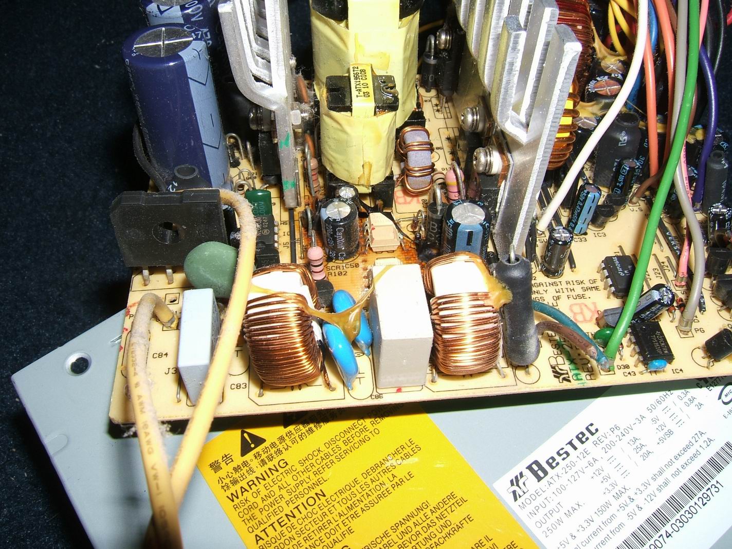

        Here's a Bestec ATX-250-12E Rev P6 that destroyed an eMachines motherboard. The lone Fuhjyyu output cap among the Jamicon says that this is one of my quick recaps. Had I discarded the Bestec the board might still be alive.

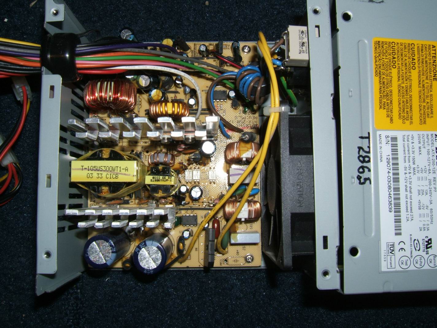

          Here are the pictures. I found an ATX-250-12E Rev P7 which appears to be identical to the ATX-250-12E Rev P6. The board revisions are both P5.6. The P7 unit had not failed and shows no heat or cap damage. I can't find any obvious components with revised values near the heat damaged area.

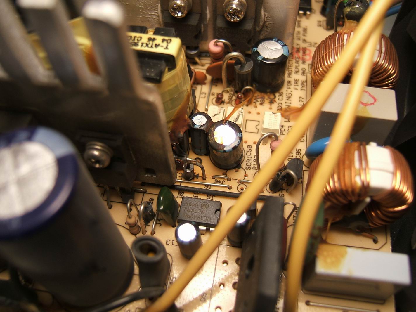

                        The 5vsb circuit DOES have some voltage feedback control. Kc8adu posted a photo showing the capacitor which causes the problem. See the attached drawing of the Bestec ATX250 12E two transistor 5vsb circuit. The capacitor in his photo is labeled C1 on the pc board and in my drawing. Notice that this is the capacitor which provides filtering for the optocoupler PC2 which controls the voltage regulation of the 5vsb circuit. If this capacitor goes bad, you don't have voltage regulation!
                        The SeaSonic has a two transistor 5vsb circuit almost identical to the Bestec. It is labeled C24 and has a value of 47uF/50 volts. My blue esr meter indicated that this capacitor is open. I replaced it and the 5vsb is now holding steady on 5 volts and the power voltages (3.3, 5, and 12) come up properly. So this is a CRITICAL capacitor.
                        Now for the question - why does it fail so often? All boards that I have worked on with this problem showed burn discoloration on the pc board, and some components possibly burnt. Is heat causing the capacitor to fail, or is the component failure causing the heat? Also, is it possible that voltage spikes are causing damage to the capacitor over time? I could be wrong, but I think it a possibility that when the power is first applied to the 5vsb circuit, the first inductive kick from the power transistor feeds back a spike in the feedback coil. I would think it would take a cycle or two for the voltage regulation to kick in. If so, this capacitor is taking the spike.

                          I've seen the burns too, but what component is causing that? My experience is typically near the 1 or 2 watt power resistor. Others?
                          >>why does it fail so often?<<
                          Scope pin 4 on the Iso with/without cap & with/without load and see what the p-p is. Perhaps a clue? Maybe cap underrated voltage?

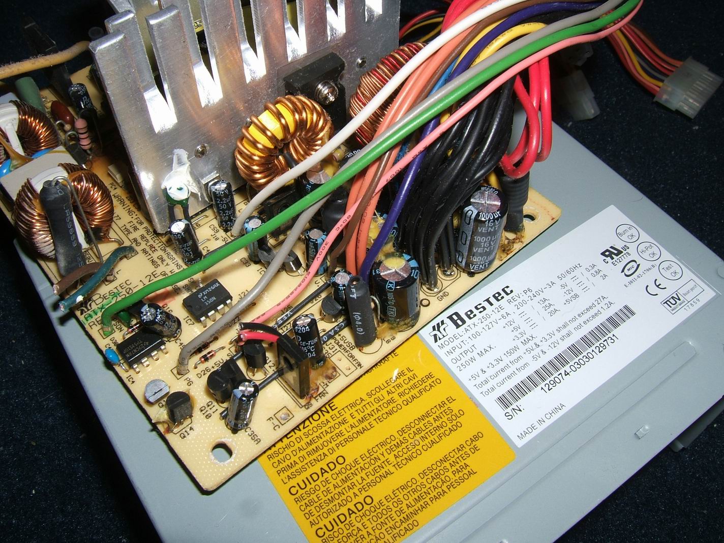

                            I have drawn some of the schematic for three different PSU transistor type 5vsb - all of which follow the same basic circuit. They are:
                            Bestec ATX-250 12E
                            SeaSonic SS-250 FS
                            Powerman IW-P250-A2-0
                            The Bestec ran me in circles until I replaced the transistors with a PWM chip (see my thread Bestec ATX-250 12E up and running) The SeaSonic had an open cap which I replaced. The Powerman blew up after I attempted a fix. The feedback winding was open. I don't know why that feedback winding opened - or if it is even related to this problem. Then again ...... it might be.

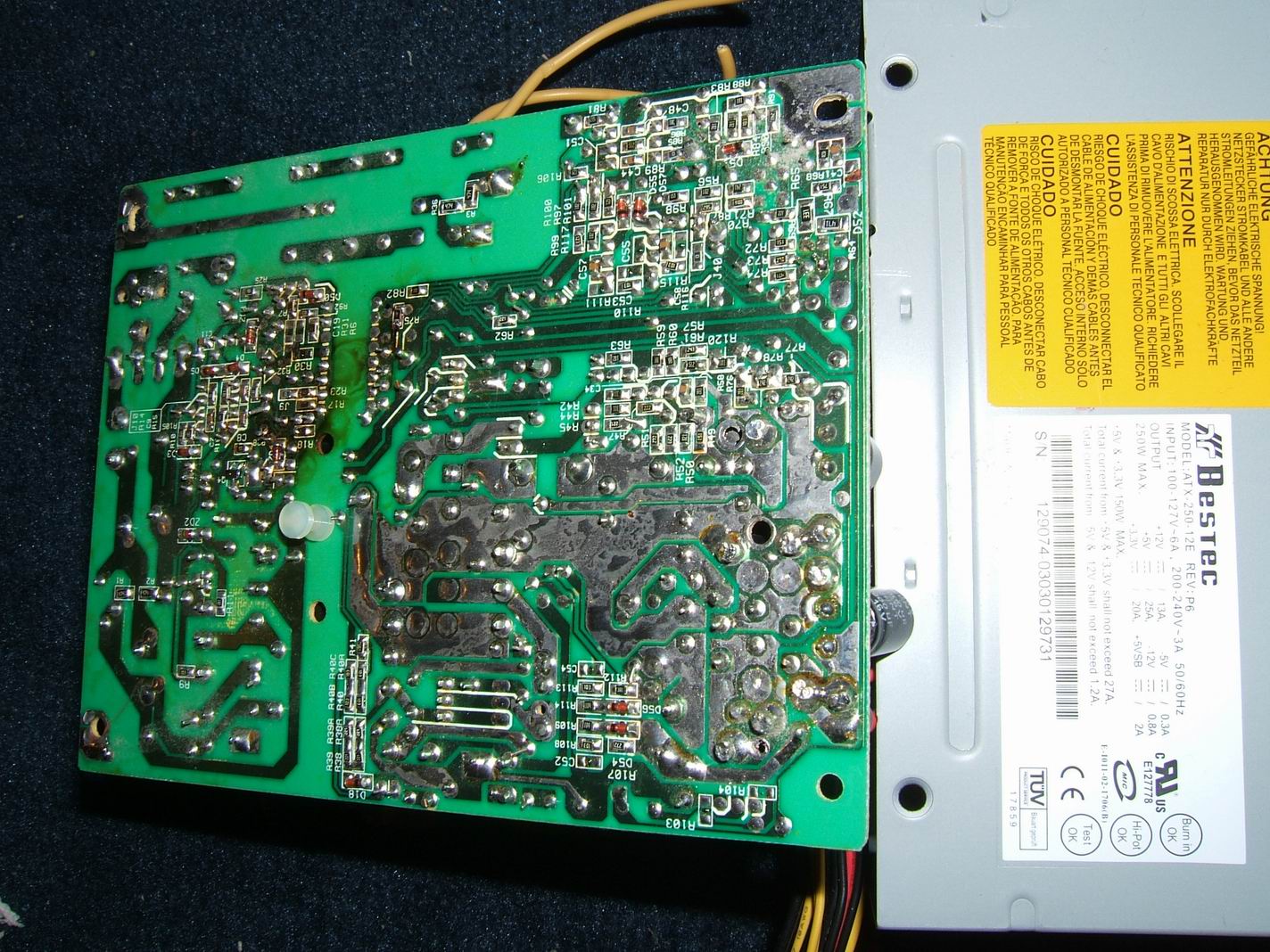

                            All three PSU had burn discolored pc board in the 5vsb area. Only the Bestec has the big power resistor. The worst burned area looked to me like it was around the diode.

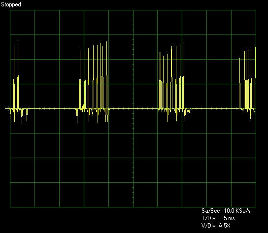

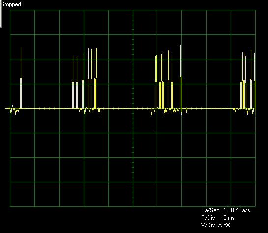

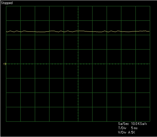

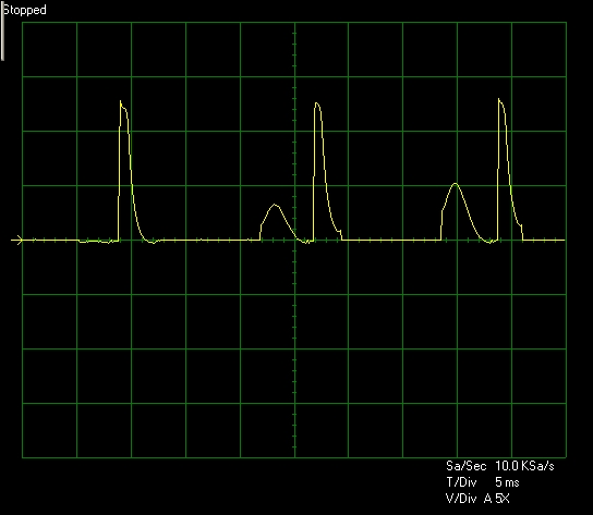

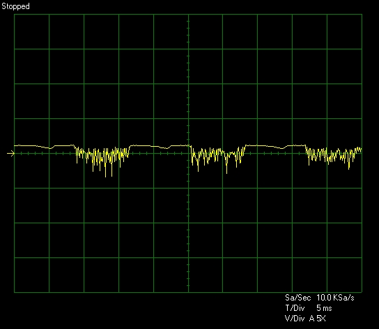

                              Scope photos of Bestec ATX-250 12E at isolator pin 4 showing:
                              Normal operation with good capacitor - about 11 volts DC
                              Capacitor removed to simulate open capacitor - about 1 volt peak oscillations
                              Resistor 100 ohms to simulate leaky open capacitor - about 14 volts peak oscillations
                              Old proverb say.........If you shoot at nothing, you will hit nothing (George Henry 10-14-11)

                                    That's good, can you repeat this with scope on the standby 5V output and voltage to make it more sensible to us?
                                    Toasty, yes it is OUCH. Typically the optisolator is usually quiet and little ripple.
                                    Cheers, Wizard

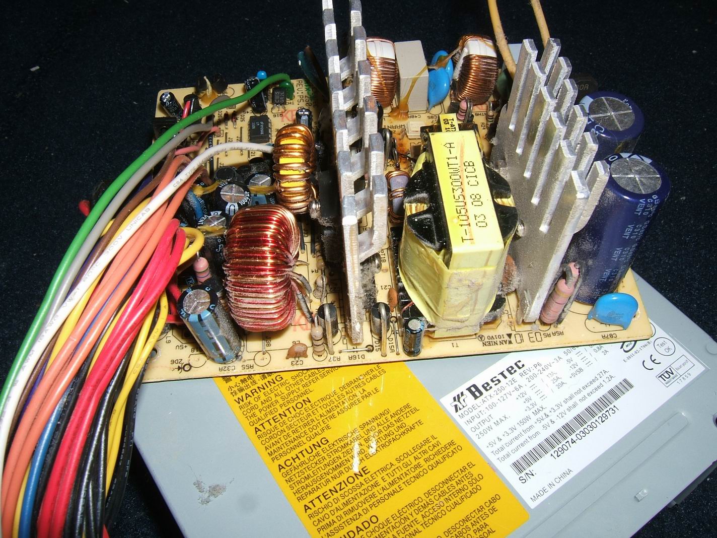

                                      Here's another not yet failed ATX-250-12E Rev P7 I proactively replaced today. The shading around the standing up diode D7 is not bad lighting or glue. I think its where the heat damage is starting. Notice how the leads on D7 are mottled and gray and the glue is baked. The brown lead section nearest the diode still has some glue. The light gray part is where I chipped away the glue with my fingernail. The gray remainder going down to the board never had glue. The Jumper J45 is even a bit dark. The leads on D6 to the right and D33 behind are still shiny. No heat damage on the leads of D7 on the back.
                                      This Bestec Rev P7 C1 10uf 50v measures 16 ohms.
                                      In another not failed Rev P7 C1 measures 3.5 ohms.
                                      In another not failed Rev P7 C1 measures 15 ohms.
                                      Random brands of 10uf caps in my cap box average 2.2 ohms. Looks like I caught today's serial killer supply just in time. I'm replacing them with the "new and improved" Bestec.

                                        Hmm... I thought the "ouch noob" was a reference to a mistake that Scenic thought Everell made when testing. I couldn't figure out what was wrong with the readings as they looked to be what I expected from the cap failing. Although, I really hoped to see some really high peaks to help explain the failure.
                                        Understand what it is supposed to be, but the test here was to see what peaks were showing up there to discover if the cap was under-volt-rated, and if that was what causing the failures. Since it doesn't seem to exceed the caps voltage rating, are we left with just a crappy cap or heat or poor placement issue or a combo of the three?
                                        At least a quick scoping of the opto now will tell if the cap is bad.
                                        @Severach - I wonder if that diode is overloaded, or failing because it isn't fast enough (wrong spec) for the circuit?
                                        Going by the schematic from Everell, that diode sits between ground and the transformer winding that feeds (thru center tap) the cap that fails with the other end going to D33.

                                          Scope pictures of Bestec ATX-250 12E in a more orderly fashion
                                          Good Cap C1
                                          No cap C1 to simulate open
                                          100 ohm resistor to simulate open capacitor with some leakage
                                          47 ohm resistor to simulate open capacitor with leakage
                                          6 ohm resistor to simulate open capacitor with lots of leakage
