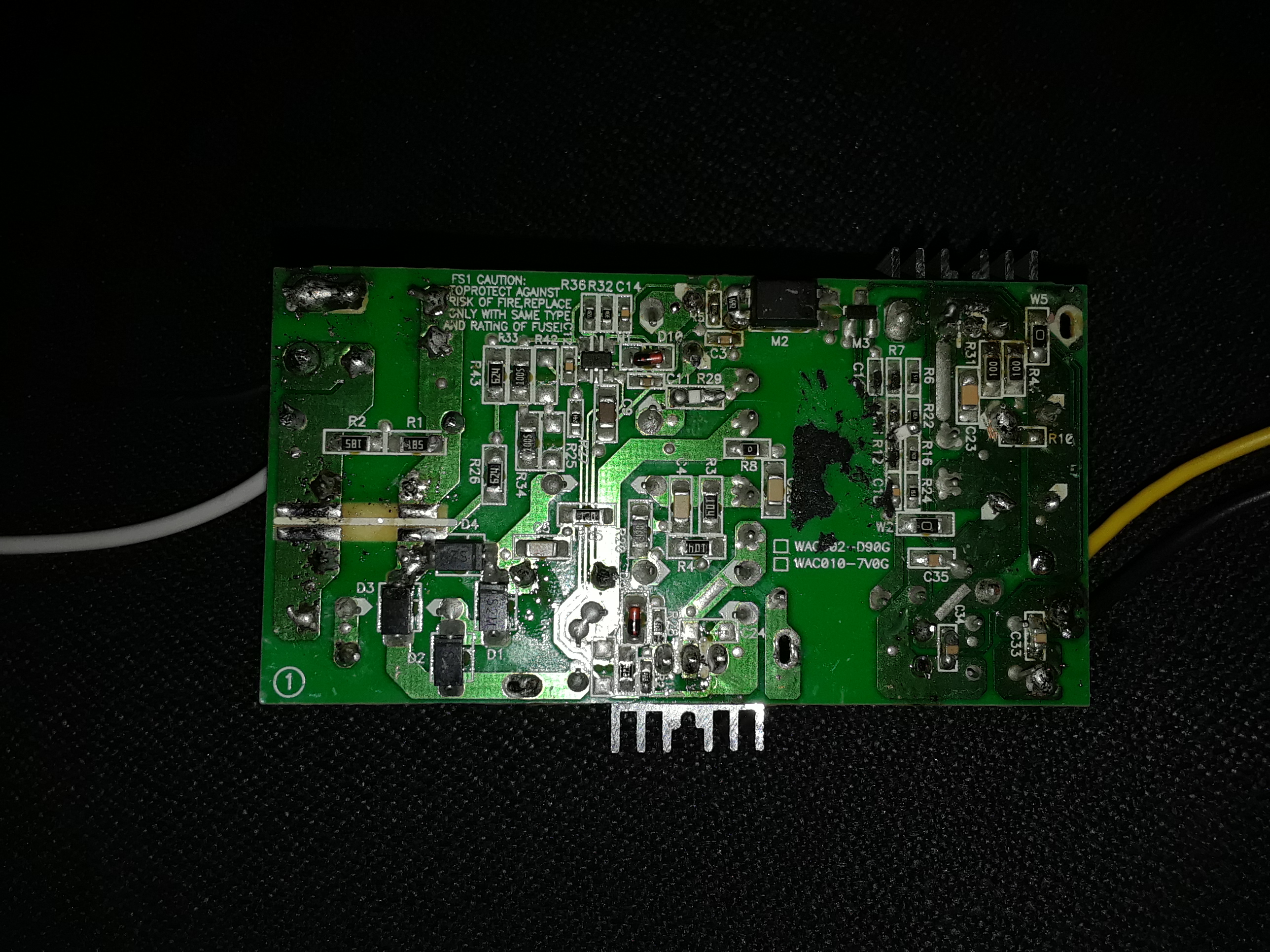

    Helloooo, i'm trying to repair this cheap 12v "5A" power supply i was given a while ago and even though i said i was not going to repair it due to how cheap and crummy it was, i was board and so i decided to pull the power supply out of my scrap pile (or what was left of it since i started taking it apart) and put new parts into it. And even after fixing most of it up it still has the same problem as it did before fixing it. The problem appears to be the circuit is pulsing on every second or two almost like it's in short circuit protection mode except there's no reason for it to be at all. The output voltage does rise up to 12v under no load so it does not appear to be shorted.
    If anyone knows what's the cause of this problem then i would like to know, thanks.
    (PS: The main reason i repairing this power supply is so i know how to fix similar issues in future repairs)
    I'm not a expert, I'm just doing my best.

    Could we see straight shot, high res pics from top and bottom of the board?
    Does the PSU work for like 30 seconds to a few minutes and then shut down? Or is it going in its knees after you put lets say a 1A load on it? Maybe the protection circuit is kicking in.

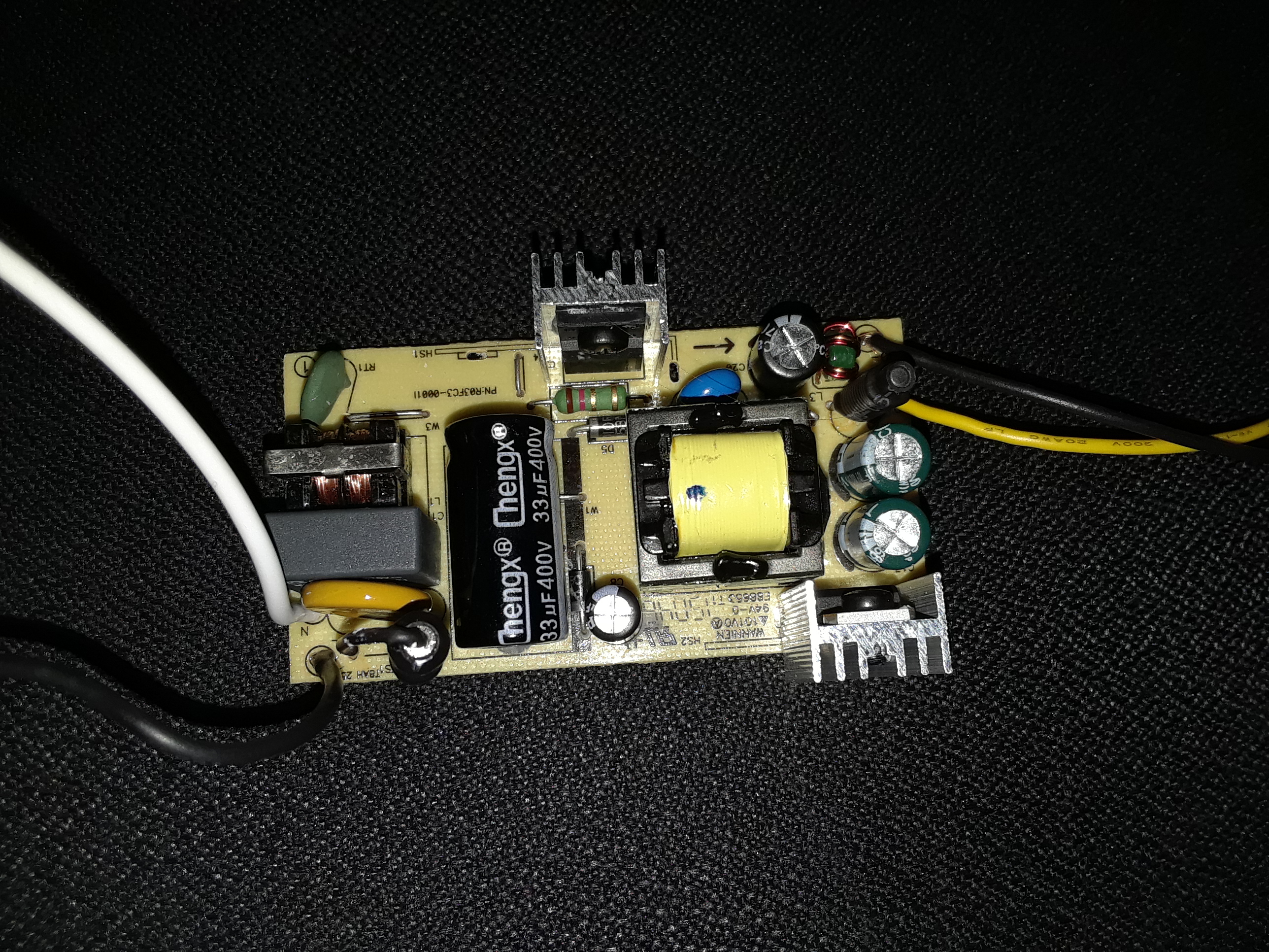

      Re: Trying to repair a cheap 12v power supply
      Even when the power supply is under no load it still does not want to work, it does this all the time.
      Here are some better photos but be warned, my soldering is not the best looking but it does work 99.89% of the time so i don't think it's part of the problem and like i said in post one 'it still has the same problem as it did before fixing it'.
      Also, any bodge jobs you see were not done by me.

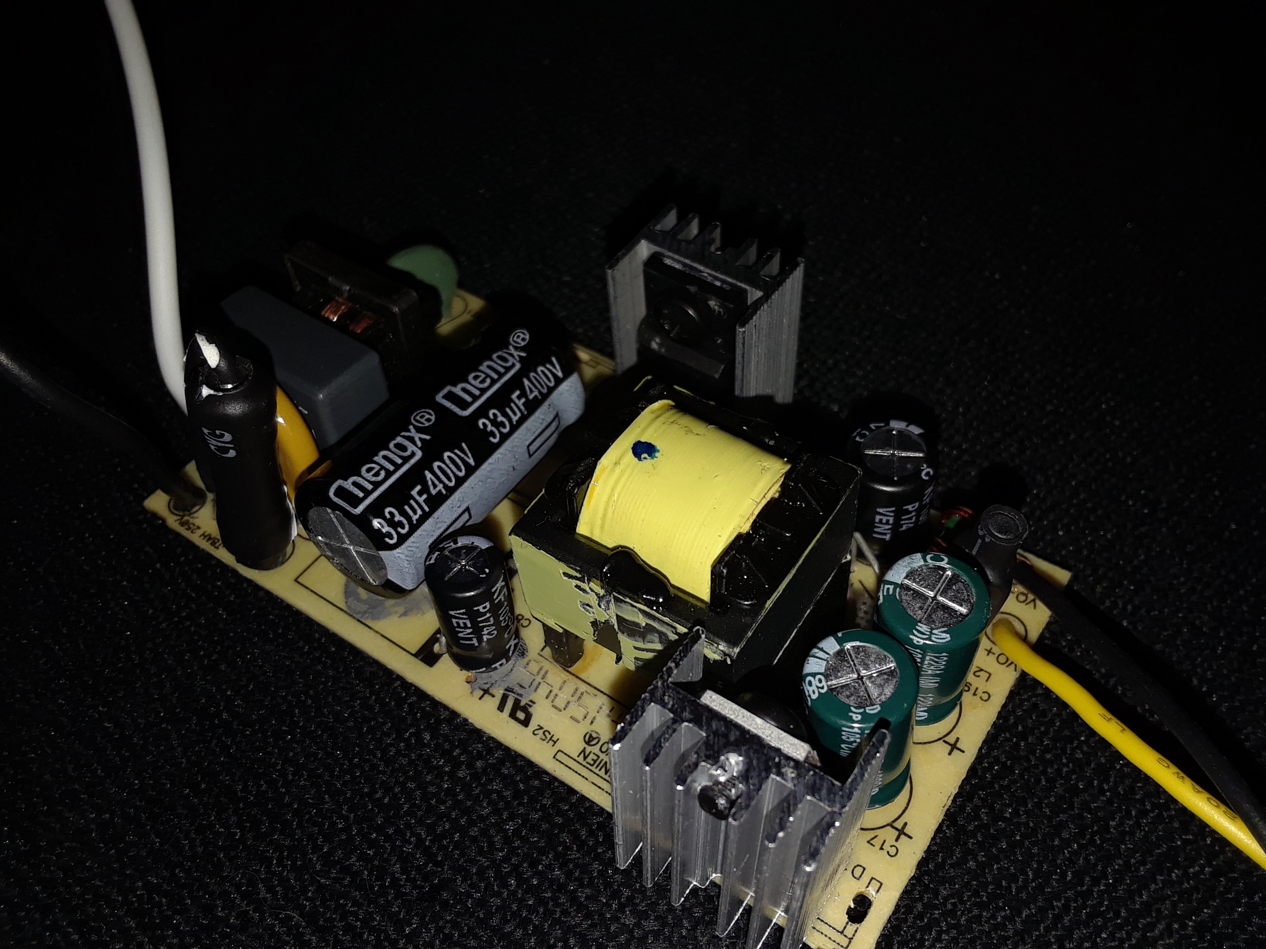

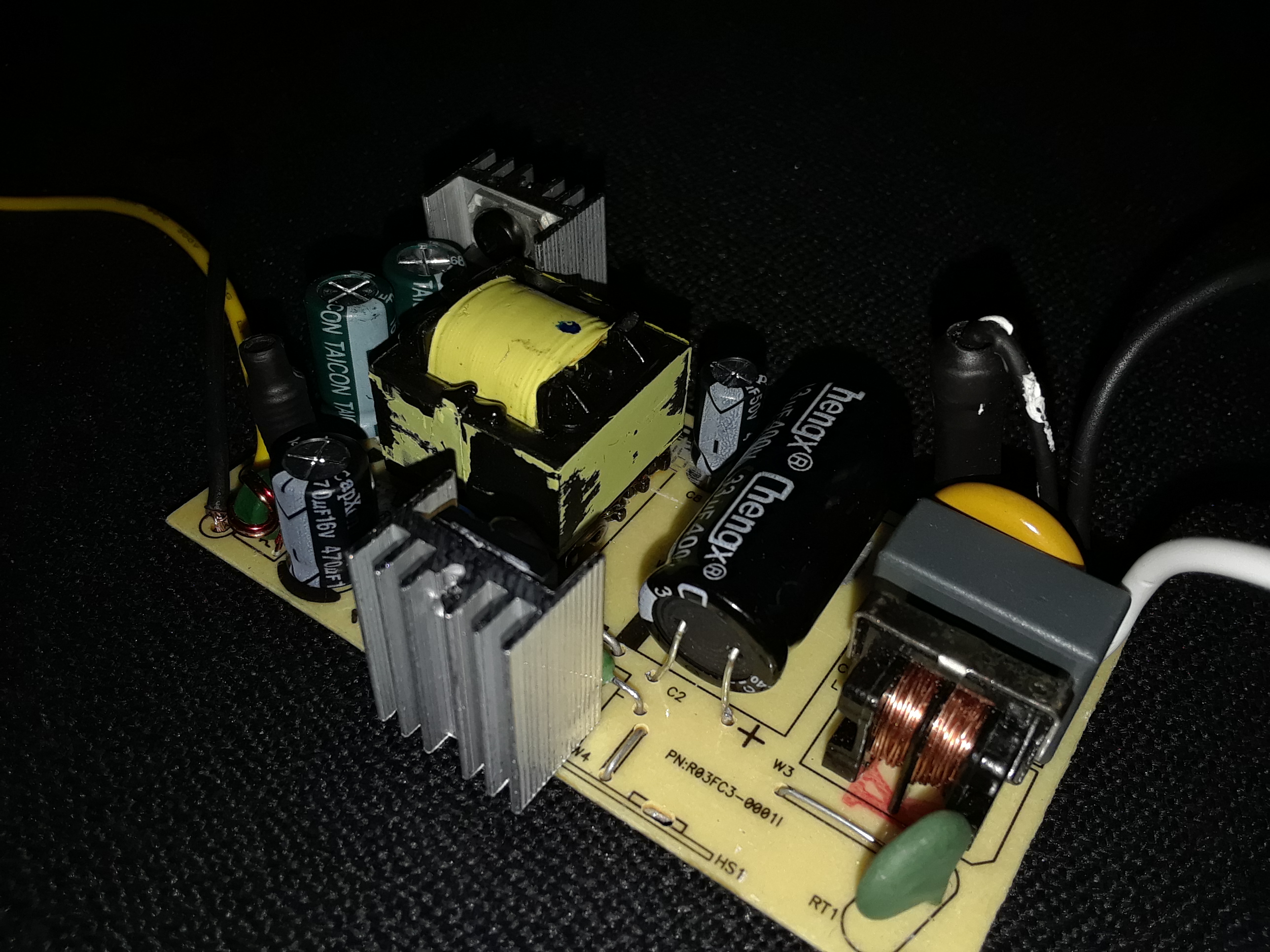

        Seems like the common failure mode: bad caps...which caps did you try to replace? Any one that feeds back could be at fault.
        And yes, nice bodge jobs
          Did you replace start-up/running small lytics cap on the primary side?

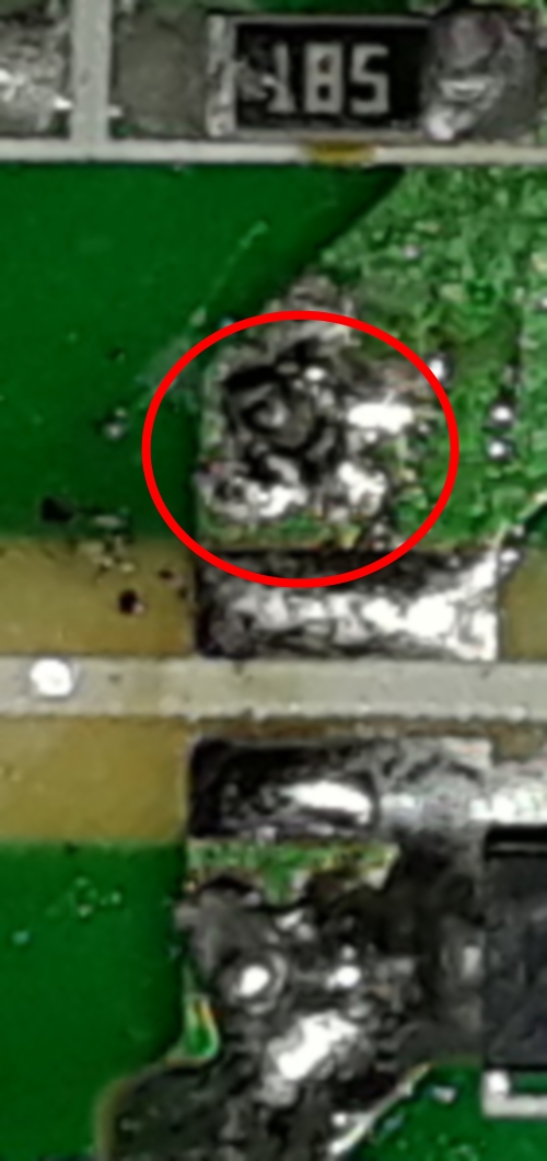

          The pins of the common mode filter choke L1 in the primary look like bad solder works.

            I replaced all of the capacitors with brand new ones i have on hand which were also pretested before being put in. (they're mostly test capacitors to make sure this thing worked)
            Well i don't think it's at fault in this situation because the unit does try to start up.

                    Tested it and both sides of the common mode choke tested at less than 1Ω each.

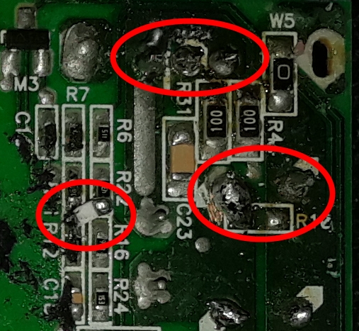

                      When I see board in this condition, first thing I would do is to clean up those bad soldering works first to eliminate the known bad looking condition. Someone mod the board too? I will not call the soldering on that inductor pin is acceptable.
                      The resistance between the inductor pin if checked at the pins may look OK, but if measured between the pads where the pins are solder too is another story.
                      You should also the DC V meter connected to the two legs of the main filter cap (the 400VDC cap) without the load and see what happen with the load connected.
                      Also check R46, R43 resistance.

                        R43 tests at around 543k, I could not find R46 but looking at the board i'm guessing you meant to say R26 witch tests at 555k.
                        However, R35 (a 10Ω resistor used for the snubber) is shot (tests at around 1.2MΩ).
                        As for the soldering, i did not notice that one pin on the common mode choke was not fully soldered (yet somehow still working) but the diode package and the 680uf cap's soldering have their reasons. (the 680uf capacitors reason being a bit better than the diodes reason) But i will try to make it look better (as i was a bit short on time).
                        BTW i did not solder that SMD cap.

                          The primary capacitor's voltage sits at 172VDC even when the output is pulsing. (This is with the diode and common mode choke re-soldered)
