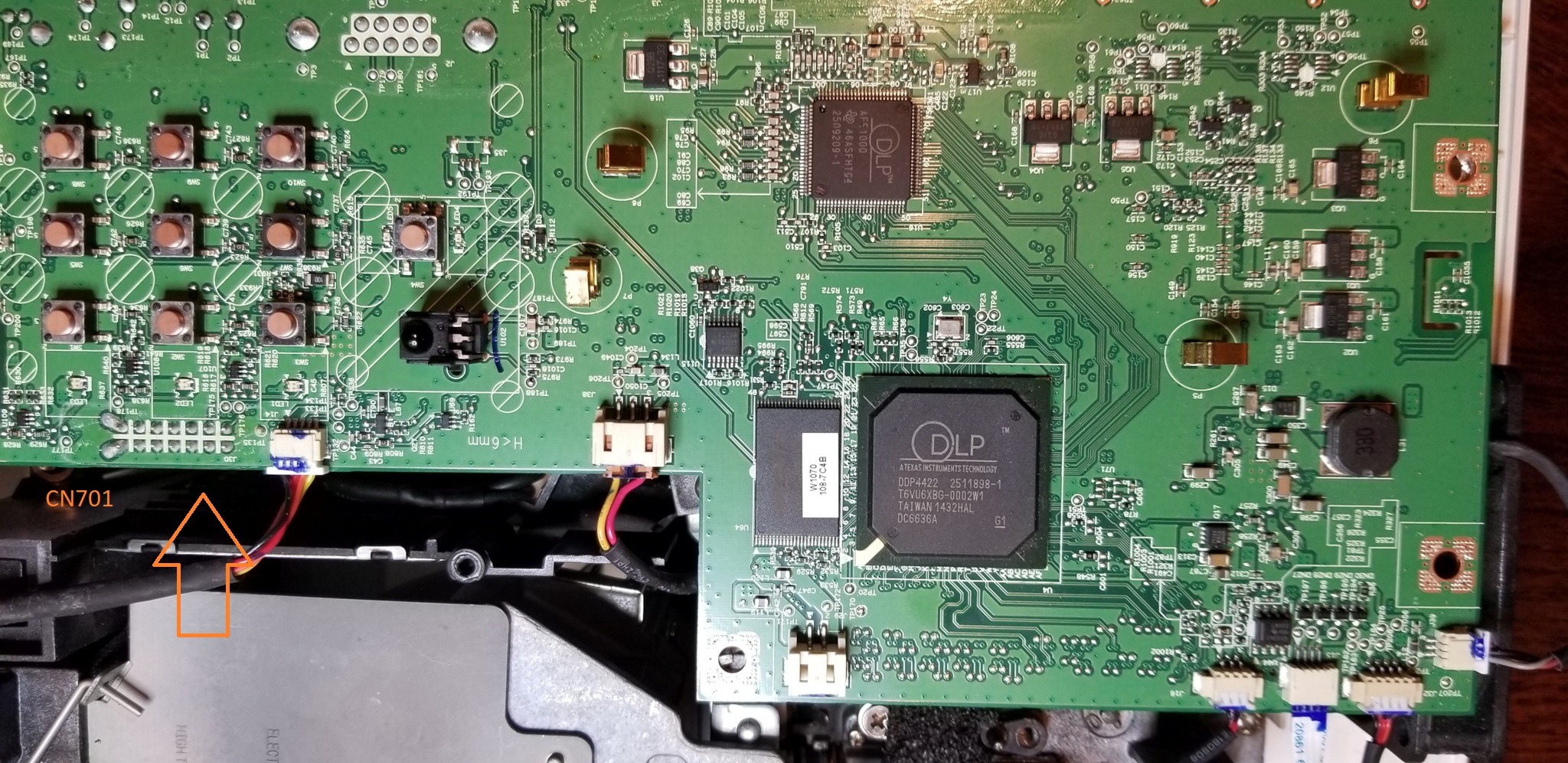

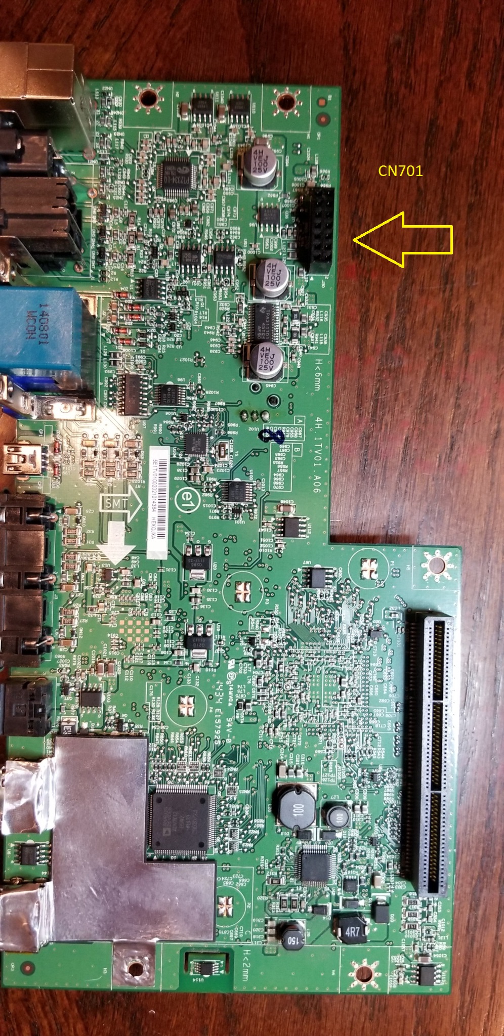

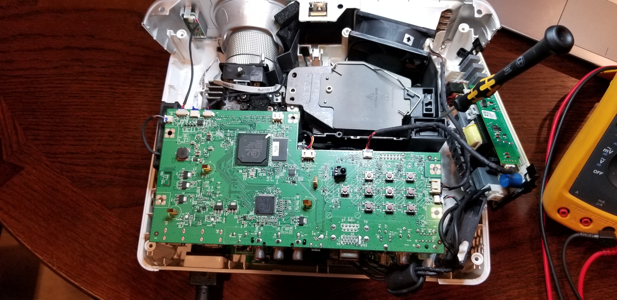

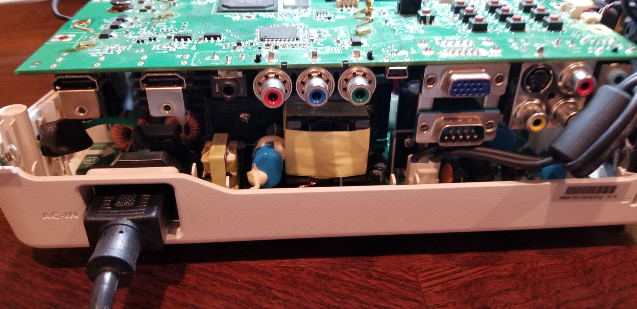

      Today, I have plugged everything back together and I have measured the pins ,at CN701 and both voltages are oscillating. That is why the power button LED blinks.
      With Min/Max, the most that I have measured is 4.7V and 1.4V.
      Without the main board connected, these voltages are stable. Something is bad on the main board?
      I have took some quick phone shots. Most likely they are not good enough for diagnosing the boards. But at least, you have an idea what we are talking about.
      Without the main board connected, I have measured the optos, between pin numbers #3 & #4 and I'm measuring 1.00V, at IC652 and 15.3V, at IC653.

        Either the main board is drawing too much current from the PSU due to some sort of a fault, or the stby circuit from the PSU can't provide enough current required for the main board to run properly.
        Check or replace that cap that runs the STBY circuit on the PSU. You can also use a bench power supply and feed the main boards STBY with it and see what happens.
