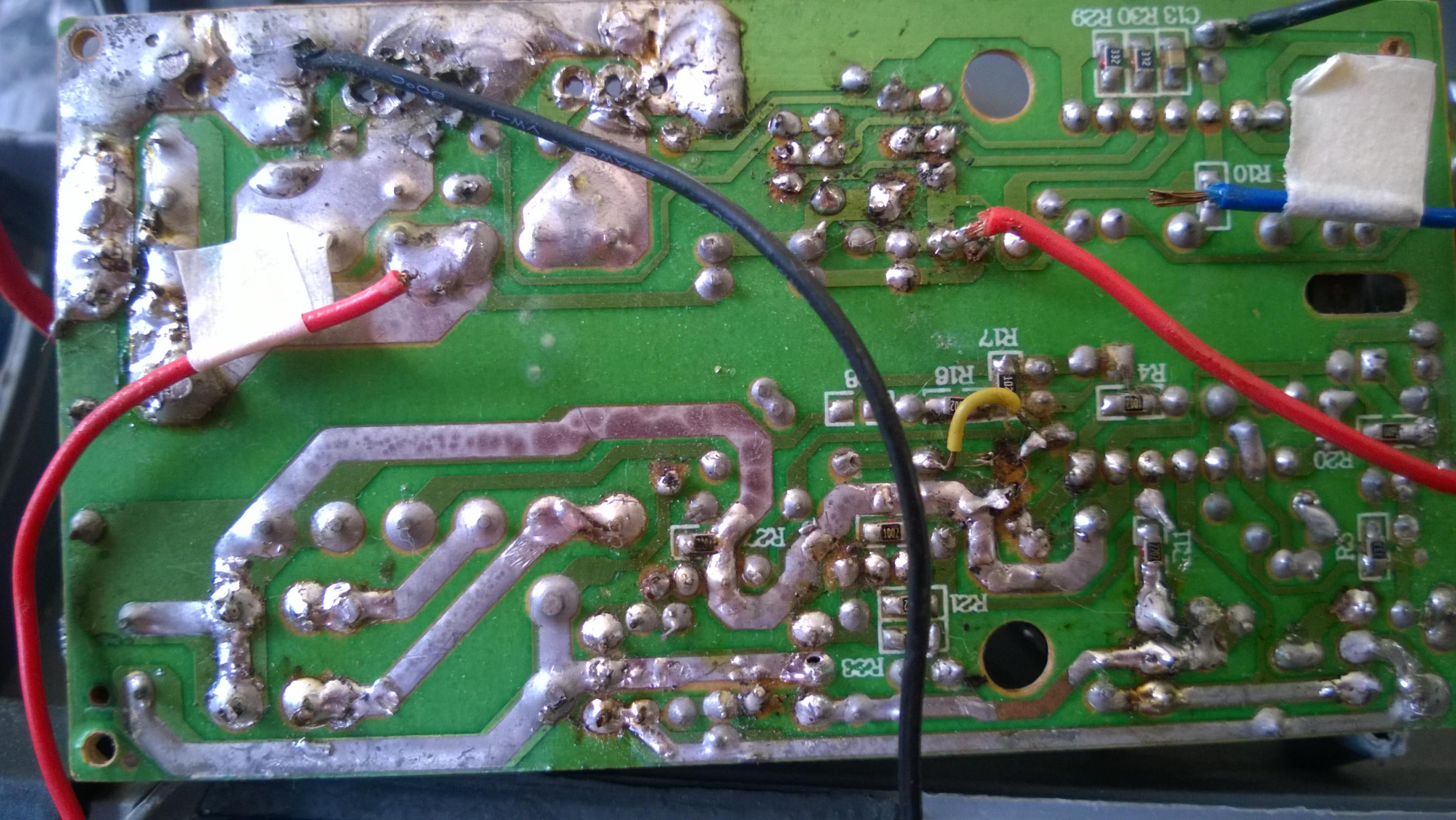

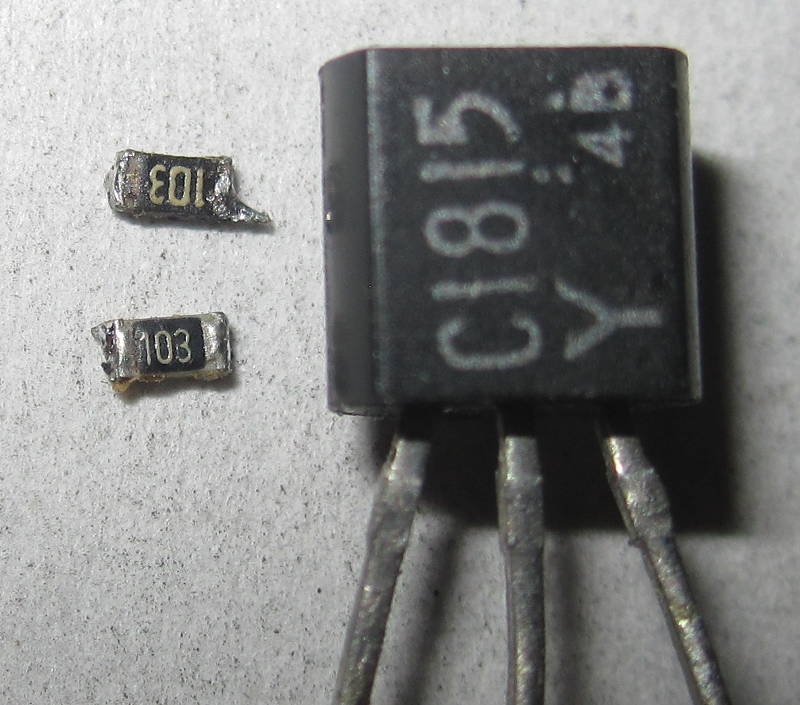

    UGH.. I think I found the problem in my inverter. I found a "103" (10KΩ?) 0603 resistor that measures infinite...
    Now I need to find a replacement... I have a 1005 "1002" resistor in my spare parts dump which is a bit too big
    Found one on a dead cdrom board... Soldered it in. After at least 5 years of this project backburnered, I see life in it. The LED turned green once more when it had never turned on ever since it failed. I need to resolder the transformer now and see if this thing lives once more.
    What really pissed me off is that I bought this inverter to open and see what was inside. It worked at first. When I opened it to peek at its guts, it stopped working. I never got it working again. Being an honest tinkerer, I did not return the inverter despite it was under warranty because I could have damaged it... Now that I debugged it, I should have returned it, this was 100% manufacturing defect. Live and learn?
    Allrighty my little 80W inverter is reassembled and working like new. That was one of the longer projects that took forever to rootcause *sigh* ... luckily I was able to find all the original screws and case parts despite it being disassembled for so many years. Tested it with my small bench PSU, quiescent current flow: ~250mA. With a 4W night light bulb, ~550mA. Regulation: horrible as expected. I could see the brightness of the night light bulb change as I adjusted the input voltage. The overvoltage and undervoltage inlet shutdown works, LED turns red and shuts down when I go over or under the limit...

      For reference for my inverter, sorry for the threadjack:
      Hazard Fraught Tools ... err Harbor Freight Tools / Chicago Electric Power Systems 80W direct plug in power inverter Item 66972
      Design: modified square wave inverter using two KA7500 (TL494), two stage/H-bridge, isolated output. Open loop/No regulation.
      Symptom: Inverter doesn't invert, fan turns on, LED remains red
      Repair: Found R9 to be open, replacing with good 10KΩ resistor restored operation to normal. (The C1815 TO-92 transistor is there just for comparison.)
