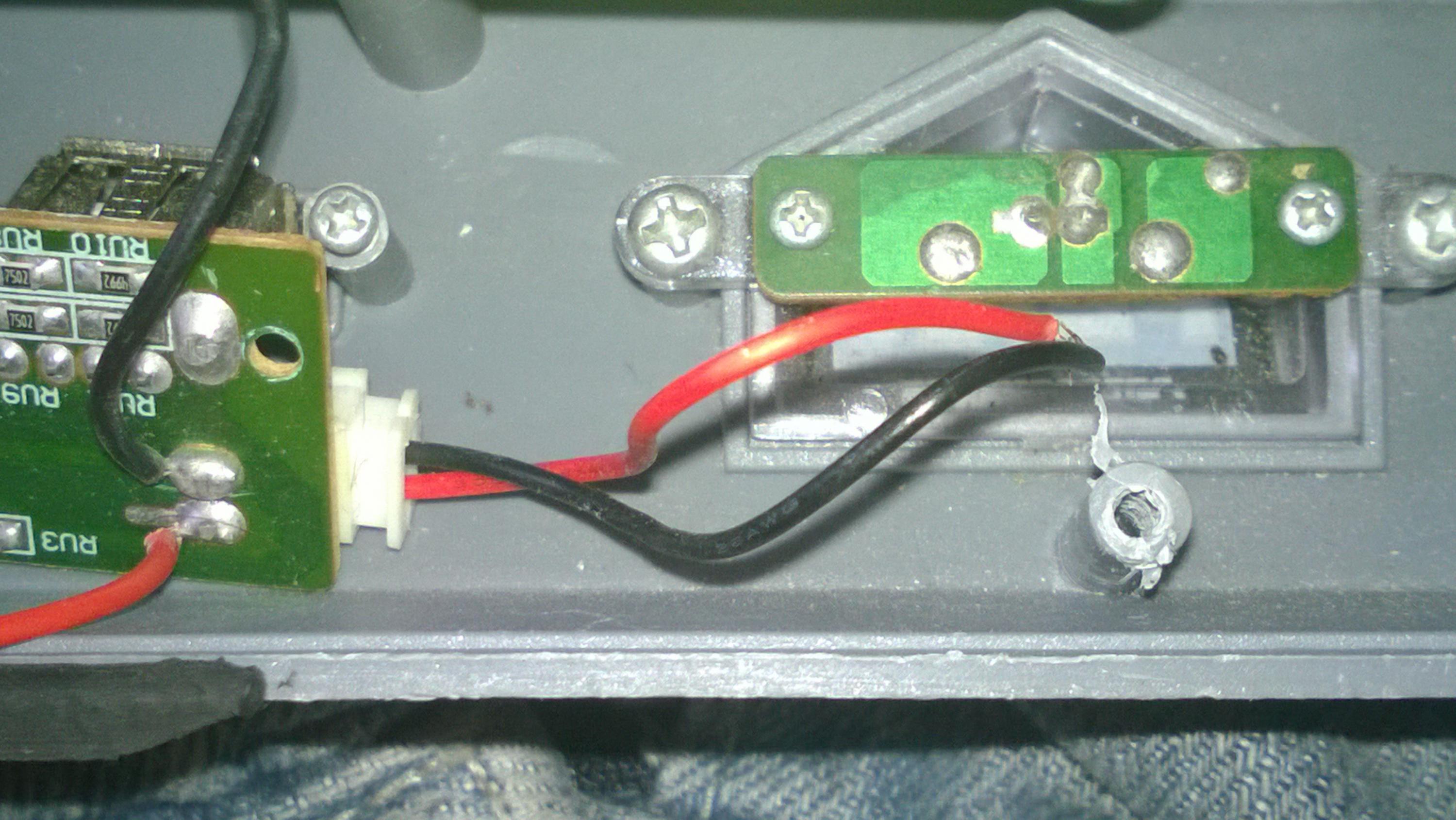

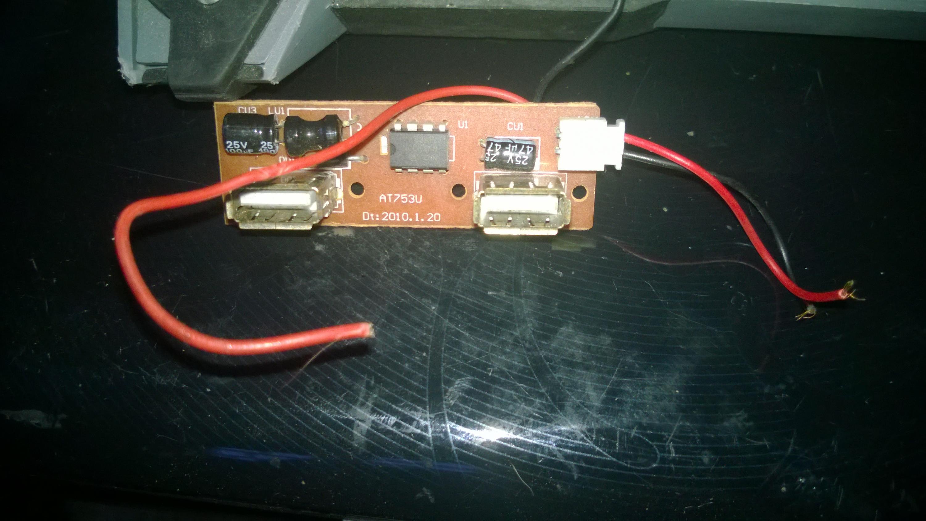

    What's on the USB board, does it have its own converter? (my USB port on my AC inverter has its own converter, so I could just feed in 12V from the car straight in, so it would make it easy to figure out what needs to be fed in.)
    This board sure looks like it has seen its days...
    • Mandraco
      • Apr 2013
      • 50
      • Puerto Rico
      #42
      Re: Help with a car lighter inverter
      In these pictures you can see the board with the USB ports and the unattached red cable on the left. On the right you can see a connector with a pair of smaller red and black cables detached from other board. That board measures about 3\4 inch long, as you can see in the last picture, and is only a status light with the brand logo. For that one I can use the diode testing mode in my multimeter to find out the polarity of the diode. I hope this helps.

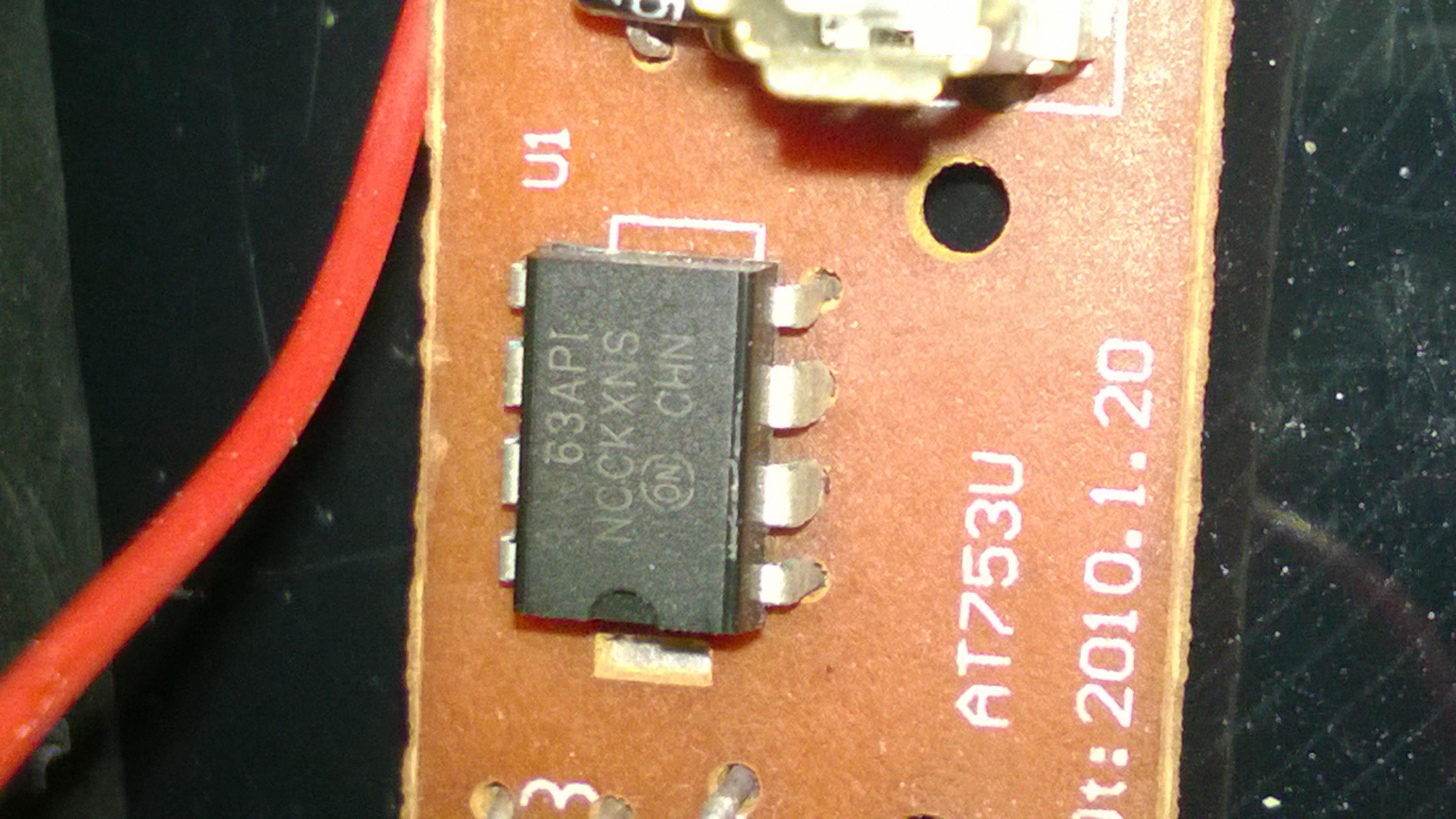

        #43
        I only see a couple of caps and an IC, besides the ports.

          #44
          Ah yes, so it does look like the USB board has its own regulator much like the one I have, so likely the input hooks up straight to the 12V input, just tap off it anywhere. Likely it's a MC34063A based regulator (can't read the IC or enough of the back side of the PCB is showing) and is its own switching buck regulator. I suppose the LED indicator lamp is lit from the same tap. Finding the resistor on that board would be another good sign as to how many volts should go in.

            #45
            Yes, the IC has written on a series of numbers and letters: 63API before the "6" there are what seems to be three numbers which are very faint. I looked up the visible part of the code and found only a site selling ICs with errors "save buying IC with typos" It says. Maybe this is one of those since the first numbers are not readable so easy. The most I can make is a "300" but it could be wrong, below is a picture, I'll try to get the complete code later when I get home, thanks.

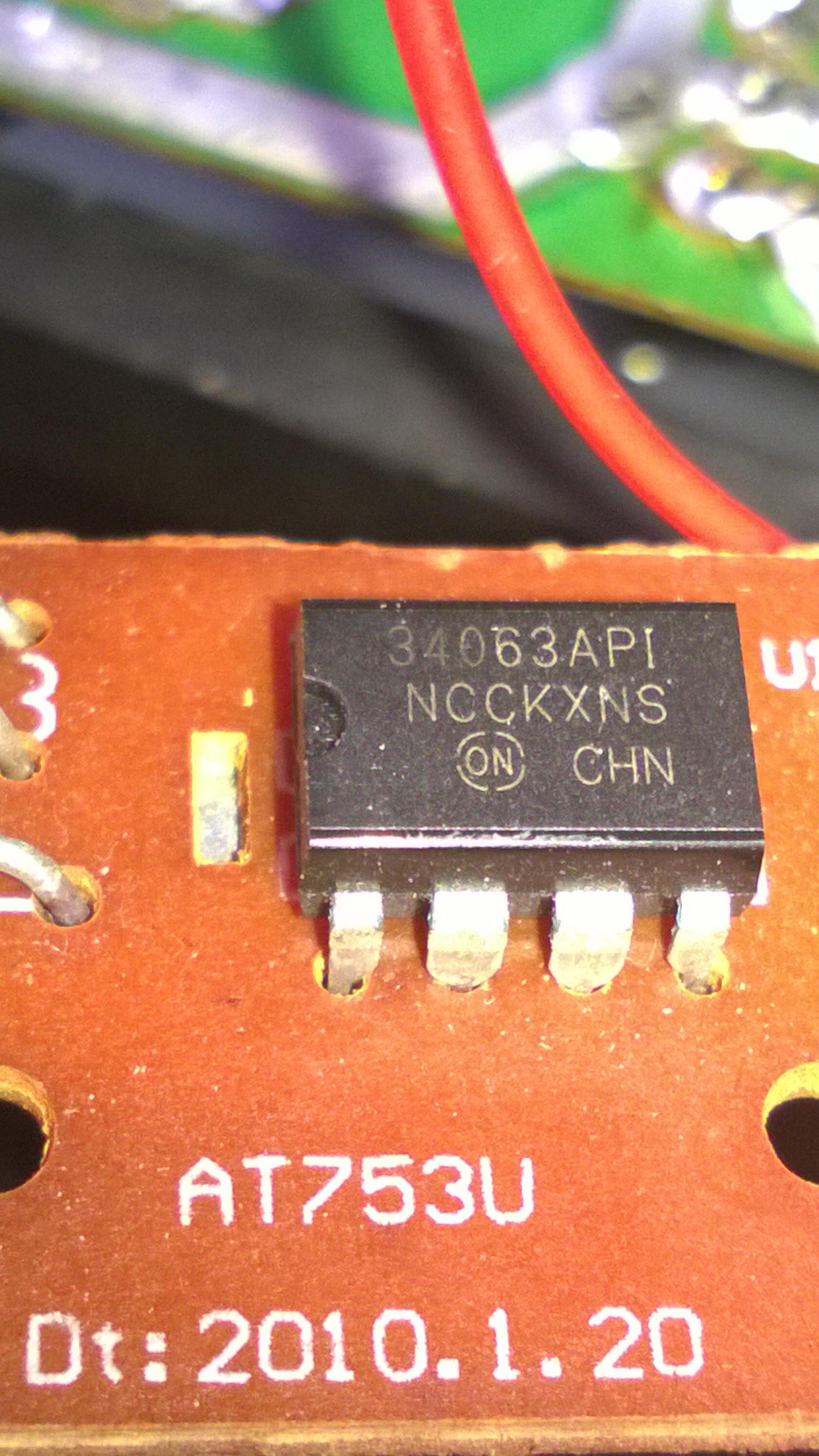

            • Mandraco
              • Apr 2013
              • 50
              • Puerto Rico
              #46
              I was able to see the complete code on the IC, It is: 34063API as you can see in the picture I attached to this reply.
              • eccerr0r
                Solder Sloth
                • Nov 2012
                • 8716
                #47
                Yup, that's the ubiquitous MC34063 allright. So just need to connect the + wire (probably the red wire, though need to see tracks on back of the MC34063 board to be sure) to somewhere after the main fuses/switch and black to GND (again, need to view board. Pin 4 of the MC34063 should be connected to whatever is connected to GND as a double check.)

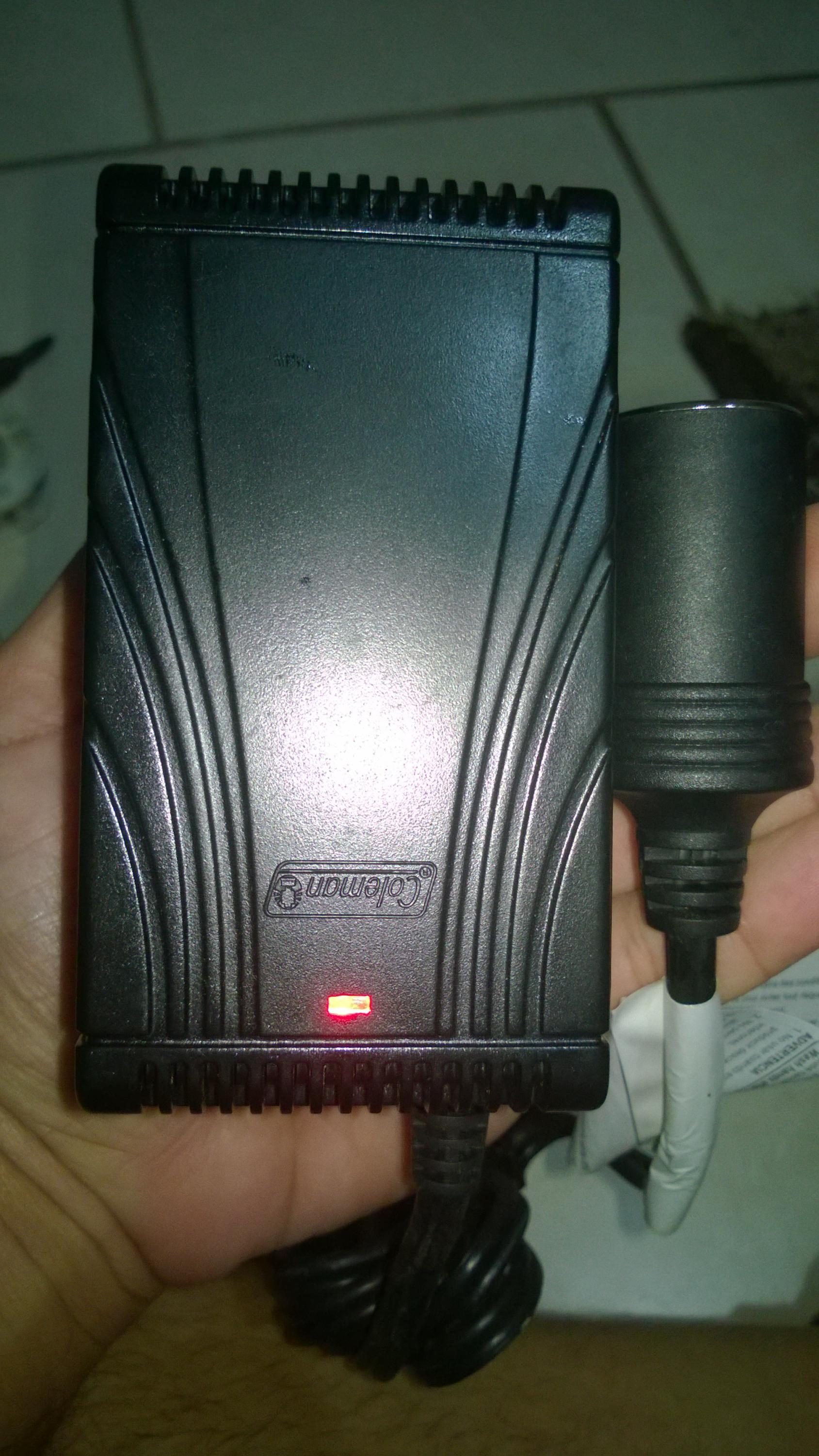

                  #48
                  Hello guys, I'm back! I'm so sorry to take so much time from my last post, these days have been very hard. I've been fixing other stuff around the house, gas range, clothes washer
                  Now, yesterday I put back together the Inverter and found it showed a blue/purple light in the inverter's brand logo but then it turned off on itself and toggling the switch on or off showed no change. Then I tried unplugging and plugging back and the only two LEDs, purple/blue on the logo and the status led, both flash the moment I plug the inverter. I'm not plugging directly to a car lighter socket, I'm using a home to lighter plug converter. It's a power converter to convert 120v AC to 12v DC (5.25amps) and noticed that, as soon as I plug the inverter, the adapter's status light dims and starts buzzing and the inverter starts buzzing as well. I can say the the buzzing in the inverter comes from the general area around the transformer.
                  Bellow is a picture of the power converter I'm using and its box. Any guess as if the transformer is bad or should I check other components? Thanks again.
                  • petehall347
                    • Jan 2015
                    • 4451
                    • United Kingdom
                    #49
                    that is a power supply not an inverter .
                    • eccerr0r
                      Solder Sloth
                      • Nov 2012
                      • 8716
                      #50
                      I think he's using the power supply to power the inverter so he doesn't have to test in a car or whatnot. In any case it sounds like something's still shorted, check the other MOSFETS to make sure there are no shorted units.
                      Oh, and better yet, measure the voltage of the PSU/current draw of the inverter for more clues as to what's going on... ideally the inverter should not be drawing much except for the first moments as it charges the capacitors. Should not be more than 1A or so, and the PSU voltage should not drop below ~12V ...

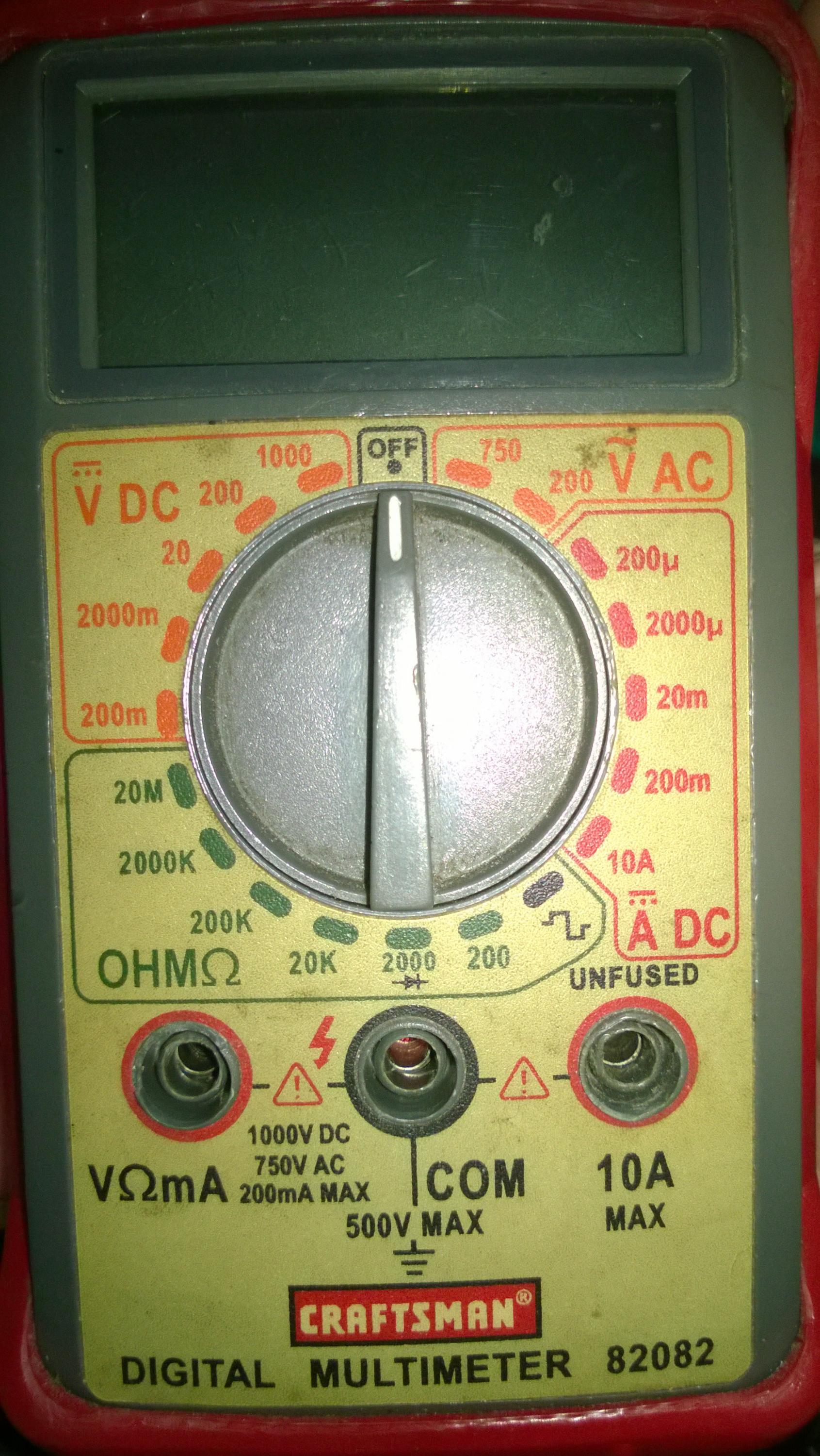

                                  • Mandraco
                                    • Apr 2013
                                    • 50
                                    • Puerto Rico
                                    #57

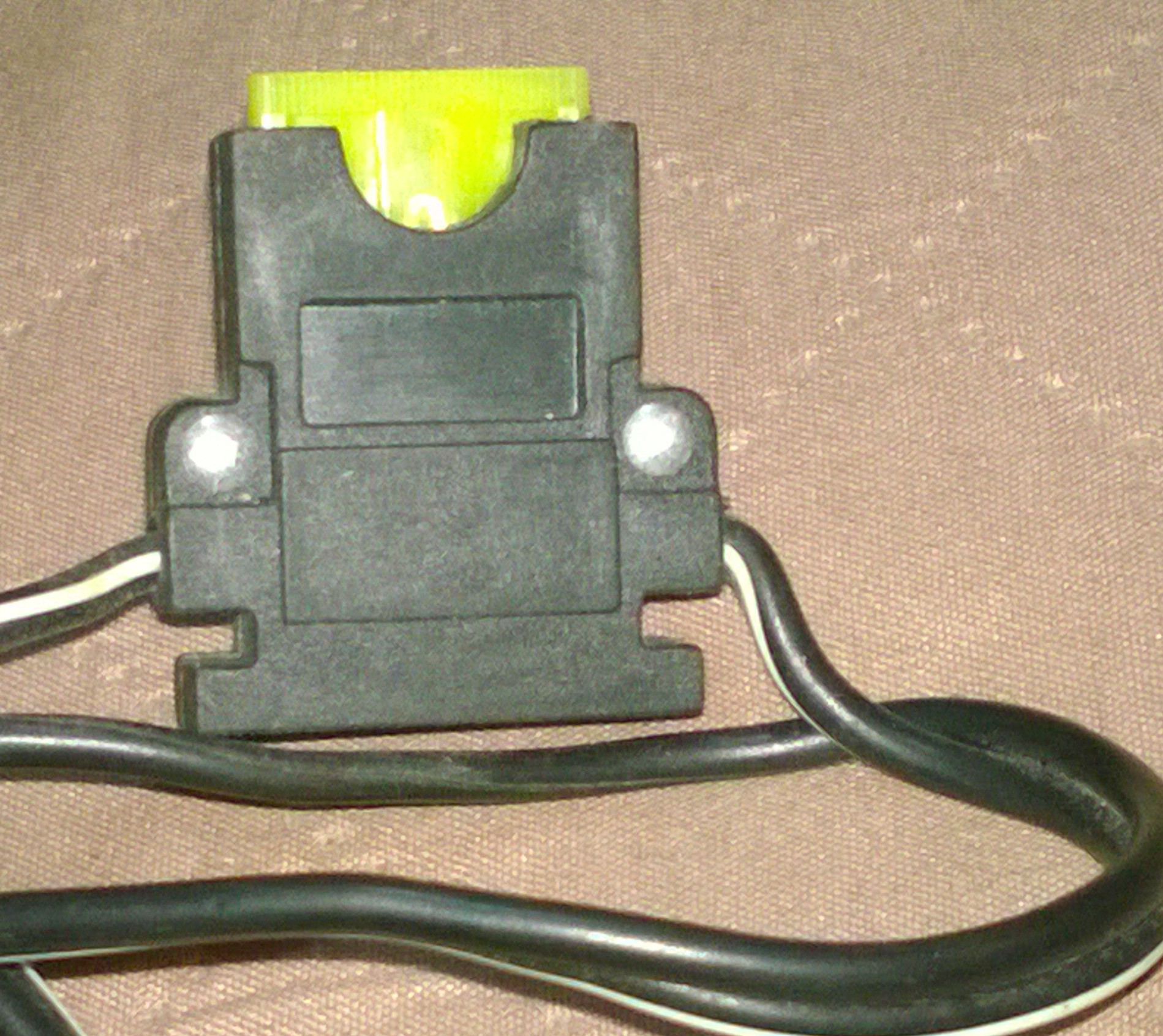

                                    What do you mean by INLINE multimeter? Mine is that in the picture I include below. It has no clamps, just pointy leads. When you say there's a workaround and going to the fuse contacts, I get it you mean to place the leads in both contacts of the fuse port, Am I right? The fuse port is on the cable, it's between the end that goes to the car lighter outlet and the inverter.
                                    I included a picture of the fuse port as well as one of my multimeter.

                                        • eccerr0r
                                          Solder Sloth
                                          • Nov 2012
                                          • 8716
                                          #60
                                          The "dim bulb tester" is an ad hoc tool people make. It's just a light bulb that you jury rig into the circuit in lieu of the fuse. It's conductive enough to let power pass, but if the device is shorted, instead of the device or the removed fuse taking damage, the light bulb lights up brightly, signifying a short. The light bulb "car tester" probe likely is not conductive enough to pass enough current to do much testing in this manner.
                                          And yes you can stick your probes into the fuse socket instead of the fuse to test current draw. As your inverter is still shorted as witnessed by a burnt fuse, there's no need to continue to test in this manner, you'd likely cause damage to the circuit or the meter if you tested this way - you have to look at the inverter.
                                          BTW usually those ATC/ATO fuses have a little metal exposed at the "handle" side of the fuse that you can use your sharp multimeter probe to measure voltage before and after the fuse. People often use these to check the fuse without removing the fuse.
