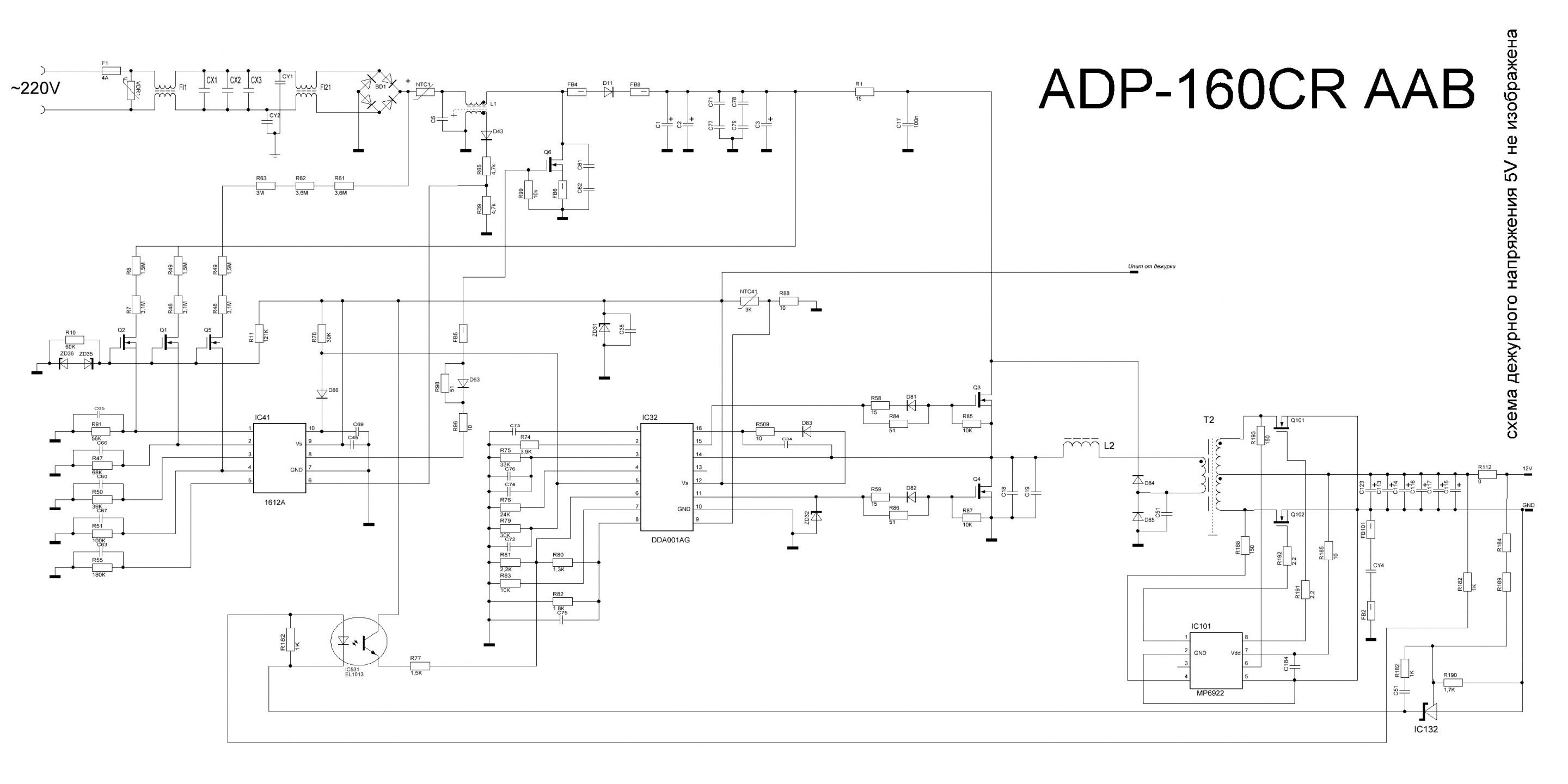

                  Re: PlayStation 4 Slim power supply ADP-160CR
                  I need to know the value of R39, the rezistor code, can you help me?
                  • lpraderi
                    • Dec 2017
                    • 31
                    • Uruguay
                    According this hand made russian diagram of ADP-160CR R39 is 4K7 ohms
