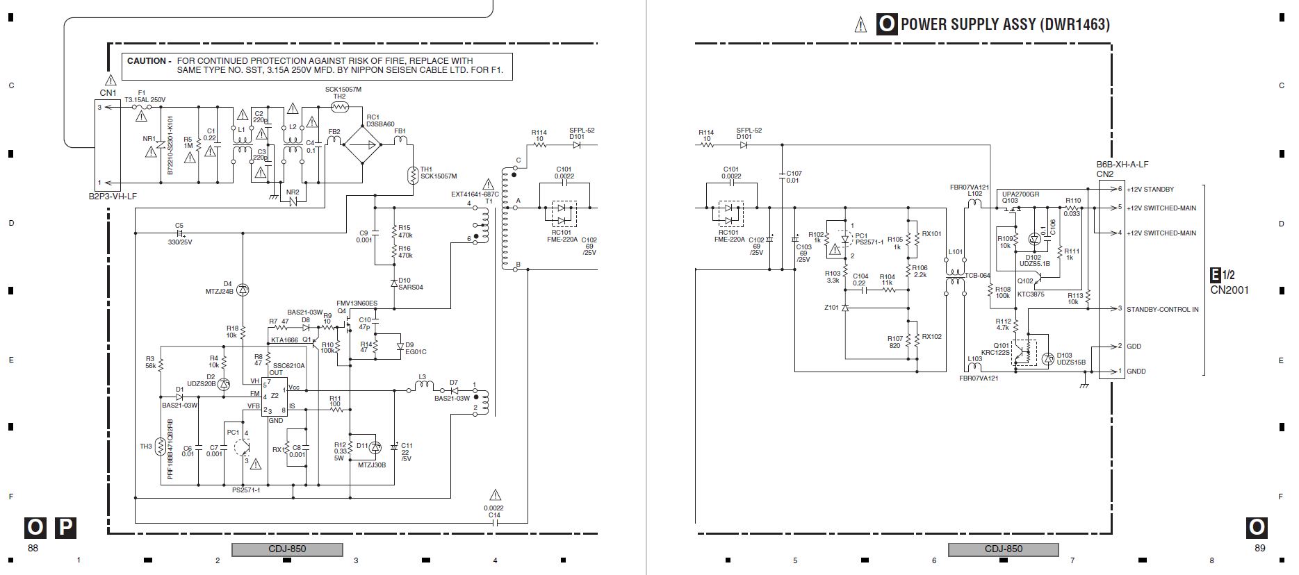

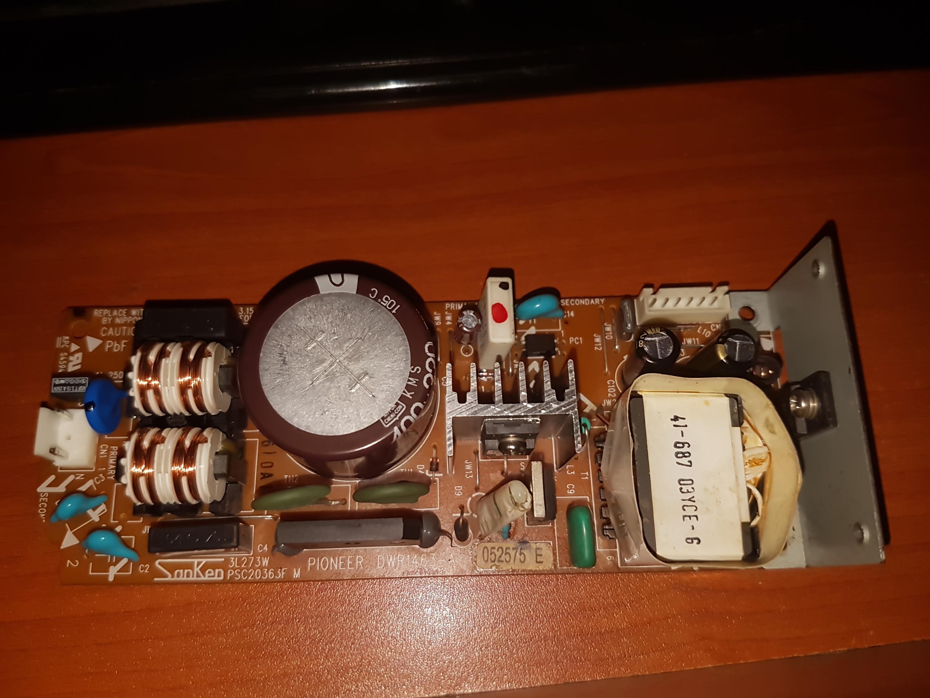

    Yes, this is the weirdest ive ever seen. Taken from a CD player. Just nice and compact with not much components.
    First it has no power. Dismantled the unit, unplugged everything and tested the power supply on its own. While the power plugged, hearing a ticking sound on the switching transformer. Tested the port for 12V, only 5V was showing.
    OK, i replaced all the electrolytic caps and ceramic caps, NO GO
    Swapped the N channel transistor. Still NO GO
    Soldered all the joints, NO GO
    Tested all the normal diodes and SMD diodes, all gives good reading, none shot
    But the thing is, all of a sudden after switched off for sometime and switch on the unit again, it will work providing solid 12V and there wont be any ticking sound and the entire set works fine . Then when you switch it off and switch on again after a while, the ticking sound will start doesn't matter with load or without load. Anyone had this issue before?
    All other boards on the player is fine, the power supply is faulty on its own as it gives the ticking sound without anything plugged in to other boards.

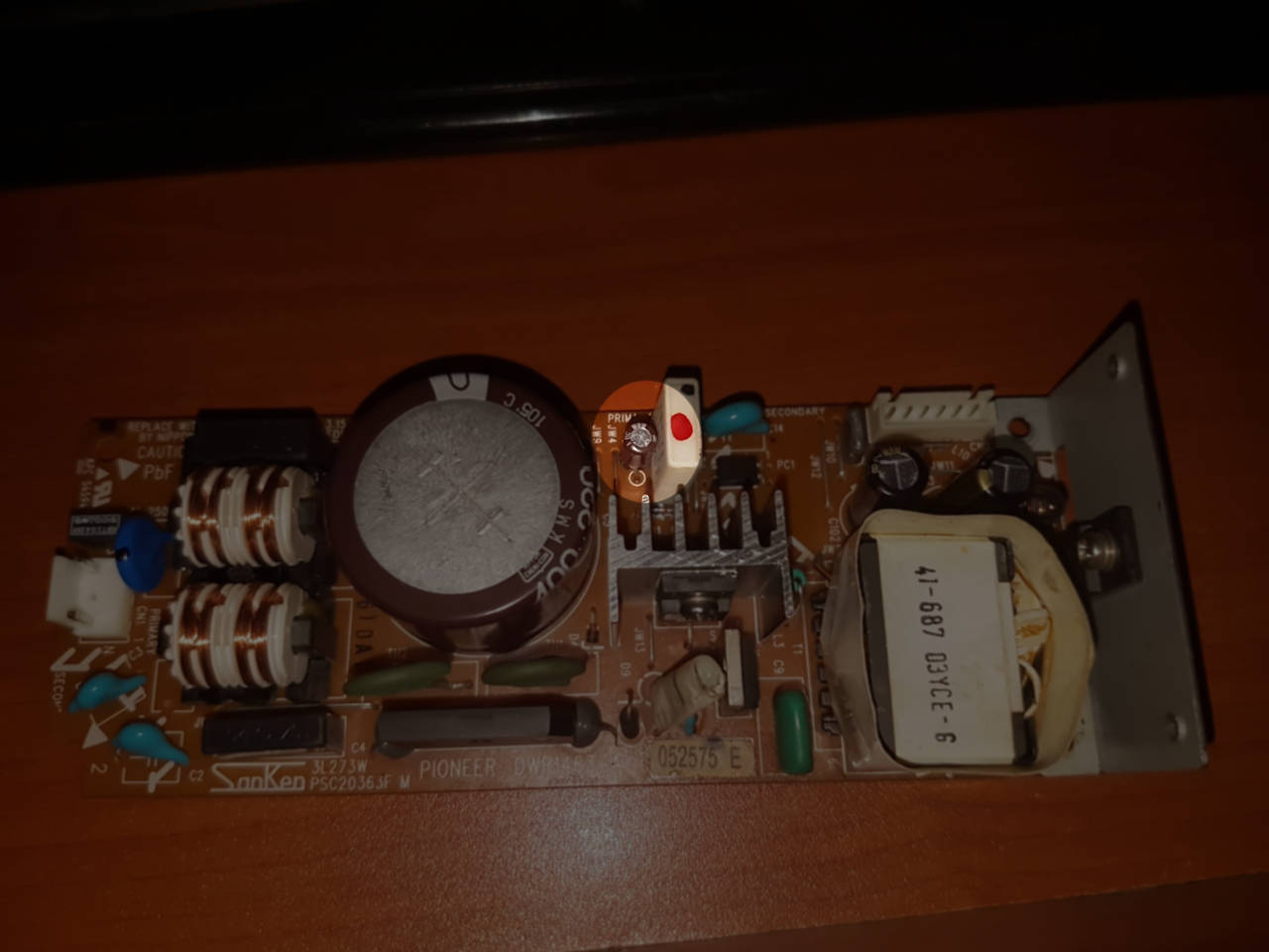

    Did you check or replace startup/running cap C11 in the HOT side?
    The ticking sound you hear is due to SMPS is in start-up shut down mode whcih can be due to bad caps or bad rectifier in the cold side.
    BTW, the schematic looks to have error, C5 is labeled as 330/25V, that cannot be right, that is the main filter cap so it cannot be rated at 25V, C11 is shown as 22/5V which is wrong also. See what the real rating of the caps are on the board and compare them to the schematic.
    https://www.badcaps.net/forum/attach...3&d=1519382548
    The board is fed by 120VAC or 220VAC?

      I was about to guess C11 but because "all" caps were replaced it couldn't be...
      I think this is C11:

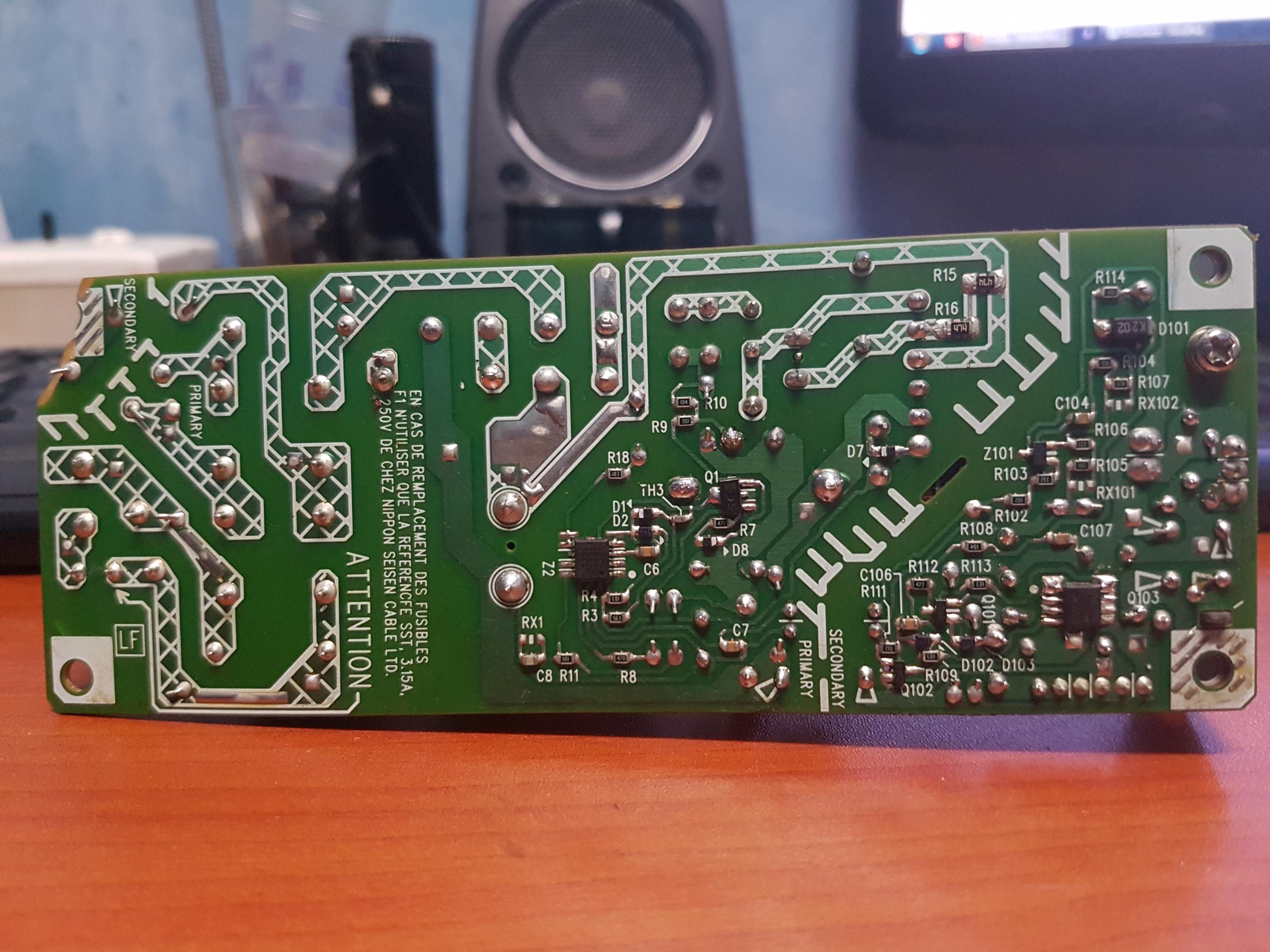

        Looking at the bottom side of the board it does not look like there is sign of soldering works on the cap's legs.

          Thats because after soldering everything, to make sure its clean i cleaned the entire board with alcohol and toothbrush
            Re: Weirdest power problem
            OK, thanks for the clarification.

                      Replaced the optocoupler, power supply is working but the ticking comes back for few seconds like 10 seconds upon turning on if switched off for more than 10 minutes.
                      I think some smd ceramic caps needs checking.
                      • DjKrish
                        • Oct 2012
                        • 354
                        • SG
                        Update : C6 smd cap shot. Replaced, so far so good.

                          Isn't C6 a MLCC, now these I wouldn't expect to fail unless they're physically damaged thus shorting...
                            I wonder what that Thermistor TH3 is being used for, it looks to be for something to do with temperature. I did not have a chance to look up the spec sheet of the IC yet to see what pin 4 is used for.
                            So C6 has leakage resistance?
