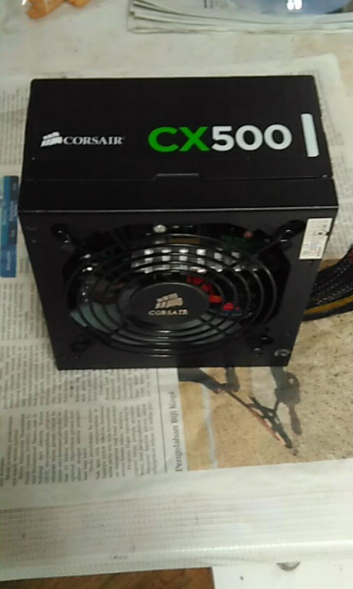

Asistance required on troubleshooting Corsair CX500
  • KidD01
    • Sep 2010
    • 8
    • Indonesia

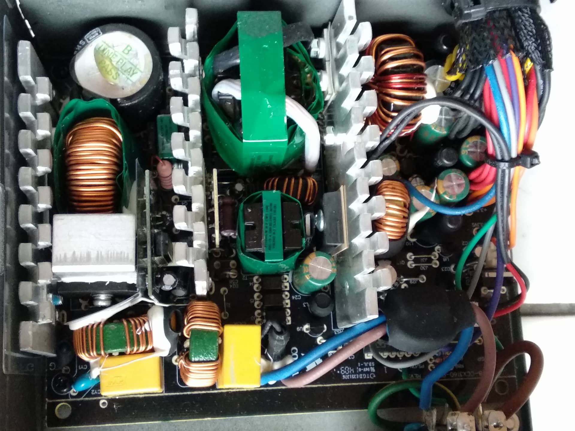

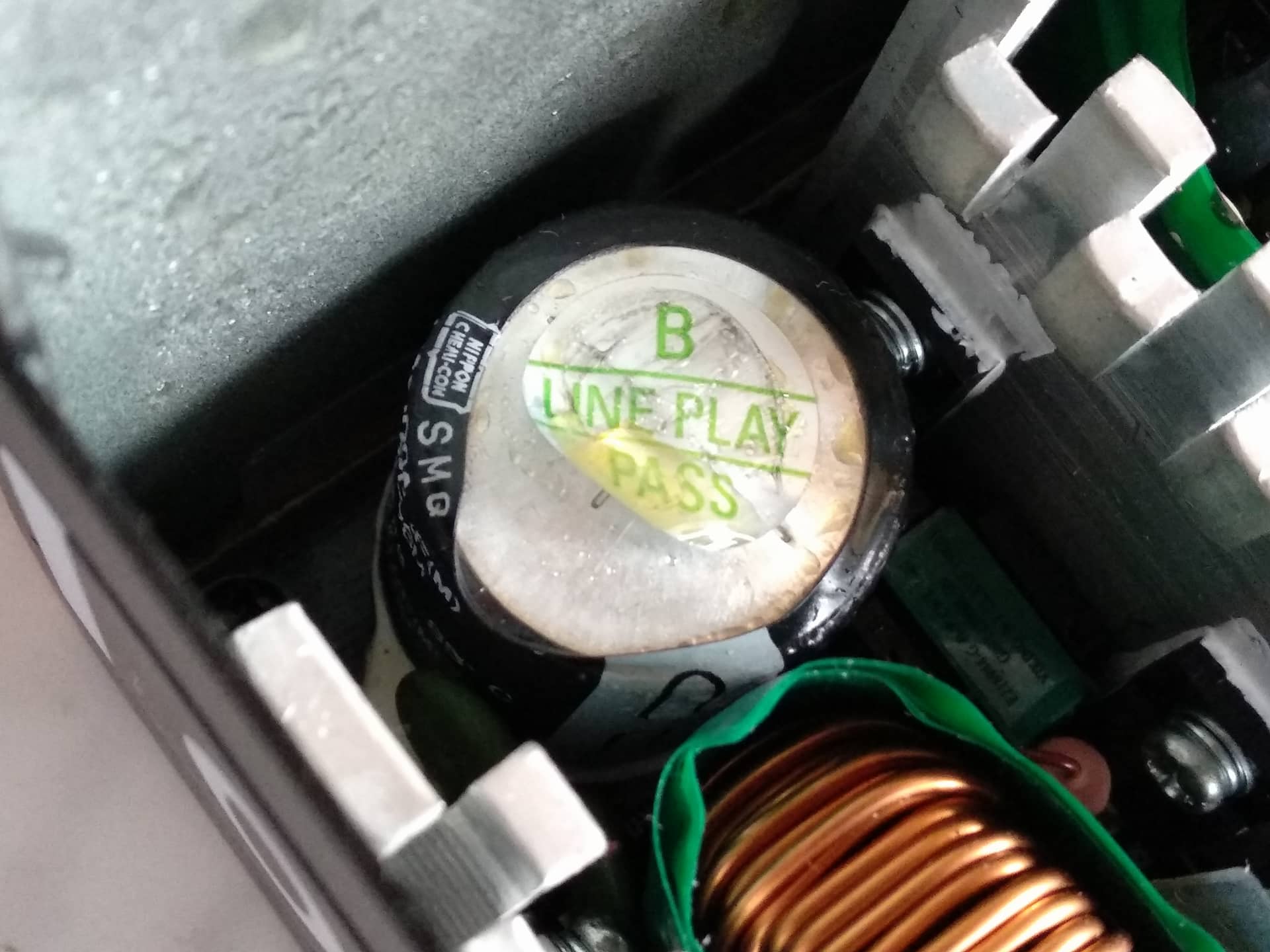

    I just got a Corsair CX500 which got a blown primary capacitor (a Chemicon SMQ 220uF/400V), judging from the capacitor appearance it seems there are something wrong besides the capacitor as the plastic on capacitor body had some traces as if it was overheat.
    Would be grateful if anyone can provide information which parts to check.
    Thank you.

    Re: Asistance required on troubleshooting Corsair CX500
    Is the fuse blown?
      • Jul 2011
      • 6039
      If the fuse is blown check the bridge rectifier for a short circuit
      • Agent24
        I see dead caps
        • Oct 2007
        • 4953
        • New Zealand
        If the bridge caused the capacitor to fail, it could have killed the PFC MOSFETs and controller too.
        Or the PFC circuit could have a fault which caused an over-voltage condition on the capacitor.
        It's still possible for primary capacitors to fail by themselves, too. Just not as often as the secondaries.

            Probably an APFC failure, causing the primary cap to blow (and perhaps the fuse + other components too?). Time to heat up your iron and start pulling parts.
            • MHTSOS
              • Jun 2014
              • 17
              • Greece
              Remove the heatsinks with the mosfets on the primary side and check them. Most probably some of them, if not all, are shorted.

                                    Then I opened the case and the visual examination showed nothing wrong. But when I touched the primary big capacitor with my finger it felt slightly bulging.
                                    The cap tested with esr micro and uF scale of multimeter AND Chinese transistor/C/diode tester, all of them found it was totally open!
                                    Wow, I'm surprised the APFC circuit didn't explode or take out the primary switching transistors for the main PS. Perhaps the fact that you live in a country with 220/230/240V mains AC might have helped it a bit. With 110/115/120V AC main, the current pumped through the APFC coil should be 2x... which means the back-EMF could get really nasty high with an open primary cap.
                                    Originally posted by goodpsusearch
                                    The psu is Corsair VS450, the CWT version, so CWT is the OEM again.
                                    Several weeks later, a friend gave me for free another failed PSU, this time Corsair VS350, again the same CWT platform and once more the same failure mode. Fan spins, voltages barely on spec and primary capacitor totally failed open, capacity is 0uF!
                                    The failed cap is Aishi 400V 150uF 85C on the VS350 and Aishi 400V 180uF 85C on the VS450.
                                    Thanks for sharing this info!
                                    So looks like a lot of Corsair PSUs are likely expected to meet the same kind of doom someday - probably sooner than later, now that many of these are rather old.
                                    I think the cap brand is crap. Please correct me if I am wrong.
                                    Nope, not wrong at all ... though it looks like APFC can be hard even on the good Japanese brands if they are not sized up to the task.
                                    I also find ridiculous the 150uF/180uF ratings for units that actually do 350W/450W accordingly in reviews (and more in overload tests without blowing). The cap must run at 395V-400V to be able to deliver those watts, because, as we know Q=C.V so when the C is too low you have to compensate increasing the Voltage.
                                    Although I also think it has to do with the energy stored in the cap too... i.e. E = 0.5 * C * V^2
                                    Since the energy increases with the square of the voltage, a slight increase in the voltage could offset a much greater drop in the capacitance... so that's how I think they are getting away with much smaller caps. IME, most APFC circuits with 400V caps typically run at about 380-385V... which is still pretty damn close to the max. voltage rating, especially since this is just the DC value and not considering the peaks and ripple current, which could well be closer to 390-395V (if not 400V) when added together.
                                    And while electrolytic caps can withstand a decent over-voltage, it is not advisable to always run the cap near its maximum rated voltage and ripple rating... which is what APFC seems to be doing, hence why even good cap brands tend to fail.
                                    Originally posted by linuxguru
                                    There may not be enough space in the Corsair CX... units for a 450v/105c cap
                                    In that case, perhaps drop down to 420V and see if you can keep the same (or get slightly increased) capacitance.
                                    I don't know if 85C vs. 105C will matter much either... but perhaps it does.
                                    In the end, I think it all comes down to finding the biggest capacitor that the PSU can fit dimension-wise and going with at least 420V. Doing these two should give hopefully a little longer usable life than what the original cap(s) did.
                                    choices are limited, but there's a Samxon HP(M) 220uF/450v/105c cap that will fit - it's in the tall and thin form-factor:
                                    https://cdn.badcaps-static.com/pdfs/...b9a5d6b9ef.pdf
                                    No idea about reliability, though. Where there's more space available, I use Yageo 220uF/450v/105c. Yageo is the parent company of Teapo, and tends to make higher-quality stuff.
                                    I probably still wouldn't trust it as much as the Japanese brands, but that's my personal opinion / skepticism towards non-Japanese caps. (Apologies to all non-Japanese caps that might find these words offensive/racist, lol )
                                      At the company where I work as IT, one computer suddenly wouldn't post.
                                      The fans would spin when the power button was pressed but the motherboard would not "beep" and load the OS.
                                      I checked voltages with multi-meter and found them unstable (can't remember details cause it's an old incident). I replaced the psu with a spare and the computer was back up and running.
                                      Then I took the faulty psu to check voltages again without load. Voltages appeared better without load but no equipment would post with it connected.
                                      I also think 400V is too low for APFC.
                                      Finally, 85C is just wrong, given the stress that the APFC puts on those caps.
                                      I already ordered and received some replacement primary caps for these psus and I plan to do a full recap and enhancement on them and then use them on my pc builds but unfortunately I postpone it al the time due to lack of time.
                                      Happened again , same platform, same failure. Notice, that all the other caps were good.
                                      What I like a lot is that the psu just fails to power pc any more nothing blows up
                                      • goodpsusearch
                                        • Oct 2009
                                        • 2850
                                        • Greece
                                        Highly possible. But I have also encountered HEC 450W APFC psu with primary cap totally dried and fuse / mosfets blown. So can't tell for sure.
                                        I think 105C helps a lot and also the max ripple current specs of the cap and of course choosing made in Japan caps when possible. I hope 420V caps are enough to help too because I find it very difficult to fit 450V caps in there
