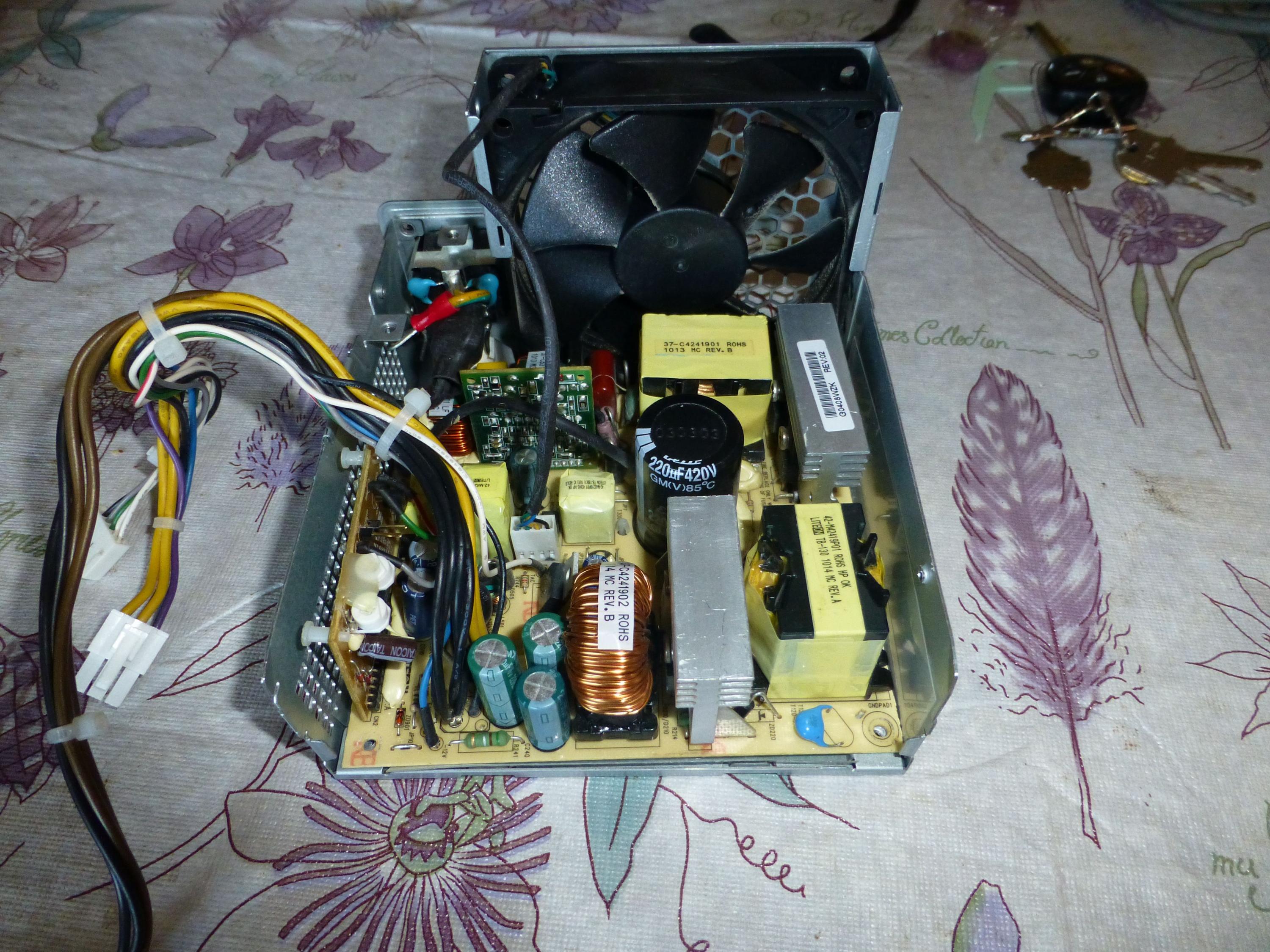

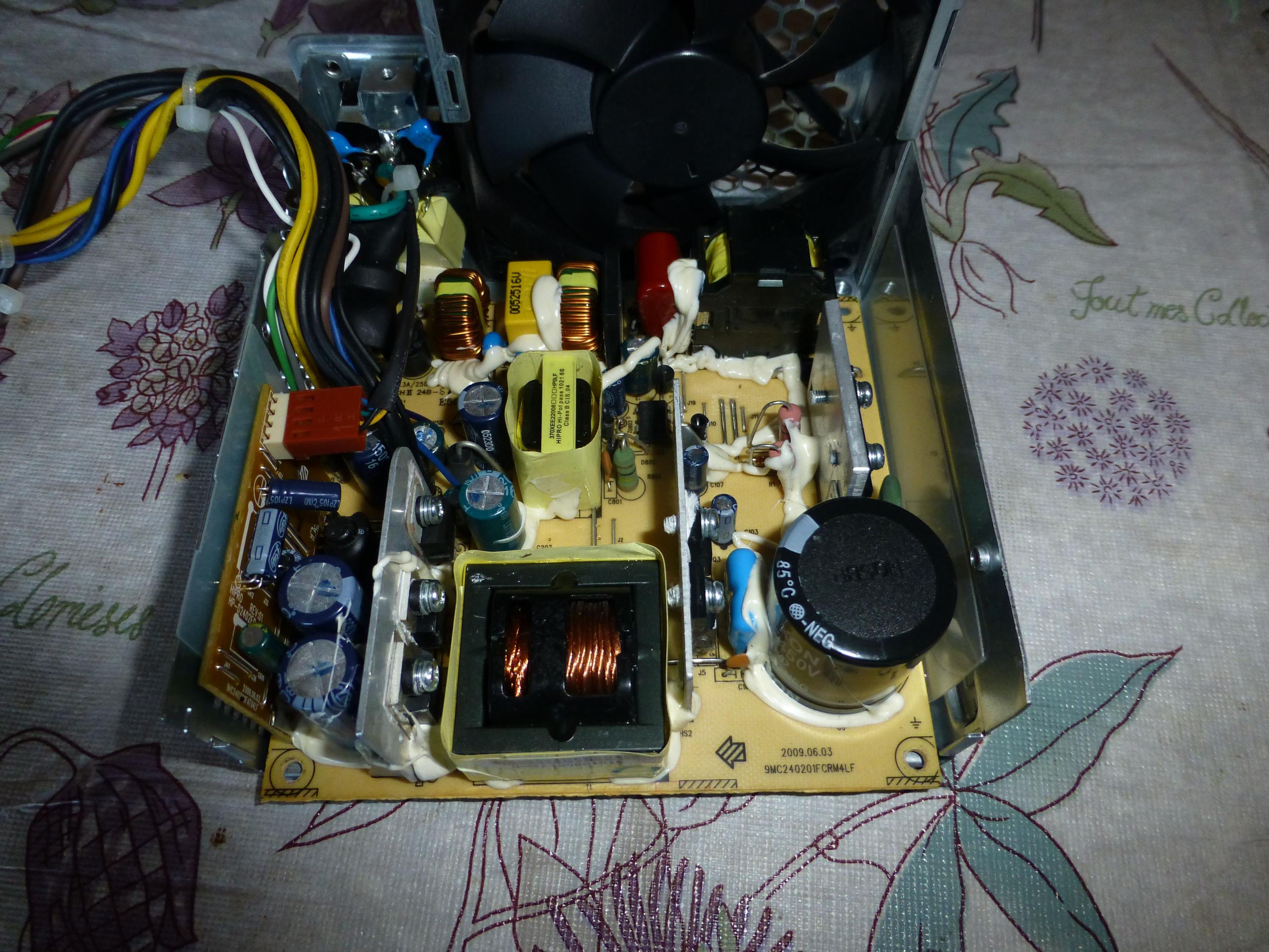

      Your pics are of PSUs from 2 different vendors. If I'm reading the transformer markings correctly, one is from Hipro and the other from Lite On. The pictures you posted do not show the components in question, so I suggest pictures of where Q210, etc., are located.

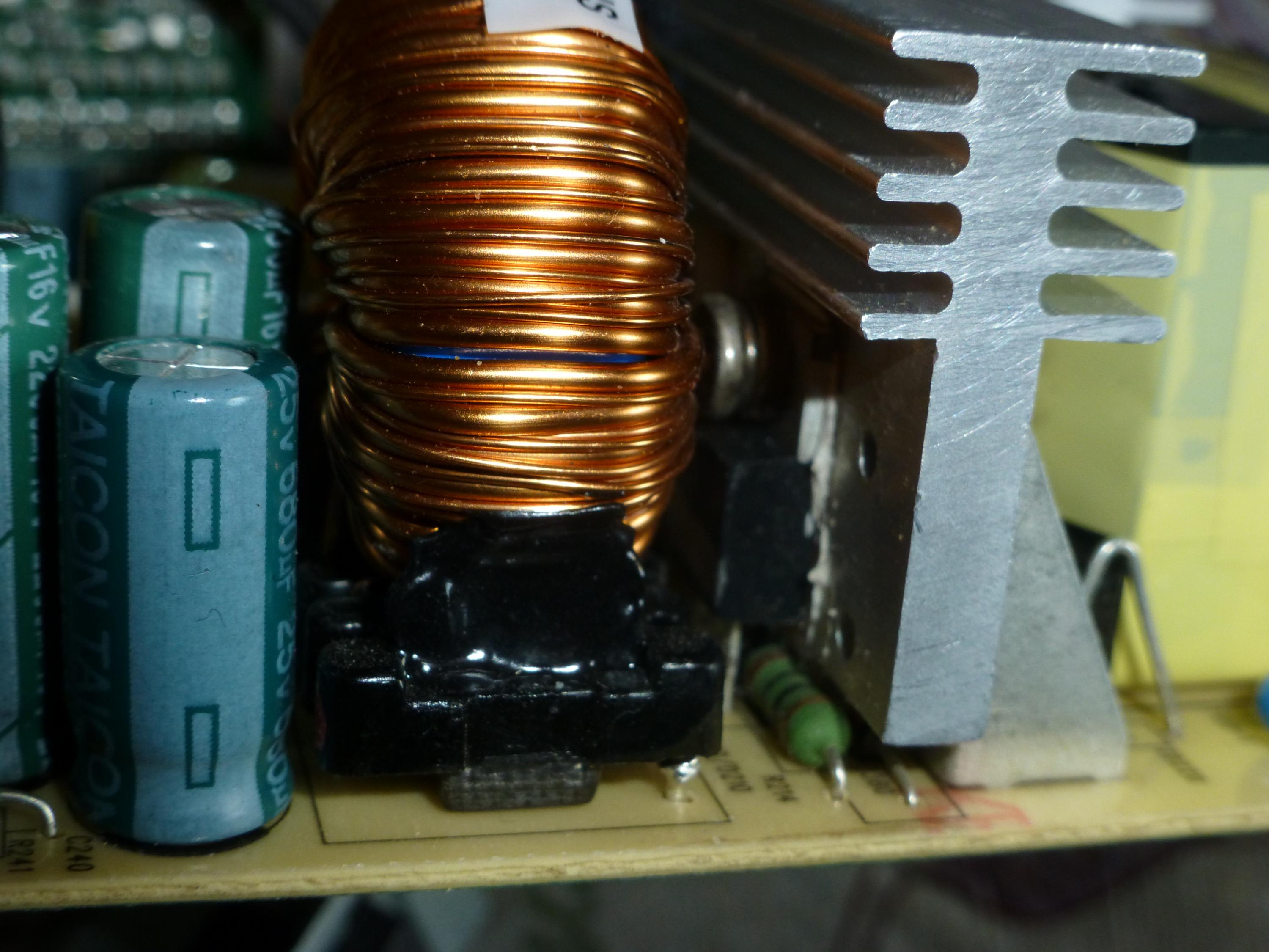

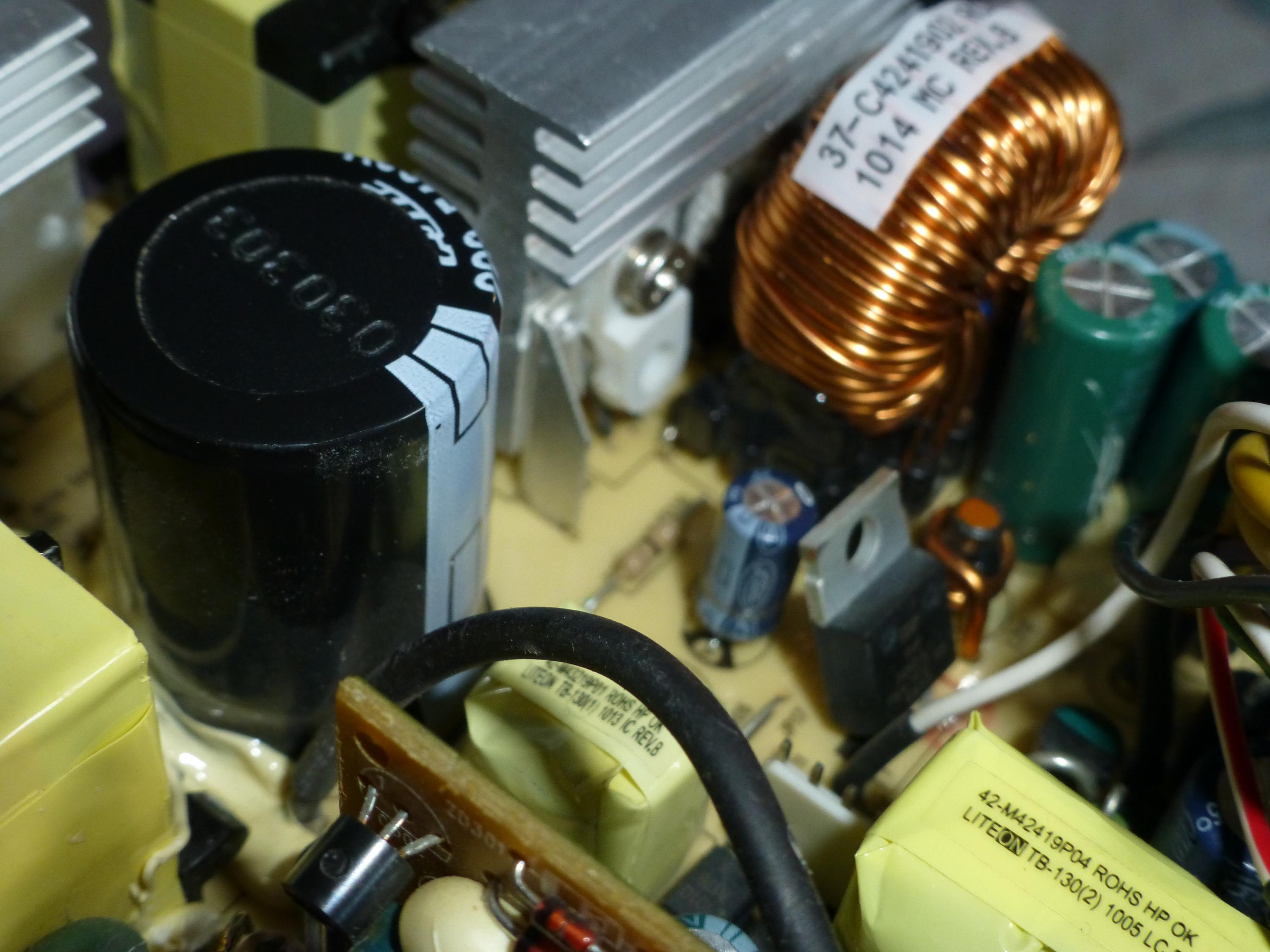

        yes there are 2 different the PS-4241-9HA is the one with RT900 and RT901
        Difficult to show them in a photo see photo PS-4241-9HA they are on the heat sink at the front of the board between the transformer and the coil. Here are some close ups.
        The white one is RT900. both RT900 and Rt901 test open.

              The HiPro probably had bad caps if the system was boot-looping. I see some Teapo and LTec caps, which are always a cause of concern.
              As for the LiteOn... could be bad caps again or it could be something else too.

              Regarding RT900 and RT901: sounds like these are thermistors or fusible resistors. I'm having a hard time seeing where these are located in your pictures. But their location could give an idea of what they are used for (i.e. weather they are on the primary or secondary side).
              Yup.
              You can usually tell from the model numbers too. HiPro PSUs typically begin with "HP" and LiteOn with "PS-". And Delta Electronics (another major PSU OEM) usually starts with "DPS" (on "NPS" in case of Newton-built PSUs).
