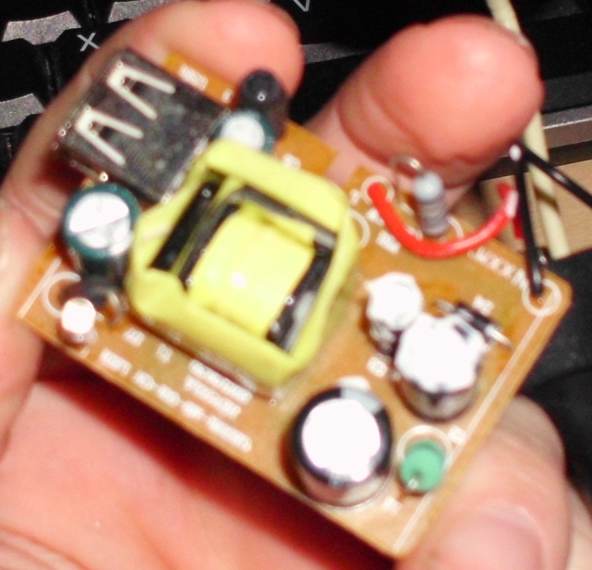

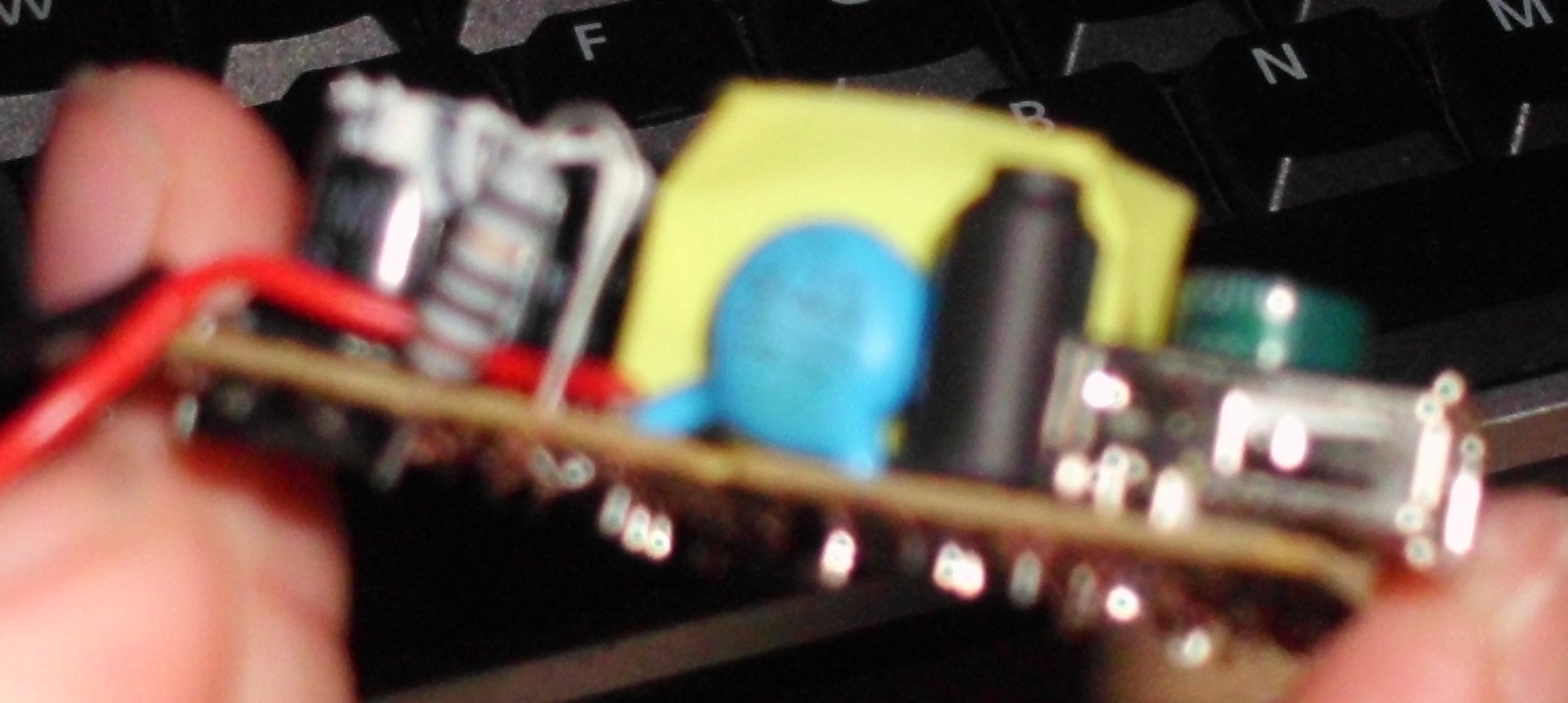

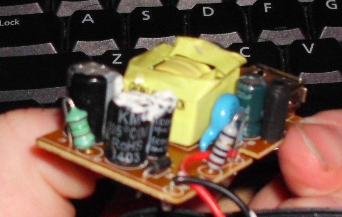

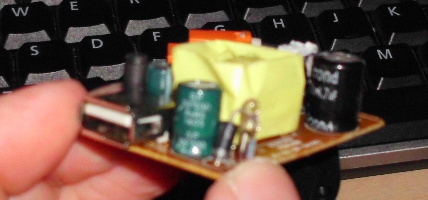

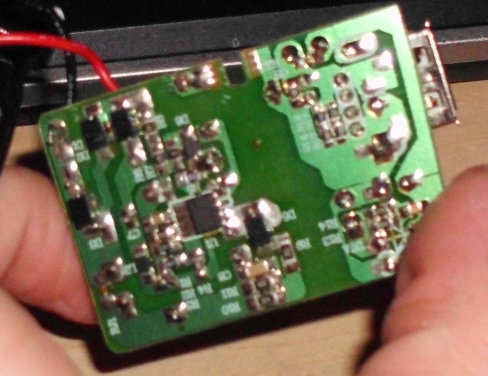

    Is this thing a sh*t bay charger
    This a 5V 1A power supply i am using to run a raspberry pi zero (my thermostat), i am gonna guess and say i am using around 300ma
    (Pi zero v1 headless, upto one 5v relay, upto one bright led, usb wifi)
    I noted this on the caps
    *width x height
    • 400v 4.7uf 10x13
    • 400v 4.7uf 8x12
    • 50v 4.7uf 11.5x12
    • 10v 680uf 8x12
    • 10v 220uf 6x11
    the caps appear to have a brand name and actual part numbers
    1. is this thing a POS?
    2. it has a hideous blue led (took this opportunity to hide it inside the brick)
    3. it has a very audible coil wine
    Sorry for camera blur

        Re: Is this thing a sh*t bay charger
        It's not total crap but I don't see an opto-coupler for voltage feedback and only one mains rectifier diode (1/2 wave) with 4.7uF cap, so I would say it's not a great design.
        It would have mush voltage regulation on the 5V and the slightest hiccup on mains would reboot your RPi, this PSU has no "hold time".
