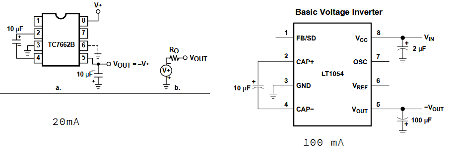

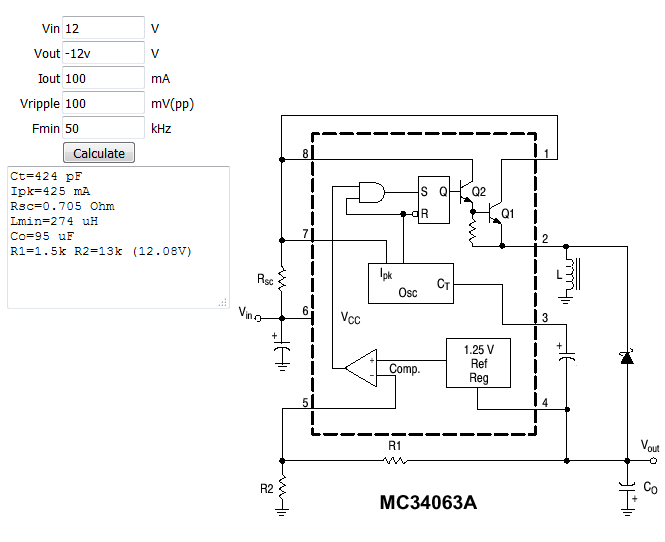

                      • mariushm
                        • May 2011
                        • 3799
                        Re: -12V-less HP server unit: does majority of current boards even require the rail?
                        You can make a small circuit with a MC34063 switching regulator, or with a voltage doubler/inverter to create -12v from 12v ... you only need a few mA since pretty much nothing uses -12v these days.
                        • Behemot
                          • 4845
                          • CZ
                          I know there are al-in-one regulators, but I just wonder whether it is worth it - seems that there are many boards to choose from which don't need it
