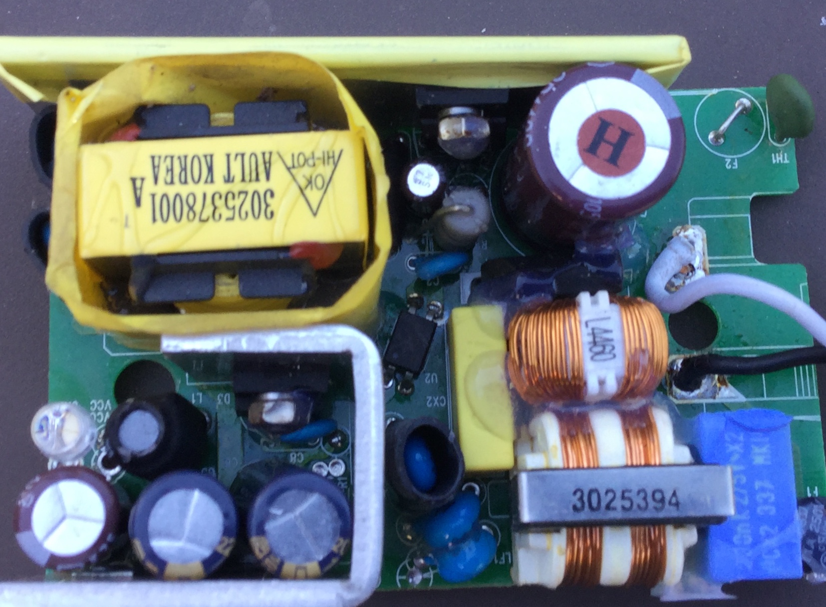

    This power supply run some white LEDs flood light in the front of my yard
    This power supply has been in use for about 4 to 6 years until we had a bad thunderstorm which mess up a lot electronic devises which cost me about $1000
    to replace
    This power supply did not escape it vengefulness of that storm
    I would like to try to fix it I can not find this size power supply in this foot print any more
    It fits in a power supply box that was made by Malibu lighting company it nice and small with a photo cell all ready there
    The problem with power supply is that it come ON for a second then goes OFF for a second and keeps repeating
    The optic sensor was blown to pieces replace it and recap it except the main cap
    Right next to main filtering cap there is a device that 4 pins but I can not read the numbers on it but I think that it must be the switching regularlator IC chip
    I have another switching power supply that is the same exact model that works fine I can read the numbers on that if I take out filtering cap again which I can do
    Any one have any ideas where to start

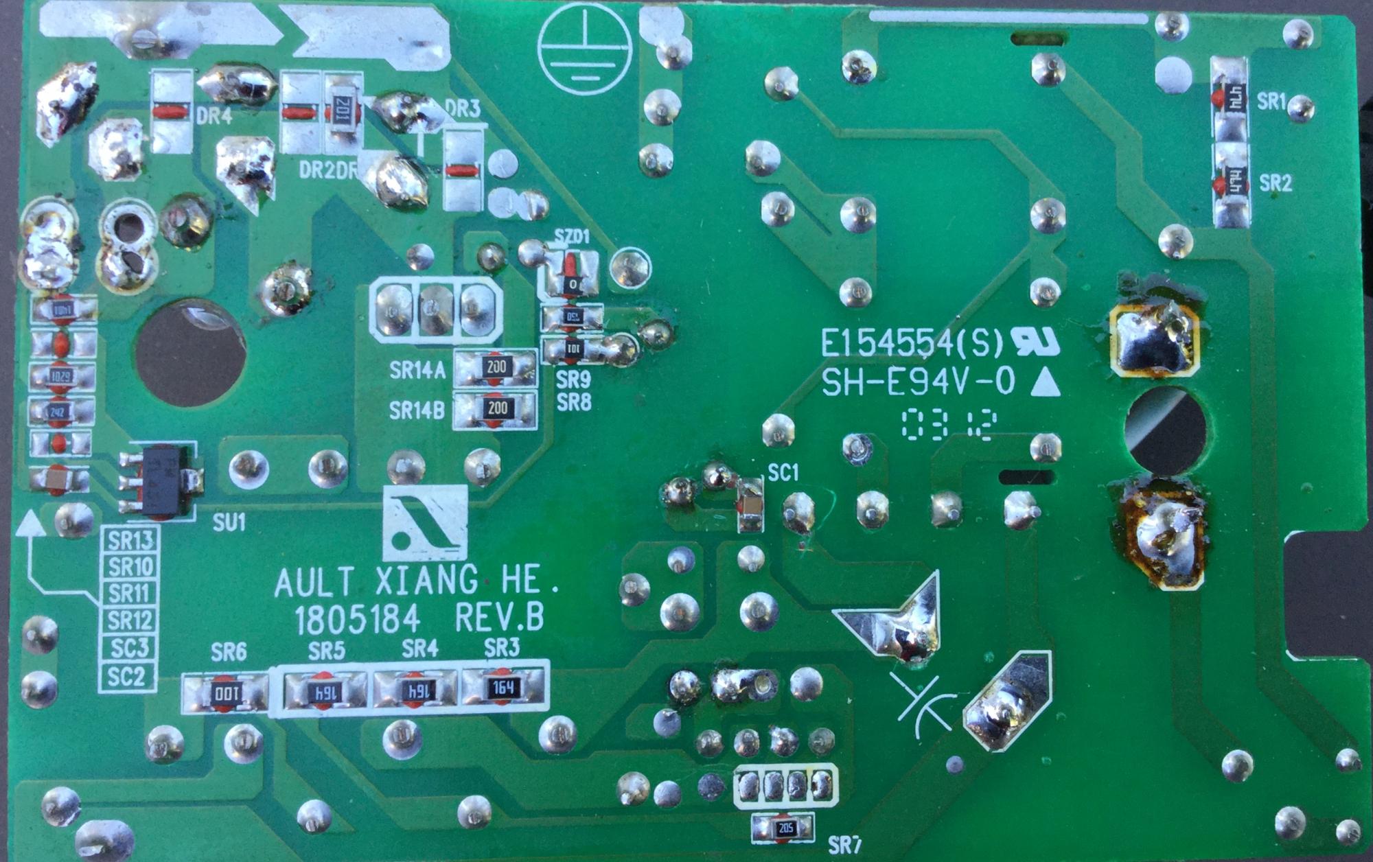

    check resistor SR9 on the bottom of the board.

      Thank you for pointing me in the right place on this board
      SR8 = 101 which should be 100 ohms reads a lot higher that in either direction
      First thing I am going to do is replace this resistor
      SR9 = 705 which should be 7 megohms it more like 11.34 k ohms in either direction
      Take this one out and recheck it
      SDZ1 if this one is a diode in one direction it reads .856 in the other direction
      It reads 1.67 volts in diode test mode
      If this is a resistor with a value of “0” it is not reading “0” ohms not even close kohms range
      (it looks like there maybe another digit but the solder is in the way)
      I will have to see if this component has a line or a dot on it ones I have taken it it out
      If it turns out to be a resistor it get replaced with another “0” ohm resistor
      All of these reading are all mess up

        Replaced the “0” ohms
        Now it flashes slower and little bit brighter but still dose not work right
        I going look up the four terminal device and see what it is and probably replace it

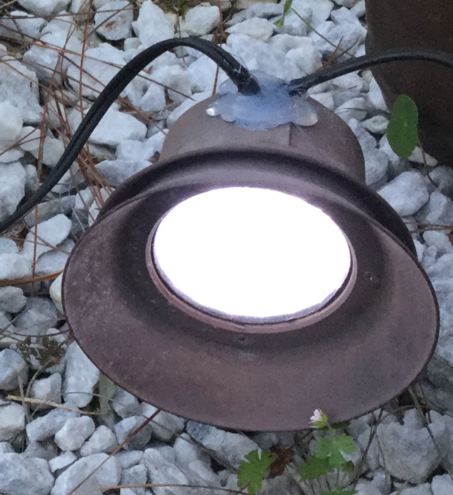

                Here is a photo of the flood light
                  Re: Ault Power Supply 3 volts @ 5 amps one second on one off
                  LED is current device, you should regulate the Current flowing through the LED and run it at less than the max current spec. The Vf of the LED varies with temperature and the amount of current flow through it.

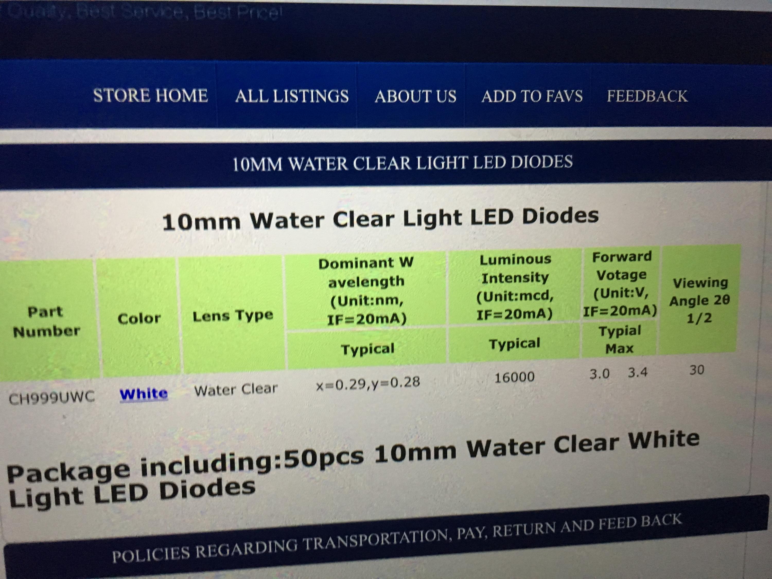

                    Here is the specks for these LEDs
                      It does not show the max current rating?
                      The spec is showing what the Vf will be at forward current of 20mA, the Vf varies with the amount of current. 20mA white LED is way too low to be used for flood lights, there are missing specification for that LED. I expect it to be 200~400mA range to be used for lighting application.

                        I was not looking for high out put LED for this application I was wanting some thing that look like flood light but was not high output just to light the walk way

                            The 4 pin device is a switching power regulator
                            Part number is
                            KA5M0265R.
                            It is a hard to find I can get them from a company in Miami Florida (they have an eBay
                            https://www.ebay.com/usr/dalbanicorporation )
                            web page it been a long time since I have bought anything from them but they carry hard to find parts

                              Power supply UpDate
                              I had two these power supply’s that did not work
                              Power supply number 1 the one I posted still does not work with the new switcher IC chip
                              Power supply number 2 this one blew the main fuse this is the one I took the switcher IC chip and put in power supply number 1 and fire works came out the bottom of the power supply switching regulator IC chip but did not blow that fuse
                              Put a new power supply switching IC chip and this power supply number 2 works again
                              So now I have to figure out what wrong with power supply one that I posted on this post
                                Technically you are right, but in this simple case the small variation in Vf is irrelevant.
                                the 20mA white LED is way too low to be used for flood lights,
                                not if the light is composed of an array of LED's, which it is according to the descriptions so far.
                                Anything above continuous 100mA in one LED is called high output and is manufactured with integral heat sink. I don't think this simple light uses special hi-watt units, but rather an array of series/parallel LED's running a typical 20 mA value (still no exact information). Let's just say that 20mA would be a good safe starting guess to get everything working before thinking about hitting them with more current. Reading just one of the LED's with the meter on diode mode will give you a working practical value for the Vf of one LED. I suggest powering the lamp with a small variable supply to find the required drive voltage.
