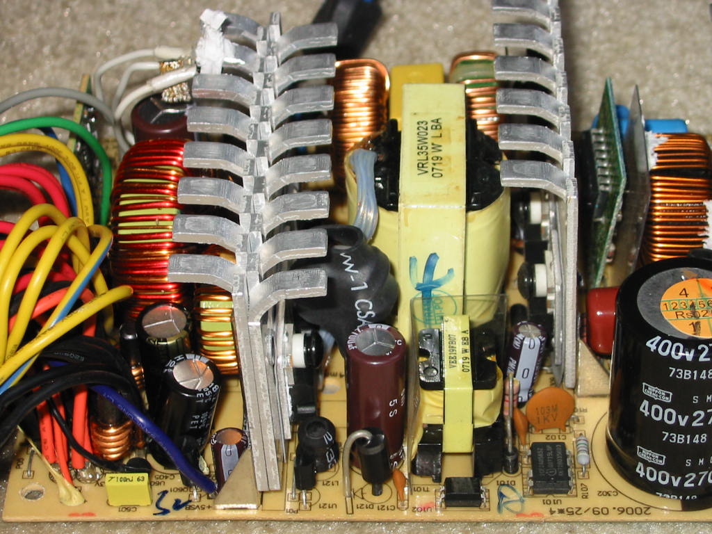

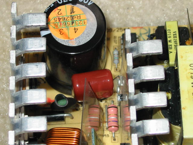

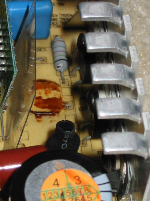

          Obviously I found the -12V & +12V OST capacitors swollen and PCB area around Q901 heated.
          The power supply didn't cause me any problem so far. But since I planned to increase load by adding a supplementary HDD I said that will not hurt to do some checking&cleaning. Now it seems that I will need to do a full recap.
          My question for you all is:
          - Do you think it is a good ideea to install two capacitors in paralel on the +12V rail instead of 3300uF/16V?
          For example 2x2200uF or 3300uF+1500uF.
          Do not worry about space. I intend to remove all components from FAN circuit (Q901, U901, fan connector, etc.) I will use a FAN powered from outside the PS, from MB connector. This way I will have a better control to FAN speed and eliminate one source of heat near those two capacitors.
          By the way, replacement capacitors will be Panasonic FM/FR series.
          Thank you!

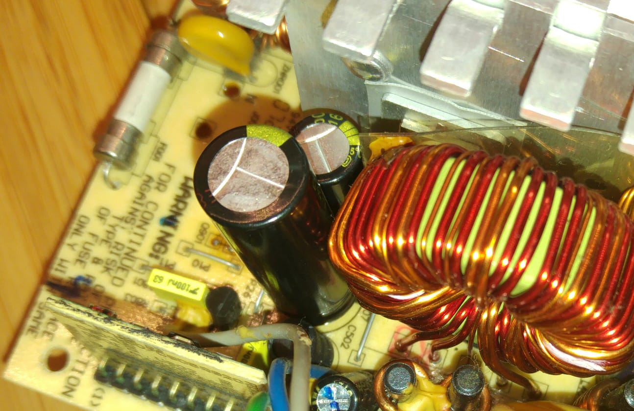

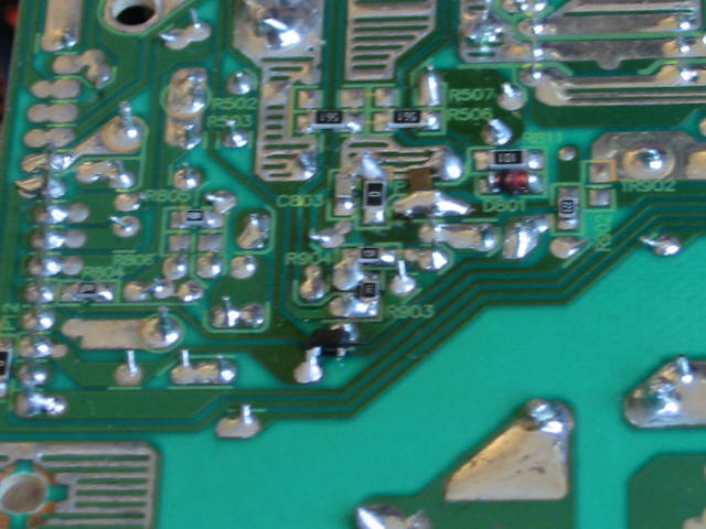

            Re: Antec EarthWatts EA-430 and EA-500 – an easy bad caps fix
            This way looks the affected area...
              If it is one of these older platforms with only single large cap, I usually replace it with single NCC KZN 3300/16, that one is superior enough to be a good upgrade

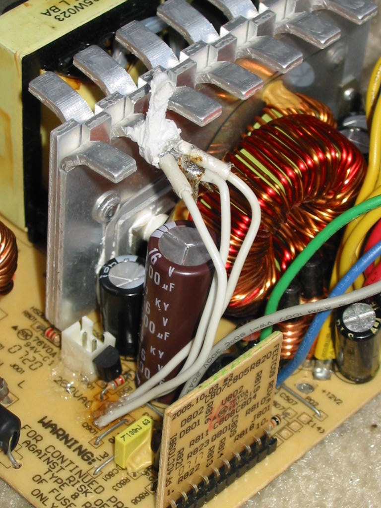

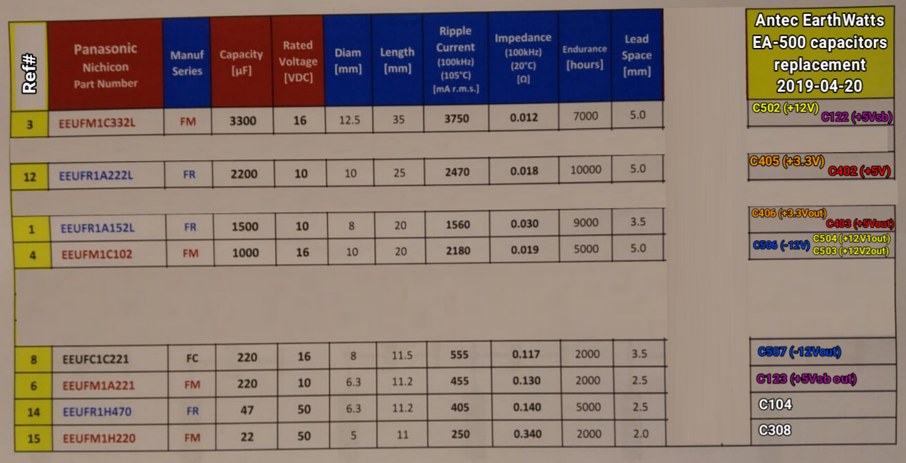

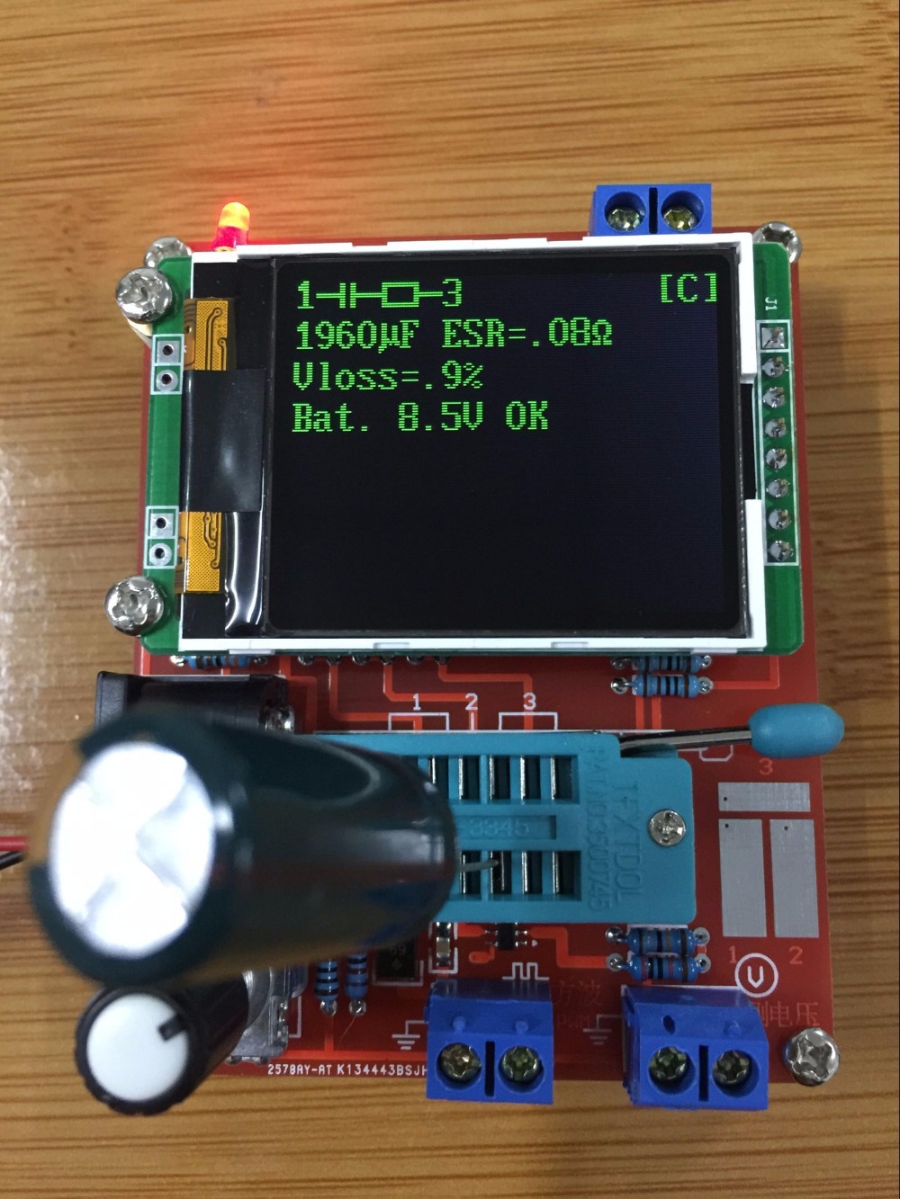

                            Today I succesfully replaced all electrolitic capacitors from my EA-500 PS, with one exception: Hitachi HP3 330uF/400V/85°C.
                            I've made a small drawing with all capacitors and the coresponding number found on PCB.
                            I also attached a list with the exact Panasonic Part Number that I used as replacement.
                            Things that deserve to be Noted:
                            - successfully installed a 3300uF/16V/12.5x35mm into +5VSB rail;
                            - the first capacitor on - 12V rail is now better than original OST RLS (Panasonic FM 10mm);
                            - successfully installed 10mm diameter capacitors on 12V1 and 12V2 outputs;
                            - 3.3V and 5V outputs have now 1500uF/10V/8mm;
                            - I removed from PCB: Q901, U901 and Fan connector;
                            - I installed first capacitors on - 12V and +12V slightly tilted in order not to be in direct contact with the big coil that can get quite warm when the PS is running.
                            - replaced original ADDA fan with Noctua NF-A8 PWM in order to have better control to fan speed and indication. Original fan seems to me that is spining quite slowly when the PS is working. Not to mention about hot spot around Q901.
                            Momaka, thanks for the advice!
                            Maybe I will let Noctua Fan run at full speed. I can barely hear it.

                                Also, the weird noise I mentioned in post #16 that I thought the big cap fixed - nope, it's still there, and usually much louder when the PSU is cold than when it isn't. In fact, the noise, when PSU is cold, is almost as loud as the fan in the PC it is in (and that PC has considerably loud fans.) What are the chances that some of the 1000 uF OST RLS caps on the 12V rail or 5V and 3.3V rails are bad? Who knows! Could also be the APFC coil being a bit loose. On the EA-430, it was very lose and covered in brown conductive glue. I removed it on that PSU, cleaned the glue, and then put it back in and glued back tightly with silicone. So maybe that made the difference. But on the EA-500, I hardly see any conductive glue on the APFC coil. Ah well... will pull it out probably some sunny day in the summer when it gets too hot in my house to run the Q6600/GTX560 rig.
                                It is quite weird with that noise that you described.
                                What I can say about the output capacitors removed is that they are quite ok regarding their values (after 22000 hours, on my PS):
                                C406 = 1028 uF (+3.3Vout)
                                C403 = 1025 uF (+5.0Vout)
                                C504 = 909 uF (+12V1out)
                                C503 = 916 uF (+12V2out)
                                So I will not bet that the weird sound is due to those.
                                Anyway I intend to test all of them more proprely when my multitester with Atmega328 will arrive.
                                Regarding the APFC coil, you are refering to the big one? Because I saw a smaller one with two types of wires near that area (see attached image).

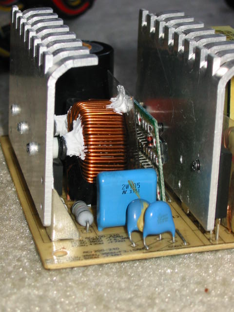

                                  The smaller one is actually a driver transformer for the upper MOSFET in the 2-transistor forward topology of the main PS.
                                  On my EA-430, the APFC coil was quite loose, so I actually unsoldered it, cleaned the conductive glue from its turns and bottom (for some reason, it had a lot, whereas the EA-500 didn't seem to have almost any), then isolated with tape and glued back with silicone glue. So it's possible this actually might be the reason why my EA-430 is quiet and the EA-500 isn't.

                                    By the way, is that one of those multi-function "transistor testers"? (The ones that also test ESR, have frequency gen, and etc.)
                                    I'll do that. I will come back with full details. I intend to compare the extracted capacitors with the replacements used (I have some from the same batch).
                                    Yes. It is a multi-function "transistor testers".
                                    What I have ordered is called: "2018 V1.13 English DIY Mega328 Transistor Tester LCR Diode Capacitance ESR meter PWM Square wave Frequency Signal Generator".

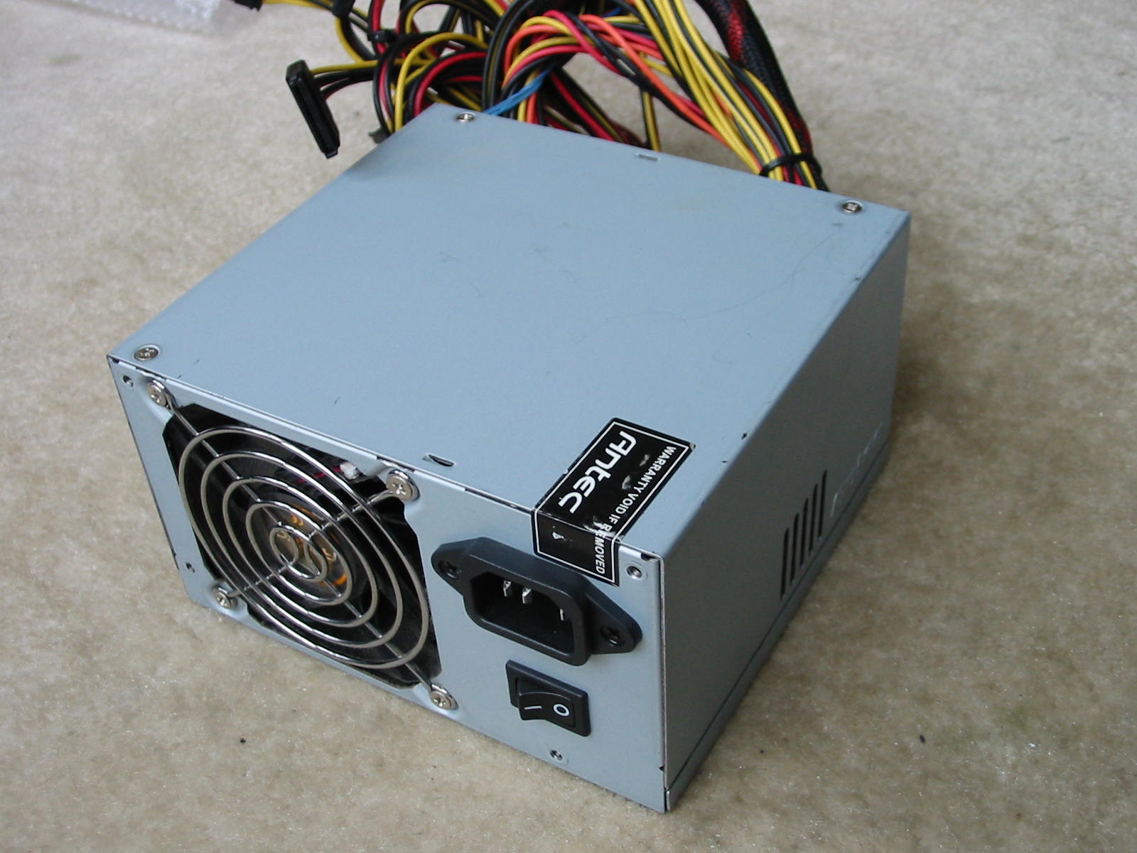

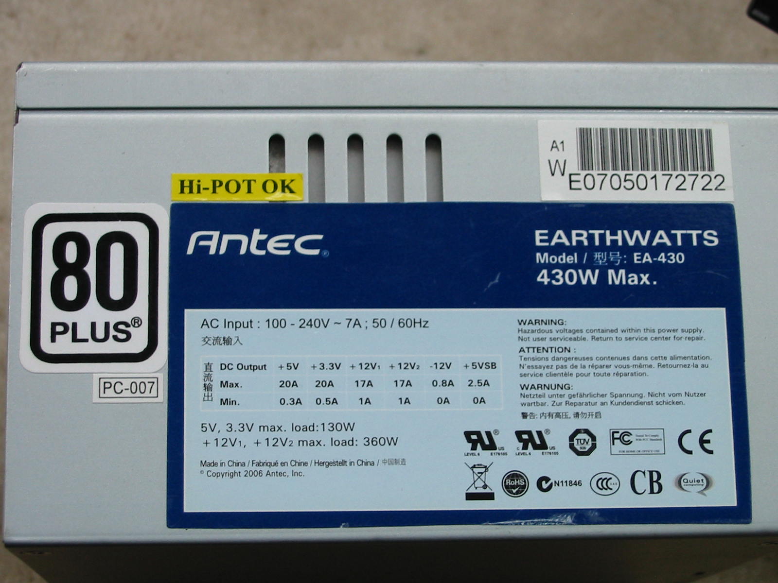

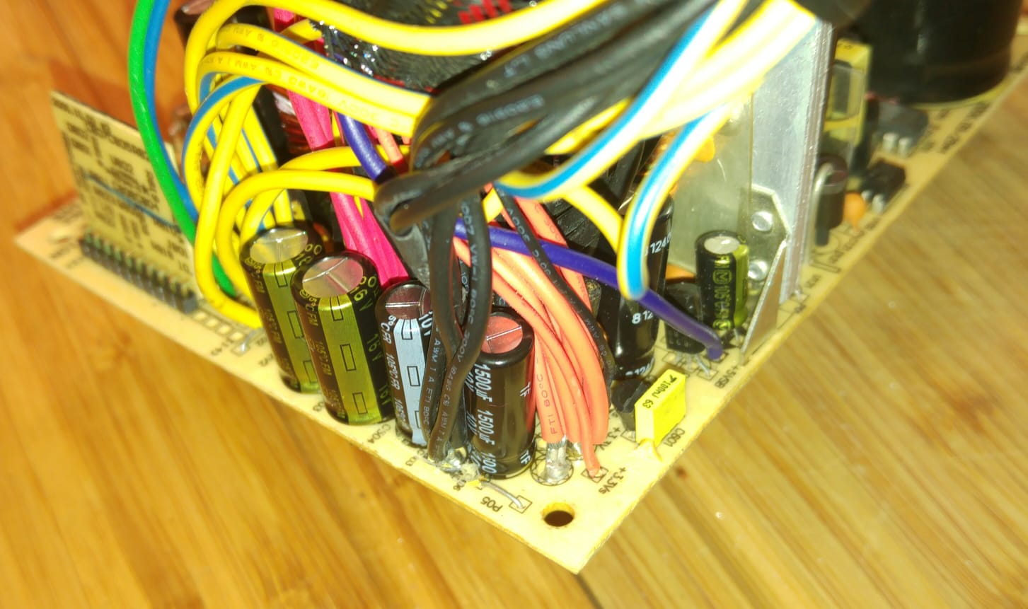

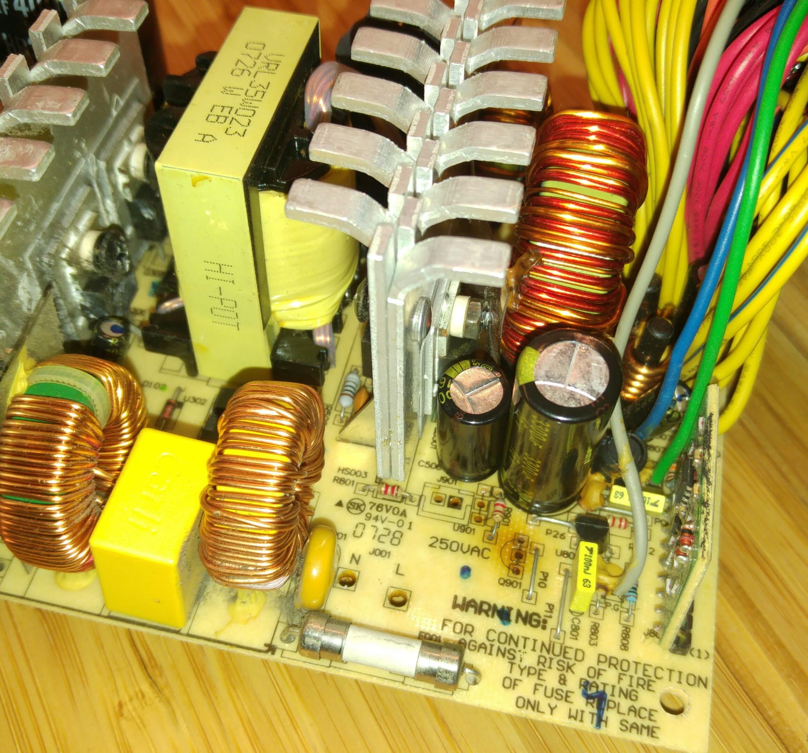

                                      Antec EarthWatts EA-430 - build quality
                                      Hmm… looks like I never really posted pictures of the EarthWatts EA-430 power supply that I've been talking about in this thread. OK, here it goes then.
                                      This one was also a cheap eBay purchase from way back when (for like $1 for the PSU and $8 S&H.) Not bad, considering these are pretty decent PSUs. It's essentially an EA-500 with slightly downsized components in some areas… but mostly the same thing inside. On the outside, besides the label (being blue instead of brown/burgundy), the only other notable difference is the lack of a 2nd PCI-E 6-pin power connector, which the EA-500 has.
                                      Case pictures:

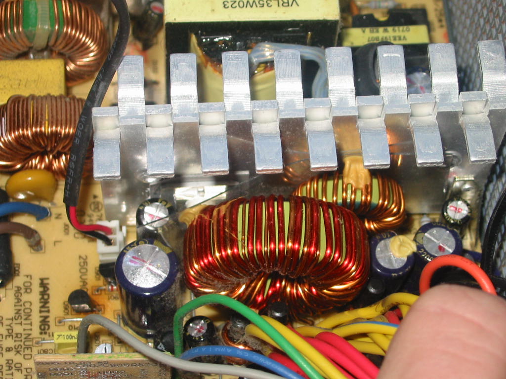

                                      Now moving onto the insides… again, it's almost the same as the EA-500 PSU shown in post #1. Probably the biggest difference is the size of the primary capacitor - the EA-500 has a 330 uF cap, while the EA-430 has a 270 uF cap. Both are rated for 400V, though, which isn't optimal IMO due to the APFC circuit's high-running voltage. But I did an experimental add-on/mod on this one that I will get to a little later below. Also, another difference is that the EA-500 has 2x PV218N50 MOSFETs whereas the EA-430 has 2x FOP 13N50G MOSFETs (with the former supporting up to 18 Amps continuous and 72 Amps pulsed vs. the later only being capable of 13 Amps continuous and 52 Amps pulsed.) And lastly, the EA-430 doesn't have that weird factory “flying” cap-resistor mod/fix on the optocoupler of the 5VSB circuit that the EA-500 does. Everything else appears to be pretty much identical. But here are pictures of the EA-430, just for the heck of completion:

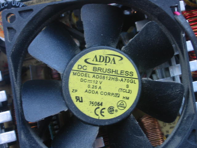

                                      Also a picture of the fan, since I didn't seem to include one with the EA-500:
                                      It's an ADDA AD0812HS-A70GL rated for 0.25 Amps @ 12V.
                                      Apart from this, there's nothing new to add for the build quality here. So below is just a parts summary before I jump into the mods I did on this PSU. Actually, there is one typo in post #1, which is why I am including the summary again. It has to do with the 12V rail's recitifiers: I said there's only one 30 Amp rectifier on the 12V rail in post #1, but there are actually 2x 30 Amp rectifiers in parallel.
                                      Primary Side Summary:
                                      - EMI/RFI: four 2.2 nF Y2-class caps; two Carli X2-class certified caps (0.22 uF + 0.47 uF); three common-mode chokes
                                      - GBU806 bridge rectifier (8 Amps @ Tc = 100°C, 600 V reverse voltage)
                                      - PFC section: 1 uF 450V film cap after bridge rect., 2x PV218N50 MOSFETs, one STTH8506d diode, one 1N5406 diode
                                      - Main filter cap: one United Chemi-con SMQ, 400V, 270 uF, 25 x 35 mm (dia. x h)
                                      - Main PS topology/design: double-forward with 2x FOP 13N50g MOSFETs
                                      - Transformers: main with 35 mm core and 5VSB with 19 mm core
                                      - Input wire: 16 AWG, 300V for Live/Neutral and 18 AWG, 600V for ground

                                        Antec EarthWatts EA-430 – recapping and modifications
                                        And now back to how/why I got the EA-430 PSU for cheap: it had the same issue as the EA-500: bad caps on the output. Actually, my EA-430 had only one bad cap - the 12V rail's OST RLX 3300 uF filter cap. Also, IIRC, the 2nd output filter cap on the 5VSB (OST RLS 16V 220 uF) was starting to go slightly high ESR. The other capacitors still appeared OK. And the few that I pulled out for a pre-emptive recap (2x OST RLX 2200 uF) tested OK as well, including the primary cap.
                                        Therefore, the first order of business was to recap the PSU, which I did in a similar fashion as the EA-500: use whatever low ESR caps I had on hand that were “relatively” close enough. As such, I didn't replace the 8 mm OST RLS caps right before the output wires - these all appeared OK and so far have been holding up OK in the EA-500. I don't see a reason why they wouldn't in the EA-430 either. Below is a summary of what was replaced:
                                        12V rail: 1x OST RLX, 16V, 3300 uF ---> 1x UCC KY, 16V, 3300 uF
                                        -12V rail: 1x OST RLS, 16V, 1000 uF, 8mm dia. ---> 1x Rubycon YXJ, 16V, 1000 uF, 10 mm dia.
                                        -12V rail: 1x OST RLS, 16V, 220 uF ---> 1x Rubycon YXJ, 25V, 220 uF
                                        5V rail: 1x OST RLX, 10V, 2200 uF ---> 1x Panasonic FM, 6.3V, 2200 uF
                                        3.3V rail: 1x OST RLX, 10V, 2200 uF ---> 1x Rubycon ZLH, 6.3V, 2200 uF
                                        5VSB rail: 1x OST RLX, 10V, 3300 uF ---> 1x UCC KY, 6.3V, 2700 uF
                                        5VSB rail: 1x OST RLS, 16V, 220 uF ---> 1x UCC KY, 10V, 220 uF
                                        And of course, I also changed all of the small caps on the primary side with equivalents from Nichicon, Panasonic, Rubycon, and/or UCC. Picture of the recap:
                                        Another noteworthy change, as is already shown above: “securely” mounting the series regulating transistor for the fan onto the secondary heatsink to allow it to dissipate heat better/easier. Of course, I still don't know how thermally-overloaded this transistor may be. So just like with the EA-500, I added a small diode between the 5V rail and the positive (+) lead of the fan to feed it 5V when the fan is operating at minimum speed (and in case the series transistor fails open-circuit.) The modification can be seen here with a SOT-23 diode:
                                        This wasn't the only modification I did, however. Another one is when I was changing the small 220 uF output cap on the 5VSB rail - I couldn't bend the leads on the cap enough to make it fit due to using a recovered capacitor from an Xbox 360 motherboard. Therefore, I made my own hole in the PCB to make the cap fit.
                                        While messing with these small “dinky” mods, I noticed something a lot more concerning – the APFC toroid inductor was a bit loose and the tan glue on it had turned quite dark / brown.
                                        After removing it for closer inspection, I found something even more concerning:
                                        The APFC toroid had started to chip away at the insulating coating of its current sense resistor next to it. This could surely result in bad news for the APFC circuit if a winding on the inductor shorts to the resistor.
                                        So this certainly needed addressing. First, I removed as much brown/conductive glue as possible. Next, I unwound several turns on the toroid to remove more glue and added electrical tape between some of the windings before winding them back on. This was done in order to (hopefully) better protect against turns shorting. The crap glue had already started to tarnish the insulating coating slightly on a few windings. After all this was done, I put the APFC inductor back in and secured/glued it with regular household bathroom silicone/caulk both on the bottom and the top (to the case of the APFC MOSFETs.) Obviously regular silicone isn't ideal for this application either (due to slight acidic off-gassing when curing)… but beats cheap crap conductive glue ANY DAY!
                                        Needless to say, I tested the PSU on its first power-up with a 500 Watt heating element in series with the AC input, just in case I goofed up somewhere on the “repair” of the APFC inductor. However, all was well and the PSU worked fine.

                                        Well, remember how I mentioned the APFC putting extra stress on the primary cap because of the high voltage and high frequency? I've had this idea that perhaps putting in a film cap could help it deal with some of the HF ripple – or so I'm hoping. Actually, recently I opened a Delta/Newton PSUs for a Precision T7400 tower, and it also had a film cap in parallel with the two primary caps… which I think gives “my idea” more credibility. And so what did I do? Exactly this – I put a Panasonic 450V 2.2 uF polypropylene metal film cap in there.
                                        And here it is all soldered up on the bottom:
                                        As for how much this is going to help ease off ripple current from the primary electrolytic cap – this I don't know. I'm just trying to prevent something like this from happening:
                                        https://www.badcaps.net/forum/showthread.php?t=37779
                                        Moreover, even in the even the primary cap fails open-circuit, I think the paralleled film cap could/should still provide at least some form of a low-impedance path to ground so that the energy stored in the APFC inductor doesn't do a crazy voltage shoot-through and break down primary silicon… or so is my theory, anyways. I guess we will have to see it in practice, which will be who knows when. I don't have this modification/addition in the EA-500, but that one also has a noisy/whining APFC already, which worries me a little. On the other hand, the EA-430 was quiet before and still is quiet after this add-on. So at the very least, I'm sure my add-on / modification is not hurting anything… except possibly my wallet with a few extra cents (or so at the time of buying these Panasonic PP film caps… now they are over $1 and regularly out of stock on Digikey.)
                                        And this concludes just about everything I have done to the EA-430 and EA-500 PSUs. For the EA-500, I might swap the 3300 uF KY cap on the 12V rail with a KZE, just for the slightly more appropriate ESR. The 3300 uF KZE is currently sitting in an old Inno Power PSU (by Macron Casing) that doesn't need anywhere that kind of low ESR on its output. It's been working OK with it… but is just not needed there. This will be work for another day, though. I'm just mentioning it in case anyone wants to recap one of these EarthWatts PSUs, since the KZE is probably closer in terms of ESR to OST's RLX series than KY (though the difference between KZE and KY isn't that big – just 5 milliOhms.)
