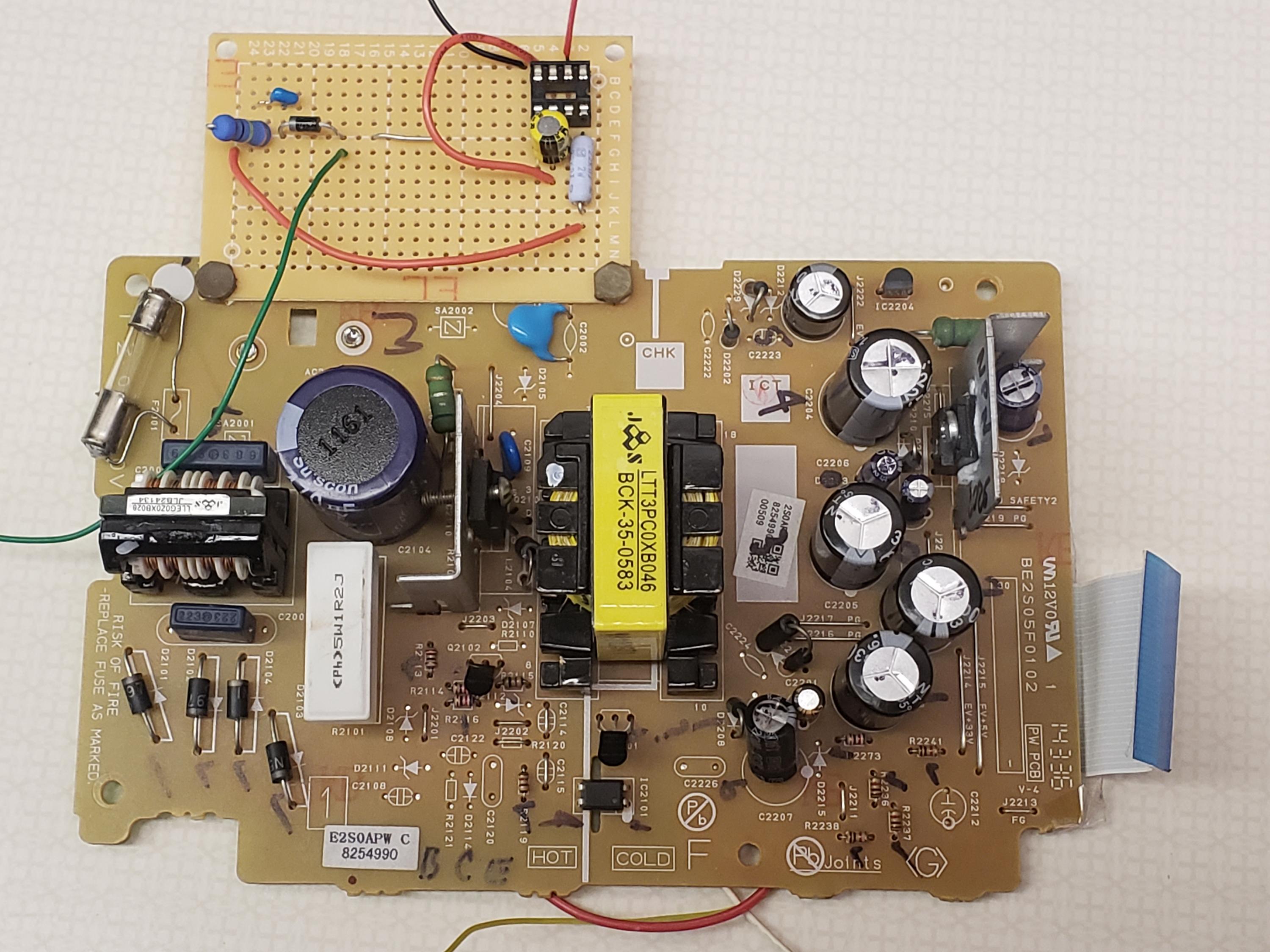

              #146
              Re: Magnavox DRV power supply SMPS
              frankenboard
                master hoarder
                • May 2008
                • 12164
                • Bulgaria
                #147
                Originally posted by johnfin
                frankenboard
                Not bad, though.
                Just try to keep most wires as short as possible. Also, maybe make the grounding wire a bit thicker. Other than that, looks ready for a test, I suppose.

                  #148
                  So for our first test am I leaving Q2101 and R2234 as original?
                    master hoarder
                    • May 2008
                    • 12164
                    • Bulgaria
                    #149
                    Yes, let's try everything original and see what happens.

                          #152
                          Well it went up in smoke, or at least the ncp1200. Turned it on, light came on full brightness, then a pop and smoke. Chip was hot so I assume its bad. Any way to check it? I will triple check the wiring again.
                            master hoarder
                            • May 2008
                            • 12164
                            • Bulgaria
                            #153
                            Time for an autopsy and circuit adjustments then.
                            The only way the NCP1200 chip can go bad is if the main switching transistor Q2101 or its source resistor R2108 are bad (Q2101 with short-circuit between Gate to Drain/Source or R2108 open-circuited). So remove Q2101 and R2108 and check them.
                            That said, if the NCP1200 looks overheated even a slight bit, it's better to replace it. As I suggested earlier in the thread, when building these kinds of mods, it's a good idea to get *at least* two of these controller and any other specialty parts. That way, if one blows up, you won't have to wait again (and pay for shipping again) for the part to arrive.
                            Also, I now see there are a few possible improvements we can make to the circuit - particularly in protecting the NCP1200 chip. Since its Vcc is rated for up to 16V max, limiting the voltage on a few of the signal pins to 15-16V should work to protect the IC - that would be the CS and DRV pins. In addition to that, maybe replace R2108 with a 1 to 1.5 Ohm, 2W resistor (flame-proof metal film or fusible type of resistor only). This will set the over-current protection to a lower level, so that the NCP1200 chip will self-limit sooner. And lastly, in order to further protect the NCP1200 from the main transistor, Q2102, you could build the driver circuit show in Figure 26 ("Improving Both Turn-On and Turn-Off Times") on page 13 of the NCP1200 datasheet.
                            For starters, though, again make sure that Q2102 and R2108 are 100% good. Better yet, replace Q2102 with the new MOSFET you bought and also change R2108 with a 1 to 1.5 Ohm, 2W flame-proof resistor. Then check all your wiring again and give this another try. In particular, check the Snubber/Clamping network you built and verify that the diode and resistor in it are good (take out of circuit to verify). Detailed pictures of your complete project, before you power it on, will be extremely helpful too in order to see if there are any mistakes. And of course, do have a look at the modified circuit I made again, and make sure that your add-on board is not only wired the way it should be, but also that any other parts or paths that need to be removed from the original circuit already are. So please compare the original and modified circuits very carefully.

                              #154
                              Ok, before we dig in, I replaced the ncp1200 and replaced the mosfet with the one you mentioned before. Plugged it in and the light did not come on and no voltage at output. 120vac at input. So lets get from there and start measuring. Let me know where.
                                master hoarder
                                • May 2008
                                • 12164
                                • Bulgaria
                                #155
                                So was the original MOSFET bad as I expected? I'd like to know, as that can tell more why the circuit/mod failed. Simply replacing a part with a new one without telling us if the old one was bad doesn't always tell the full picture.
                                Also, did you check R2108 to make sure it's not open-circuit?
                                While at it, check R2101 and R2106 for open-circuit as well.
                                You should get a quick flash (even if very faint) from the bulb due to the input capacitor charging up, regardless if the PSU has any output or not.
