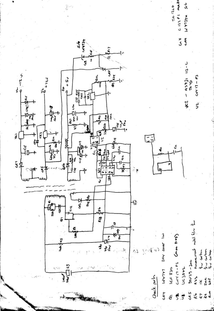

    CISCO 2501 PSU issues
    This PSU is a;
    Computer Products - NFN40-7632E
    P/N - 700184-002
    Cisco P/N - 34-0625-02 Rev B0
    Serial No. - ZKAI 1420
    Date Code - ZH22N
    Max. O/P - W
    I/P Pwr - 100-240V 0.6-1.2A max. 50-60 Hz
    Rail O/P - P1 + 12.0V
    P2 COM
    P3 + 5.0V
    P4 + 5.0V
    P5 COM
    P6 - 12.0V
    This PSU was DoA
    Checked for any opens and shorts across the PSU connector at
    the motherboard end - there were none.
    Checked for any opens and shorts across the fan connector at
    Took measurements across the PSU connector at the PSU end
    when in cct.
    When powered on, the 12V fan was ticking and moving slightly
    Measured the voltage across the +12.0 v rail and it was measuring
    positive and negative values ranging from 0.62 to 1.45V but these
    varied.
    Measured the voltage across the +5.0 v rail and it was measuring
    positive values ranging from 0.64 to 2.35V, again these varied.
    Measured the voltage across the -12.0 v rail and it was measuring
    positive values ranging from -2.31 to -5.29V, again these varied.
    Removed the PSU and opened, a number of small lytics, e.g. at the
    PWM controller were measuring high (up to 14Z), replaced all of these (3 of) with Pana FC 100uF 35V.
    Tested the ESR of the O/P filter caps - these all ok, e.g. NCC series KMH (primary) and LXF (output).
    Removed switcher and secondary ICs.
    Switcher - ST TRF8360 does not appear to have a short.
    The secondary has;
    1. 2 Rectification Diodes
    These are single package diodes (2 pin only)
    One is a Fairchild-MBR1660 for the +5.0V rail
    The other is a Motorola MUR820 for +12.0V rail
    2. Two three pin voltage regulators
    One of these is a -12.0v reg., an ST-L7912ACV for -12.0V rail
    The other is 1.5A low dropout reg., ST-L4940V12 for the +12.0V rail
    3. A Thyristor SCR, a Motorola-C122F1
    Checked the diodes for shorts - there were none
    Checked the regulators for shorts - none apparent
    Checked the SCR out of cct. - no problem apparent
    In the first instance, as I don't have a scope, I checked if
    the PWM controller (Motorola-UC3842AN) was s/c to gnd. No.
    I tested all the discretes (resistors and diodes) - these all report
    good.
    My first replacement effort was to replace the PWM controller
    (Motorola-UC3842AN as above) with a new part, an On-Semi
    UC3842BNG. I rebuilt the PSU and test the O/P voltages of
    the PSU when in cct.
    First, the fan had stopped the ticking. Measurements recorded;
    negative values (only) ranging from -0.46 to -0.8V but these
    varied.
    positive values ranging from 0.35 to 1.6V, again these varied.
    positive values ranging from -1.29 to -5.76V, again these varied.
    Odd, the +12.0V rail is negative
    Also, the regulation is not up to spec.
    Next, would it be appropriate to replace the -12.0v and +12.0V regs?
    These may be malfunctioning
    Any help and insight appreciated

    Re: CISCO 2501 PSU issues
    Hi JE,
    I used repair loads of these, I even drew out a schematic which is knocking around somewhere. All the failures I ever had were down to a specific handful of components. Here's an extract of a mail I sent a few years back.
    Anyway, as for the fixes....
    Most occasions you will find that there has been a burn up of a couple of
    resistors, not always though. This depends whether the Mosfet has gone
    s/cct or not.
    Here's a quick guide :-
    Fuse OK, whistling, change C14 47uF 50V 105c (this should be changed
    on all units as a matter of course).
    Fuse blown, also R6,CR4 Q1, U1 and possibly R13, R4, R10, U2, CR5.
    Change all parts (not forgetting C14).
    A couple of gotcha's. When ready for testing always load the 5v supply
    with about 9 to 10 Ohms and start it up with a variac if you have one or
    series light bulb if you haven't. 40W will do just for testing.
    The other one is don't be alarmed about the low resistance across the 12v
    line (CR8) it measures 90 Ohms when good.
    Depending on the source of manufacturer will depend on equivalents used
    for some devices but if you have enough faulty units you'll get to see this.
    I'll see if I can find the diagram if you haven't got one.
    Good luck
    Bob
      Bob, hi
      Y - that would be very useful
      Of the three bad PSU I have persently, they exhibit the same symptons;
      I have scketched out the O/P and have attached these.
      May prove useful to compare notes on these.
      I have also attached the check list notes.
      • midibob
        • Nov 2008
        • 285
        Here you go.
        Not very good quality but I don't have any schematic drawing software (or the time to do it). I've marked some voltages as well which you may find useful.
        I think some of your connections maybe incorrect?
        Good luck
        Bob
