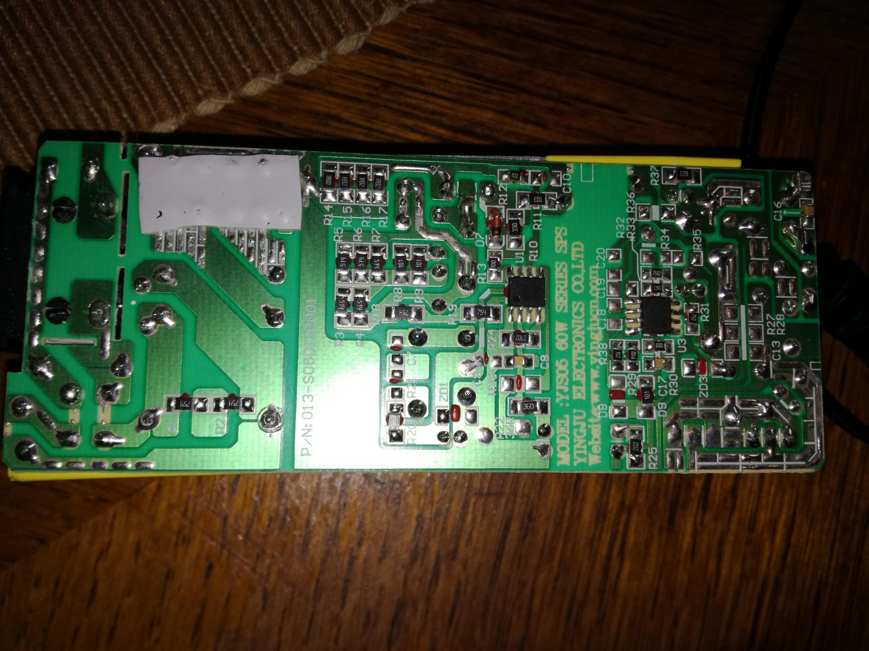

    OBH NORDICA model: YJS05-2402500D.
    Input: 100-240V, 47-63 Hz
    Output: 24V DC 2500mA
    Just out of nowhere it stopped working. What my knowledge could handle is dismantle of plastic box and measuring the input voltage which is correct 230+- V, fuse is OK, but on the output there is no voltage !
    If any of you guru guys could help me to diagnose the DC adapter I would be very grateful.
    By the way I have no way of measuring capacitance, have just a regular multi meter! And they all look fine ! visual appearance!

    in the center is a huge cap, at the edge of it is a small one.
    replace the small one - use something decent like panasonic FR or rubycon starting with ZL
    infact get it out and tell us what's printed on it,
    i will try to locate a very high temperature replacement such as 125 or 130' capable.
    those bricks cook regular caps!

      That looks like a flyback topology design, controlled by a 384x type pulse width modulator IC, U1 on the bottom of the PCB. That little capacitor stj suggested you replace is essential both for the circuit to start up and to stay running. Some manufacturers use low quality parts in that function, so it fails frequently.
      It's a fine point, but if that area gets really hot I'd recommend Panasonic FC, Nichicon PW, or Nippon Chemicon LXZ for that spot. ZL and FR use an electrolyte technology that does less well in hot spots. I've had good experience with Rubycon ZL and with the older Panasonic FM series (same electrolyte technology as FR), but I think FC and the other parts I recommended would be better 105C parts (which FC, FR, ZL, PW, and LXZ all are) for a hot spot.

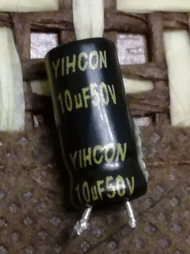

            YIHCON 10uF50V
            105 degrees C

              Waiting for ESR meter, till then am out of luck testing the capacitor, so will just replace it.

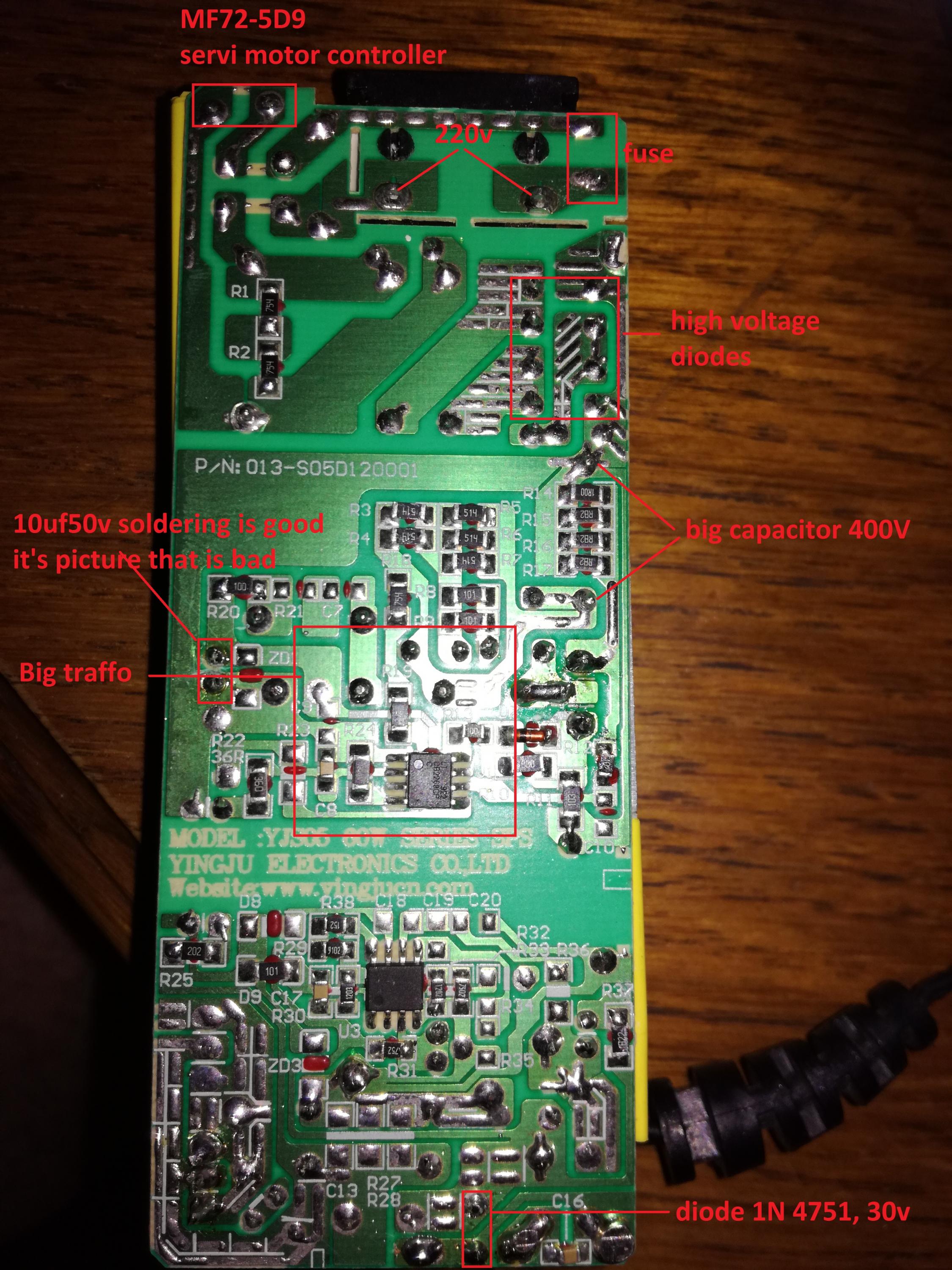

              I did however remove before reading the posts, SCHOTTKY RECTIFIER MBR10200CT <red arrow with in the picture>.
              By testing it out of the box, result were not good /reason I removed it cause readings with in the board were weird.
              I did by the new cause the price is just fine.
              By measuring the new one and the old one, I did find it not the same ! so I assume faulty rectifier.

                Had a spare 10uF50v, 105 Celsius, signal lamp worked, which was good enough for me, (bad me did not check dc output). I had assembled the adapter and yat bad news, it's not working again !.
                I have dismantle the adapter once again and am not getting signal lamp now. !
                Maybe my capacitor was bad though it was new !

                  Actually in some designs the ratings for that capacitor can be very critical.
                  It's basically used as a timing circuit so the unit will turn on at the right time.
                  But if no model designations are on the old cap that's going to be difficult...

                    Please guys, after changing diode 1N 4751, 30v which seems to be shorted, and capacitor 10uF50V,and SCHOTTKY RECTIFIER MBR10200CT.
                    Board seem to be working and I have tested it, but as I switch it off, i get the same problems once again !!!. (just diode 1N 4751, 30v shorted)
                    Please I don't know what seems to be causing it. But there has to be a problem somewhere in between. Either transformer, but as far as my knowledge goes, if transformer is bad it's bad and it's not working at all.
                    Could u please inguide me what could be wrong!.

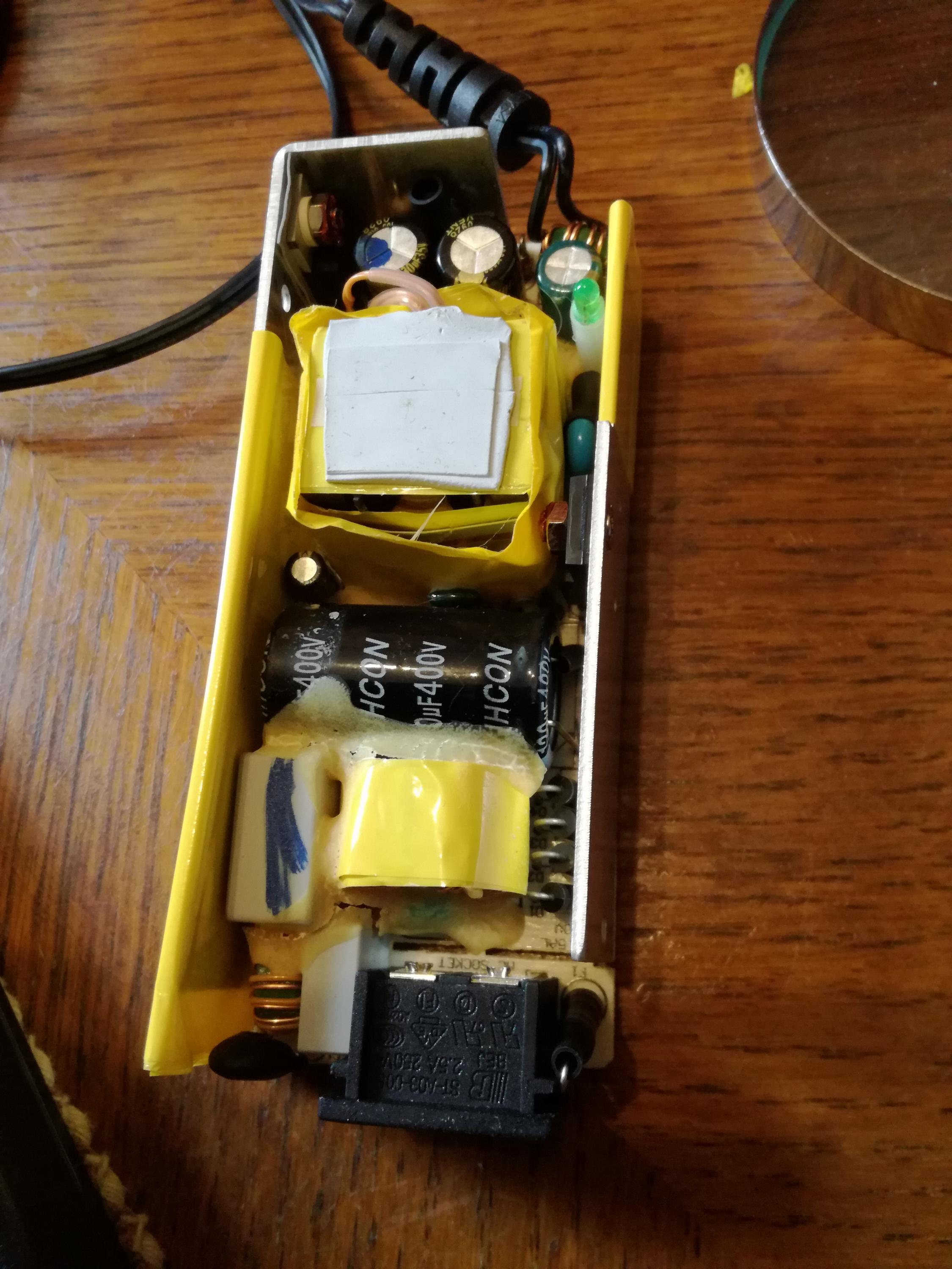

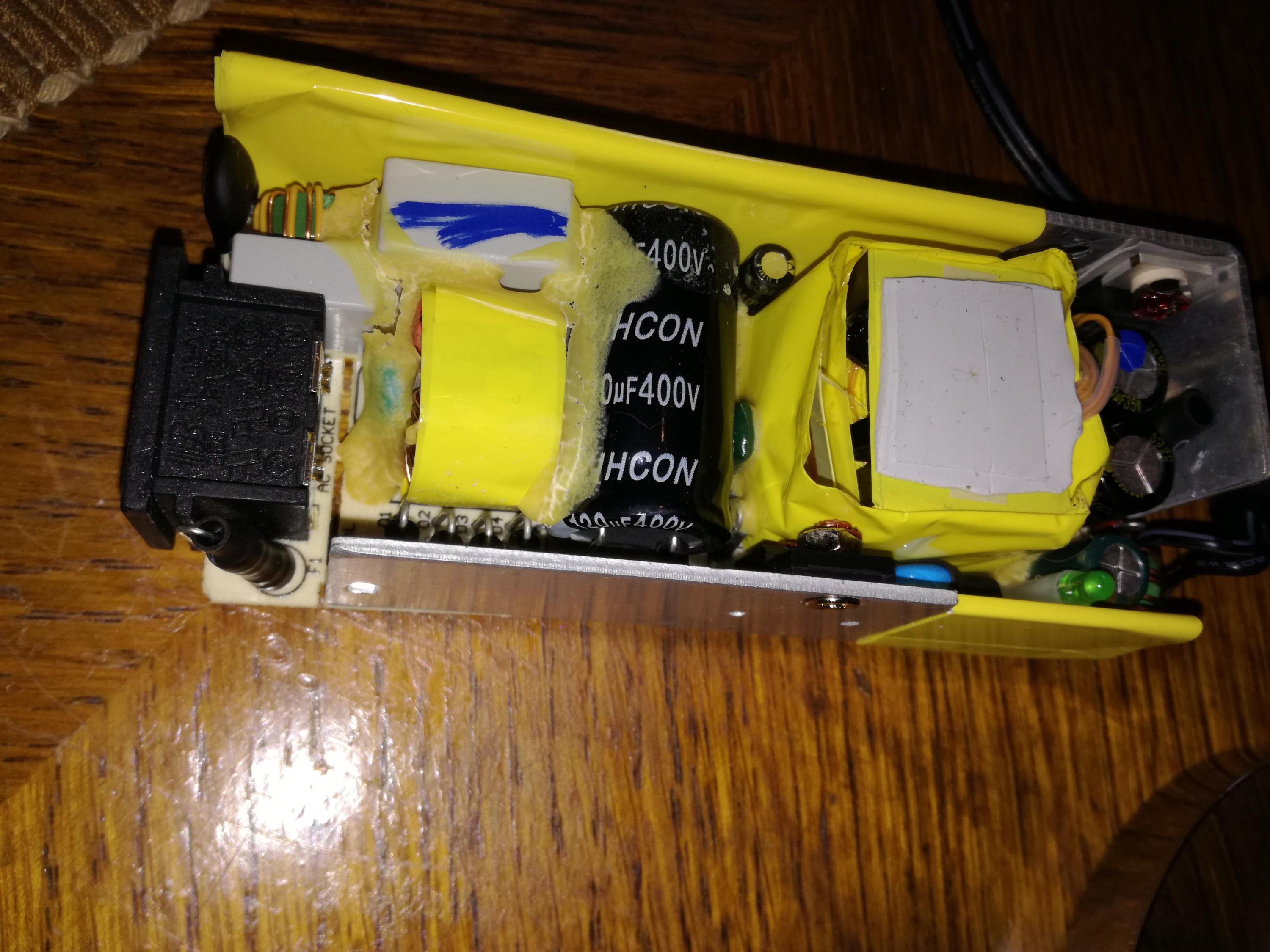

                    Sending some photos of what I have changed with the help from forum guys !

                          Hello nguberinic,
                          Please refer to your modified picture below:
                          Would it be possible for you to take a photo of the section shown by the indicated box?
                          Also, what is that component encapsulated in heat-shrink, as shown by the red arrow?
                          No need to remove the heat-shrink, as you might be able to see what it is via circuit component designations on the bottom and/or the top of the PCB.

                            Re: OBH Nordica DC adapter
                            That 30V Zener is the crowbar protection diode, it is connected in parallel with the output so if the Voltage try to go higher than 30VDC, it will conduct heavily until it is shorted out, so you need to monitor the output Voltage, you may bad Voltage regulation problem that lets the out put goes way beyond 24V as specified.
