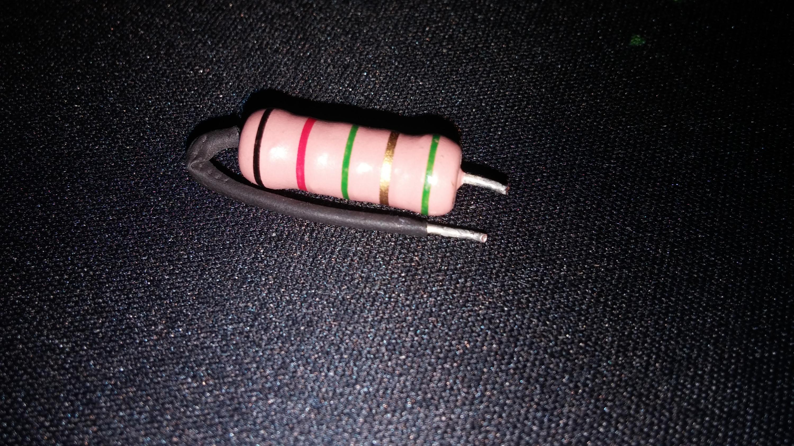

    I need to find out what value this resistor is. Having a hard time finding out. Replaced a bad main cap, a power mosfet and a smd resistor. This resistor measures .02ohm.

    it's fine i suspect.
    the first 2 bands are black,red
    that's 0,2

      Re: Thermaltake TR2 750w Need help with resistor value
      Why all the other bands then?
        • 31214
        tolerance, temperature coeficient etc.
          Black = 0
          Red = 2
          Green = 5
          Gold X 0.1
          Green = .5%
          I don't know why they used black as the first band because all calculators just ignore the zero.
          That calculates out to 2.5 ohms which is likely wrong, what you measured is likely correct, .025 ohms
            If it reads that low on resistance, it is more than likely fine. Resistors go open-circuit or high resistance when they go bad.
