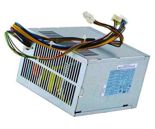

    A freind asked me to help out with this HP Desktop, it has no power issue.
    i wanted to test the psu but it has diffrent connectors than the 24 pin standard psu.
    is there any way to test it in order to rule out MB fault?

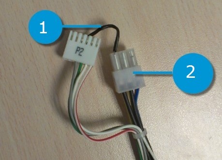

    found this info on HP's website.3
    i tested it and indeed the PSU is faulty.

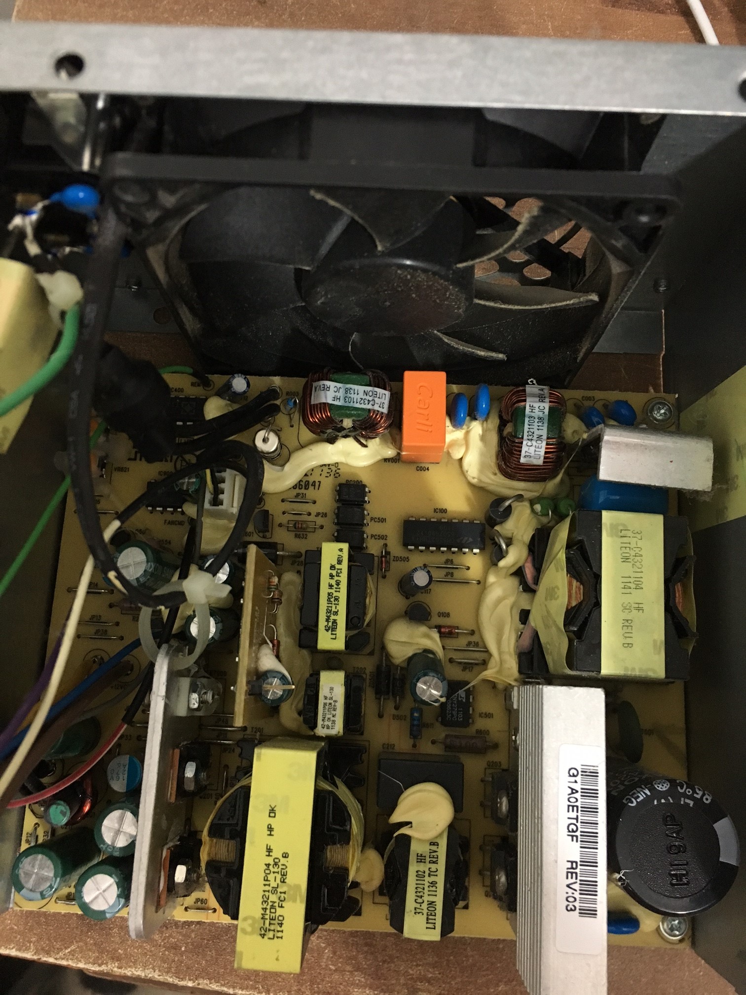

      Please post some photos of power supply board or boards

        It looks like that power supply is made by at least 3 vendors, AcBel, Delta Products, and Lite On. It has two 16A +12V outputs, a very low current -12V output, and a 1.3A +12 Standby output. It looks like the pic in your second post grounds (black insulation wire) the PSON# signal (green insulation wire).
        From the pictures I've seen, it looks like the yellow wires are one +12V output, and the brown wires in that 4-pin connector is the other +12V output.

                If it has non-functional APFC then figuring out why is the first problem. If the 5VSB is down, so also are the internal housekeeping supplies. All in all, checking the 5VSB seems to me the first place to start, since that circuit supplies V(cc) for the PFC and PWM controllers as well as output supervisory circuits.
                He said the 5VSB isn't present. What to do next depends on what type of Standby controller the PSU uses. Find out what it is and find a datasheet. Usually that has a sample circuit that can show what to look for. Understand the controller, figure out what voltages it needs and what can shut it down.
                Pictures of that area of the circuit could be extremely helpful for us to make suggestions.

                  i found these ICs, i don't know who is the 5v standby controller.
                  IC501: TNY279PG
                  IC100: CMS6502THH+X
                  IC400: PS25A
                  IC900: WT7038
                  If that helps, tell me which one is it and i will take more clear pictures of that area.
                    Re: HP 611483-001 Force on
                    You could have learned that in a few minutes by Googling those part numbers. It's U501. I suggest a thorough read of Power Integrations' datasheet. It will tell you how the device works.
