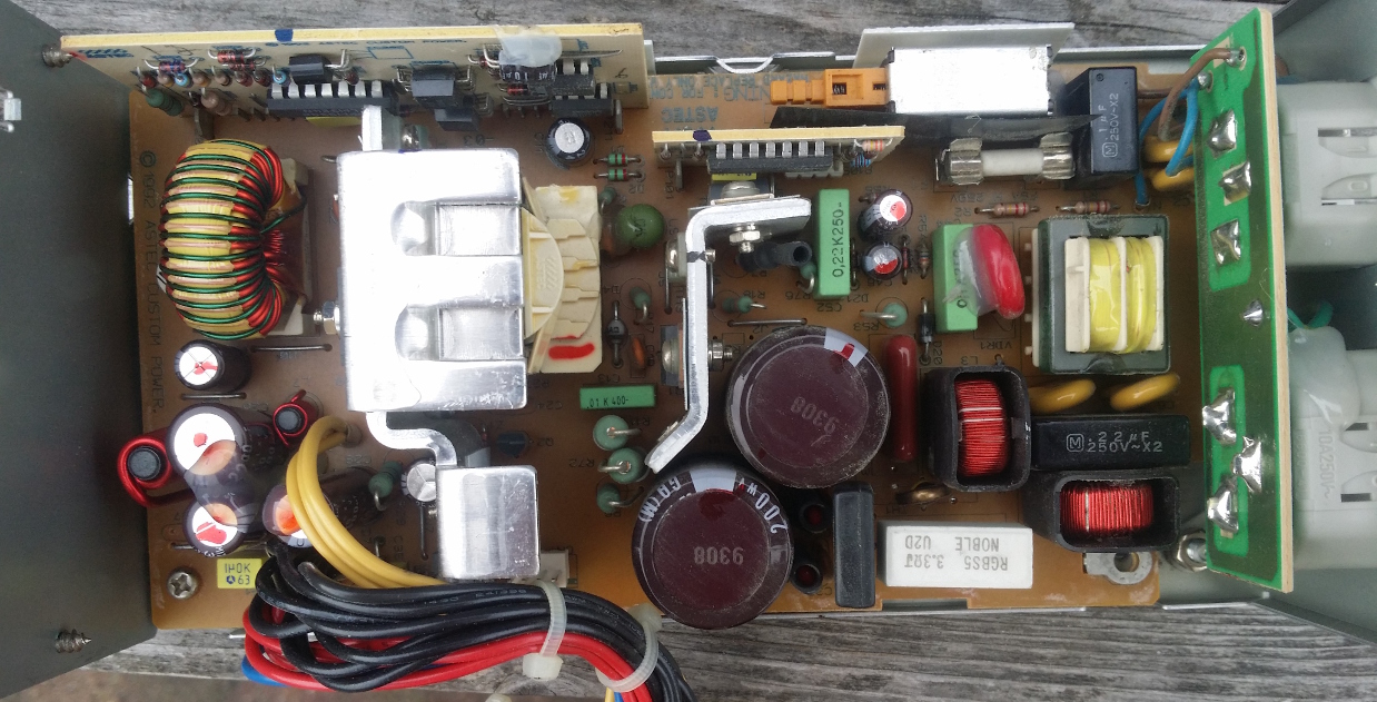

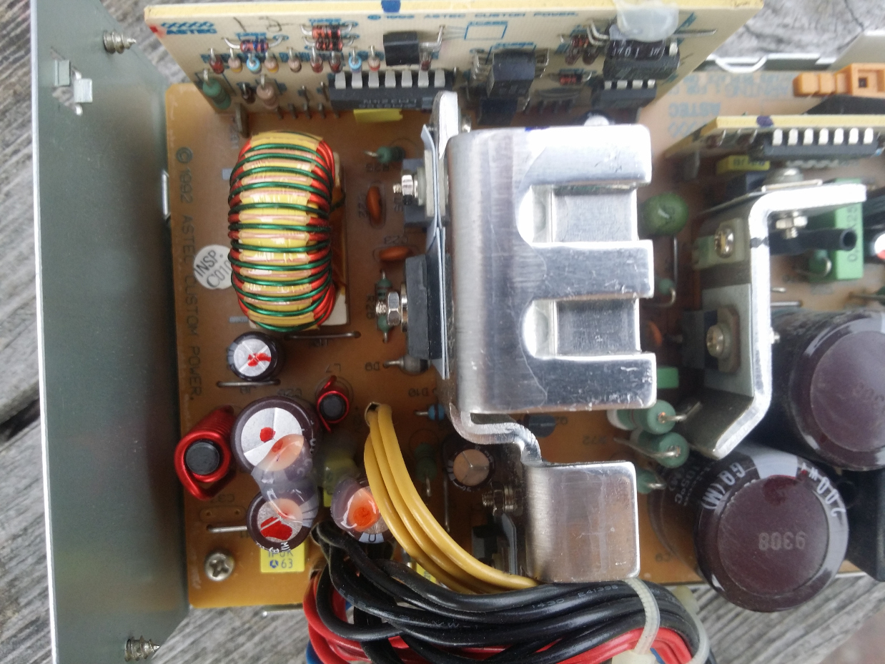

    Hello crews,

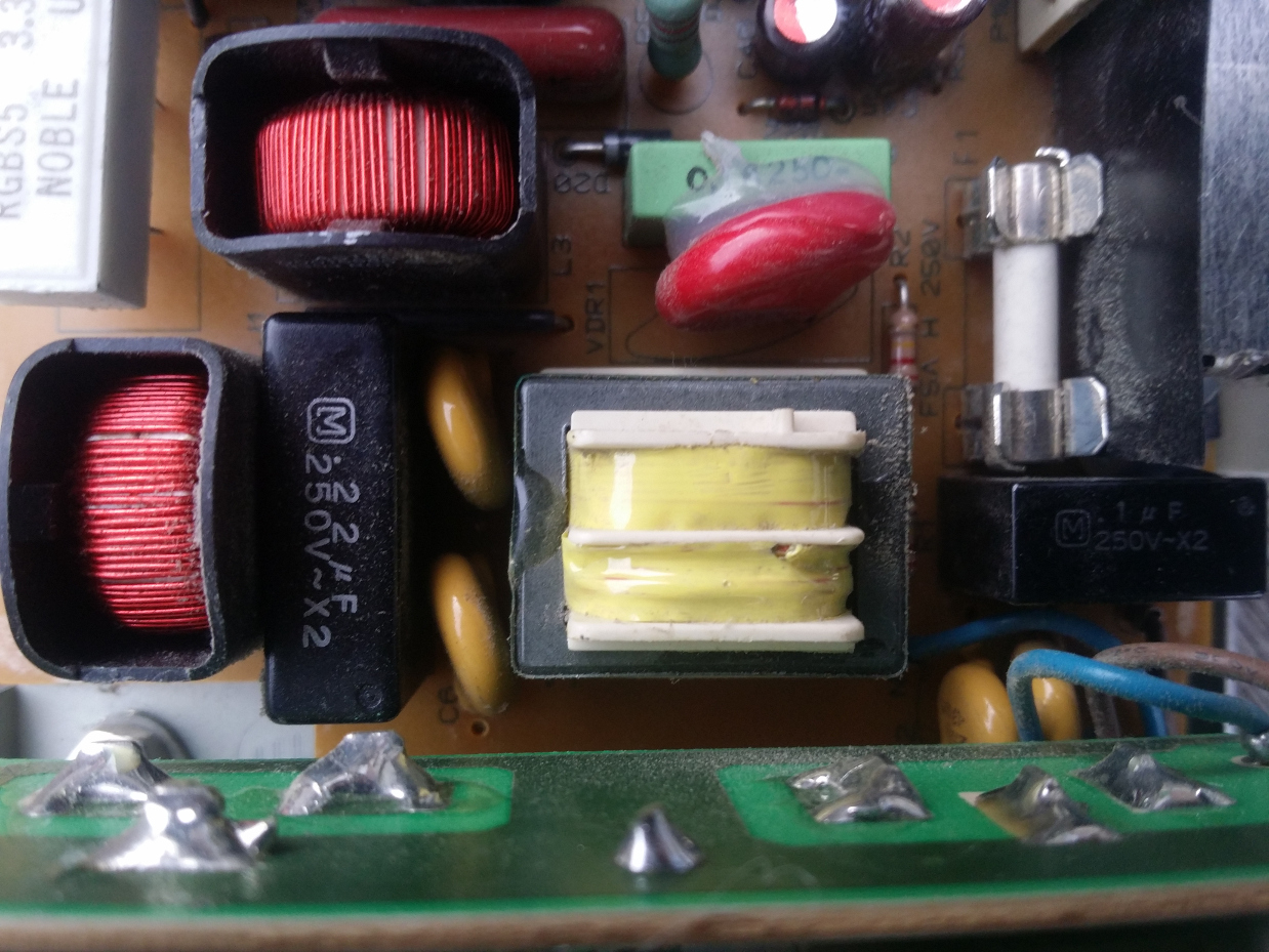

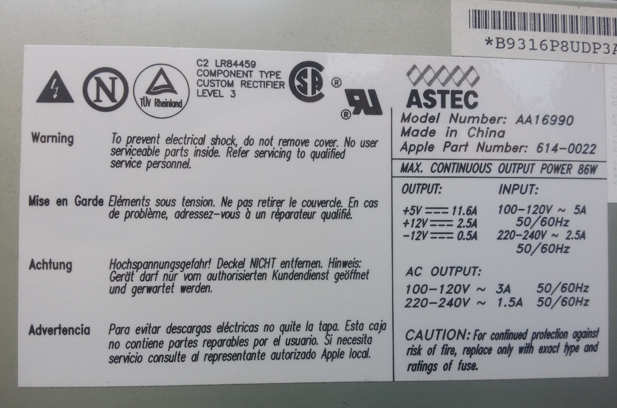

    I have an ancient Astec AA16990 PSU from the first generation Power Macintosh (about 1993). The computer was fully functional until the last month when I noticed that the floppy drive has suddendly stopped working. This brought me to the idea to check the PSU first.
    The cover lists the following output voltages to be supplied:
    +5Vdc, 11.6A (red cable)
    +12Vdc, 2.5A (yellow cable)
    -12Vdc, 0.5A (blue cable)
    However, a quick multimeter check shows the following output voltages:
    red cable --> +4.4Vdc
    yellow cable --> +7Vdc
    blue cable --> -4,4Vdc
    All voltages seem to be out of expected range which could explain the floppy drive failure.
    I bet the PSU need a major recapping due to the age of the unit that still seems to contain original components from 1993.
    I counted 12 electrolytic capacitors by Nichicon on the PCB, with no visible traces of bulging, leaking etc (see attached pictures).
    Because I have a rather limited experience with PSUs, I'd to ask the experts here about what to do in order to fix it?
    Thank you in advance!

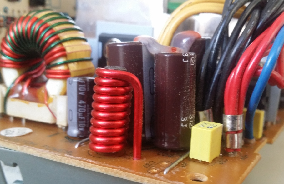

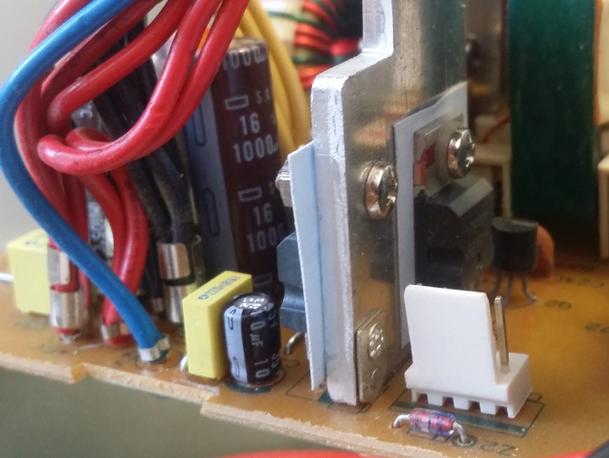

    the ones on the left of second pic near the output cables are the key ones.
    got a side-view foto so i can see what's written on the caps?
    • powermax
      • May 2017
      • 49
      Re: Astec AA16990 PSU failure
      It's quite difficult to capture these 6 caps at once. I therefore made two pictures showing 3 of 6 caps clearly.
      The biggest cap in the middle of the left image is 2200uF 10V Nichicon LXF Serie. The next one to the right is obscured by glue. The small one to the left is 470uF 10V Nichicon PL(M) Serie.
      On the right image:
      the tallest one: 1000uF 16V Nichicon SXE Serie
      the small one in the middle: 10uF 10V Nichicon
      and there is one more cap just behind the heat sink not shown on the pictures: 25uF 25V Nichicon LXF Serie

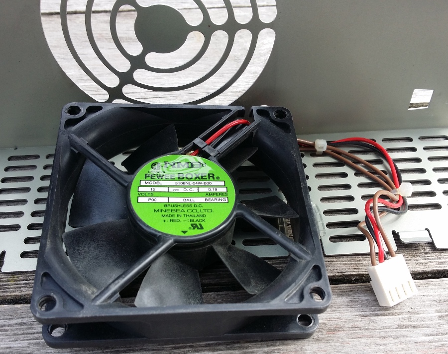

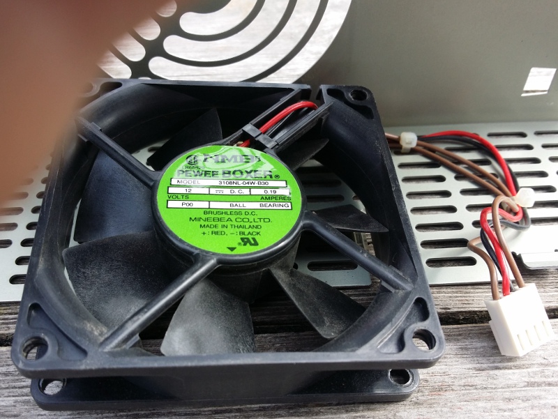

                I notice the PCB is very browned. That suggests a problem with the P/S fan, if it has one, with the system fan (if ...), or that the system cooling vents were partially blocked for quite a while. So I would consider replacing those as well (they are really old, too), and even using somewhat higher airflow fans.
                  Thank you for pointing that out! Yes, the PSU has a built-in fan (see the attached images). According to the part description, it's a NMB PEWEE BOXER 3108NL, 12VDC, 0.19W fan motor. I don't have any clue how old it is but it seems to work flawlessly.
                  Any suggestions for a replacement?
                    Fans are a mechanical part with a finite life. 24 years is really old for a fan, so replacing it could be a good idea, even if it's nice and quiet right now. NMB is a very good brand and NMB still makes that fan, but I don't know what you have easily available. So if you can't get the same part at a reasonable price, get the dimensions, "Max. Air Flow", and "Max. Static Pressure" numbers from the linked NMB webpage and find an equivalent from another good vendor.
                      PCB looks fine to me. Just looks like the cheap Phenolic brown stuff, that is all.
                      As for the fans: I wouldn't replace any fans, unless they are either starting to get noisy or stick / not rotate freely.
                      Most sleeve bearing fans are serviceable if they have a removable rubber plug on the back.
                      Ball bearing fans, on the other hand, are not serviceable once they develop bad bearings... that is, unless you replace the ball bearings with new ones.
                      NMB fans like the one above rarely have a rubber plug, and thus are typically impossible to service (unless you drill them out)... but I have not found a need to replace one yet. These fans will rarely seize up and are much better quality than a new cheap fan.

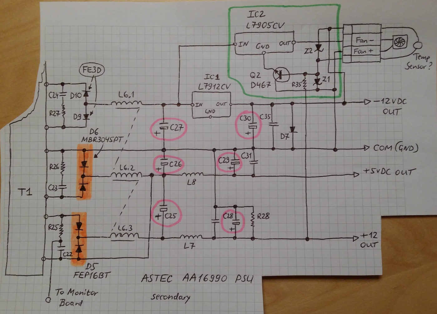

                          Well, I attached my first attempt at schematics drawing for the secondary side of the PSU of interest. All electrolytic caps (6) are marked with red circles. The part in the green box looks like a fan speed control circuitry. Unfortunately, I have no clue how this L7905CV IC is used for controlling the built-in NBM fun which operates in the voltage range of 6.0 - 13V.
                          Would you kindly take a look at the schematic and tell me which components could eventually cause too low voltages so I could make further investigations?
                            I tested the fun with a 9V battery. It works well with no mechanical noise. I therefore ain't going to replace it for now.
                            Anyway, kudos to PeteS in CA for finding out that NMB still makes this fan! Any replacement should be very easy now.
                              Originally posted by powermax
                              1 Well, I attached my first attempt at schematics drawing for the secondary side of the PSU of interest. All electrolytic caps (6) are marked with red circles. The part in the green box looks like a fan speed control circuitry. Unfortunately, I have no clue how this L7905CV IC is used for controlling the built-in NBM fun which operates in the voltage range of 6.0 - 13V.
                              2 Would you kindly take a look at the schematic and tell me which components could eventually cause too low voltages so I could make further investigations?
                              1 The L7905CV is a 3-terminal -5V regulator, with the "Ground" pin connected to ground. The 2SD467 is used as a temperature dependent resistor, so that the voltage to the fan is 5V plus the voltage across the 2SD467.
                              2 Your partial schematic shows the output rectifiers and filters and the fan control circuit. It lacks the feedback circuit which has components that affect regulation.
                                    Unless the caps on the output rails themselves are bad (which I doubt, as Nichicon PL is quite reliable - I have an Astec PSU of a similar age, and its caps are absolutely fine), I don't think anything on the schematic you posted would be bad.
                                    Speaking of the schematic you drew: good job, looks pretty good.
