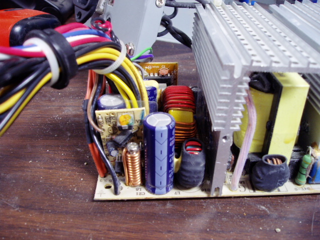

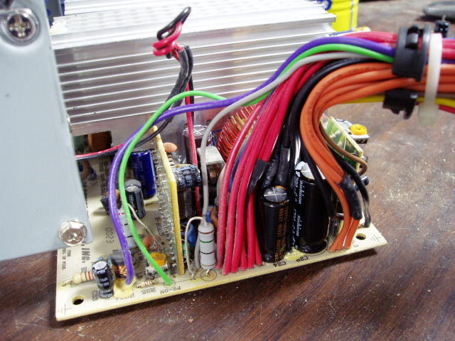

    To be fair, this is a Silencer 275ATX which was probably bought in 2000 or 2001 or thereabouts (I really don't remember). However, I pulled it apart to check the status of the caps, and was surprised to find a bulging YEC, as well as several Fuhjyyus. I remember paying a huge premium for it when I bought it. I contacted PCP&C, and they were not able to provide any information to help me with the recap. I think think they make a great power supply, but was disappointed to see these in there.
    Here's what I pulled out:
    C21 4700 10 Fuhjyyu TMR 13x36
    C29 4700 10 Fuhjyyu TMR 13x36
    C23 4700 10 Fuhjyyu TMR 13x36
    C17 470 16 Teapo SEK 8x11
    C13 1000 16 Fuhjyyu TNR 10x21
    C24 3300 10 YEC SH 10x23
    C22 1650 16 Jamicon TK 10x22

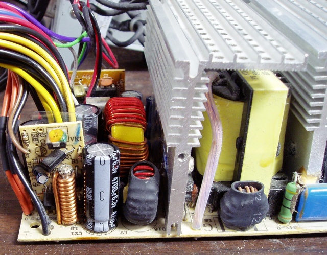

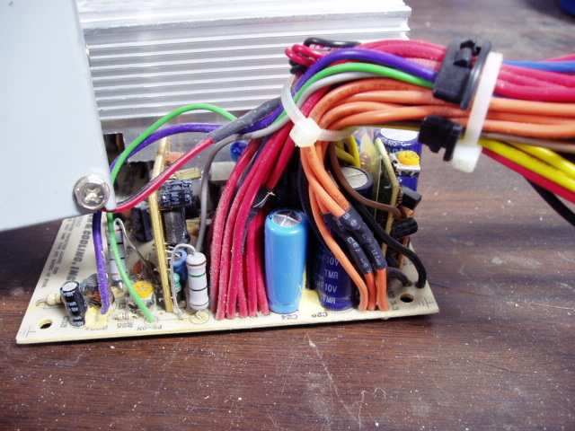

    And, here's the replacements:
    Replacements
    C21 4700 6.3 Nichicon HD 12.5x32
    C29 4700 6.3 Nichicon HD 12.5x32
    C23 4700 6.3 Nichicon HD 12.5x32
    C17 470 16 UCC LXY 8.x20
    C13 1000 16 Nichicon PJ
    C24 3300 6.3 Nichicon HZ
    C22 1800 16 UCC KZH
    Anyways, its recapped and (still) working fine. There were no symptoms before I pulled it apart, I was just checking. C17 was under a heatsink, so the 20mm height just BARELY fit in there. I was glad the bigger caps were 12.5mm, that allowed me to get some better replacements without being constrained to a 10mm diameter.

        You changes C21, C23, C24, C29 to 6.3V rating. I am not sure which supply rail it is connected to... but, usually I use the following capacitor voltage rating for recap:
        10v for +5V
        6.3v for +3.3V
        16v for +12v
