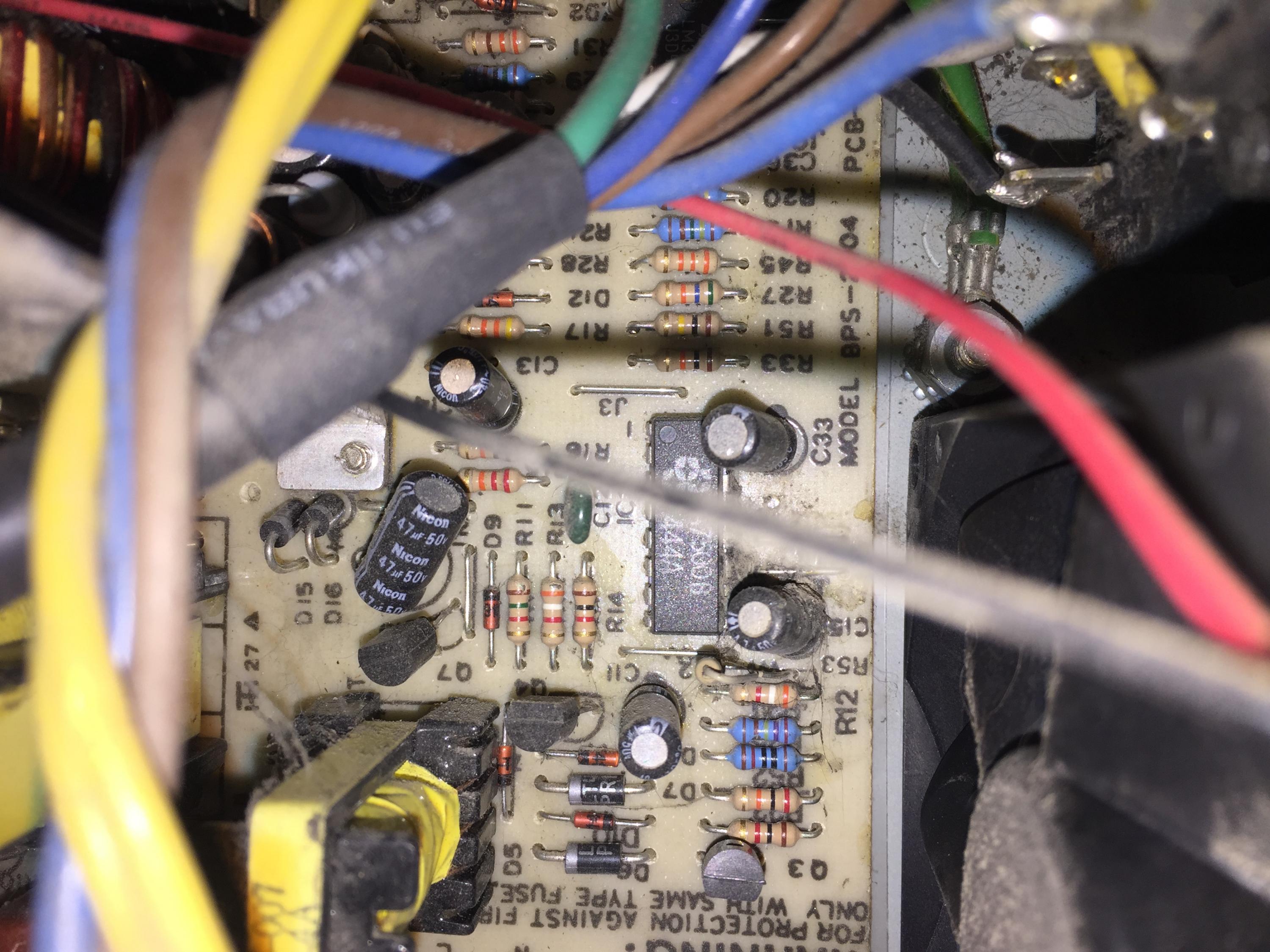

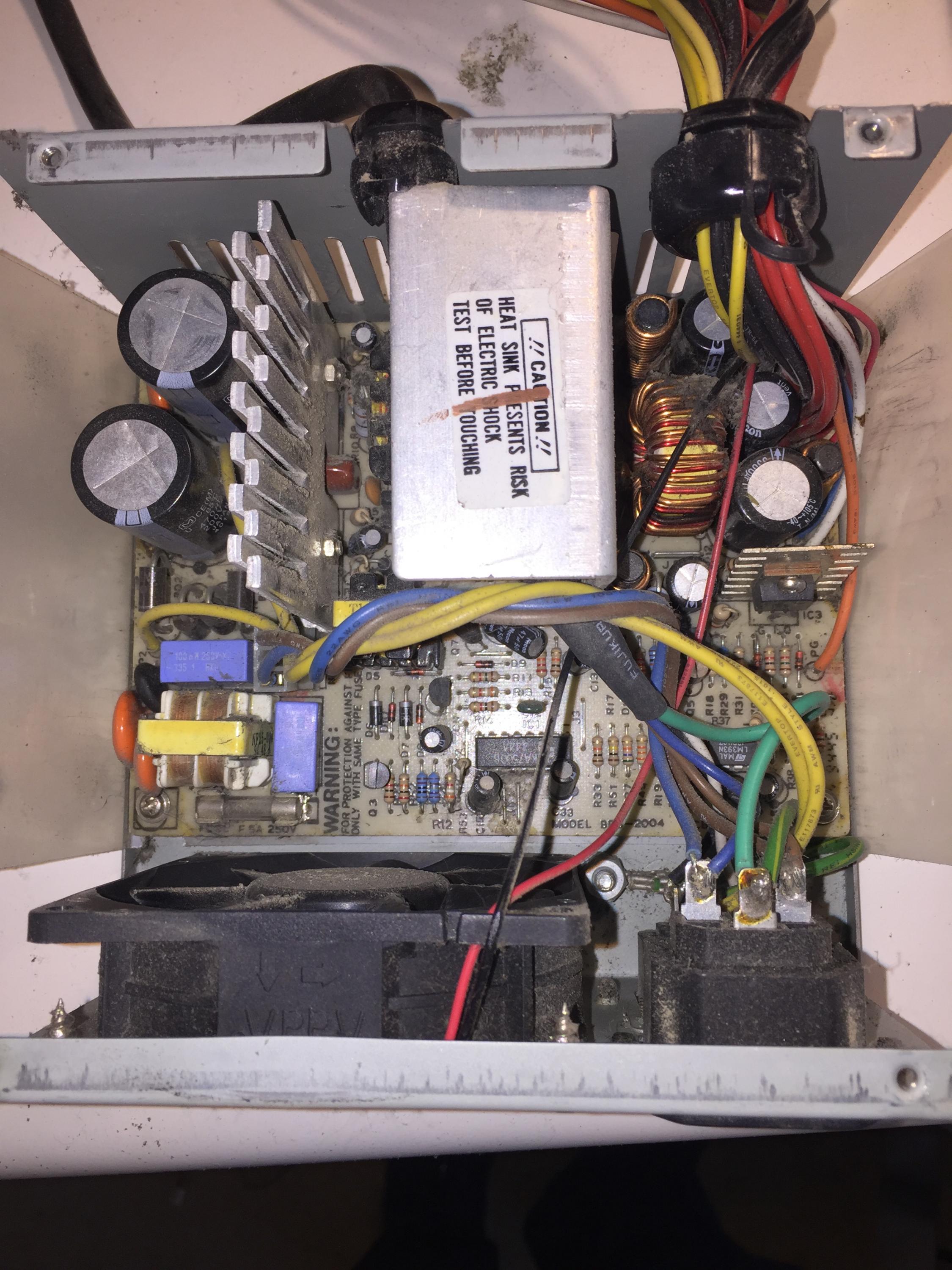

    Finally got around to taking apart one of the PSUs I plan on using in a 486DX2-66 build.
    This is a Besttec BPS-2004-4U AT power supply that was pulled from a Pentium 90 machine.
    I have honestly run this guy quite a bit as I have built the system, but I haven't really cracked it until now. I was getting close to screwing everything down, and I can't remove the power supply without removing the front panel. Front panel was off, so it was time to pull the PSU.
    Dusty. Super loud fan. Recommendations for a replacement fan?

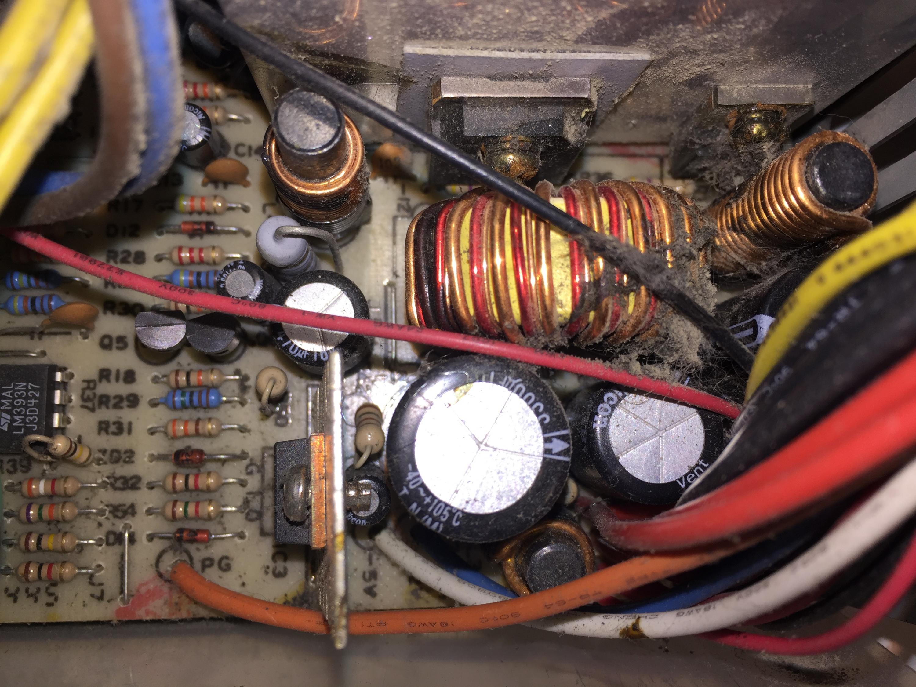

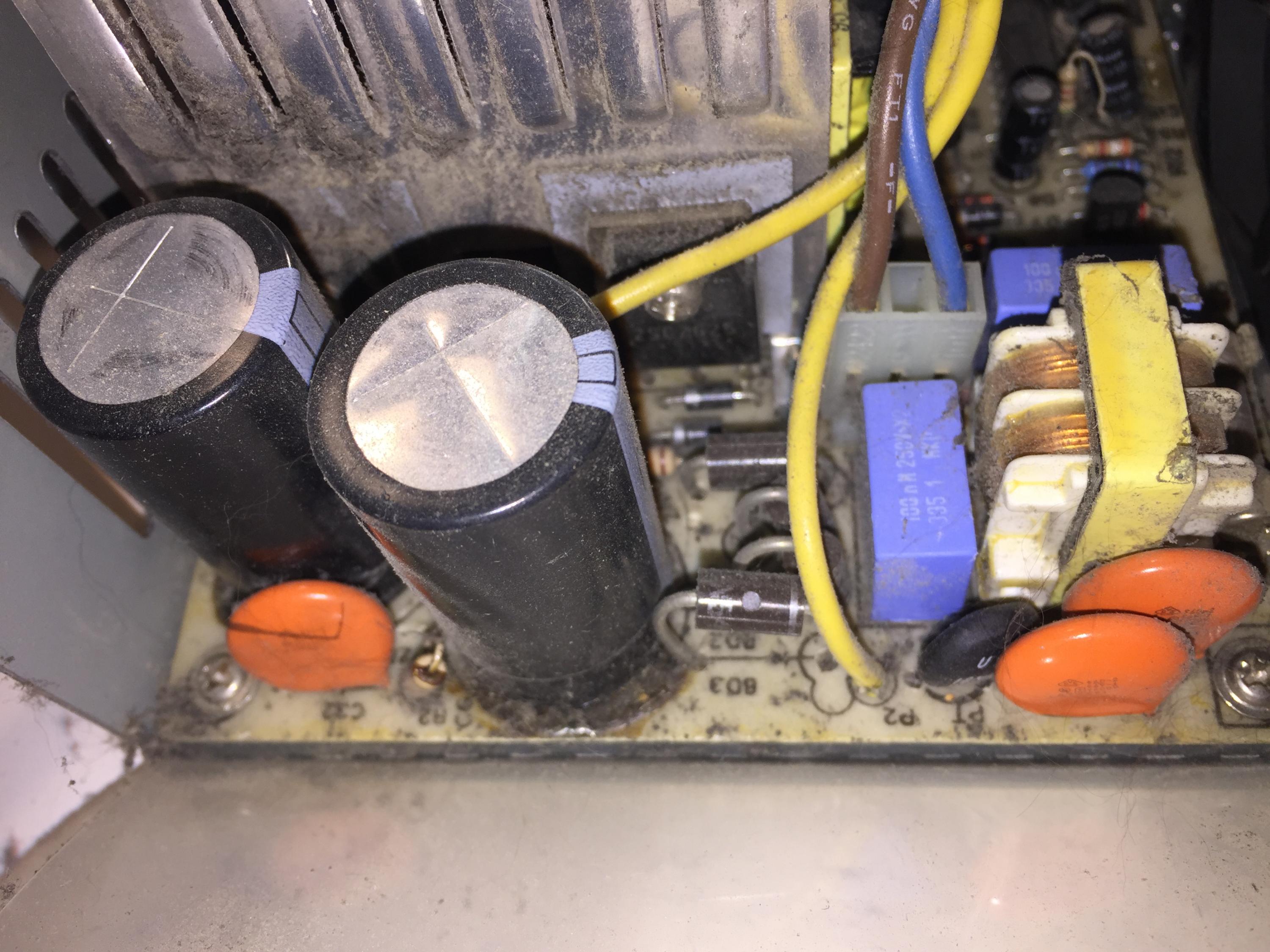

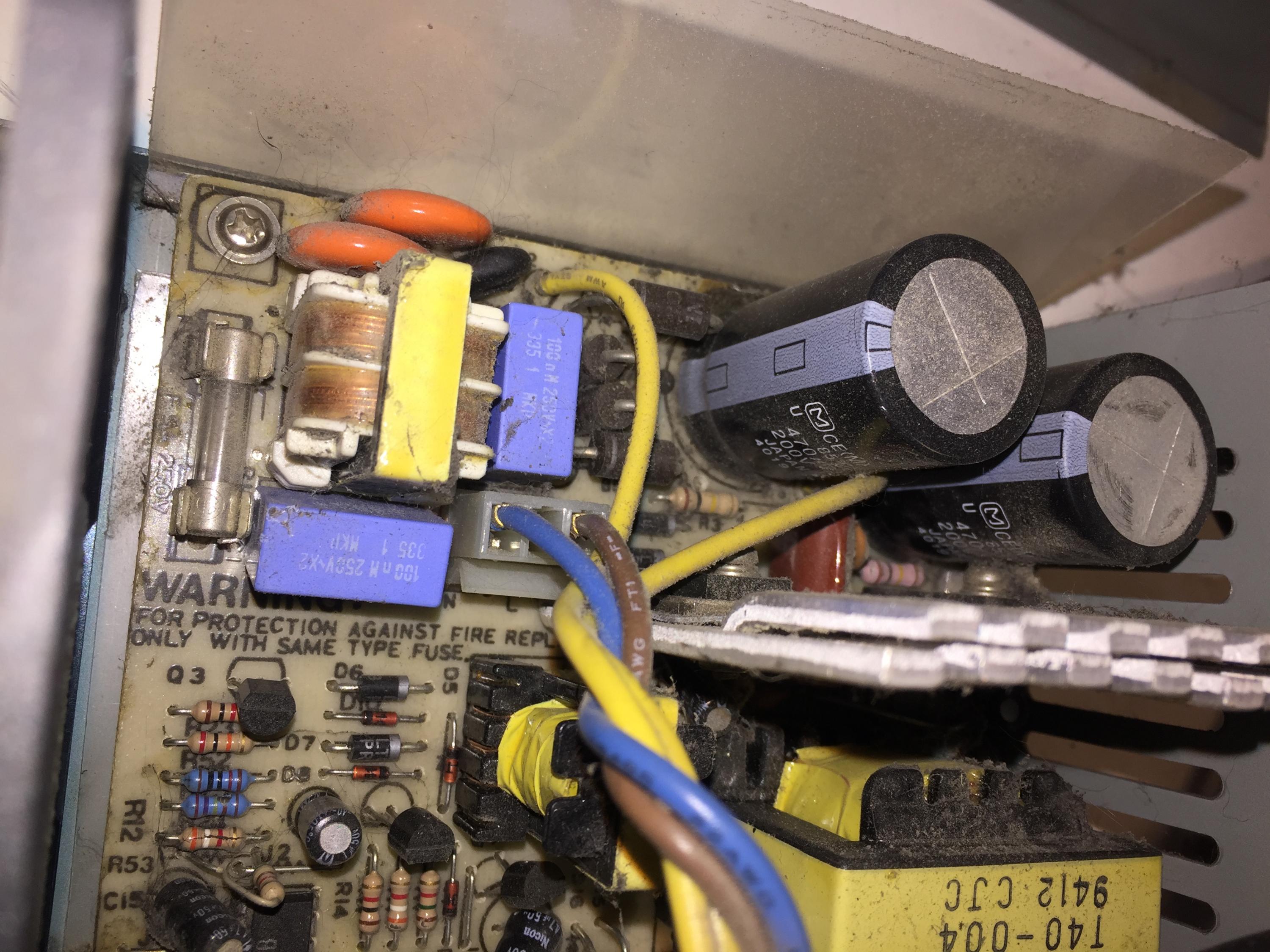

    Photos enclosed. Nicon caps in the middle and on output. KA7500B IC (sorry about the wire).
    I suppose i could wire it back up for a load and hook up the oscilloscope. Guess I got a little teardown happy when I got home today.

    Looks decent!

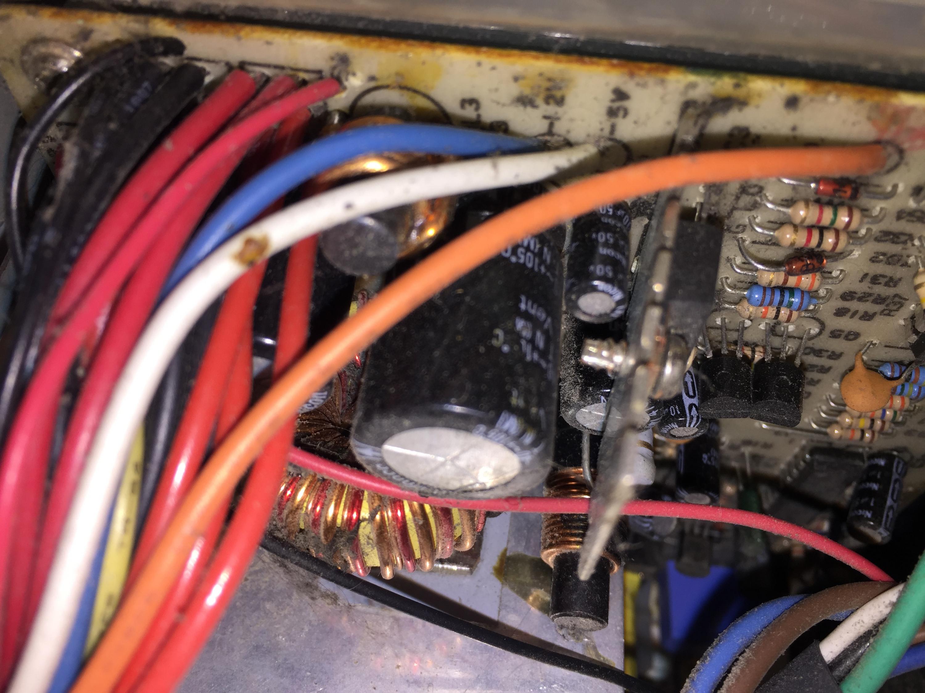

    Recap with Panasonic FC/FR, or Nichicon PW/HE. Except maybe those two Panasonic filter/doubler caps...
    If you can get to them with small needlenose pliers, make sure the heatsink screws are tight. Blow it out with an air compressor too.
    I've used Arctic Cooling F8 fans (not F8 PWM) which are 80mm, quiet and still move a decent amount of air. Wire directly to +12. Another tip is to remove the stamped grille and replace with a wire one. Measure first- sometimes those older cases don't give enough clearance in their PSU/fan cutouts to accomodate the higher-sitting wire grille.
    I always scope with resistors and/or 12V lamps. Scoping while connected to a system can sometimes be misleading, esp if poorly filtered devices backfeed their ripple (if they've got marginal/bad caps) into the supply.

        Since that's ~23 years old, definitely re-cap the output caps. I'd even suggest Nichicon PJ or PS, or UCC LXV. FC and PW (and UCC LXZ) might be "too good" and cause stability issues, and FR and HE might be be even more "too good".

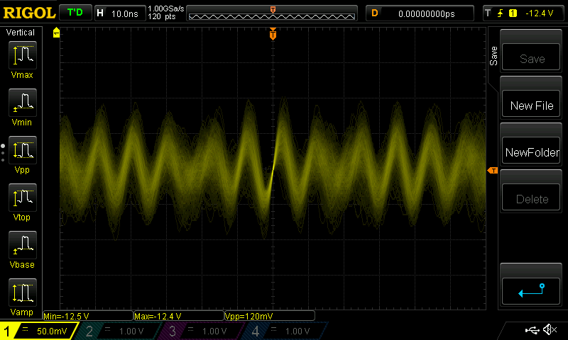

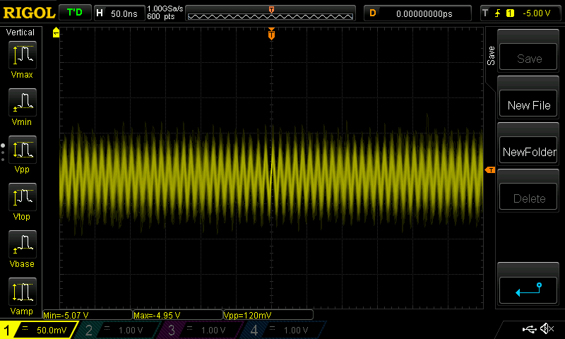

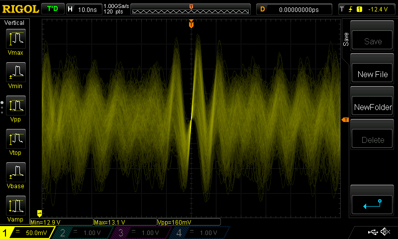

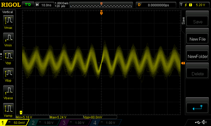

              Recapped with new fan.
              All caps are Nichicon UPJ series (name change for PJ with updated RoHS compliance?) except for the 1uf, which are Rubycon YXJ.
              Results attached. +12V is high... although this was one Pentium 90 motherboard + a single PCI video card and nothing else. So I suppose the only +12V load was the fan inside the PSU.
              Clipped the grounding lead to the metal bracket on the PCI video card. Measurements were from an empty ISA slot. ...dunno if I am shooting for the most accurate measurements. Ha!

                PSU noise measurements are not easy. Your ground lead, at high frequencies, is an antenna. And if your grounding point isn't close to the ground for where you are measuring, that also lets in noise. With the scope ground lead clipped at the same place, try measuring the noise at that point. Then, try measuring the noise at the ground of that ISA slot. I think you'll see what I mean about noise pick up.
