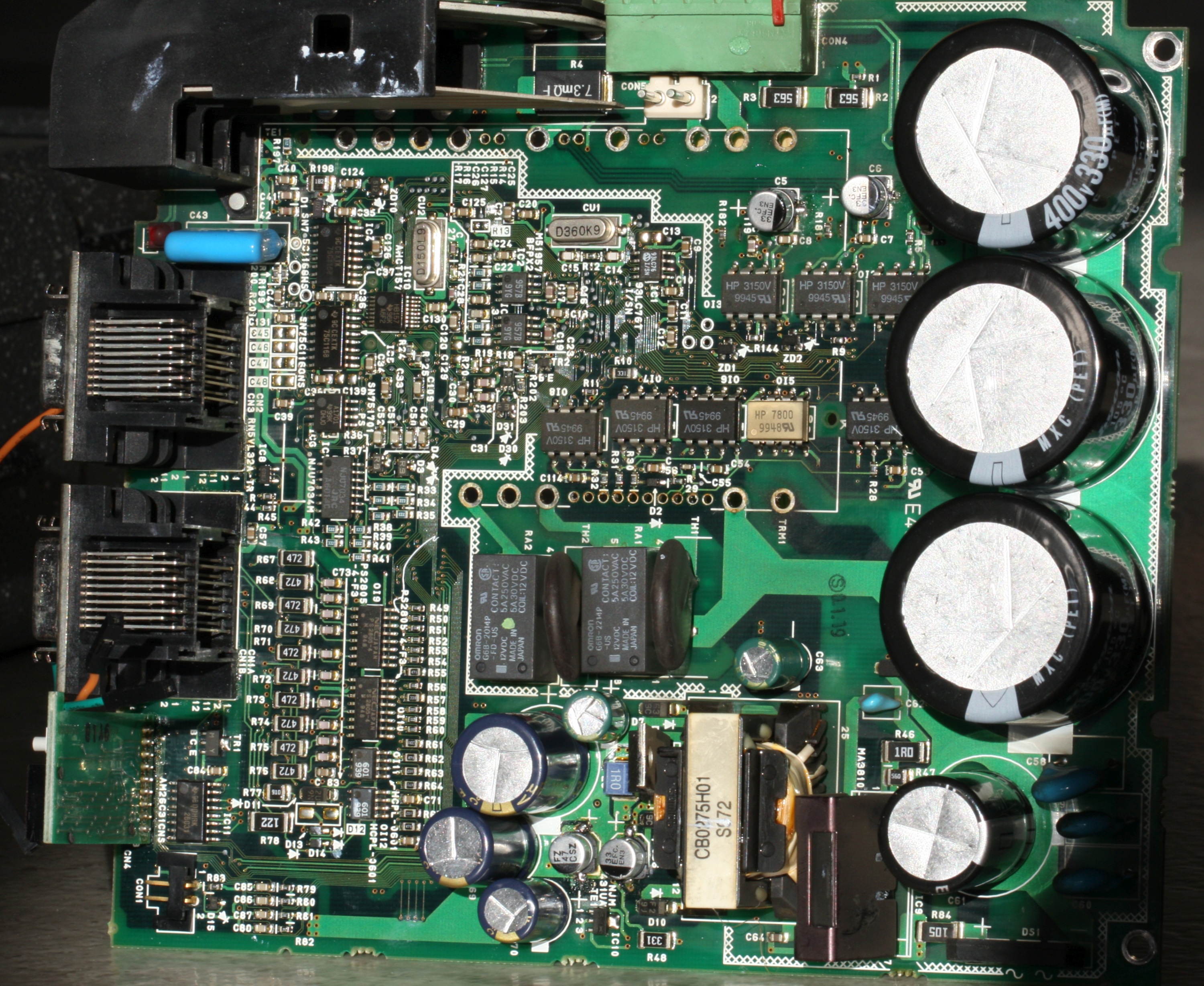

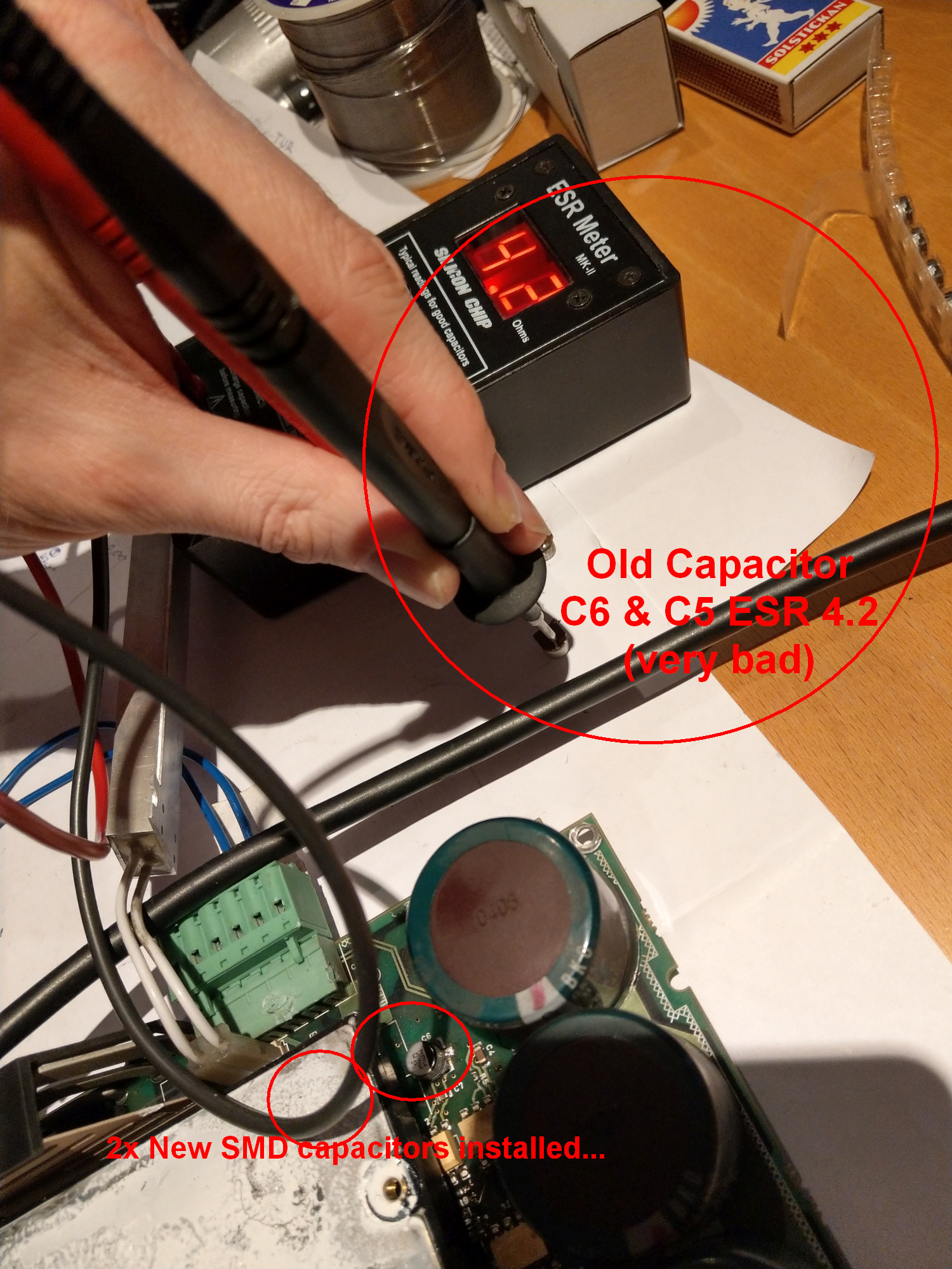

    Hi, these two caps came from a unit that otherwise is full of Nichicon caps:
    Nichicon GQ, GU & PJ manufactured late 2001.
    Got any idea what model they are? (See picture).
    The 33uF cap has an ESR of 40 so it's in dire need of replacement
    I could get it down to ca 5 by heating it with my iron, then matching the other cap...

    Re: Help to identify surface mount capacitor
    No idea, where is it from?

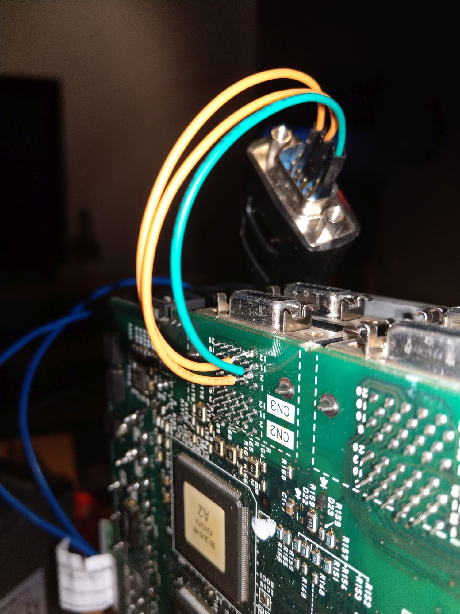

            Old thread revival time

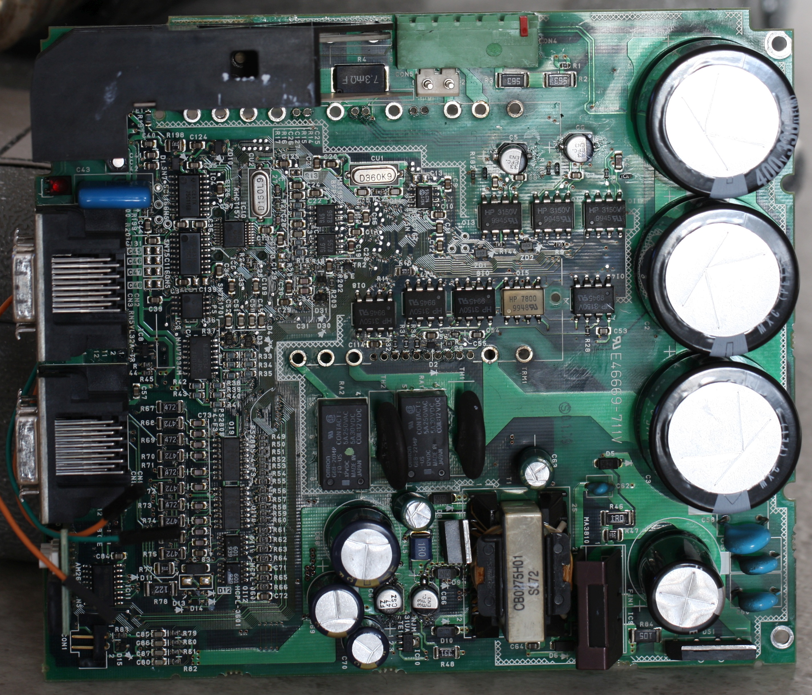

            I identified the caps: they are Nichicon UWG series.
            I replaced all electrolytic caps including those SMD's with Panasonic FC.
            Actually I'll append Elfa orderno's for the replacements below.
            Anyway sadly it didn't help.

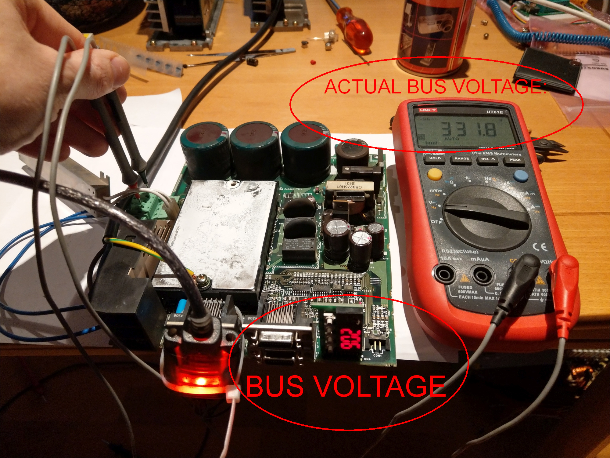

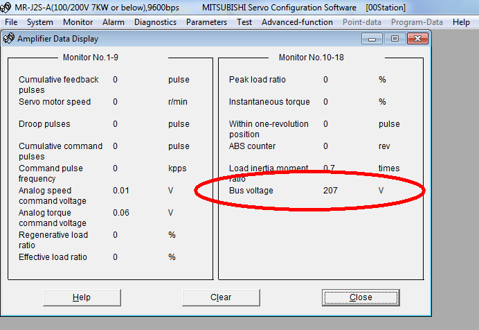

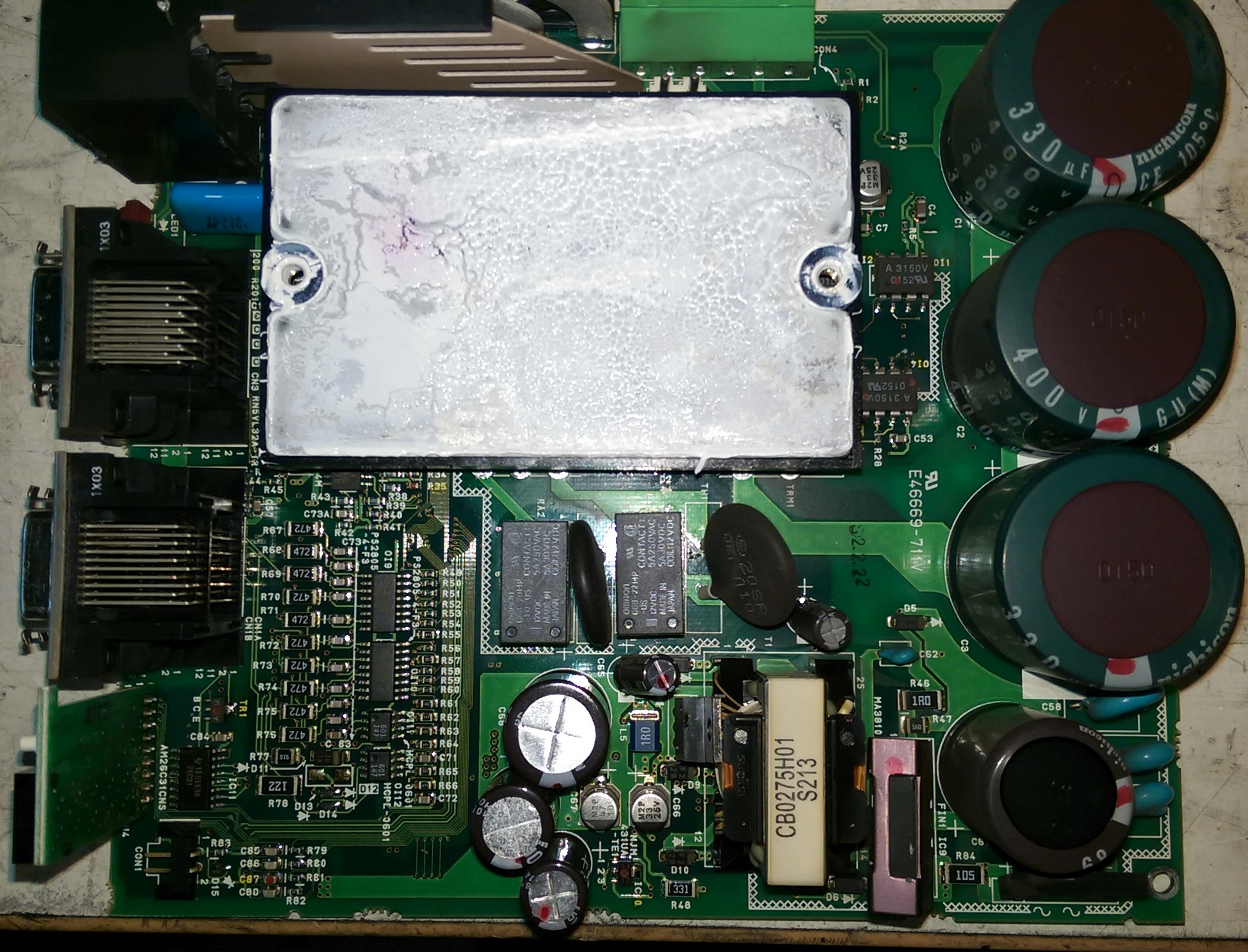

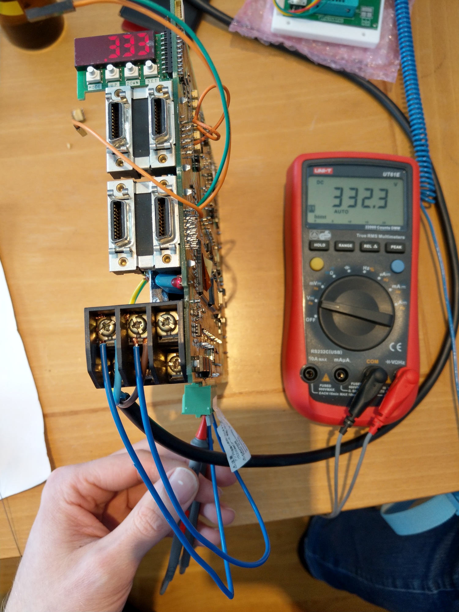

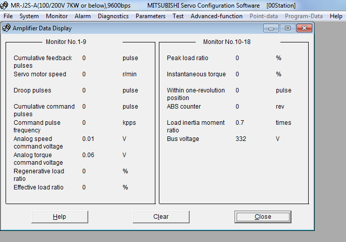

            I now have 2 such servos, they both report too low bus voltage compared to reality:
            It starts off at 170v and goes up to around 220v as the servo heats up.
            But the actual bus voltage is constant at 330v as it should be from rectified 230v mains.
            And if I heat up the servo with a heatgun the monitored bus voltage rises to the actual correct value as measured by my DMM.

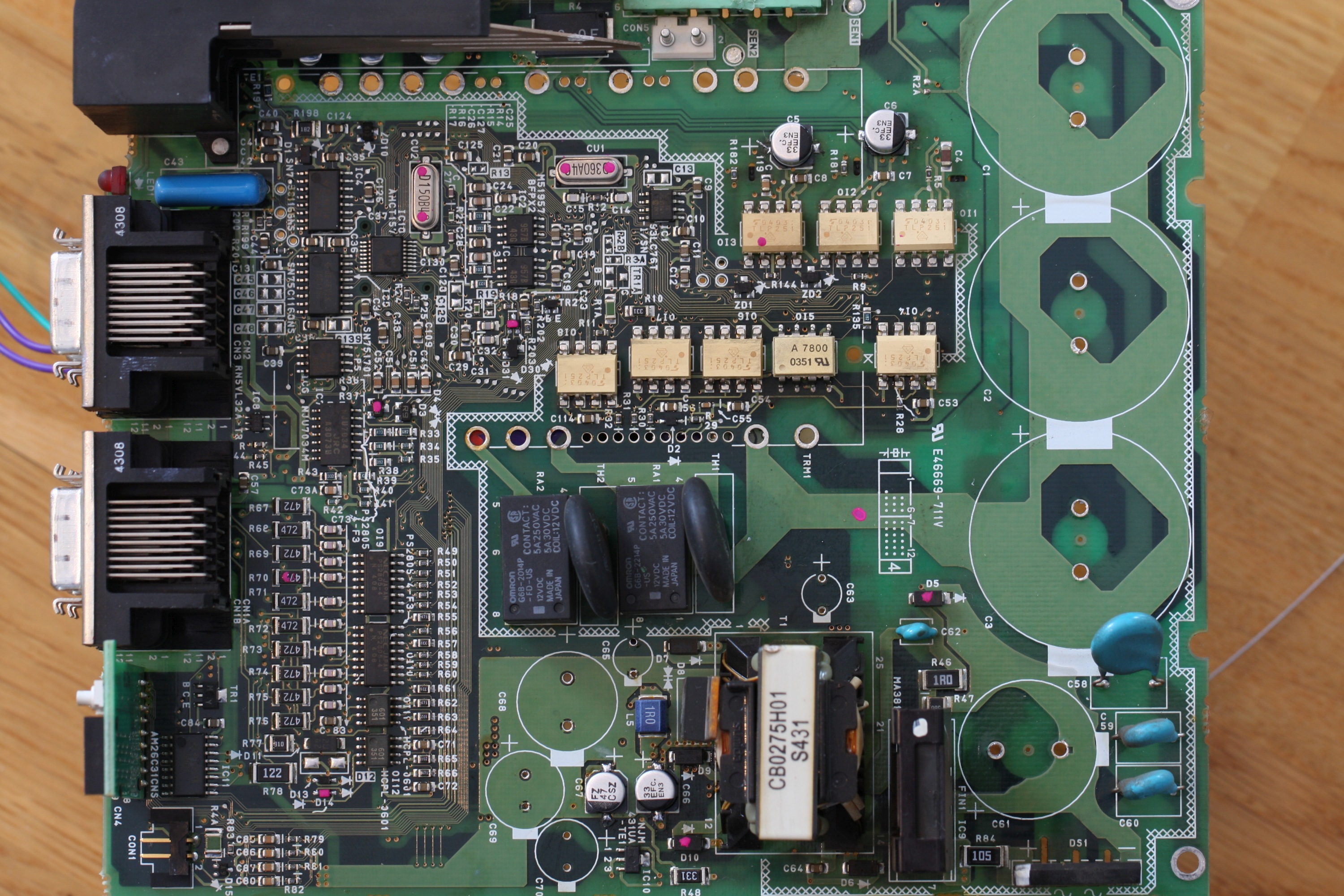

            Sadly I have not found a schematic and it's a pretty complex device so I have not been able to pinpoint which component it is that likes to be heated.
            I'm afraid that it might be something underneath the IGBT module...
            Attached some pictures of mine.
            Here is some company that repairs them and have posted photos with the IGBT module removed:

                    I'll desolder the remaining ones on the other servo and see how they measure up.
                    So far I have values ranging from 4.2 to 40 ESR for those caps
                    Replacing the caps did not affect the bus voltage reading though so I think it's unrelated...
                    That said on capacitor C6 I saw the voltage seemed to vary linearly with the reported bus voltage as I heated the servo up.
                    So that might be at least connected to the bus voltage sense circuit.

                      I guess I misunderstood, just asking but does a working unit report the full 330 volts?
                      • Per Hansson
                        • Jul 2005
                        • 5895
                        • Sweden
                        I'm sure it does, actually I don't have a working unit to try on.
                        Mainly because the communication cable has been, how do I put this, manufactured somewhat in a hurry by yours truly
                        Mitsubishi cable MR-CPCATCBL3M has been ordered though, but with the Chinese new year I don't expect it here quite yet.
                        And then I will need to go to a customer with an actual working machine to verify it on
                        Well, actually I figured out how to do it without the cable as can be seen in this picture, but that was just a few days ago...

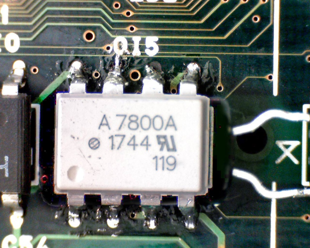

                          I found the culprit, I used -50°C freeze spray to look for the faulty component.
                          As I cooled down O15, a HP 7800 optocoupler the bus voltage reading dropped over 50 volts!
                          Sadly it's located underneath the IGBT module so I had to desolder it.
                          I don't have a new one to test with yet, and there is only one on each servo and it's broken on both it seems...
                          For anyone looking closely these pics are taken of the servo I recapped fully.
                          On it I used Sanyo WX 50v 100uF as replacement for the Nichicon PJ 82uF caps, otherwise it matches the Elfa replacement list I posted earlier.
                          The optocouplers are made by HP and Avago interchangeably due to the latter buying out the former, the part number is HCPL-7800
                          And the current owner seems to be Broadcom, maybe I should go for an upgrade to the "A" version?
                          https://www.mouser.se/ProductDetail/...7QwLI2575o8%3d

                            Re: Mitsubishi Melservo MR-J2S-100A alarm: AL.E9
                            I ordered the "A" version of the 7800 optocoupler linked above from Mouser, actually it was the only one in stock.
                            It worked a treat, the bus voltage reading is now correct

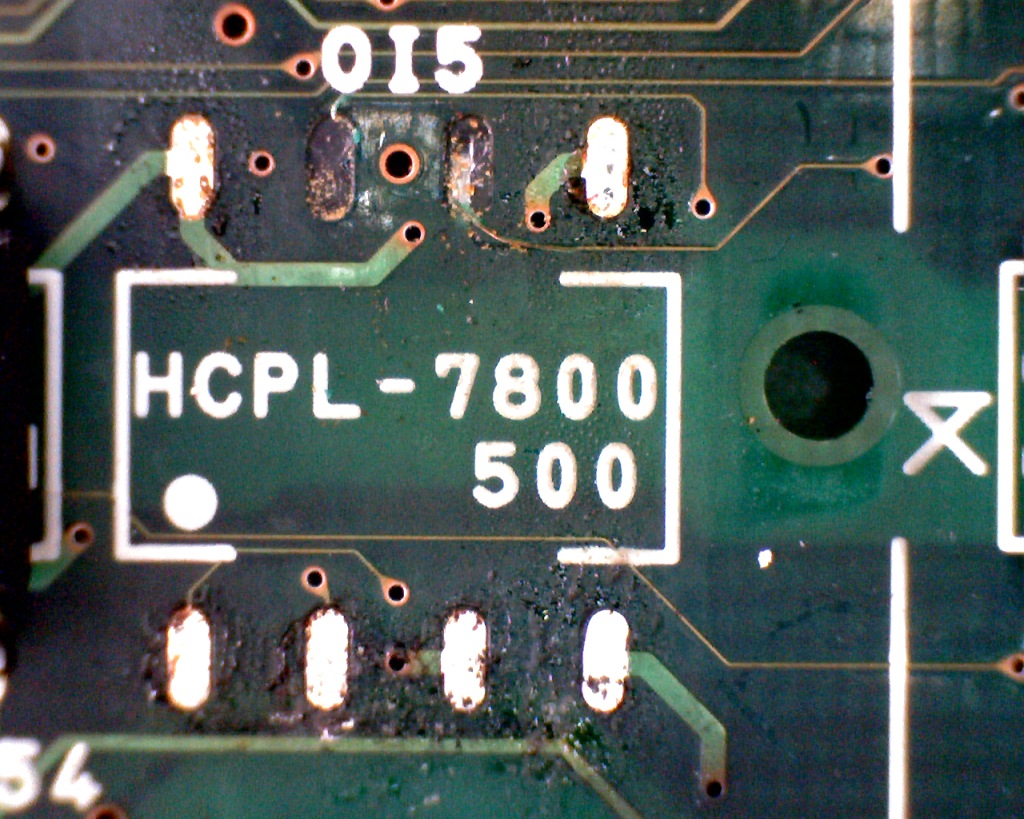

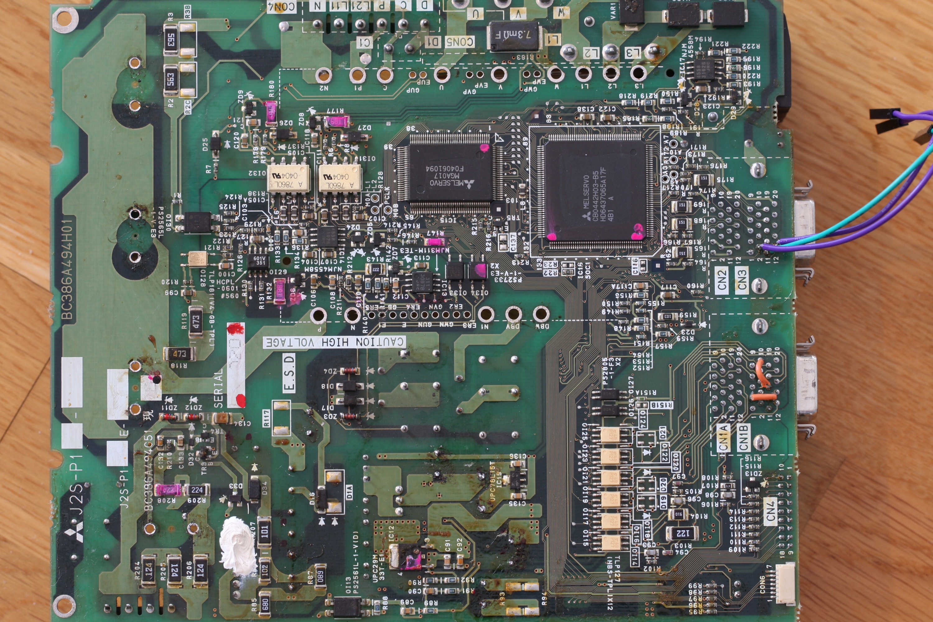

                                Started work on the other servo.
                                Under O15 there was the marking HCPL-7840 #56Y
                                Quite surprising as there was installed an Avago 7800 optocoupler there.
                                On the servo in my previous post the marking is for a HCPL-7800 500 and a HP 7800 was installed as mentioned earlier.
                                (I lifted two pads as I tried to cut the old optocouplers legs instead of desolder them, but I fixed it up ok anyway).
                                I also attached two high resolution pictures of this second servo, front & back without the caps installed, except for the new surface mount caps I have installed).
