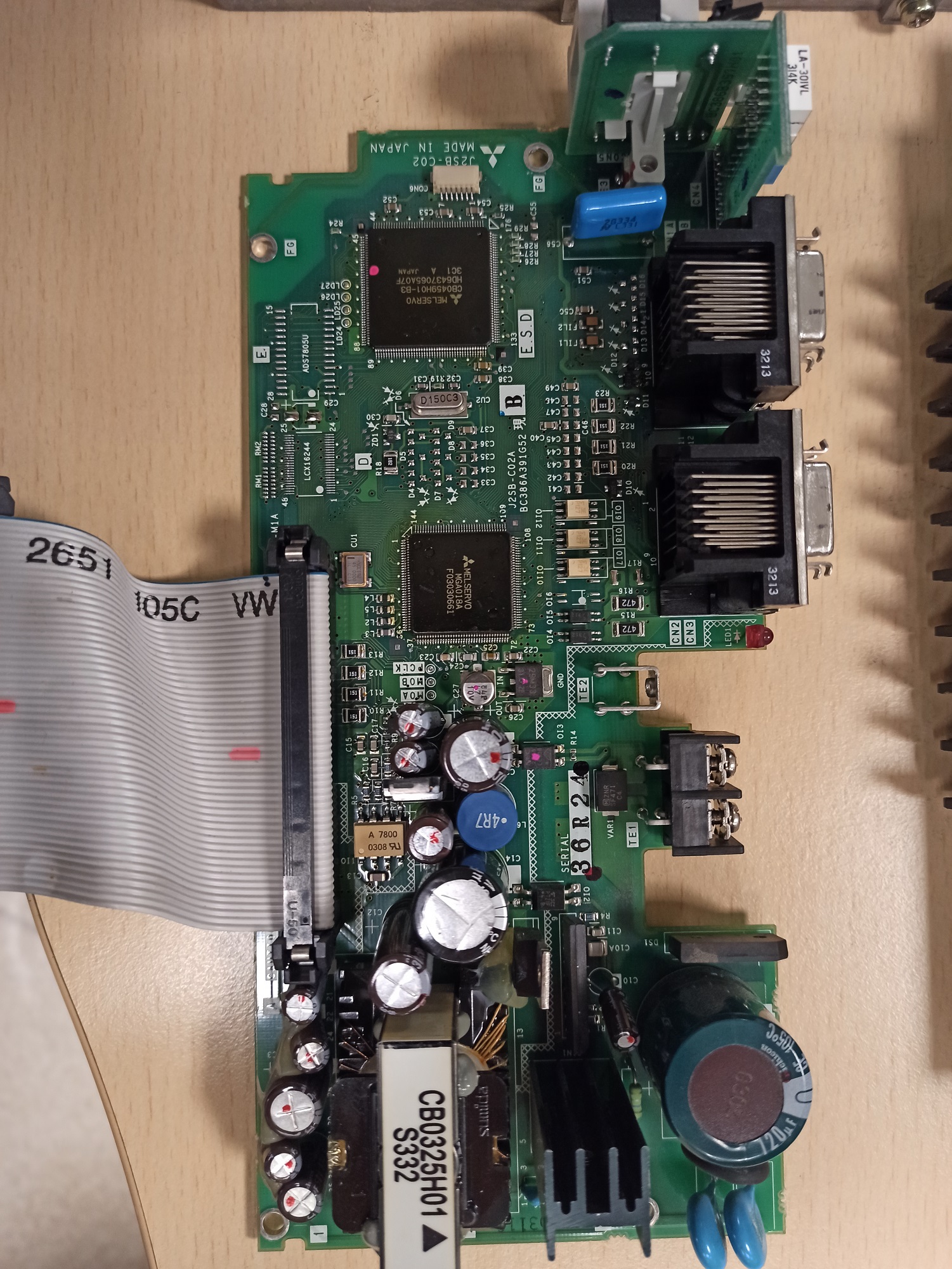

    Hi, the ones I've seen have shown AL.E9 as first & only error AFAIK.
    I work as a service technician, so I get called whenever the customers can't get the machines working again...
    So far I've repaired quite a few of these and had 100% success so far, and no returns...
    Actually I'm near Tampere sometimes for customers too (actually in Lempäälä) but not right now.

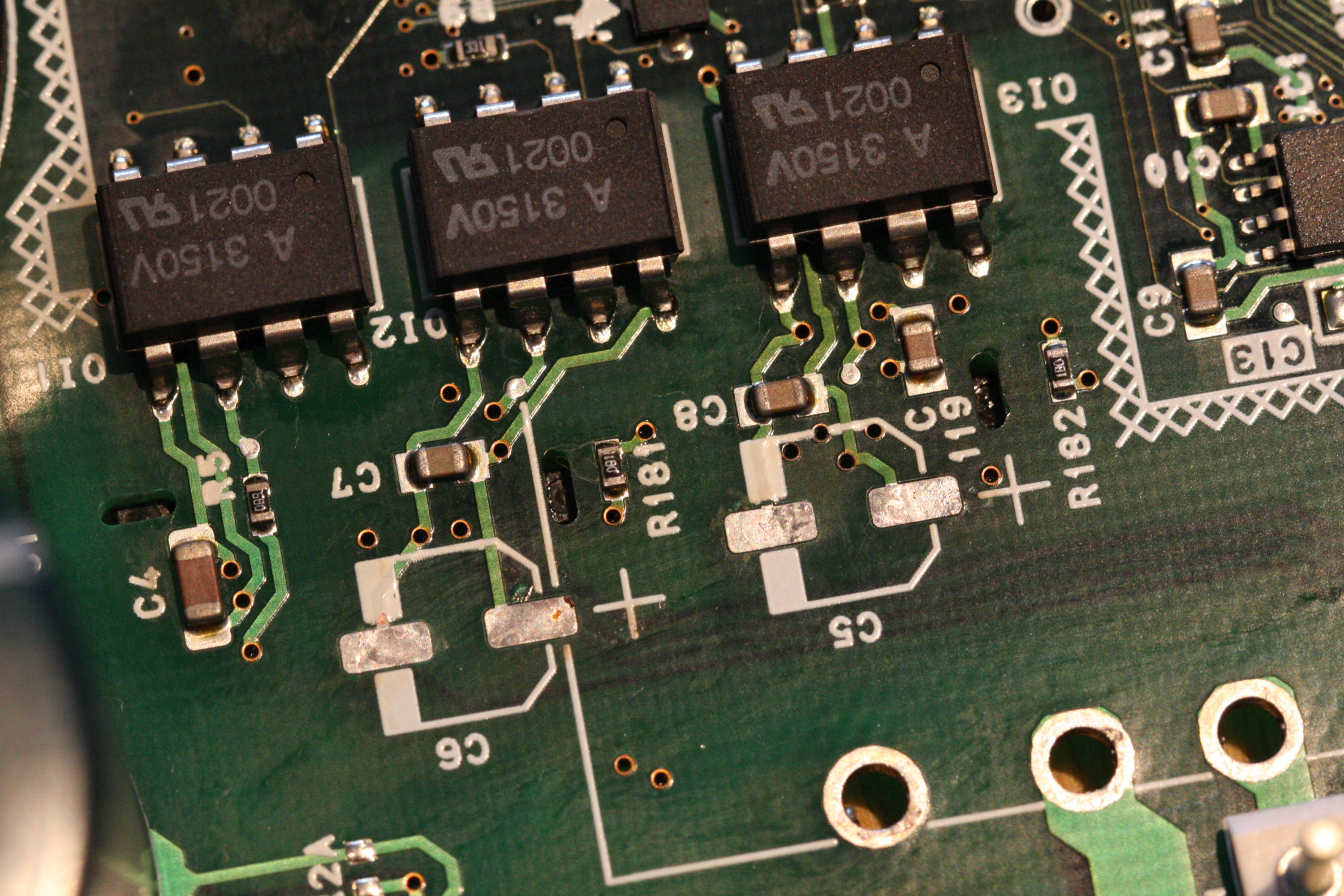

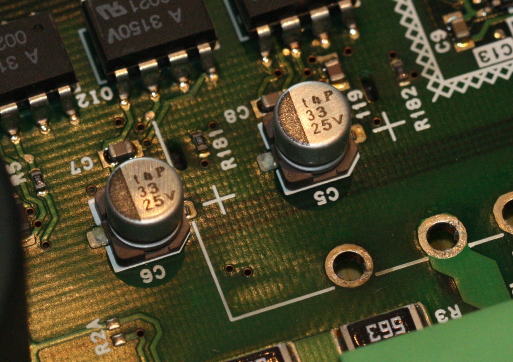

            hi, I made the change of the caps, and the HCPL7800A, in the DC BUS marks me an output of 280 vcd, the equipment was already installed in the machine and I am still working.
            Since I don't have 33uf caps, install some 47uf caps. they believe that for this reason I am giving a bus voltage of 280 vcd, the caps I use are low ESR

              Re: Mitsubishi Melservo MR-J2S-100A alarm: AL.E9

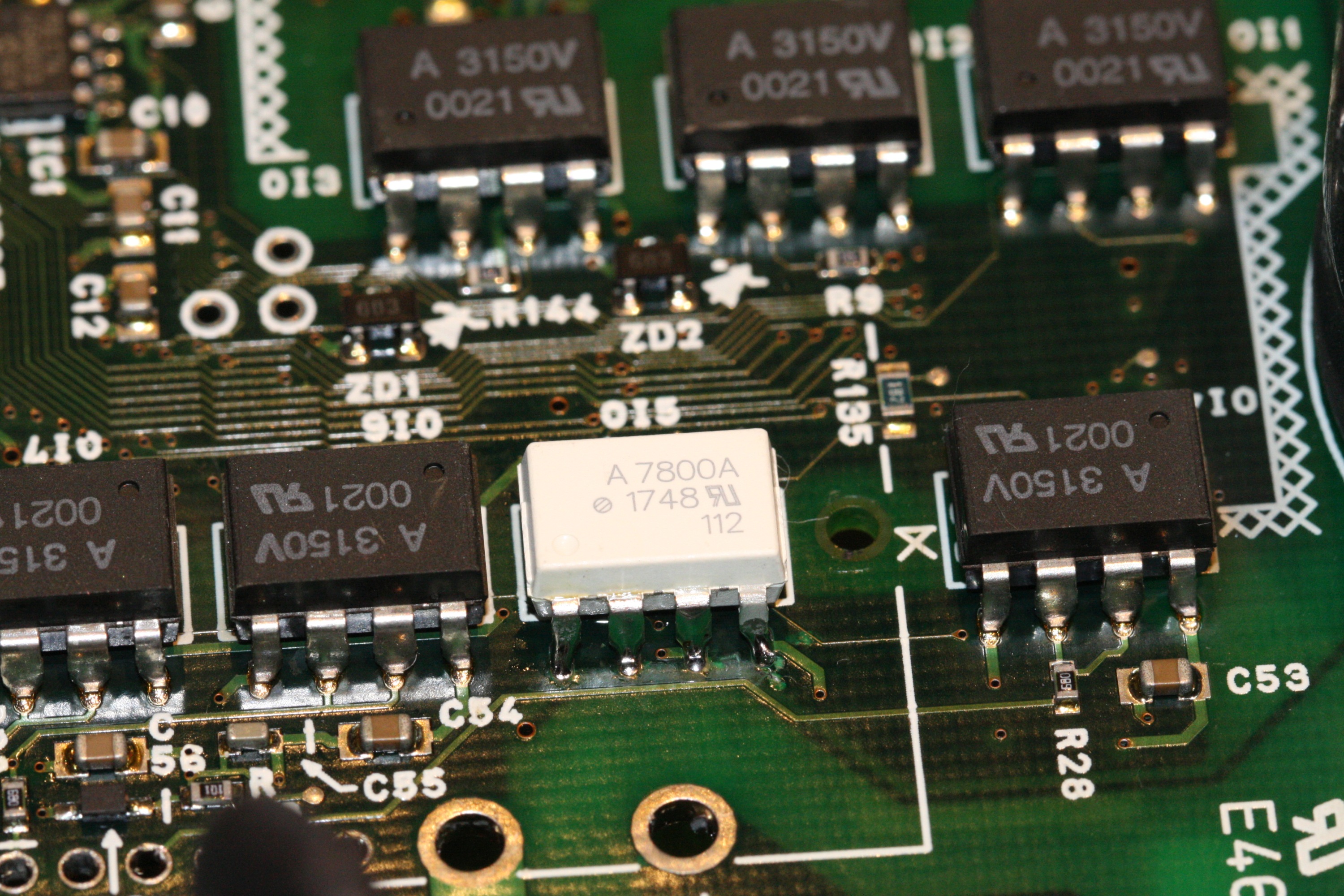

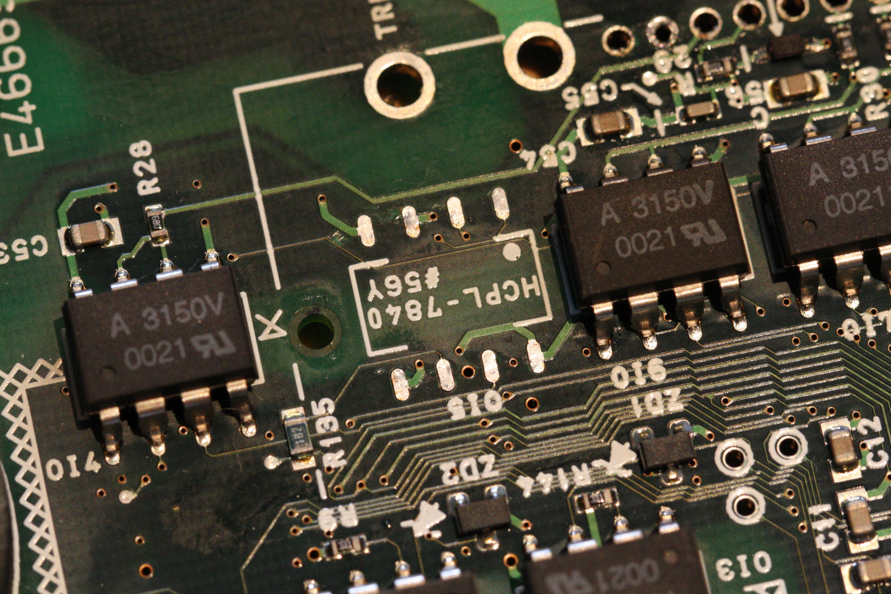

              The bus voltage depends on the incoming AC voltage.
              If you measure 200VAC input then 280VDC bus voltage is normal.
              Calculation: √2 x 200VAC = 282.8VDC.
              If not and you believe you have a heat sensitive component then heat it up with a heatgun carefully and see if the voltage changes.
              Or cool it down and see if the voltage changes.
              This is the way I used to pinpoint that it was component O15 the HCPL-7800 that was the culprit as described here.
              And yes, the servo might be sensitive to the value of the capacitor, especially capacitor C6.

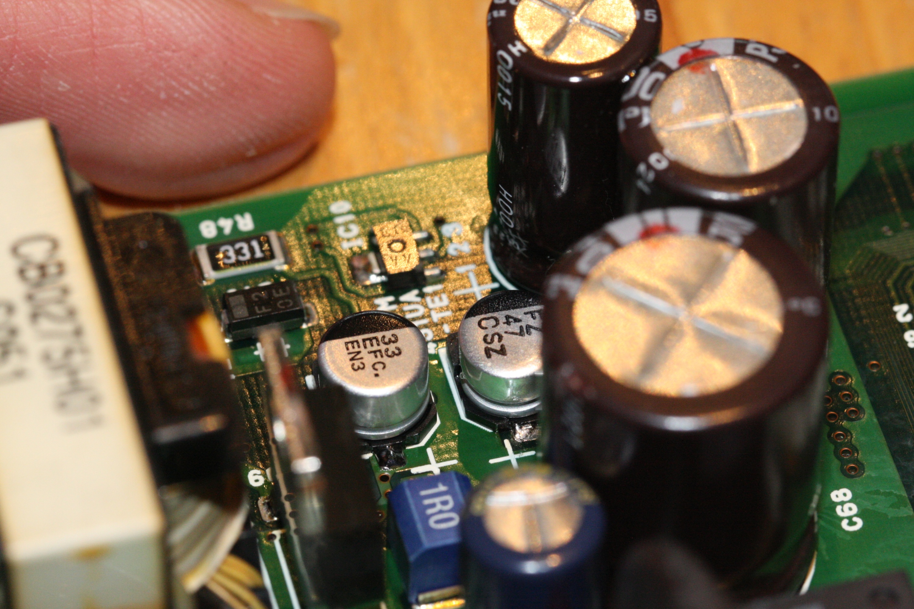

              • jae2020
                • Jan 2020
                • Philipppines

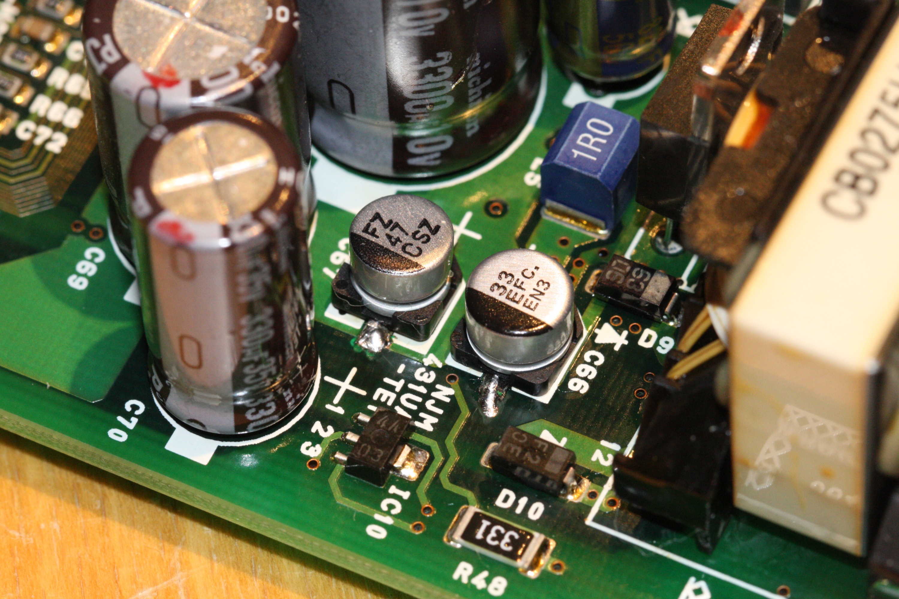

                Hi, these two caps came from a unit that otherwise is full of Nichicon caps:
                Nichicon GQ, GU & PJ manufactured late 2001.
                Got any idea what model they are? (See picture).
                The 33uF cap has an ESR of 40 so it's in dire need of replacement
                I could get it down to ca 5 by heating it with my iron, then matching the other cap...
                I ordered the "A" version of the 7800 optocoupler linked above from Mouser, actually it was the only one in stock.
                It worked a treat, the bus voltage reading is now correct
                Thanks. I solved alarm E9 after replacing this IC.

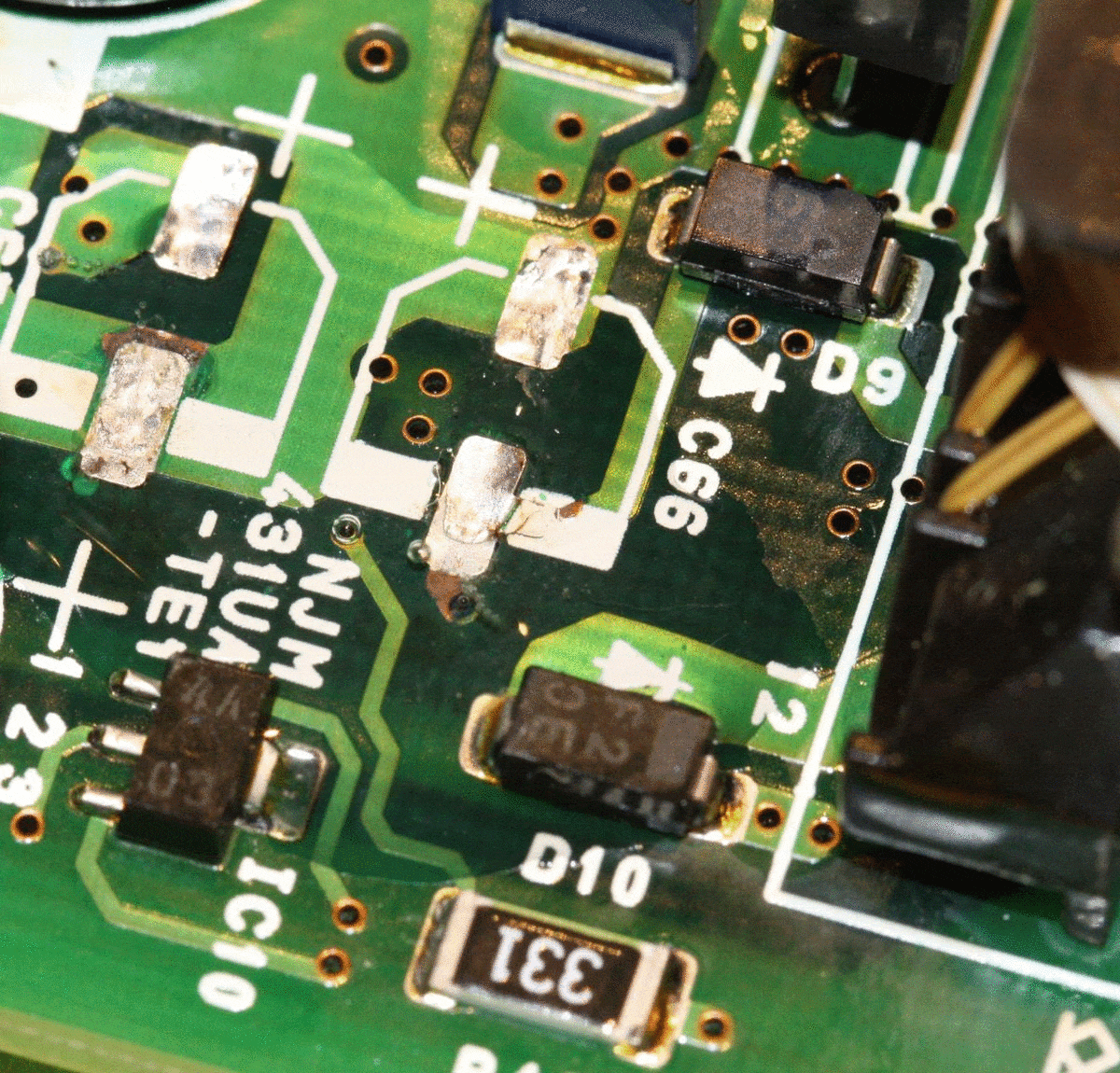

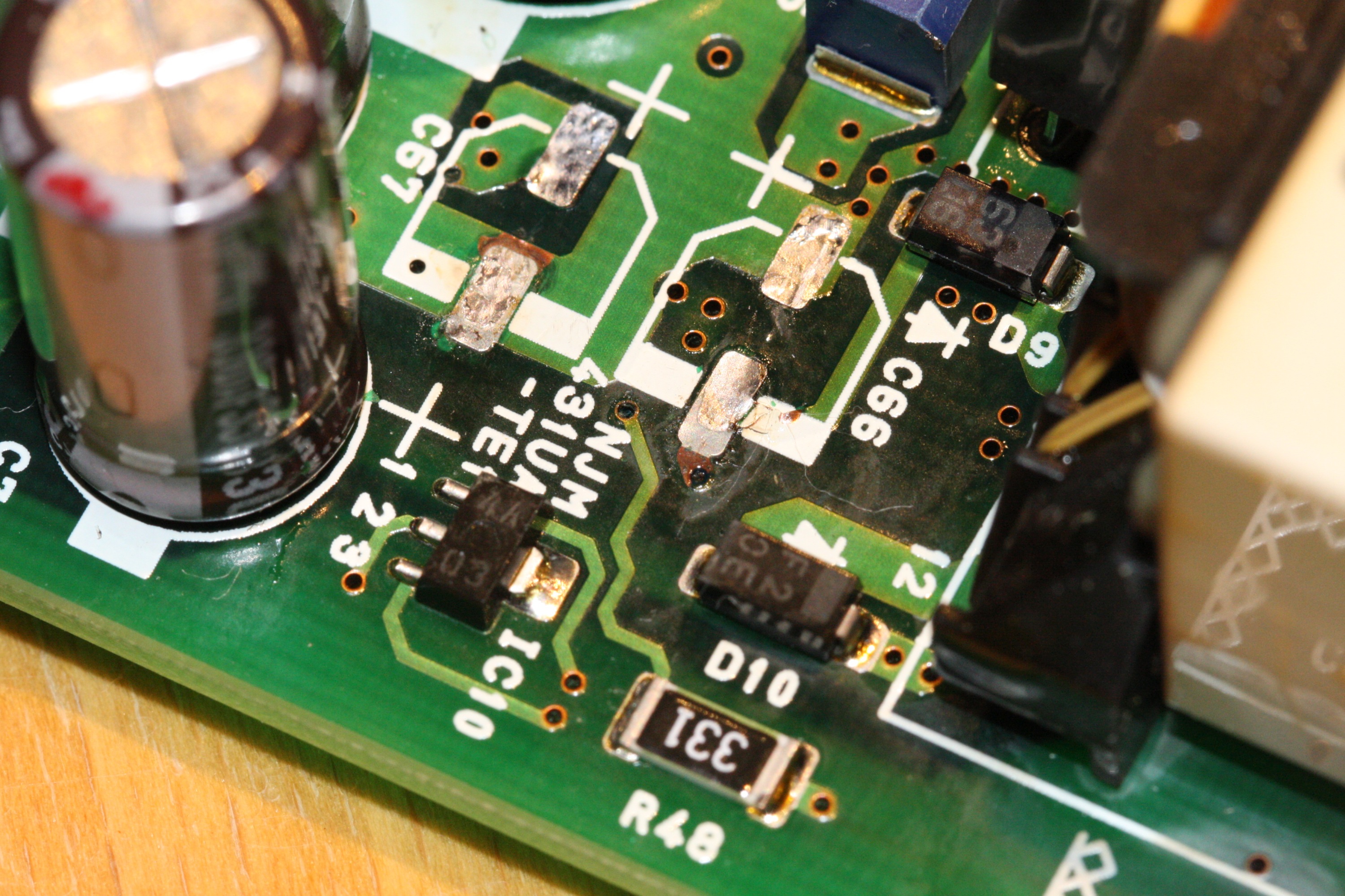

                            • Per Hansson
                              • Jul 2005
                              • 5895
                              • Sweden
                              #34

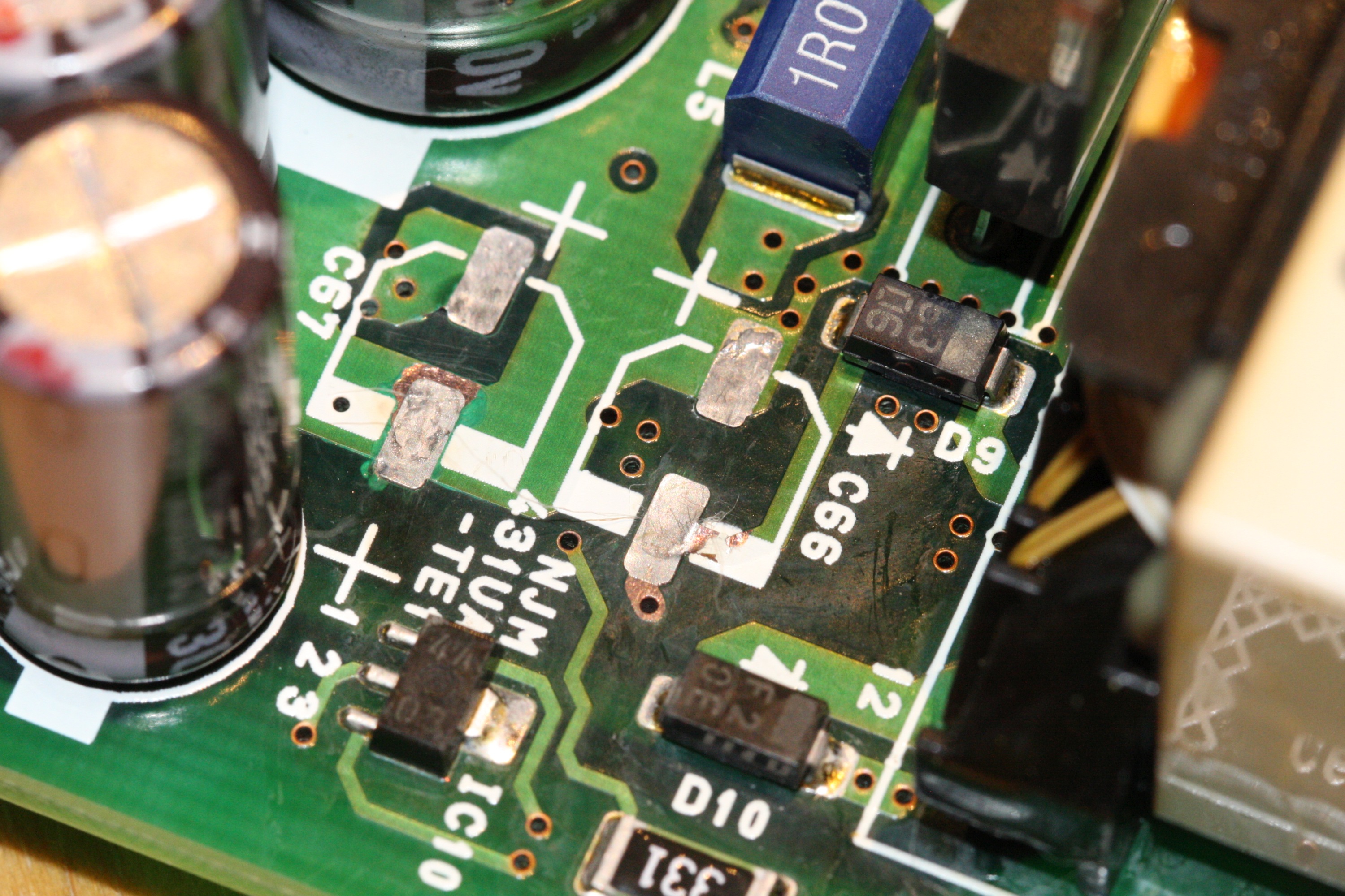

                              Nice to see so many new members in this thread, welcome to Badcaps!
                              On that theme I present you the latest repair:
                              I was hoping for it to be an "easy" fix but for the first time was greeted with leaking SMD capacitors in this servo!
                              The electrolyte had started attacking the through hole vias and crystalline formations had formed on the negative legs.
                              I used acetic acid and it worked a treat, I did not photograph the acids process in the first two caps but after what I saw was ready on the next couple.
                              I made this little GIF showing the action, the board turned out great after the cleanup thankfully!
                              P.S: I attached several high resolution photos of the before/after process as well, oh, and the SMD caps measured around 80 to 140 in ESR!

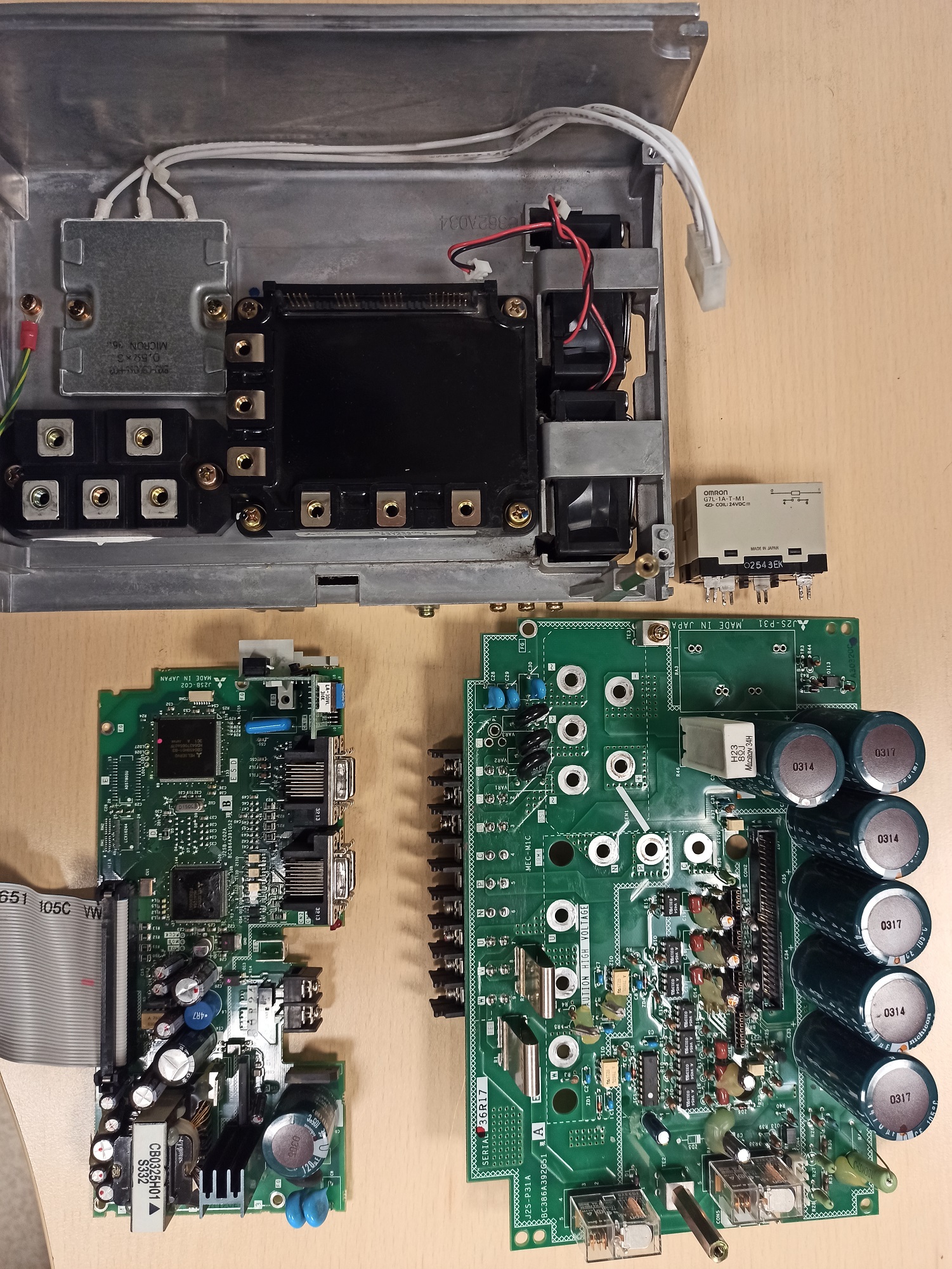

                                        hi all, i'm new on this forum , and i happy to read this post because I have the same issue with a Servo Amp mitsubishi MR-J2S-500B. i'm sorry for my bad english, please don't be angry!
                                        I have 2 servo whit the same E9 one of two go to the repair society but they are not sure troublesoot it .
                                        so i want try troubleshoot the second by my self!
                                        m'y servo amp , show me an E9 and in the the datta sheet is :
                                        AL.E9
                                        Main circuit off warning Servo-on (SON) was switched on with main circuit power off.
                                        Switch on main circuit power.
                                        but this servo ( an 3 phases input) is powered . it smell the same error like you on your mr-j2S-100
                                        on your precedent mesage you say read the bus voltage I suppose you talk about the DC rail after the PD3( 3 phases Graetz bridge).?
                                        on this version of SAMP i' d'ont have button to enter the menu. and i d'ont have pilot systéme so is hard to make measurment.
                                        with your experience, i found one opto 7800 but is not near the DC rail is on the smalest PCB but i can change it !
                                        near the DC rail i found 0I12 , is an opto TLP621 and it's Diode is concted thougth the resistor to the DC rail i suspect a probleme with it.
                                        on my PCB OI15 is not a 7800 is V454.
                                        if your have idea i'm very interested about it!
                                        thank you so much

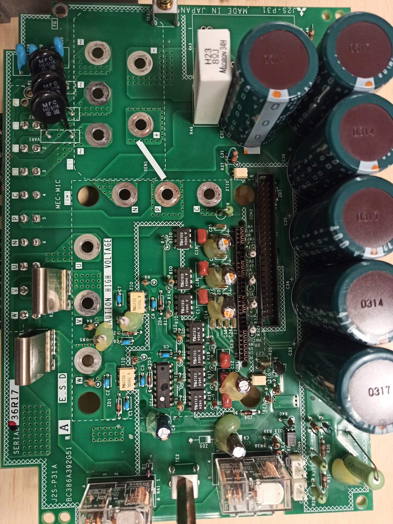

                                        • Per Hansson
                                          • Jul 2005
                                          • 5895
                                          • Sweden

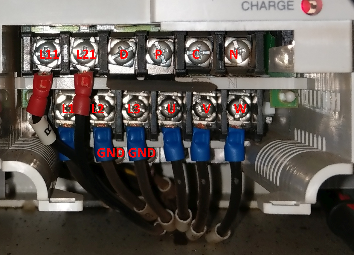

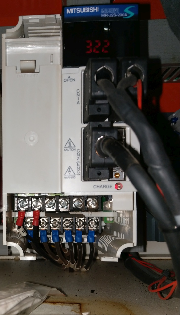

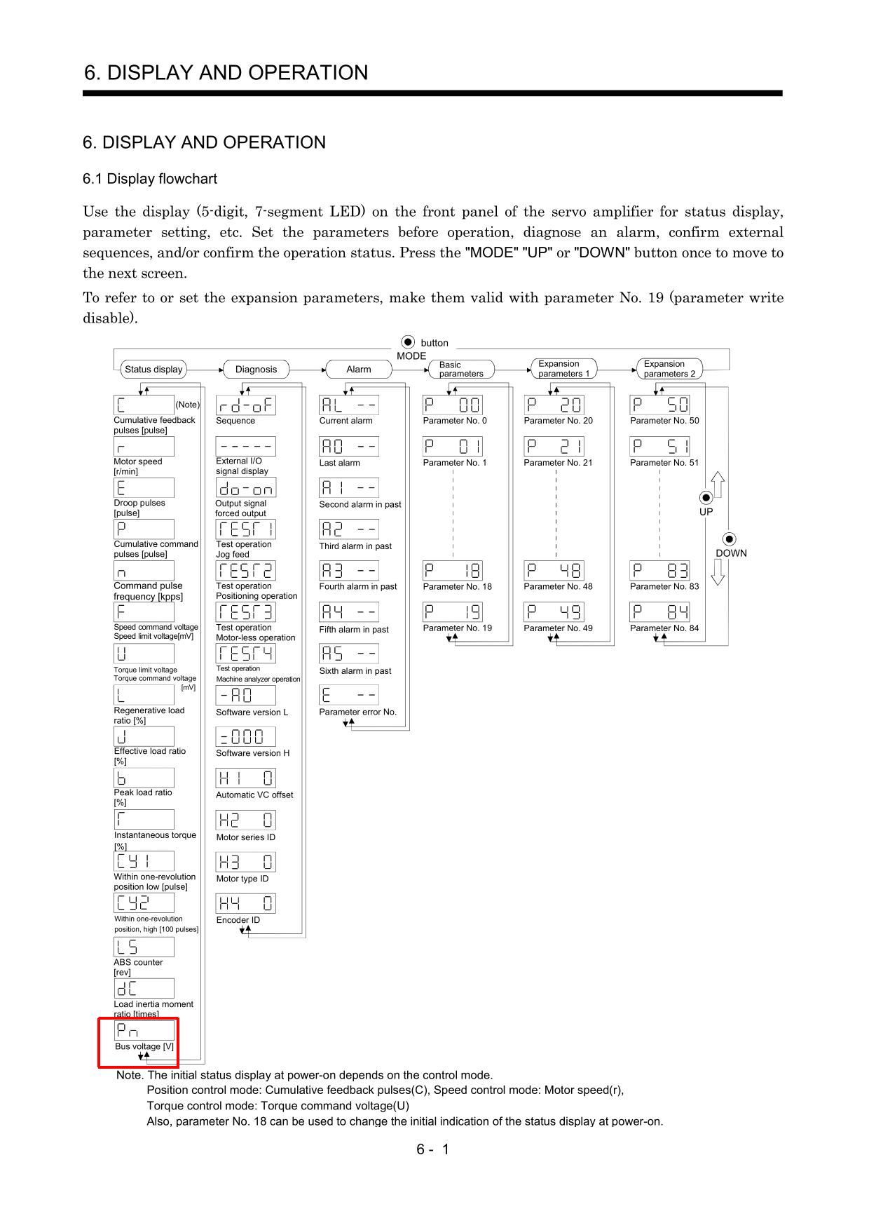

                                          #40
                                          Welcome to Badcaps!
                                          Your servo also has the LCD display, it is just in another location.
                                          I attached photos of a 200A servo here, you can see the display behind the cover shows 322v.
                                          This DC voltage you can measure between terminals P & N that I labeled in the photo, it should be similar in your servo.
                                          (It is only the small servos (80A and below) that do not have one of these two terminals).
                                          But in any case you can use cooling spray: so cool down the opto you suspect and watch the "Pn" voltage in the LCD display:
                                          If you find the right optocoupler it will drop allot!
                                          P.S: I attached the display flowchart!
                                          Last edited by Per Hansson; 02-18-2021, 10:47 AM. Reason: Attached photo display flowchart
