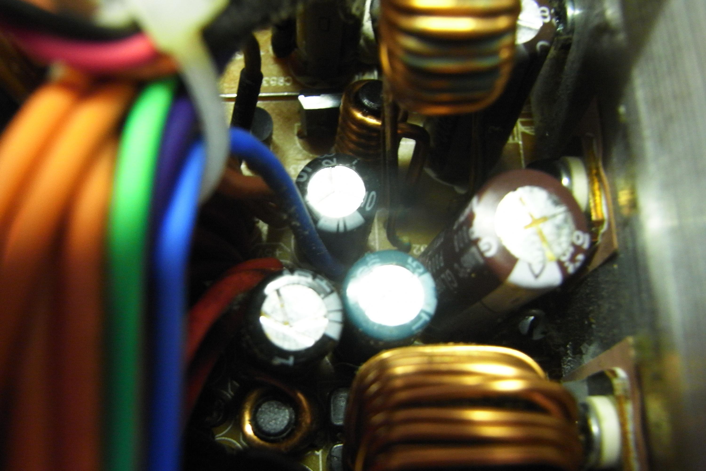

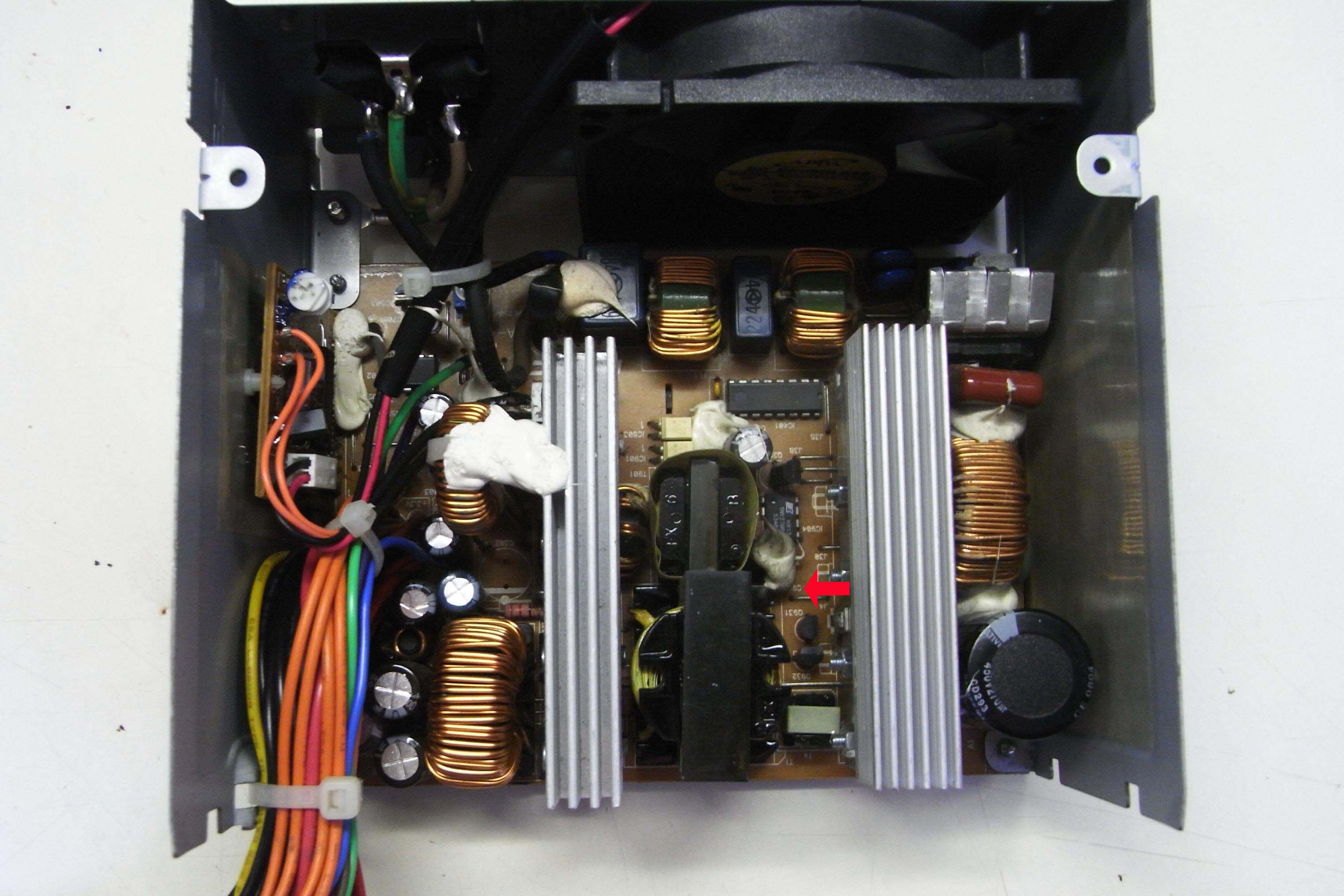

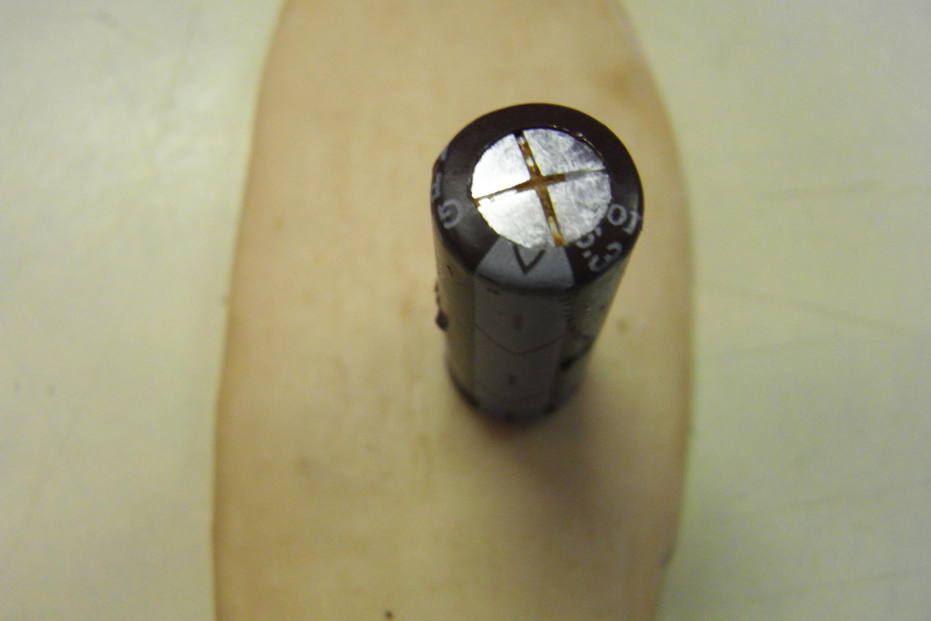

                  There is no voltage on the purple wire to ground. Please note the errant cap has been removed from the board.
                  Here are some pics. If you require others please advise.
                  The RIMG0816 file shows a close up of the brown errant cap placed in situ.

                      I see several different capacitor brands, is the dead one a Samxon GL or CapXon GL?
                      Anyway you might get away with only replacing it and if there is any others of the same model I'd replace them too.
                      What you need to check is if this capacitor is related to the 5VSB circuit, to do that we need a good clear in focus picture of the underside of the PCB.
                      Or you can trace it yourself, the 5VSB driver seems to be a TinySwitch TNY278PN.
                      There are example circuits of it on the net: https://cdn.badcaps-static.com/pdfs/...b56d9fb7b3.pdf
                        Looks like a G-Luxon from the 2nd pic, can't really make out the series though.
                        X2, Delta reached into their "capacitor grab bag" for these PSUs (the same applies to most of their "budget" models), so you'll likely find a mix of Japanese (Nichicon, Rubycon, Nippon-Chemi-Con) and Taiwanese/Chinese (L-Tec, Lelon, G-Luxon, Samaxon, Taicon) caps. The Japanese caps are likely still good, and any Taicon (Taiwanese partner of Nichicon) and Samaxon (except possibly GF series) have decent chance of still being good as well, while the L-Tec, G-Luxon and Lelon caps are probably best replaced.

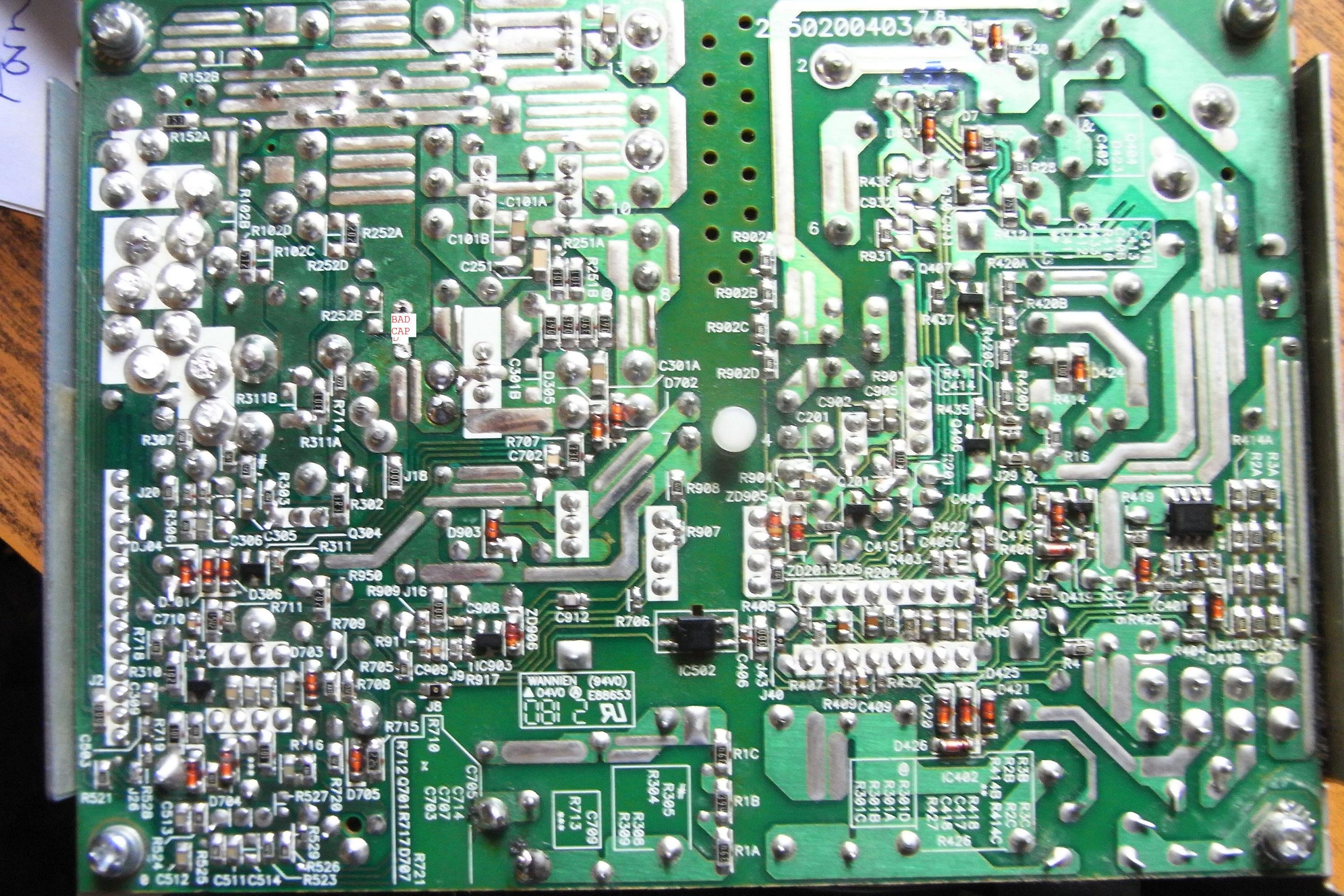

                          The blown cap is a CapXon GL 3300 uF 6.3 volt.
                          Here is a pic of the underside of the board with the blown cap removed . Its position is marked up as BAD CAP

                            Re: ANTEC Power Supply EA-430D - Suddenly dead!
                            I'm not power supply expert, but on premise that best way to get correct answer on Internet is to post wrong answer, my 2cents worth ...
                            Having zeroVSB, what you've measured from purple to ground wires, might be fixed by replacement of small capacitors in the middle, between the two heatsinks
                            In your first picture, first candidate may be hidden under white glue - is there a small capacitor at the place marked C9something or just C9 on the printed circuit board ?
                            If its replacement doesn't resuscitate 5VSB, try replacing cap that is visible in your pic
                            If that doesn't fix it,
                            But if you restore ~5VSB, power supply may well start

                              I am not sure what C9 you refer to but adjacent to the purple lead there is C 953 1000 uF 10 v . I attach a sketch of the cap layout with all the information I can ascertain without cap removal.
                              Hope this helps and regards.

                                Please refer to pic
