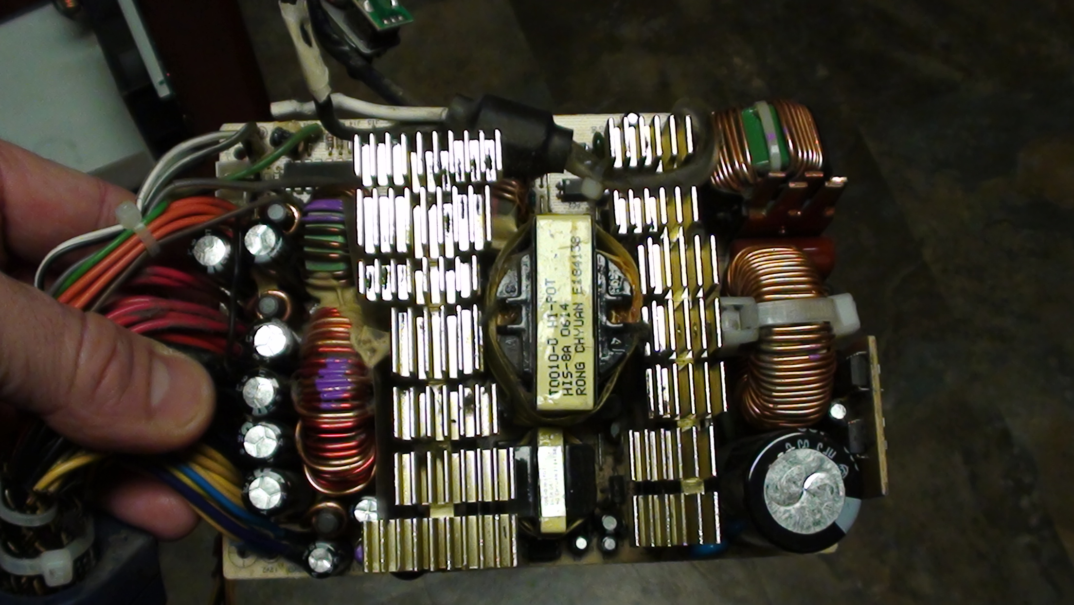

                      Re: Recapping a bad EnerMax NoiseTaker II Model EG701AX-VE(W) PSU

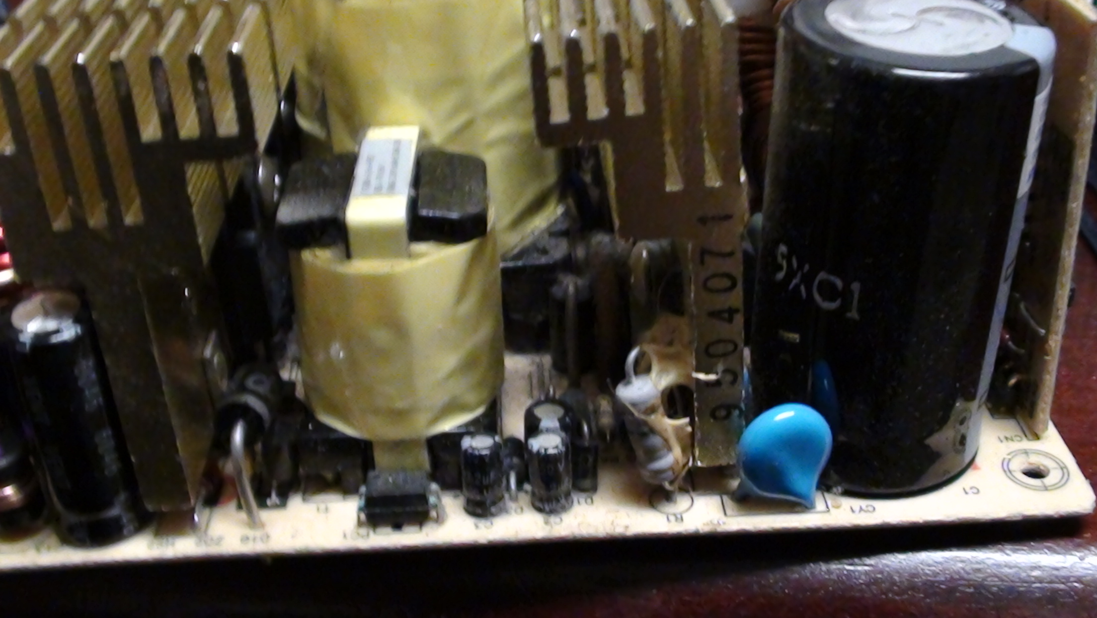

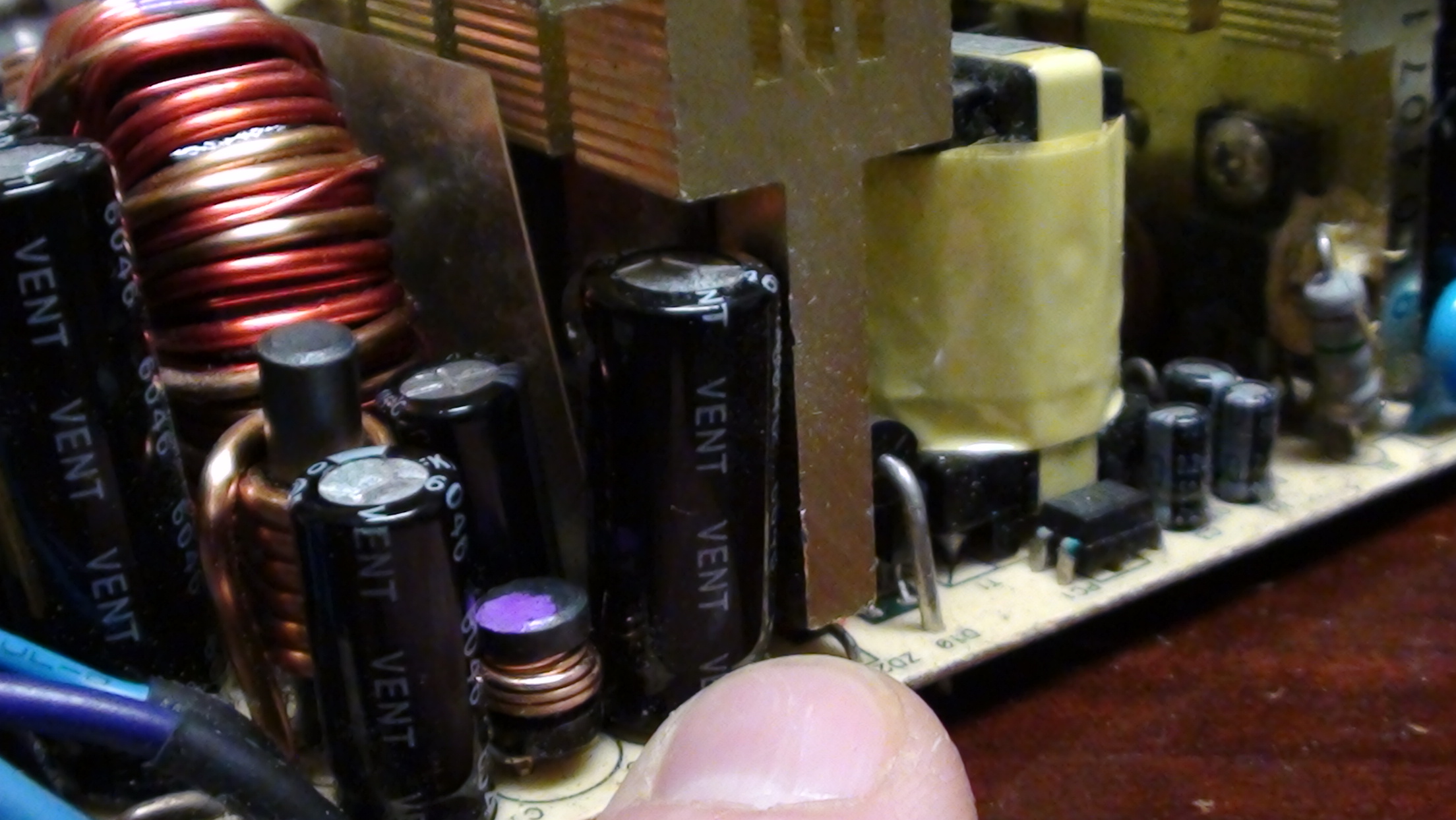

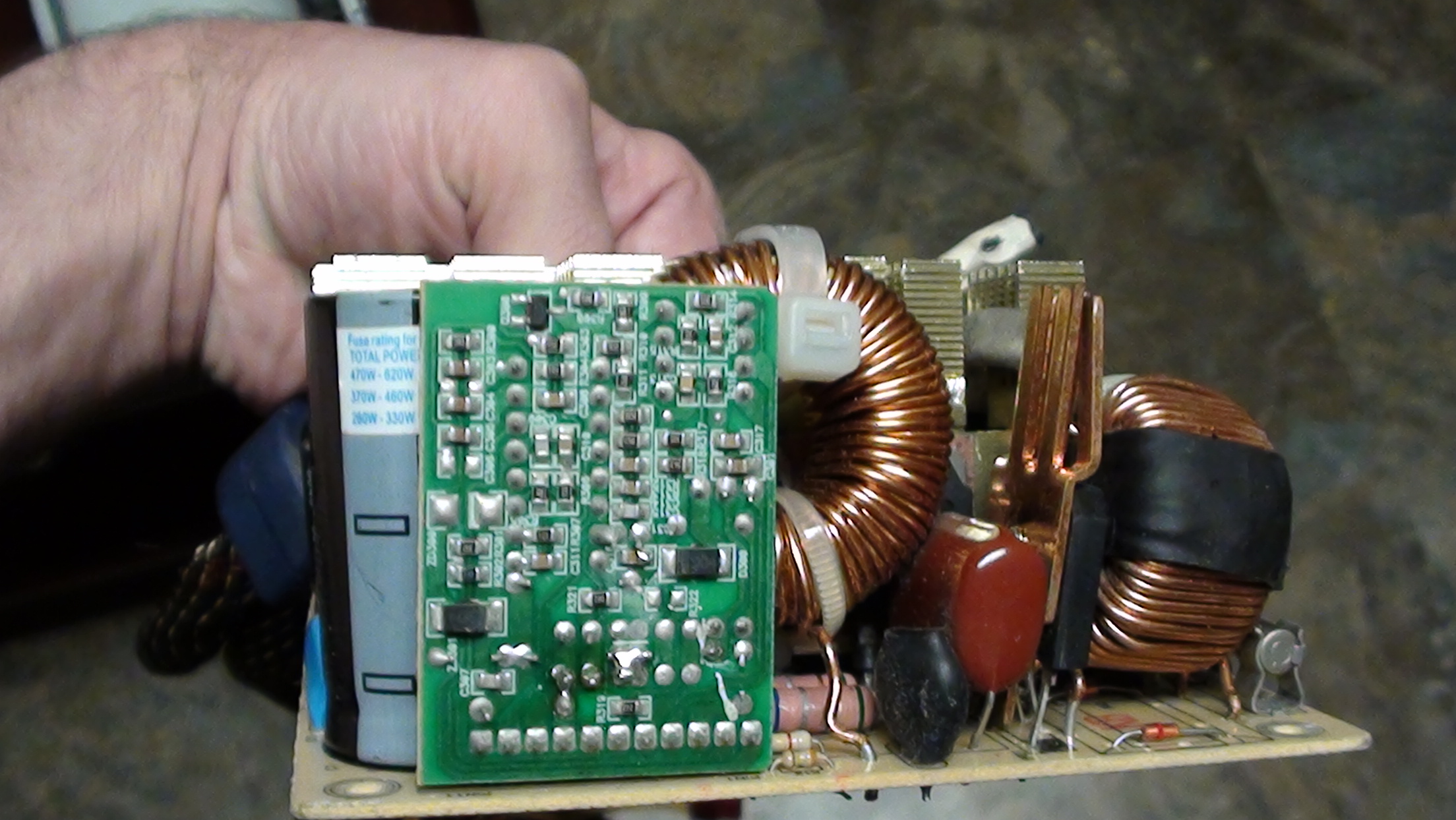

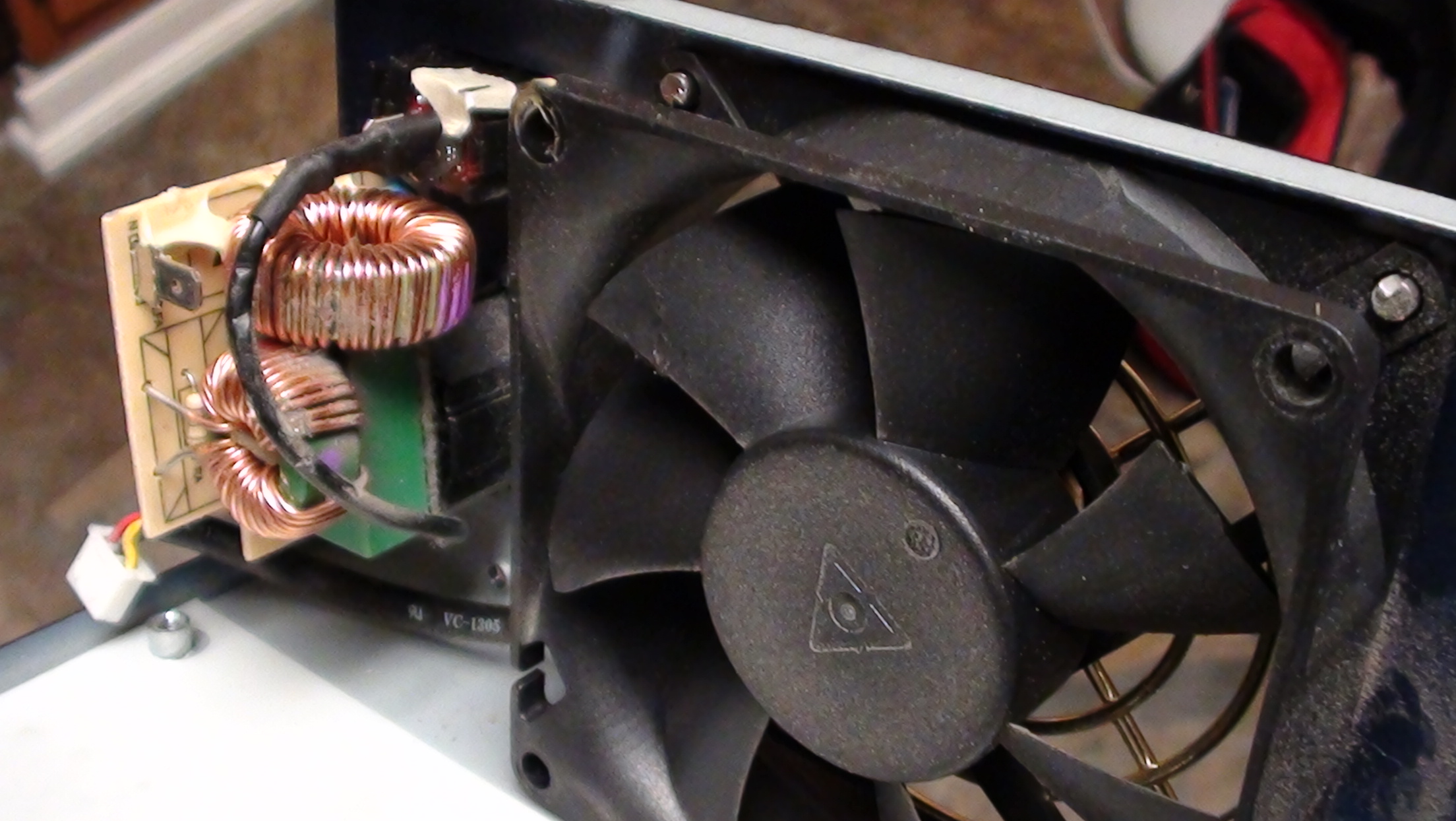

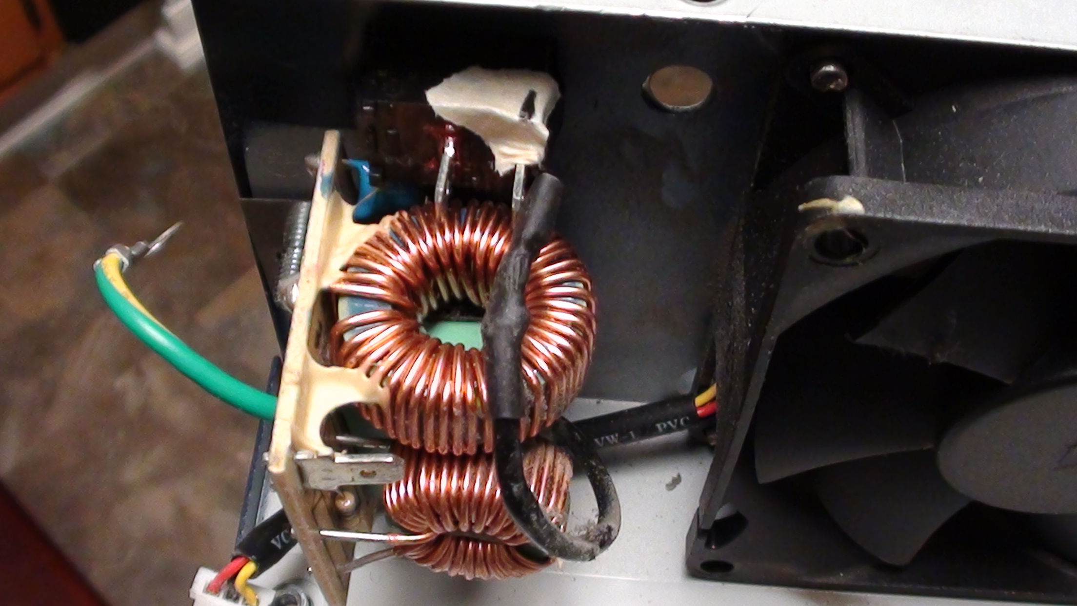

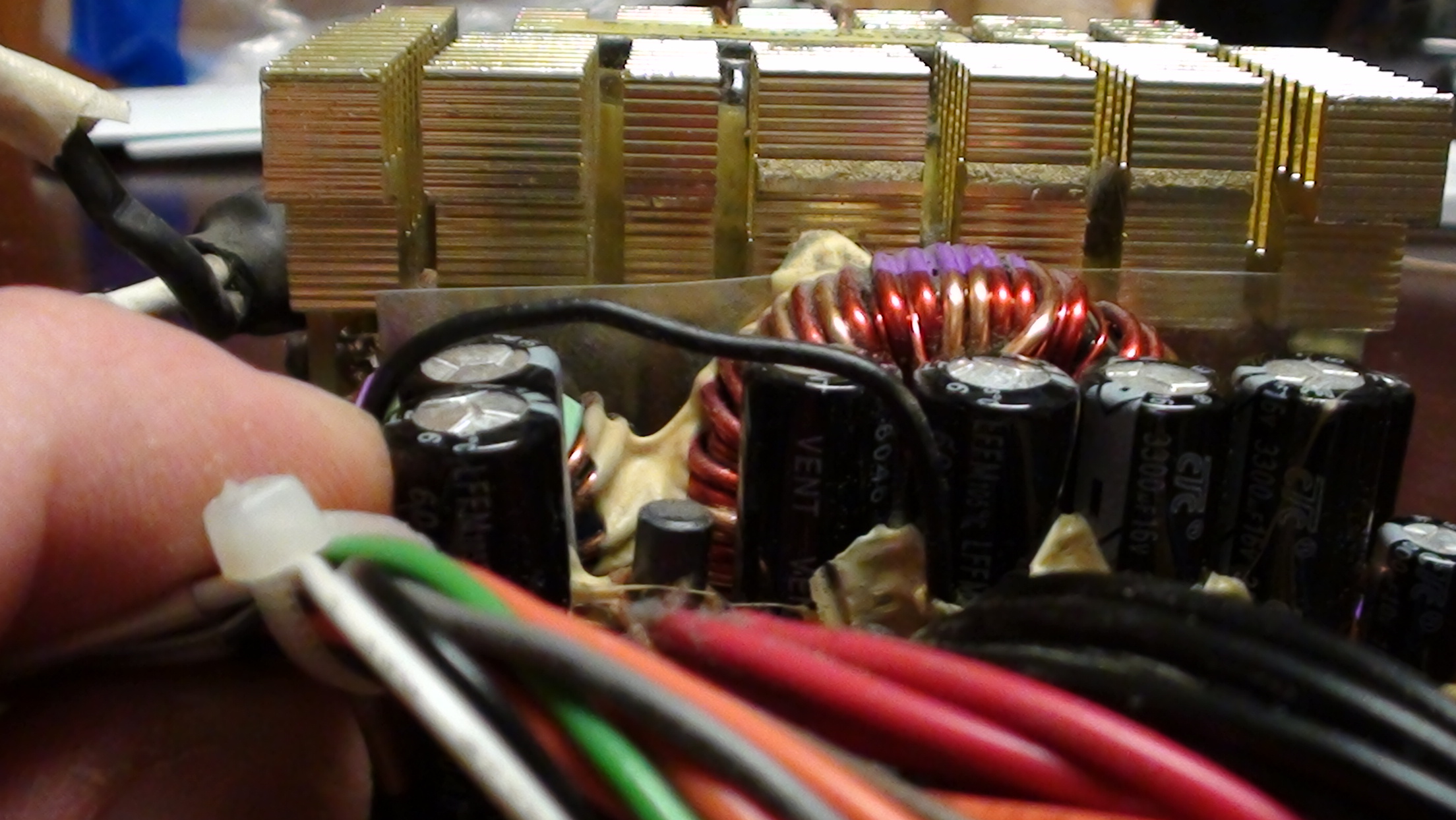

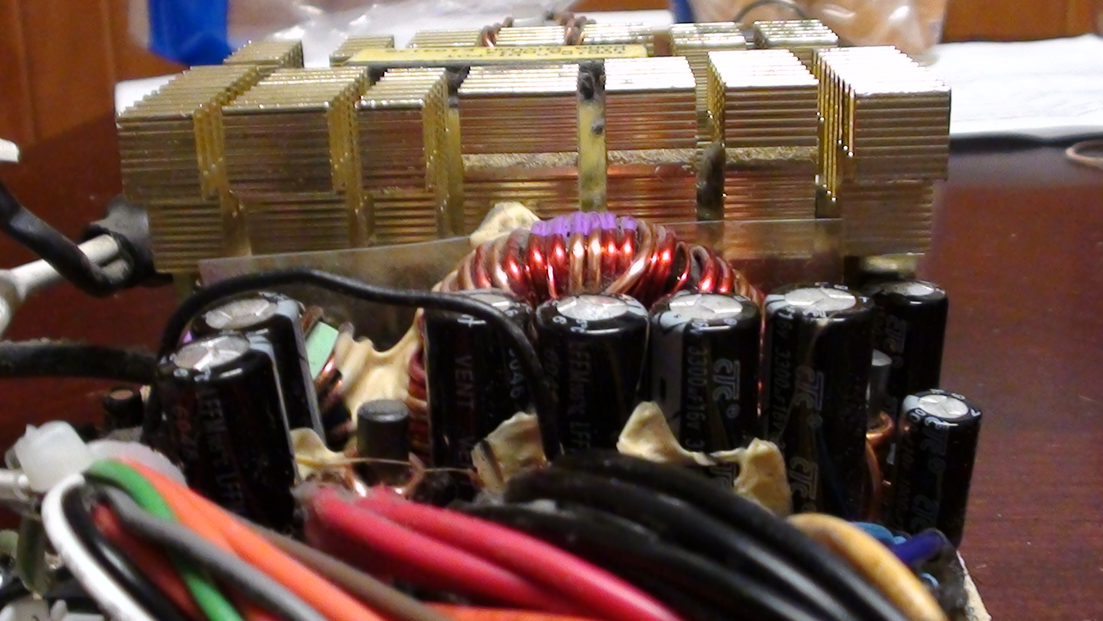

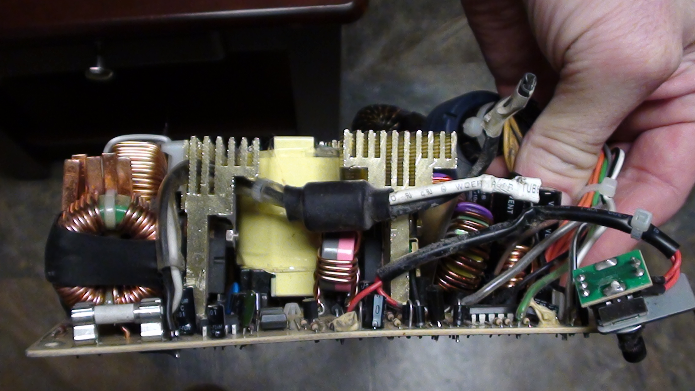

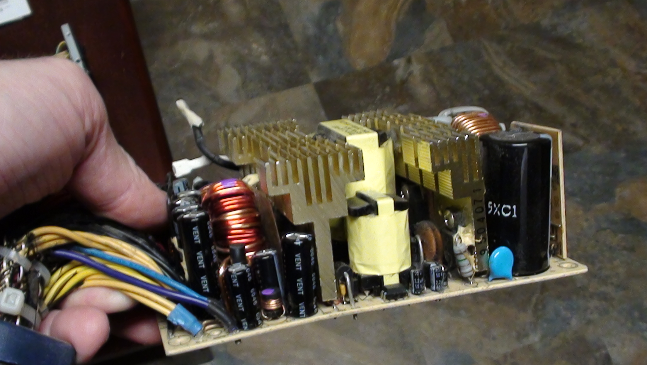

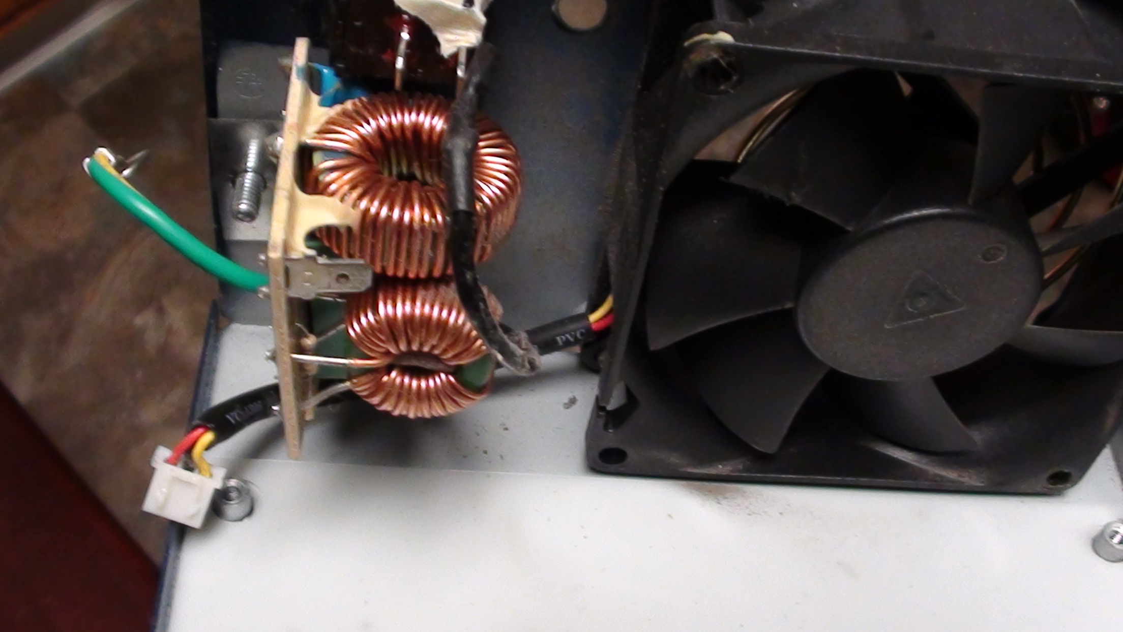

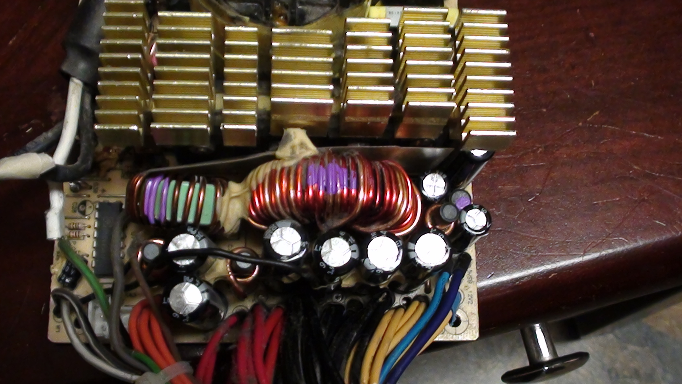

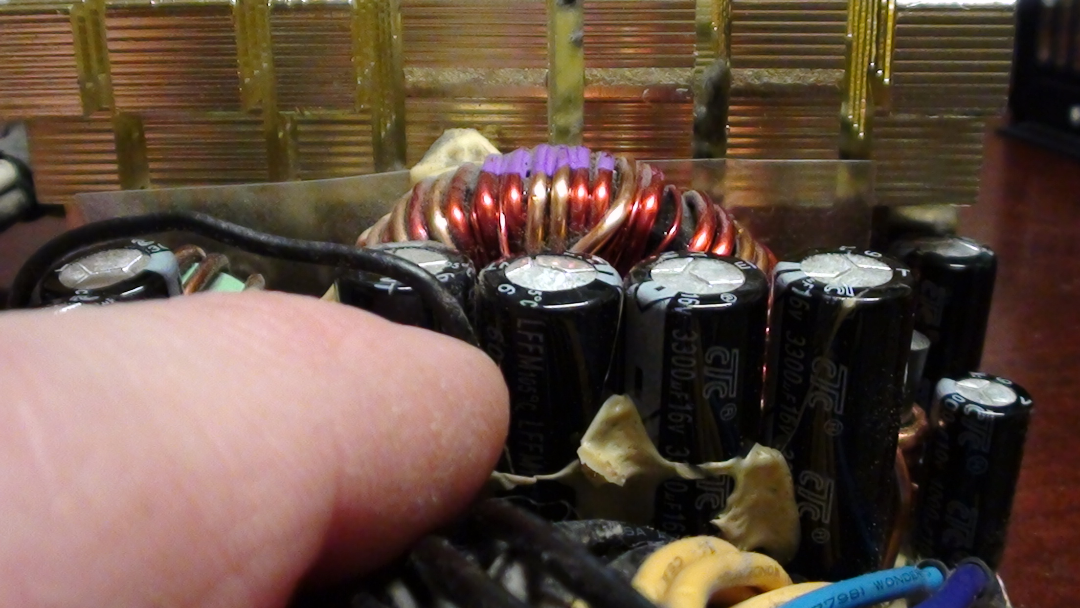

                      Here's a bunch of pictures of all the PSU except for the underneath. In the first couple pictures, you'll see the circuitry that automatically detects if it's 240VAC or 120VAC (I believe). There's one of those funky plastic looking blue ceramic looking capacitors (I think it's a cap). Not sure what those are for certain. I've always wondered and tried finding out but I always question what I find on the internet about them. Anyway, should I be replacing those weird blue things as well?
                      There's 11 small caps, but two are on a daughter board in front of the big 400v cap. Getting to them might be hard. I'll have to unsolder the entire daughter board (11 pins). But I can do it.
                      Then, including the large 400v PFC booster cap, I count 10 capacitors. The underside of the board looks dirty. It has this white stuff on it. I'm not sure what it is. I've seen it before. It's kinda like a dried on powdery substance or something. Maybe some special kind of flux or something? I'm tempted to try washing it.
                      I bet this would be a real nice 600 watt power supply when it's been fully recapped.
                      Also, I want to know how I can always identify exactly what parts belong to the primary side and what parts belong to the secondary. I can get a general idea. The big cap is on the primary side. The transformer appears to have one part on the side with the big cap, one on the secondary side. But sometimes, the power supplies aren't one half the board primary, one half secondary. Sometimes, the primary is only in a corner of the board, and unless they mark it with a big line or a big space somewheres, I wouldn't be able to tell just by looking. Is there a simple way? Do all of them have the big trace or gap on the bottom side?
                        I think I've learned it's the filter caps on the secondary side that have failed. I think that daughter board, the one that has two small caps on it, it has two ICs as well. I think they're called Power ICs. Not really sure what those big donut looking things with the metal wrapped around them are, but I think that's what gives this PSU it's weight. I thought originally those things were toroidal transformers, but I see two other types of transformers on here. I don't know how to tell if they're step up or step down transformers, but I think they're one of the two. They're the ones wrapped in yellow tape that have all the pins on the bottom of them. I think their job is to convert the AC to DC, but I'm not 100% sure.

                                Originally posted by Spork Schivago
                                I was almost thinking of replacing that big cap as well. I mean, if we're recapping the whole board, I would personally feel a lot better knowing I put high quality parts in.
                                didnt u say later on in your post u wanted to only replace what was necessary in an attempt to cost cut smartly? the hitachi japcap is fine and doesnt need replacing. just leave it. a dollar saved is a dollar earned.
                                It's a Nichicon LGR series but doesn't list the impedance at all.
                                these are general purpose high voltage caps so no esr or impedance is stated. general purpose caps are used as pfc booster caps so u dont need to match esr/impedance for the primary or pfc booster cap. just match the voltage, capacitance and ripple rating.
                                What do you mean the primary cap? Is that the large 400V 390uF PFC booster cap you were talking about?
                                for pc psus, yes thats another name for it.
                                Polymer electrolytic capacitors
                                a what?! while i like wikipedia and the wealth of information in it, sometimes poorly written stuff like that oxymoron comes up. a polymer is a solid, an electrolyte is a liquid. how can something be both a liquid and a solid at the same time?! it doesnt make sense and hence an oxymoron.
                                granted there are hybrid caps that use both solid polymer and liquid electrolyte in them. those should be called hybrid or functional polymer caps. calling it a "polymer electrolytic capacitor" is just plain confusing to newbies. or it could be like dmill said, only modern recent designs use polymers. older designs can only handle electrolytics.
                                So, Nichicons and Chemicons are lower quality caps than Rubycons and Panasonics?
                                no. they just consider themselves to be a branded name and so charge a premium for their stuff. each of these brands all have their own 10k hour cap so as far as japcaps are concerned just go with the cheapest one with equal specs. u cant go wrong with any of the big four japcap companies.
                                I was thinking of using the best capacitors that I could get for each component. I mean, within reason. For example, if there's some cap that doesn't serve a real important job and doesn't need a 105C, 10000 hours life ultra low ESR cap that costs like 2.00$, but instead just needs a Rubycon or something that's like 50 cent, I'd go for that. I remember learning that I could always use really fancy caps no matter what, but couldn't always use lower quality caps. And I remember being told it wouldn't do no good using those fancier caps, but it wouldn't hurt anything, it was just wasting money. In those cases, I don't want to waste the money, you see what I'm saying?
                                you are talking about cost/corner cutting smartly. that is fine. not over-charging a customer is something clients will appreciate and keep them coming back. a returning customer is great for having a steady business!
                                to do that, u have to post pics of your psu so it is good u did that. from there we can recommend u where to pony up the dough for 10k hour caps for example. first, u notice the three bulged caps u had? take note of where they are located and replace them with 10k hour caps. this is called learning from experience and past failures. when u notice caps bulging/failing, it means they are in a stressful area so u need the longest lasting cap there to prempt any repeat failures.
                                second, take note of caps located near or under the heatsinks as well as caps buried inside a mountain of cabling. these are areas where caps tend to get cooked. so caps in those spots need the longest lasting cap there as well.
                                uh oh. are u sure its white? it looks yellowish, brownish or tan to me in the photos. be warned, it could be the infamous conductive glue. many a good power supply has been fried and shorted after some time because of that stupid glue. the glue btw, is to hold the components down in place during wave soldering at the factory. dont want stuff falling off during soldering!! or dropping into the molten solder and getting fried!
                                if its yellowish, brownish or tan glue, u must scrape off that shit. the psu could have failed because the glue turned conductive and shorted something out. in the event u cant scape it off completely, just make sure its not touching or bridging an adjacent component where it could short that other component out.
