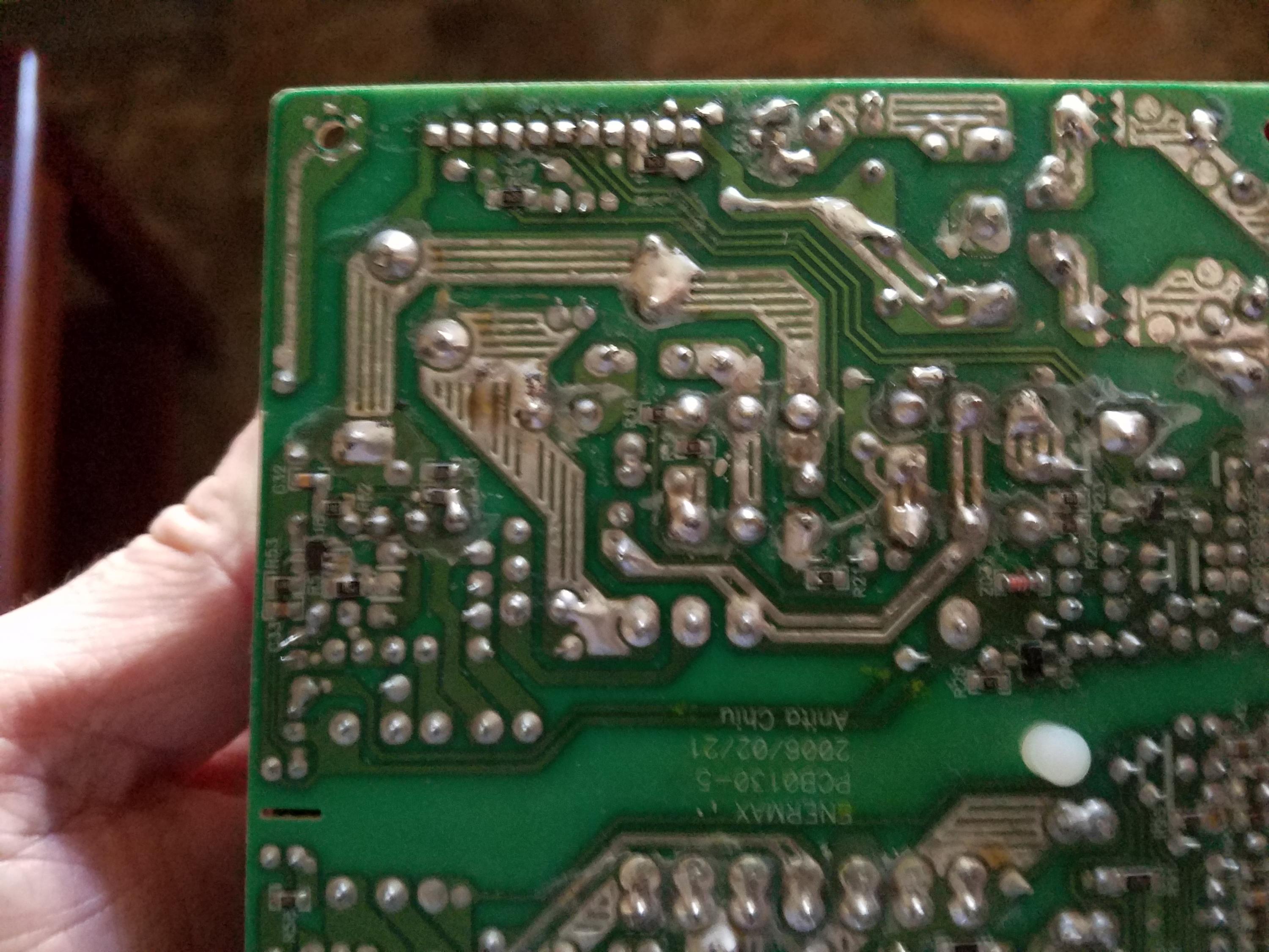

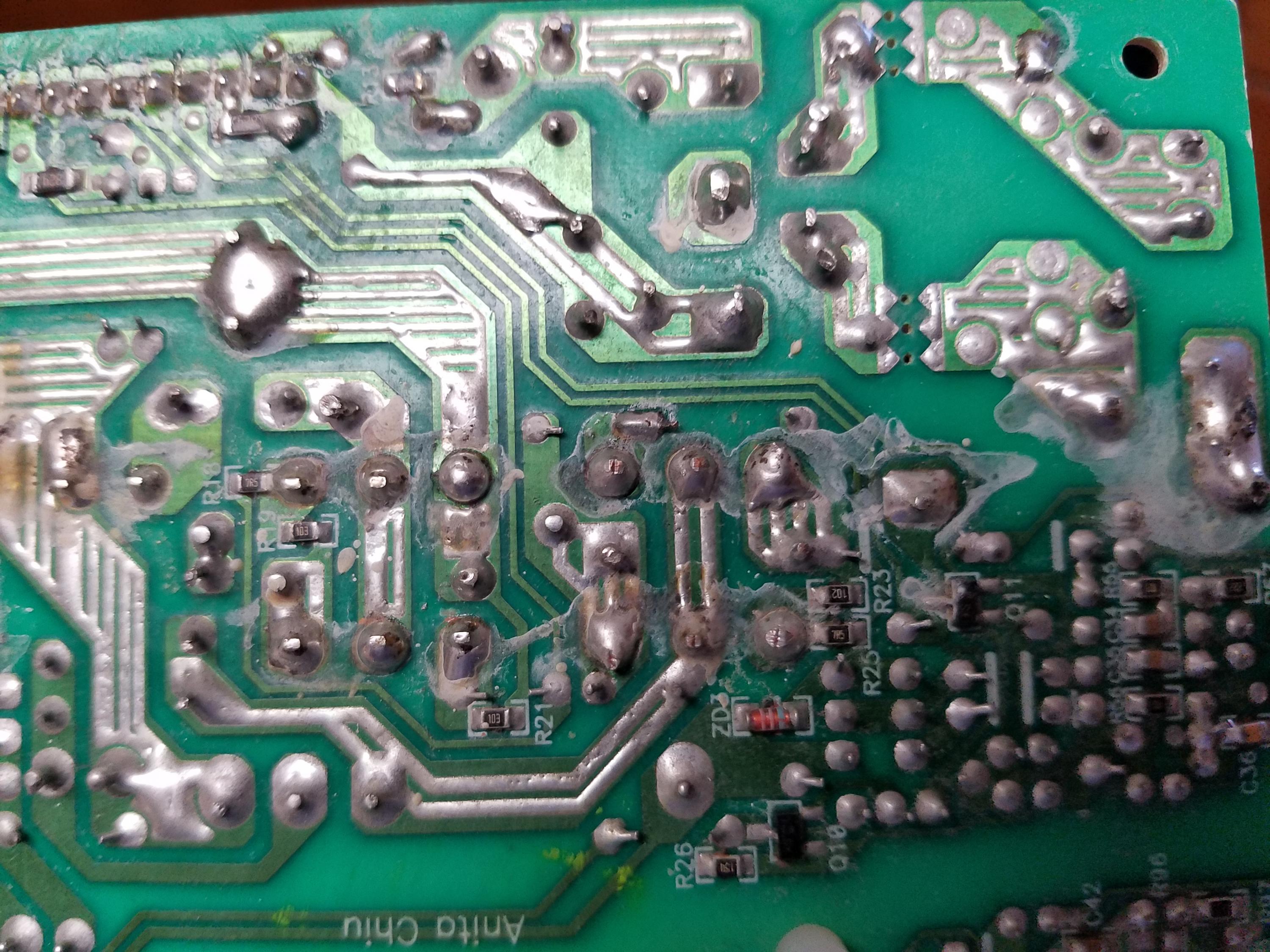

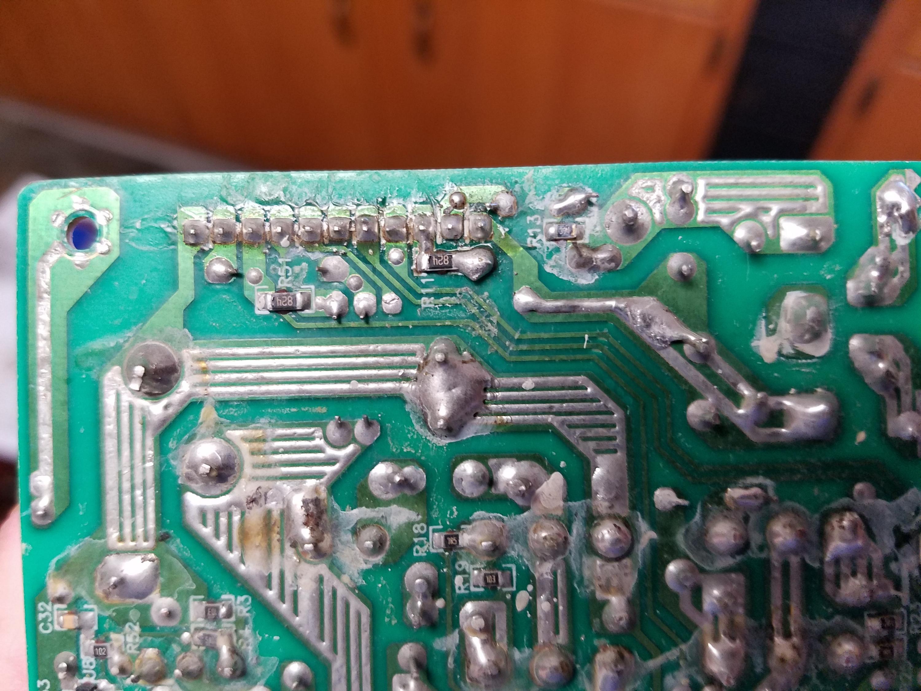

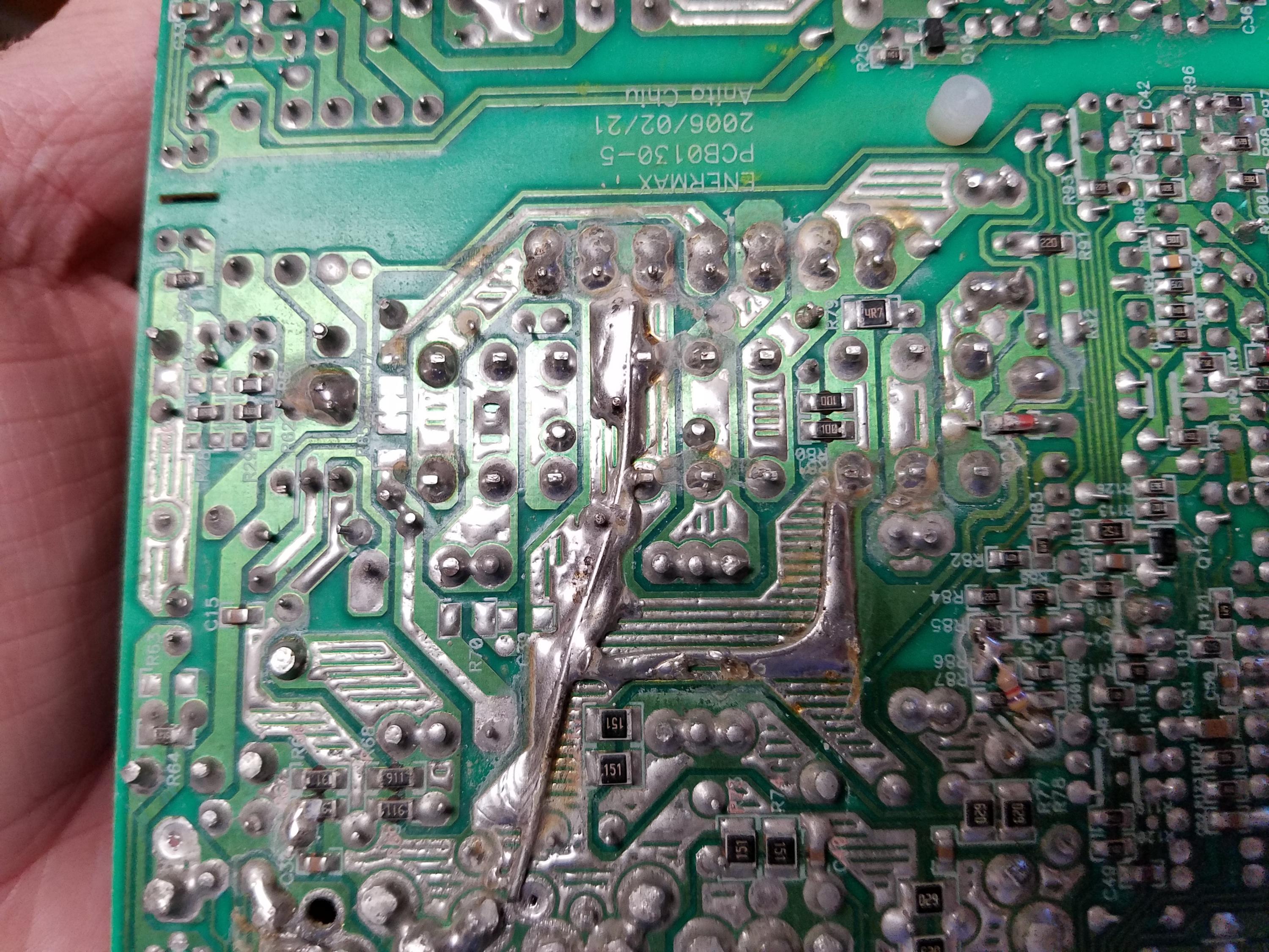

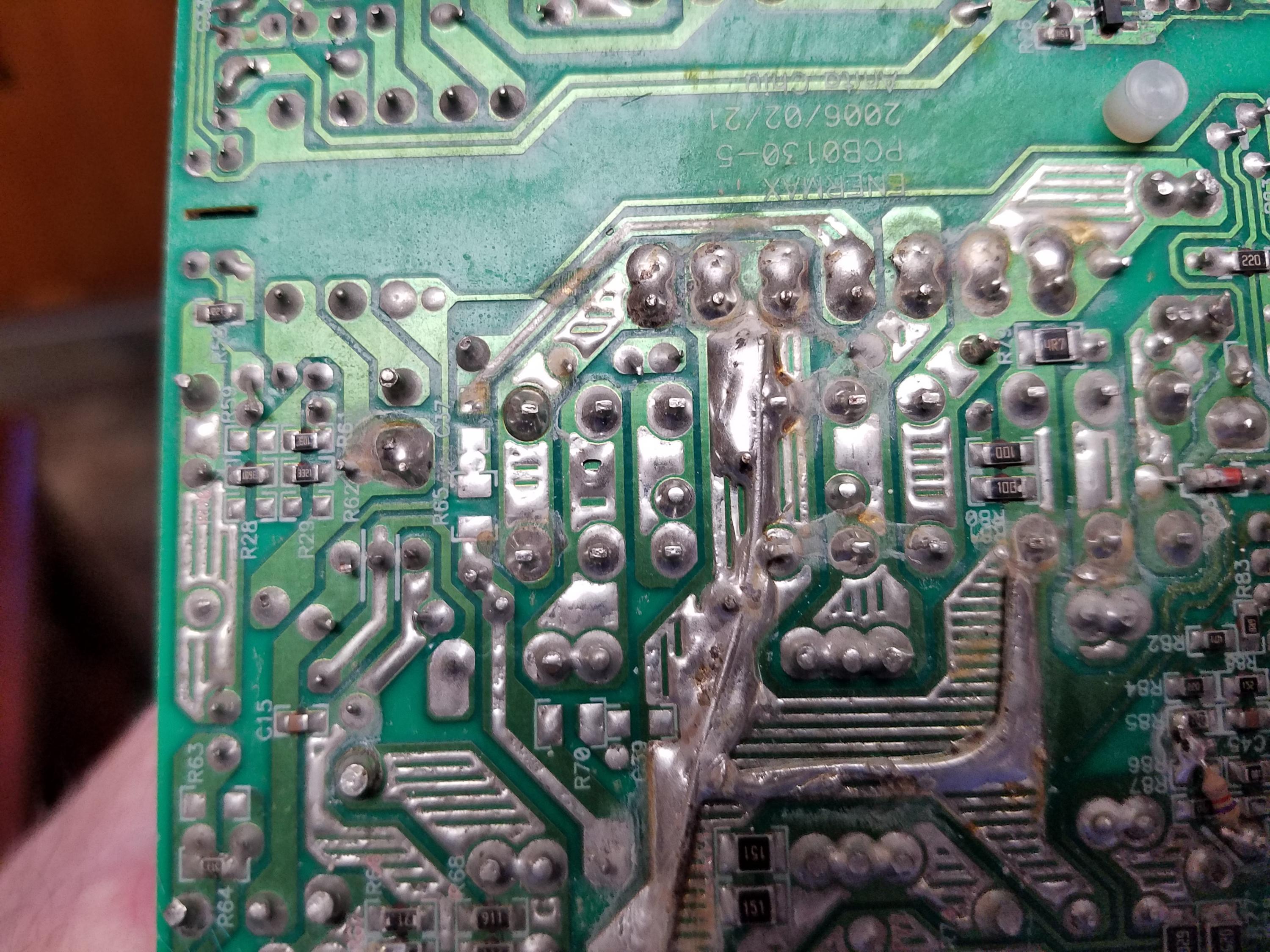

            Re: Recapping a bad EnerMax NoiseTaker II Model EG701AX-VE(W) PSU
            Oh, duh!

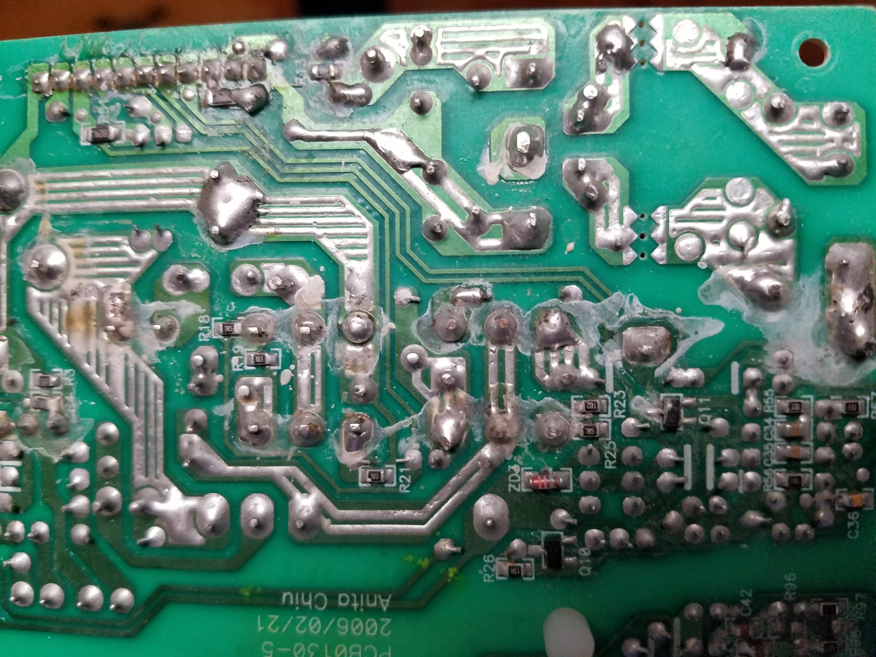

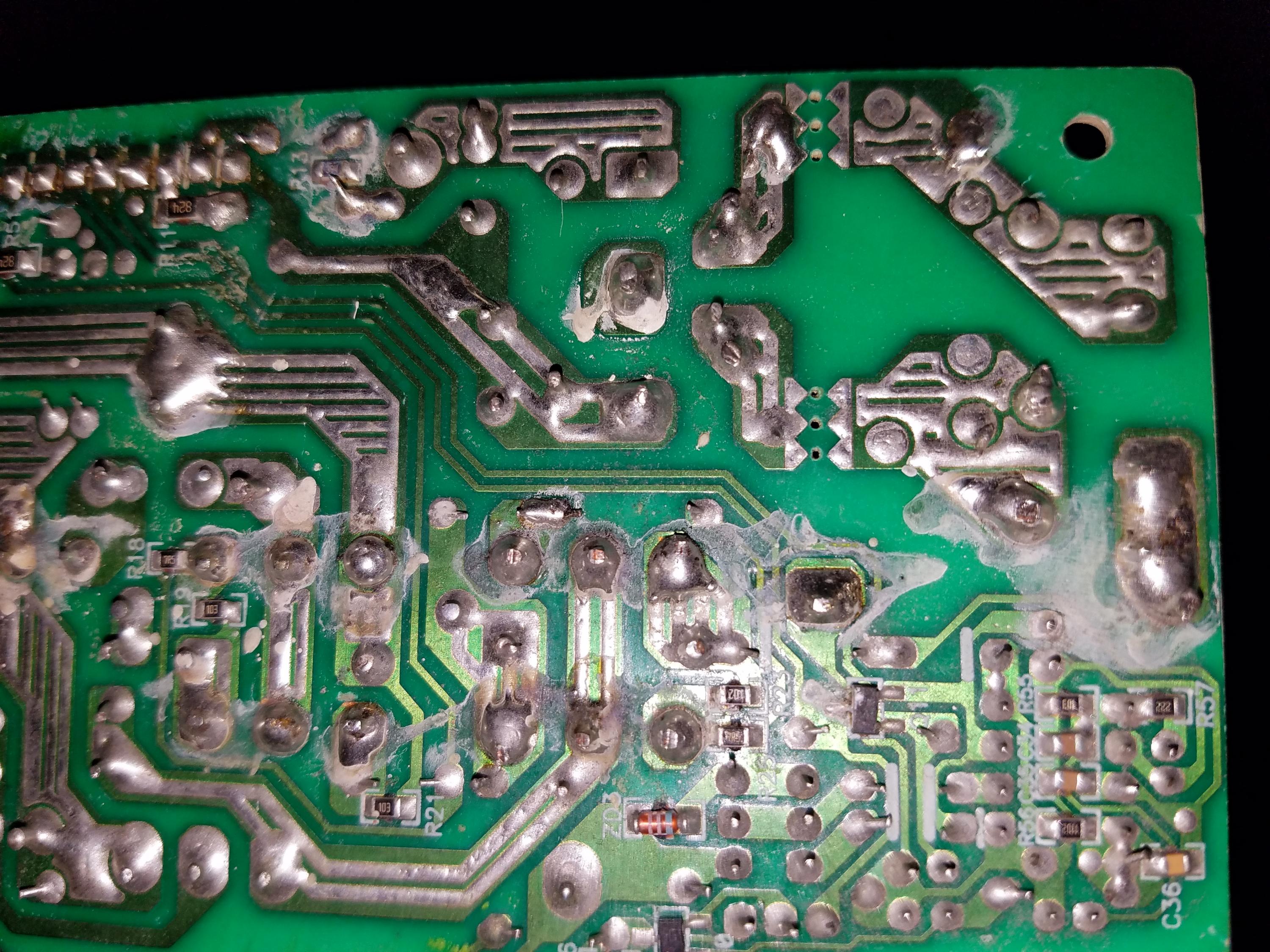

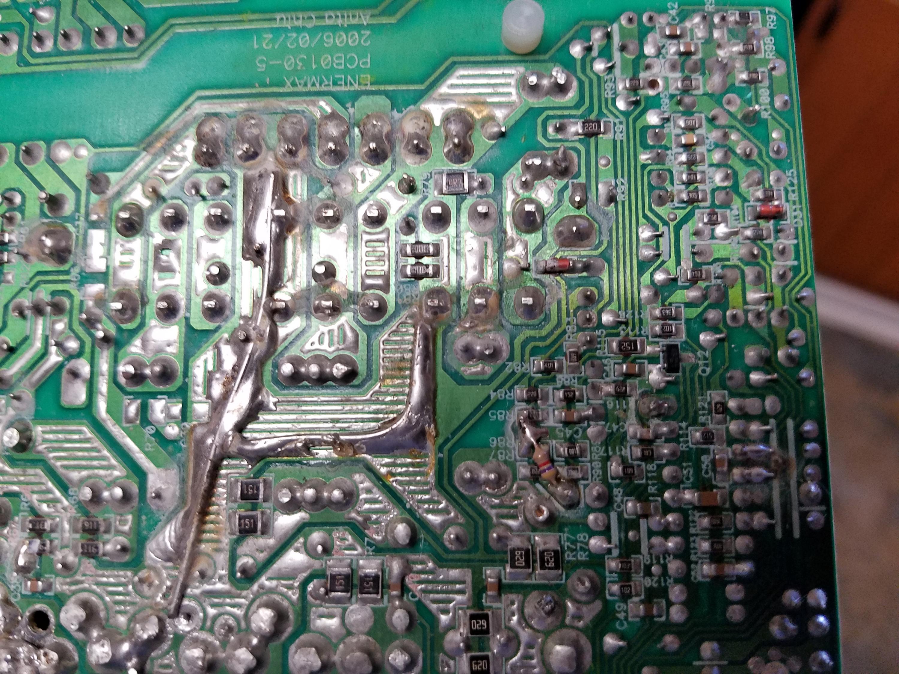

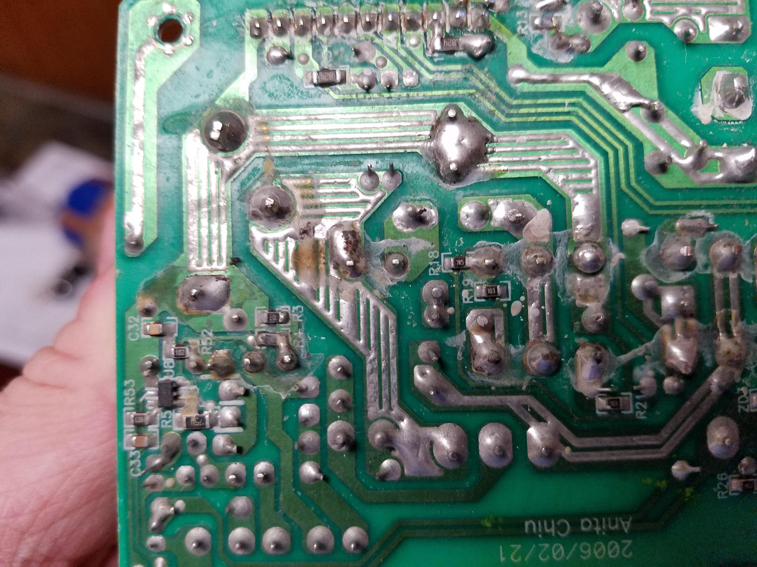

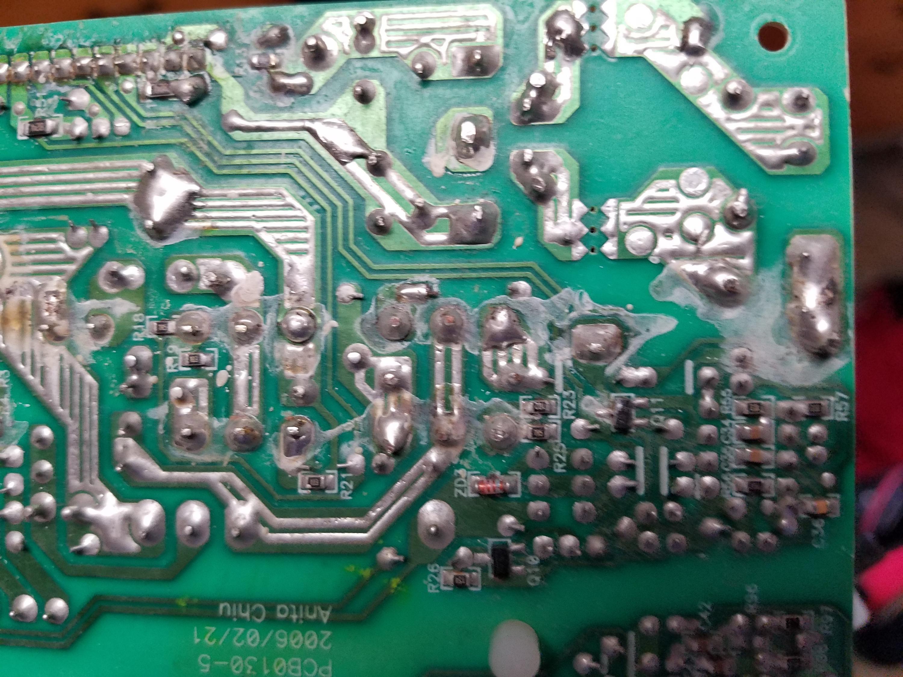

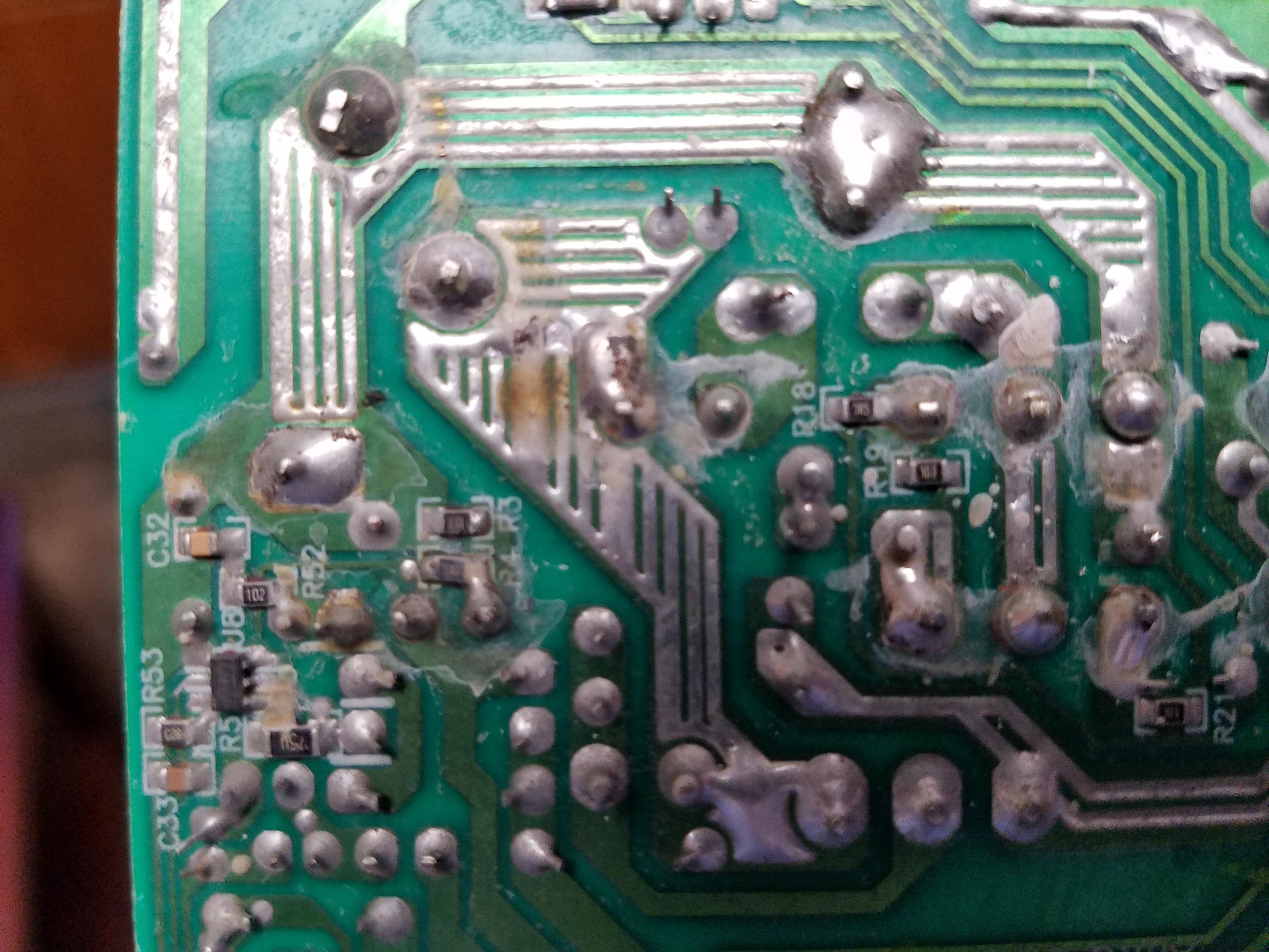

            Here's a bunch of pictures of the underside, including the white stuff that doesn't look right at all.
            -- Law of Expanding Memory: Applications Will Also Expand Until RAM Is Full
              Yes diameter. Many D8 caps are hard to get, many D10 are imposible to get but from me, I have some custom 3300/16 models. In few months also new 2200/6.3 D8 caps, finally a replacement for those Crapxons KF and similar crap FSP uses.
              That's soldering flux, Enermax did not really pay much attention to cleaning of the boards which came off of their line (before they sold it to CWT; I have seen that in units going as far as the Pro 82+). It should not be conductive, but one never knows, I always scrap that off when I work on such old units.
