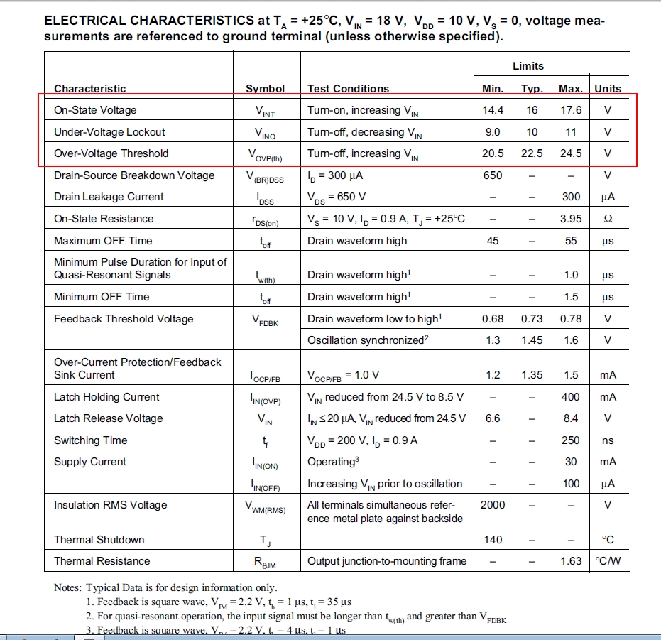

          The IC901 has 13.18vdc to pin 1, data sheet states on state voltage between 14.4-17.6vdc.
          So appears that voltage is too low, but why?
          STR-G6651 data sheet uploaded.

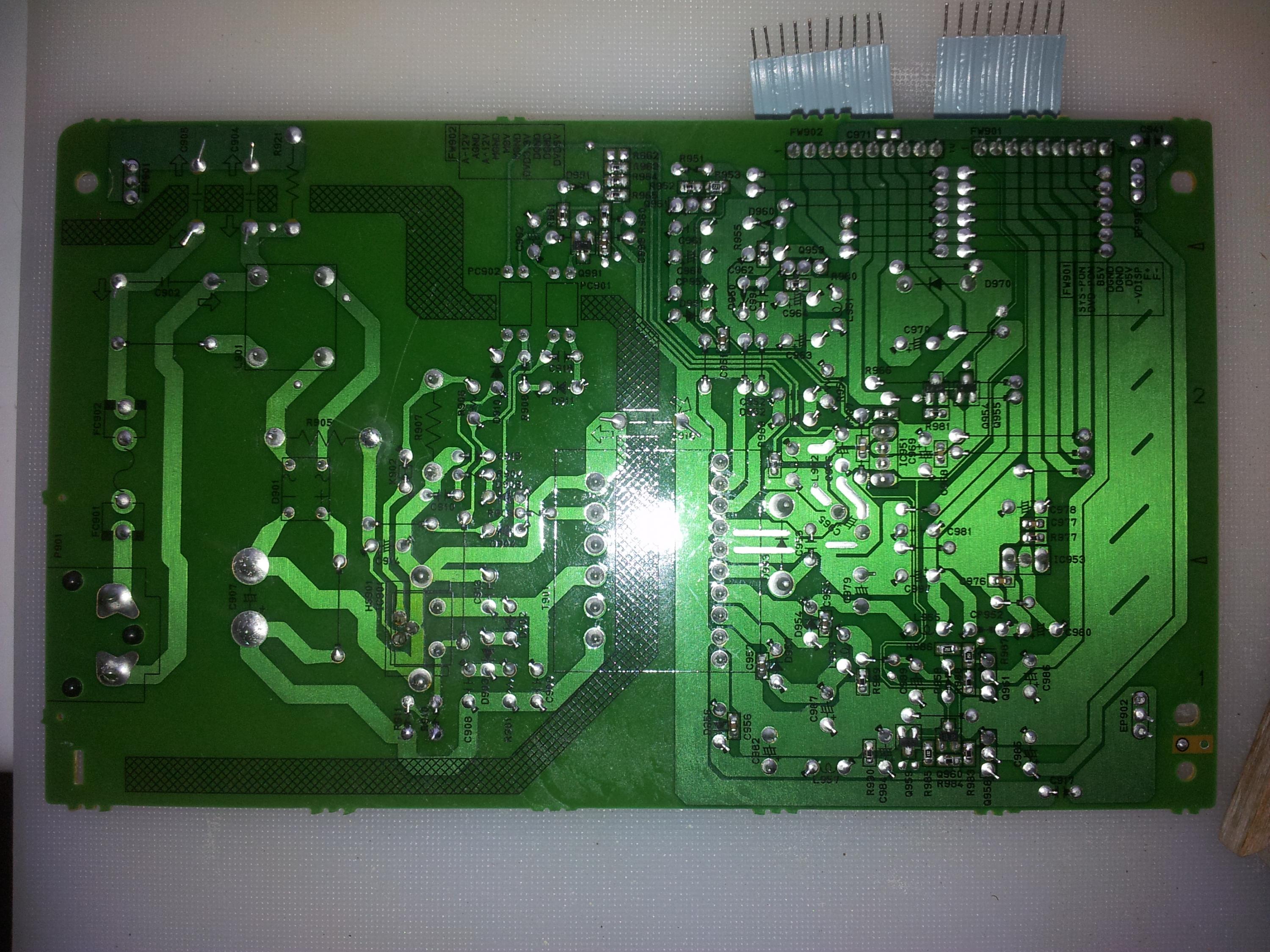

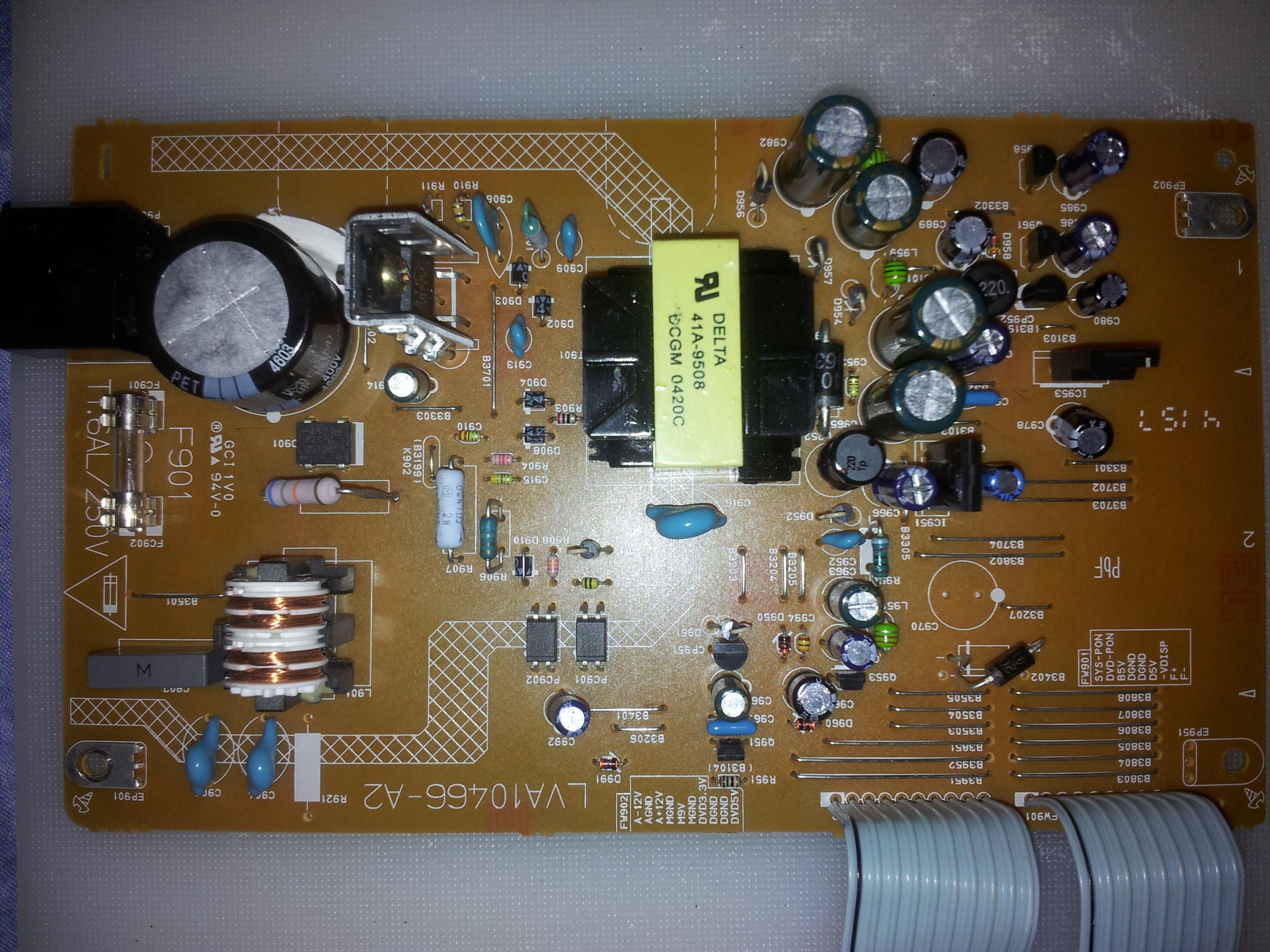

          budm:
          Pictures of PCB top/bottom uploaded.
          Owned from new, not used much, but just started using more now that 5.1 surround is being broadcast here on some programmes, we power it off/on as we use it, never use standby mode in the interest of energy saving.
          Redwire: Thanks for the headsup..
          Percy
            Re: JVC THS9 Home Cinema System SMPS No outputs or standby power
            https://www.badcaps.net/forum/attach...4&d=1485790567
            Can you please provide focused picture?
              Wrong pin. Vcc is on pin 4.
              The spec sheet sez:
              On-State Voltage: min 14.4V, typ 16V, max 17.6V
              So lets say if pin 4 had only 13.18V, it would probably not turn on. as turn off would be max 11V and the IC has under voltage lockout.
              See if pin 1, 2 and 3 are shorted?

                      budm: Sorry about the photo, I did another I hope it is OK.

                          IC901 STR-G6651 Pin 5 (OCP/FB) is terminated to the primary circuit GND through R906 (680 Ohms) in series with the SOURCE current sensing resistor R907 (0.47 Ohms). Very low resistance compared to the 940K (TWO 470K resistors in series), so you are going to get much Voltage on pin 5.
                          You will get more Voltage at FB when Opto PC901/902 are active.
                          Feedback Threshold Voltage VFDBK Drain waveform low to high1 0.68V(min) 0.73 (typ.) 0.78 V (max)

                                      It does appear that IC901 is not functioning, but it may be because the voltage present at Vin is only 13.18vdc not enough to start see post 7 by Capleaker.
                                        Start up DCV, UV/OV DCV.
                                        VCC It has to reach 16VDC for IC to start up.
