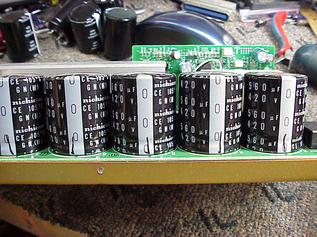

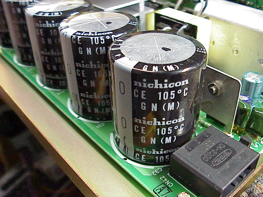

    0522 datecode.

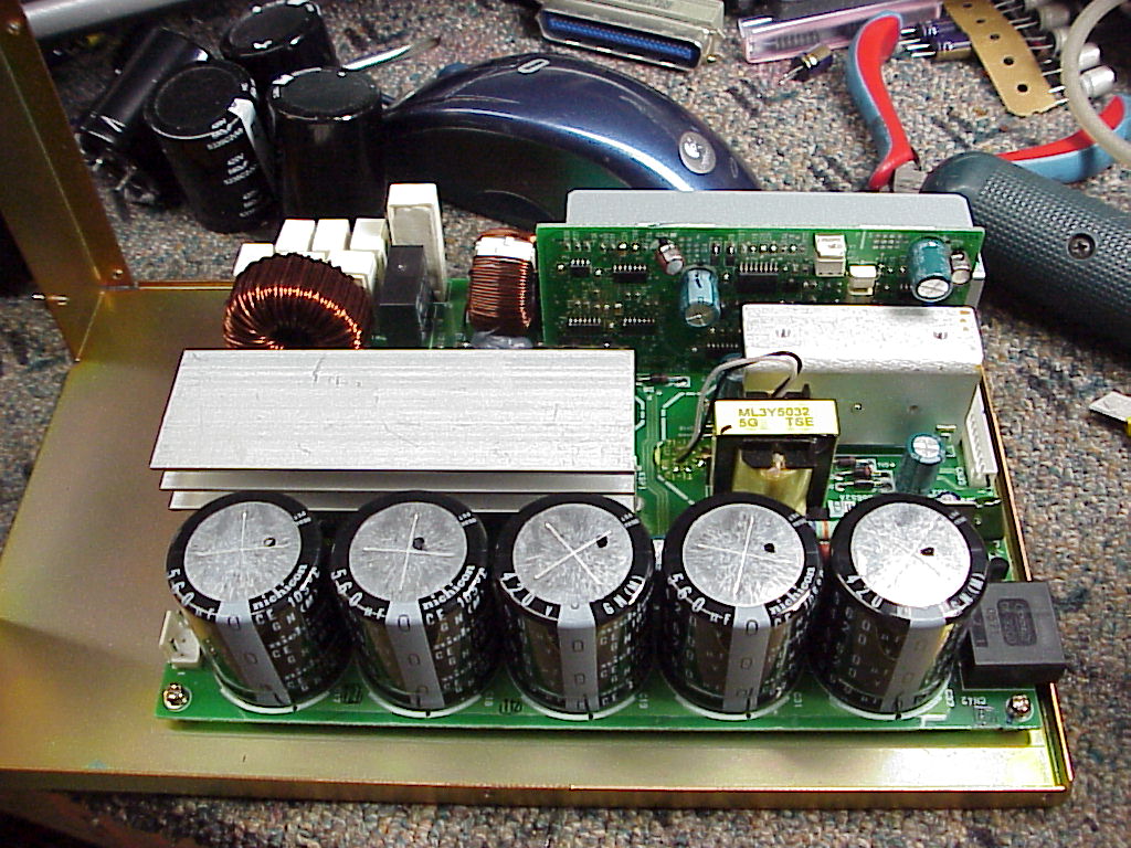

    system only in use a year till customer complained of random glitches and failure to start from cold.
    all 5 are in paralell and read 10 ohms esr!

      it is here for repair.
      i repair more industrial stuff than pc's.
      its full of taicons too which will be replaced preemptively.
      i have seen 2 others like this with the taicons blown.they had panasonic primaries though.

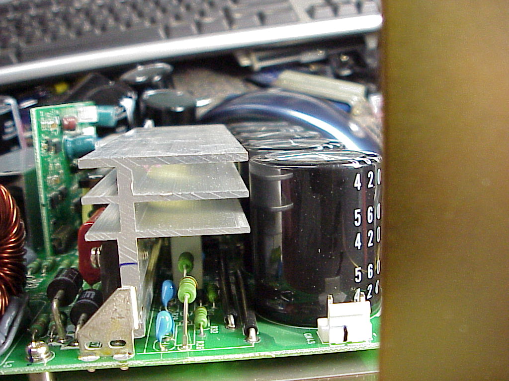

        Think maybe all that heat right next to them played a part?
        Might consider some 1/4" holes in housing next to caps to let a little air in or out right there.
