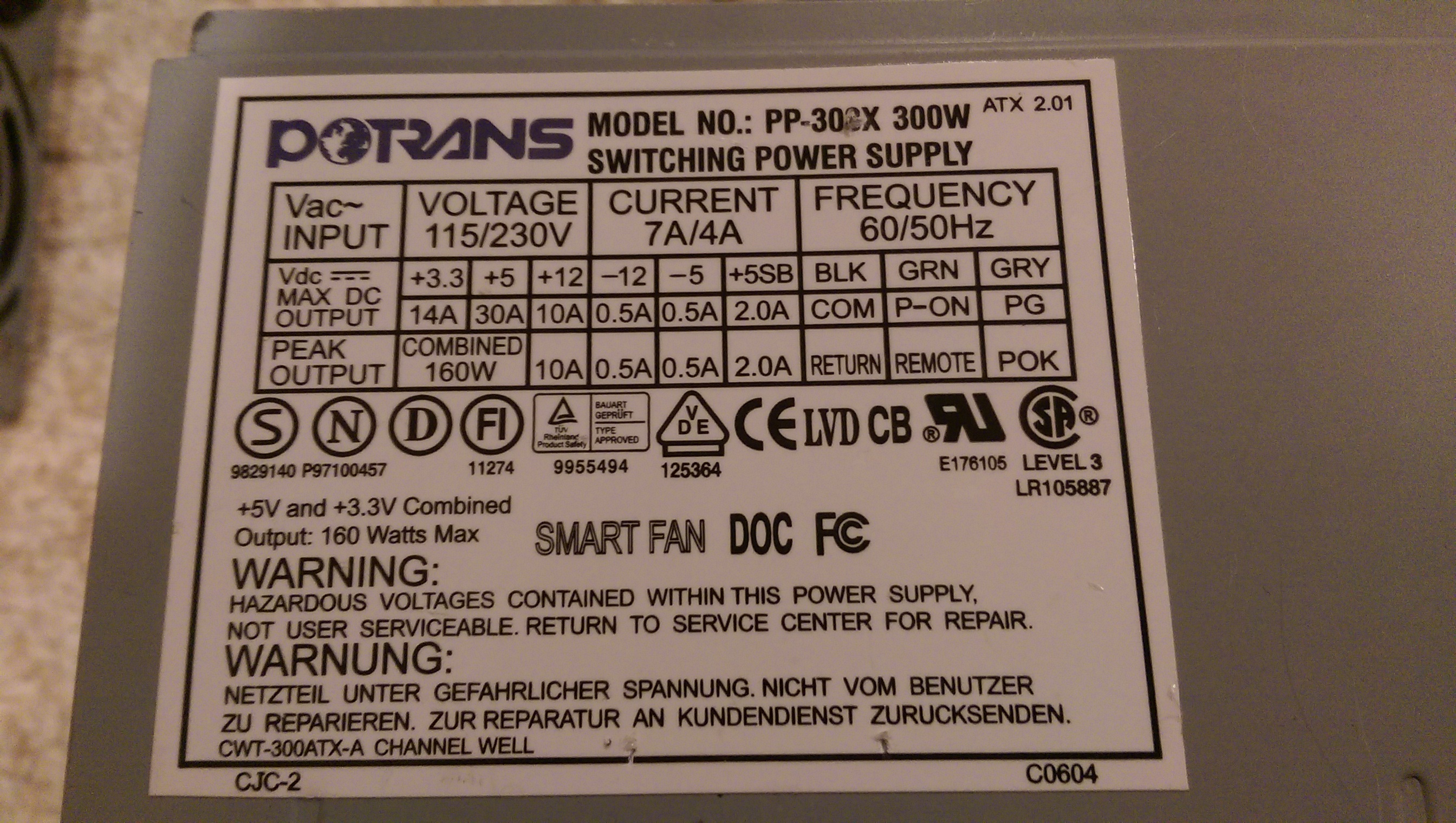

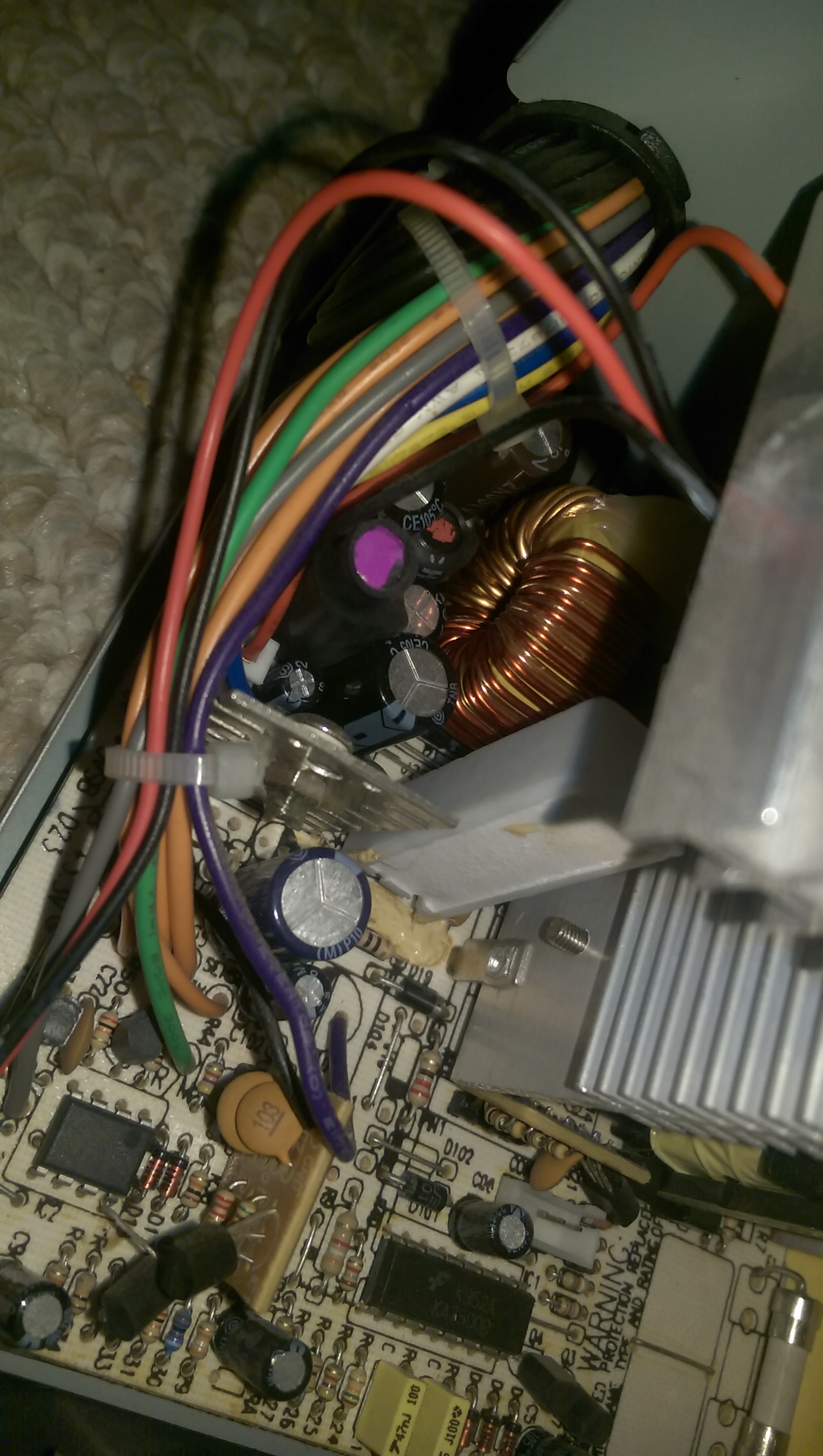

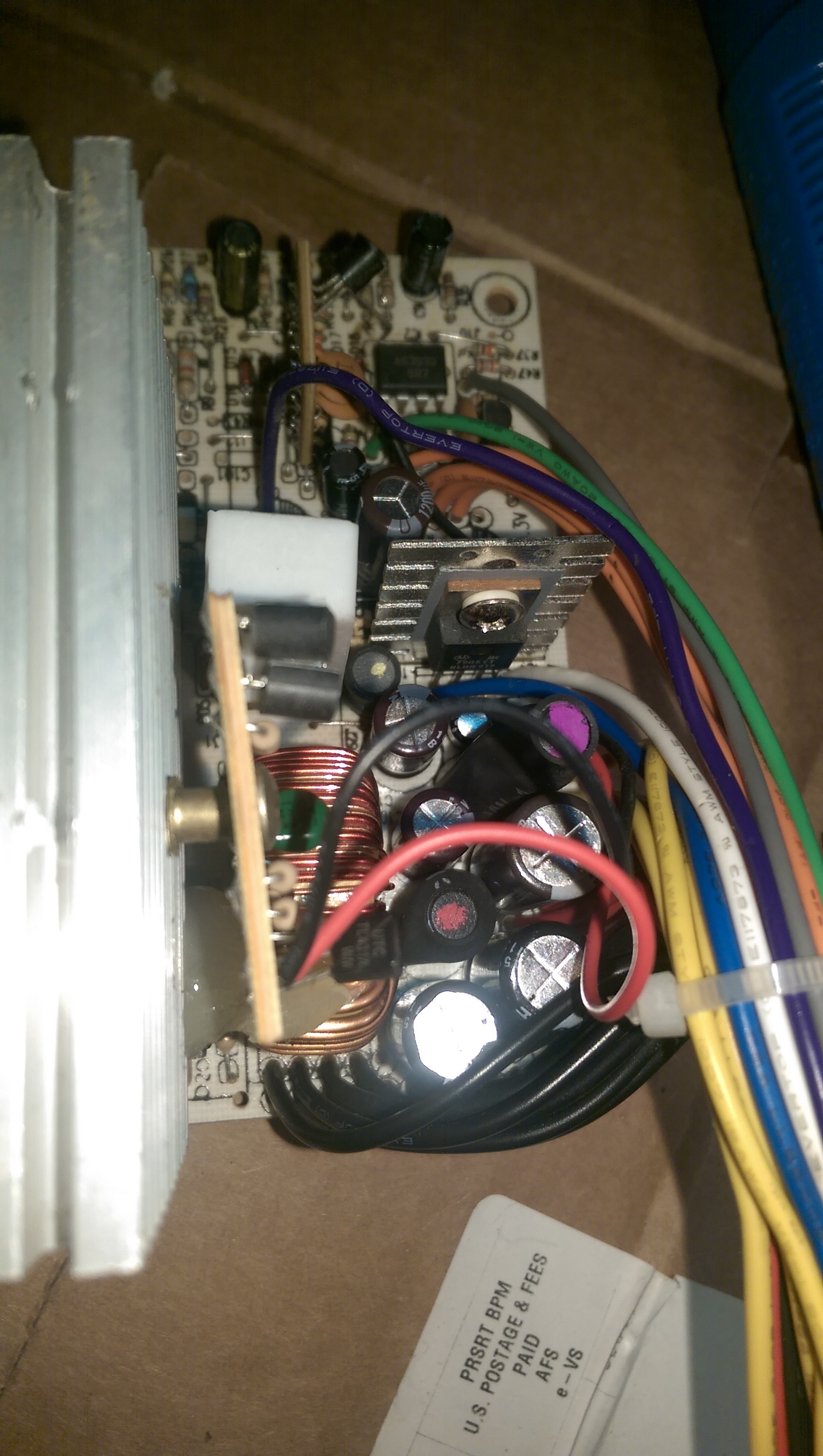

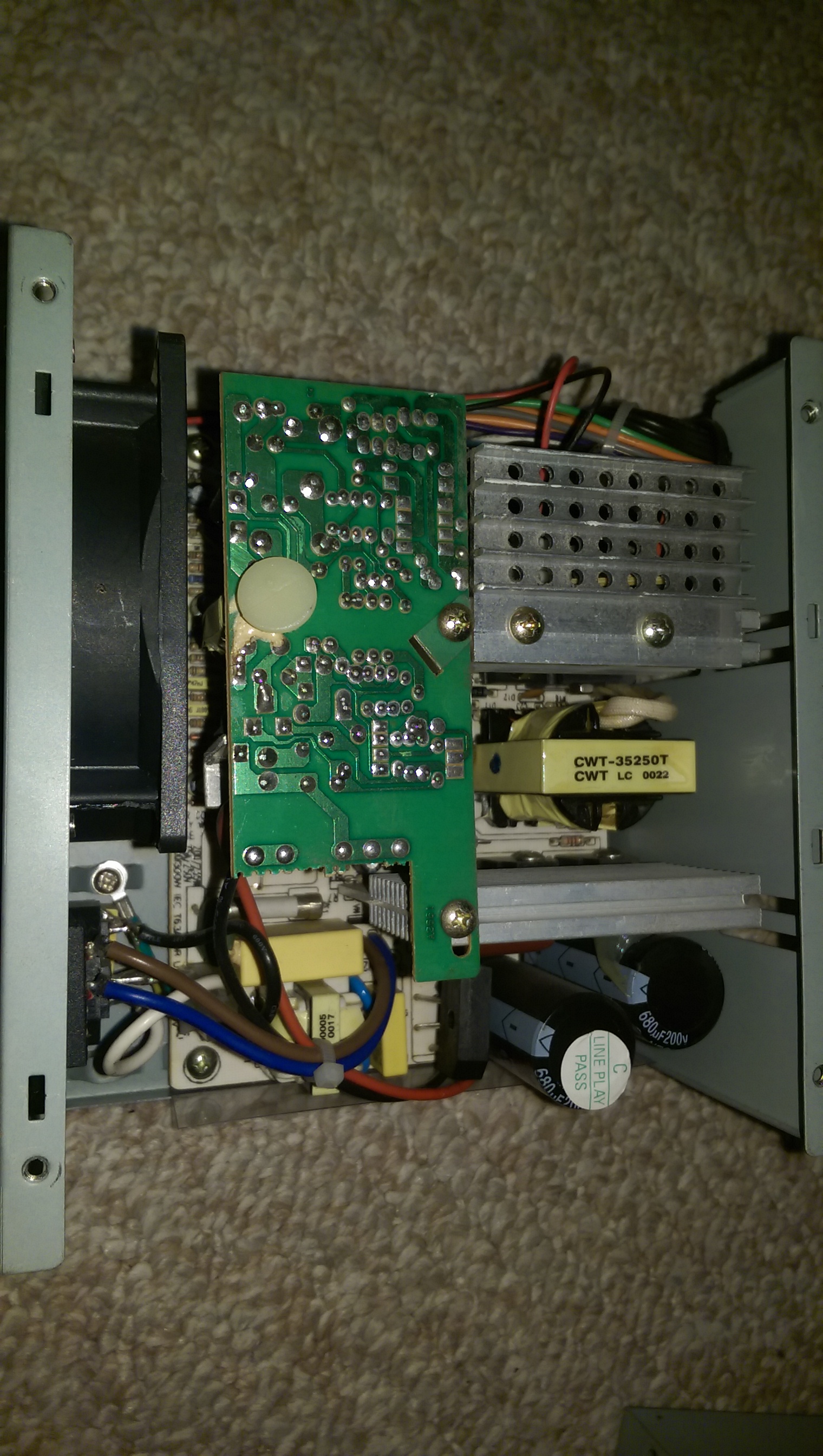

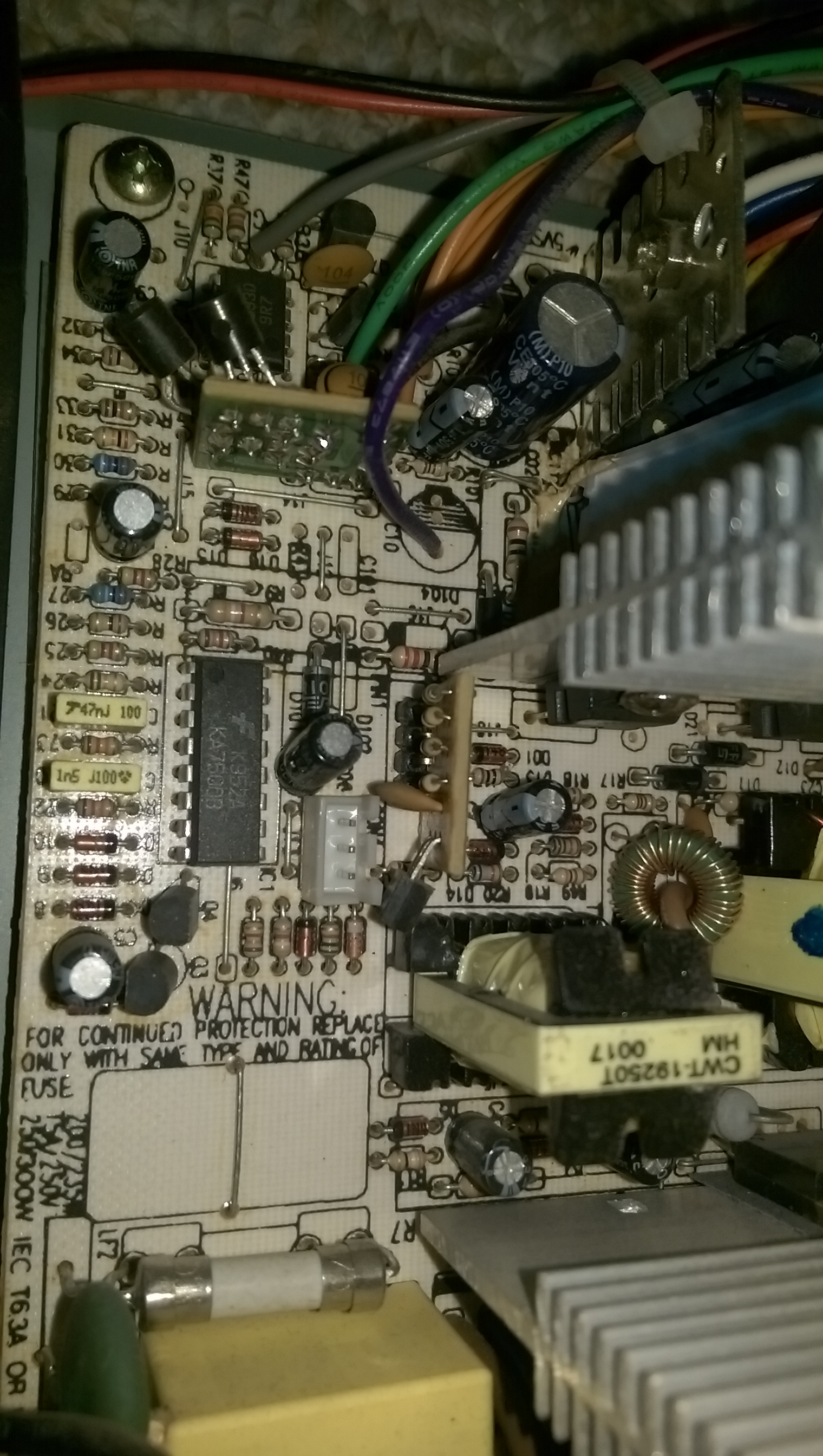

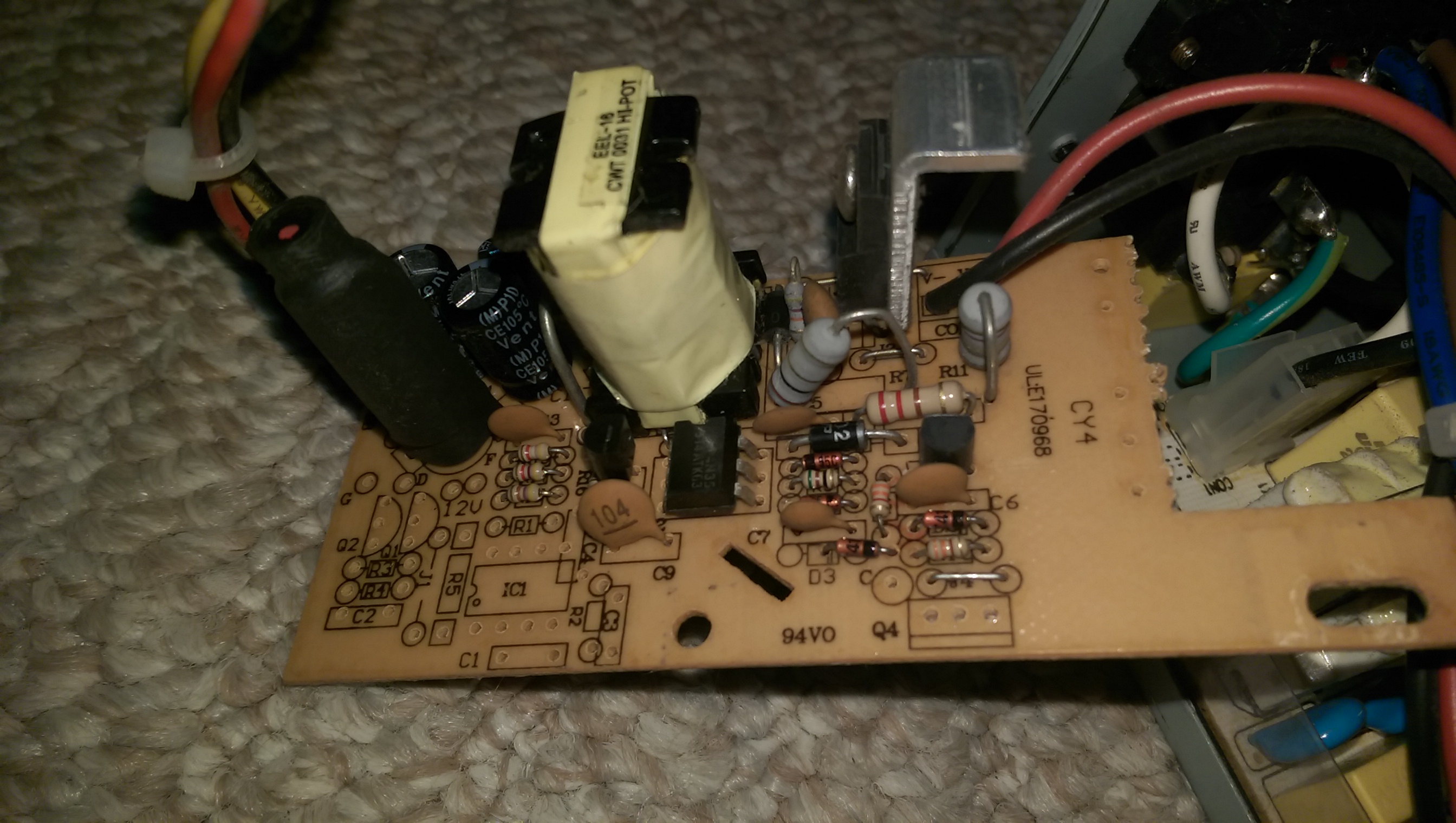

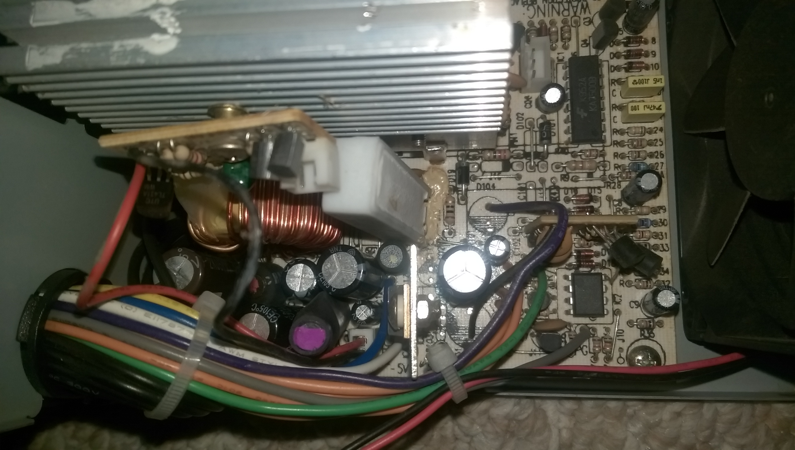

Got this PSU at the local recycle place for $2.95. I knew it was CWT before even picking it up, and shining my flashlight through the top, it looked pretty unique. I'll let the pictures speak for themselves mostly
Switchers are 2SC2625
16A ultra fast for 12V, two 40A schottky for 5V, and it uses linear conversion for the 3.3V with a 40A FET.

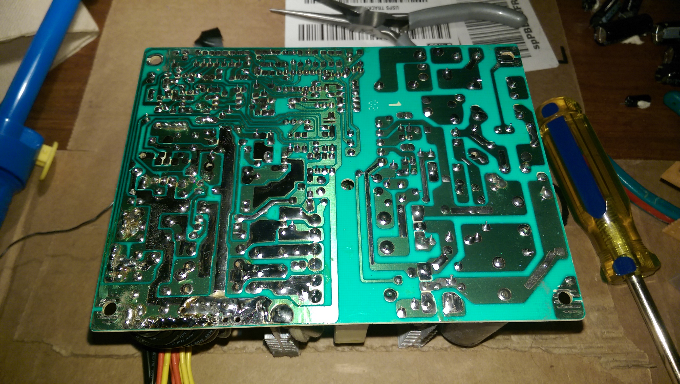

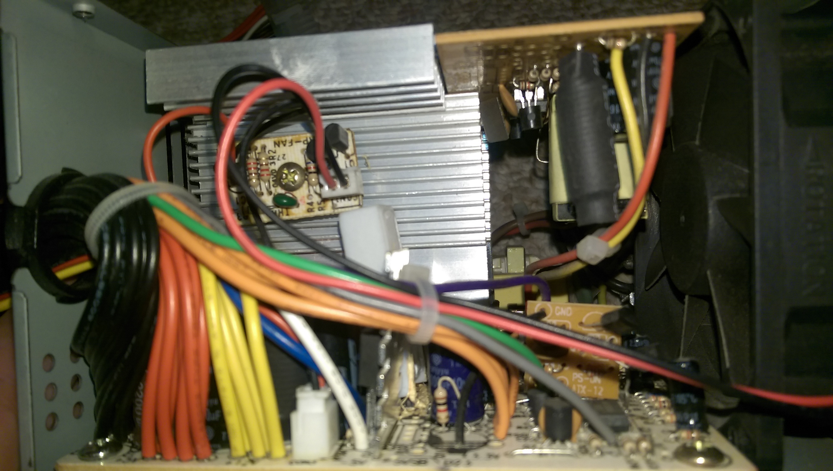

Fan is a sleeve bearing Jamicon. Will post solder shots later. I am going to recap this and use it in my Pentium III 933 rig. It's rare to find an old PIII era PSU with a quiet fan controller

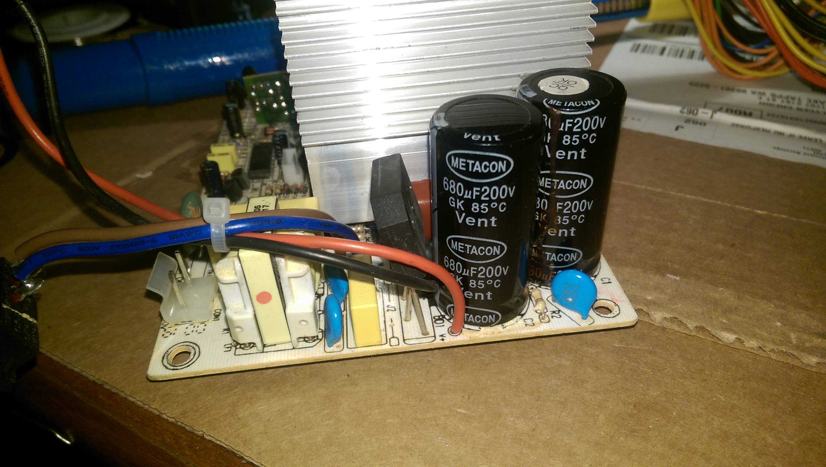

The toroid and the windings look a bit small and thin for 300W too. Those heatsink remind me a bit of those used in early 2000s FSP/Sparkle units.
