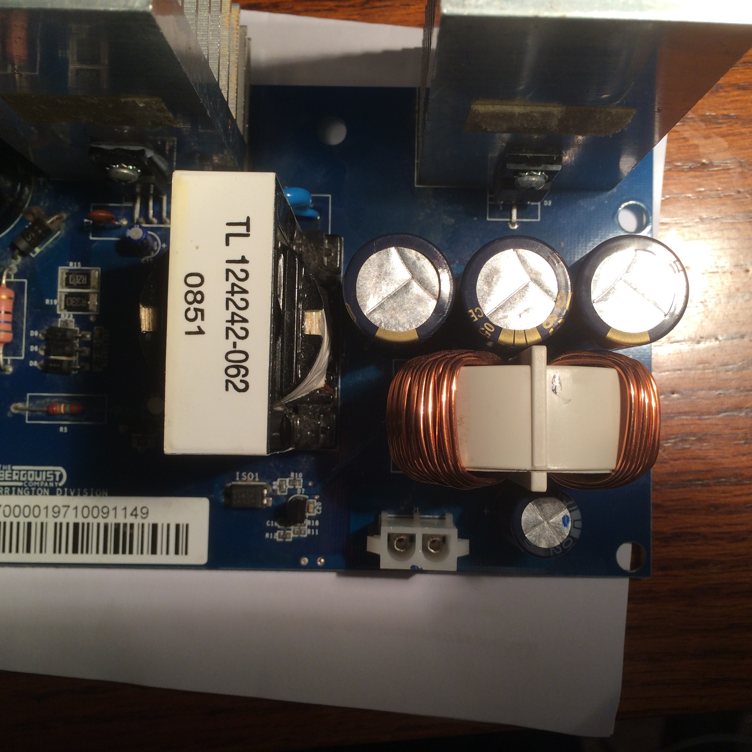

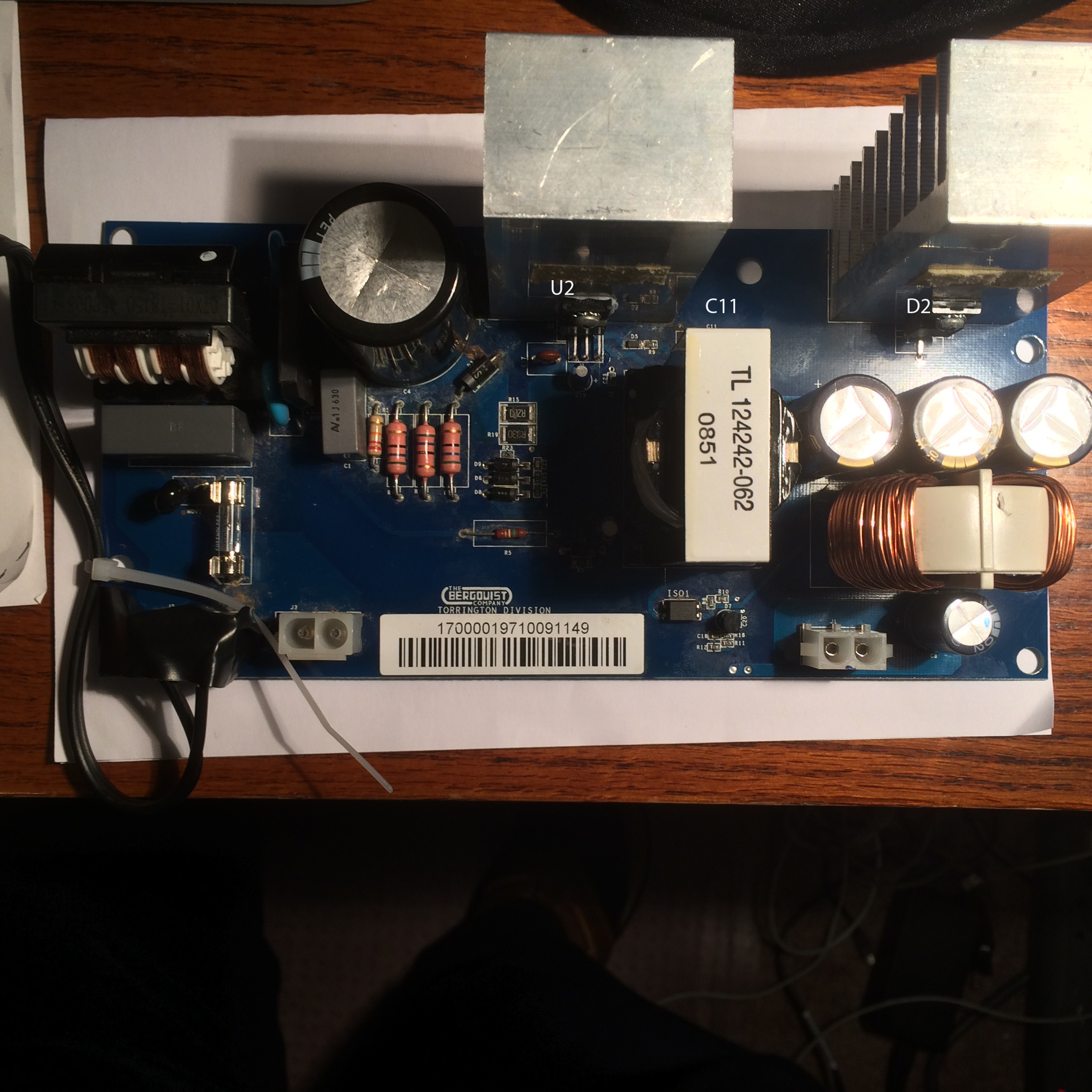

I am attempting to repair a power supply for a friend that was water damaged.I replaced the components that were damaged or rusted from the circuit which were C11 the blue large capacitor and U2 which is STR W6756. After the replacement of the parts I do not have the 15v DC output from the secondary side of the transformer. The large capacitor is giving voltage of 168-170V DC. I have checked the capacitors and resisters and do not find anything wrong. I am unsure as to what maybe causing the issue. D2 is an E2204. Any advice or input would be greatly appreciated.

C11 will not be the cause of the problem, it is for EMI,not needed for the circuit to function.
What ESR and capacitance do you get on that small lytics cap c19. next to the STR SMPS IC?
How about R15, R19 which are connected in parallel, what resistance do you get?
R9 resistance?

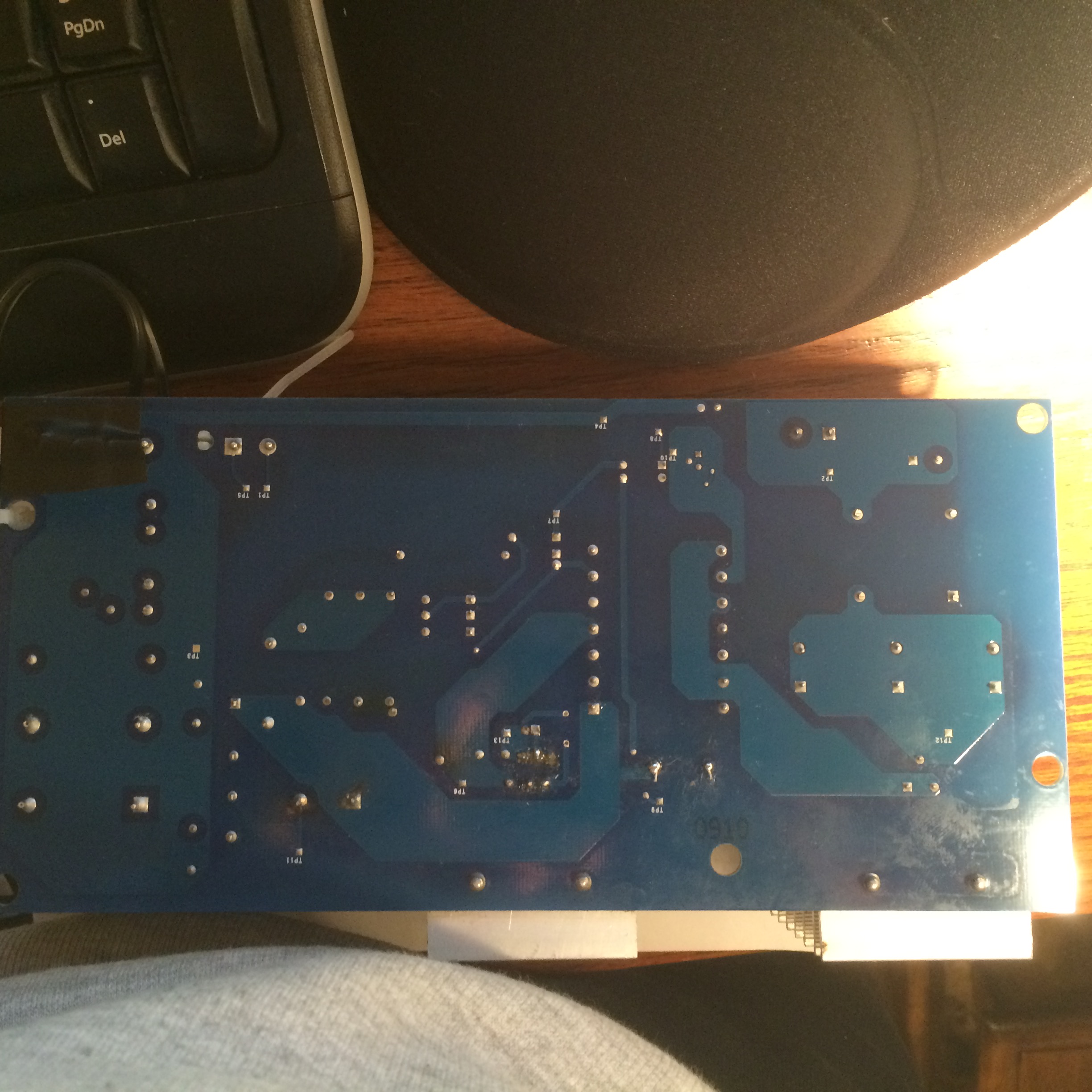

This is double sided PCB so it is not going to be easy to trace.Last edited by budm; 10-26-2016, 07:05 PM.Never stop learning

R15 and R19 both have a resistance of 130.6K with meter terminals one way and reversing the terminals I get both to measure 141.8K
Based on the online SMD resistor calculator these should be 0.20 ohm and 0.33 ohms is this correct??
R9=1KLast edited by mike123333; 10-26-2016, 08:00 PM.Comment
Re: Power Supply for Quadrafire Pellet Stove
You have indicated that you replaced the STR-W6756, what did you find wrong with it?
Please check the resistance between pin 1 and pin 3 of the old STR W6756 to see if it shows very low resistance (<10 Ohms).
Right now those two resistors for the Source pin (PIN 3) of the STR-W6756 have gone open circuit probably due to shorted MOSFET inside the STR W6756.
What is the marking on R9? I expect that to be around 10 Ohms.Attached FilesLast edited by budm; 10-26-2016, 08:45 PM.Never stop learning

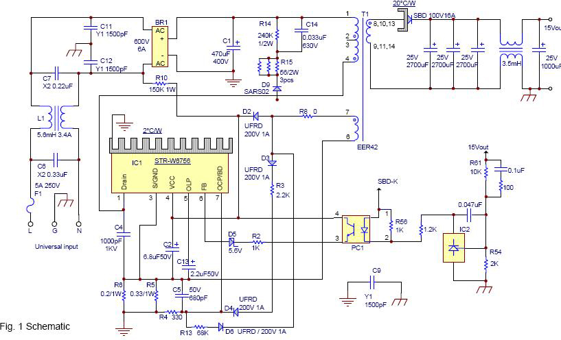

Per spec sheet on PDF page 5, the typical start up Voltage is 18.2VDC so right now that Voltage is not reaching the startup point (once the IC starts running, when the VCC drop down to 9.7V Typ. then the circuit will stop running) so the IC is not running right now.
You need to check all those components connecting to the IC, especially filter cap on t the VCC pin (I would replace it), the diode that rectify the AC to provide VCC onec the IC is running and the resistor on pin 4 as shown in the diagram.
You can use that application notes circuit as a guide, it may be close enough to your board. I will assumed that the diode on the cold side is OK, same for the caps?Never stop learning

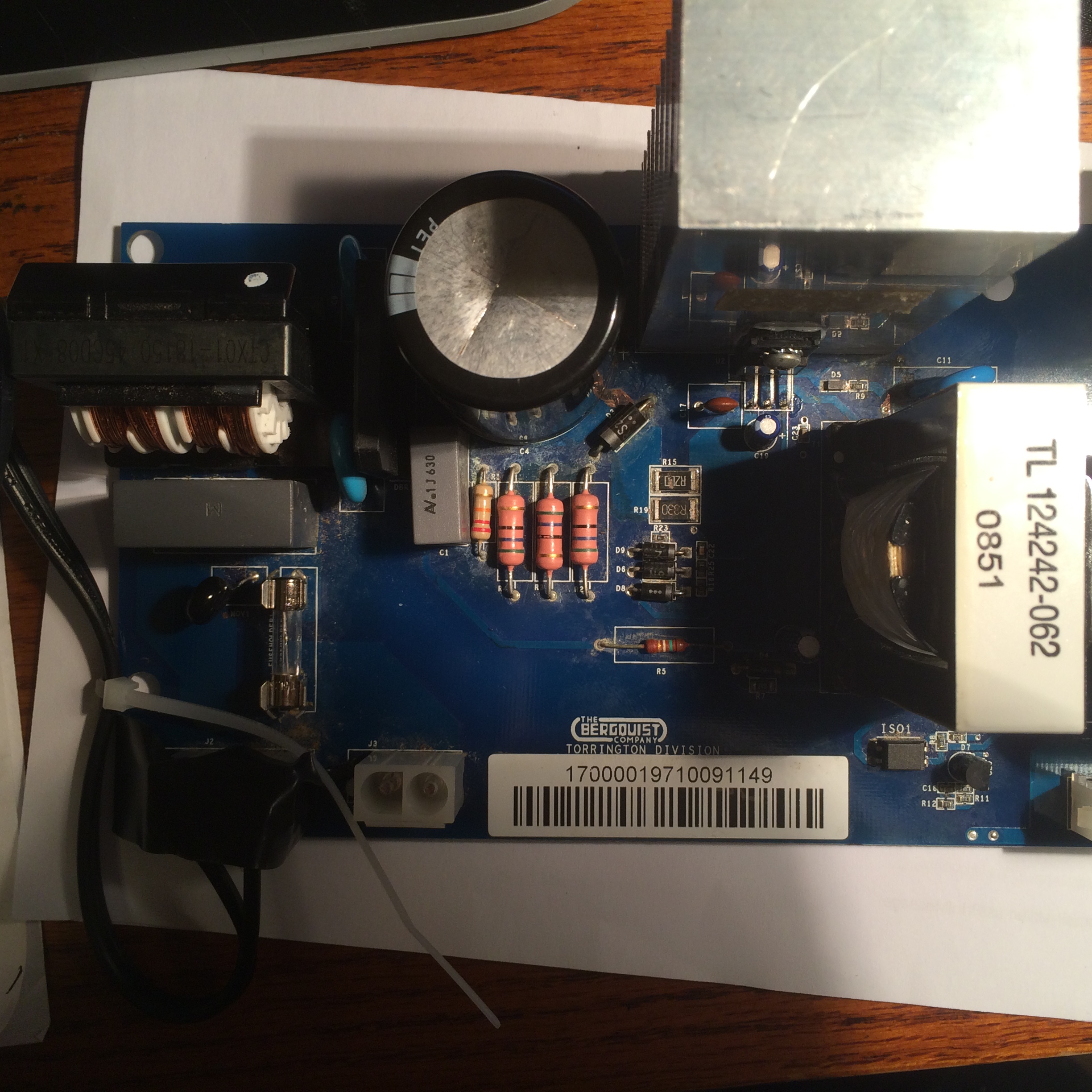

I think R23 maybe open I am measuring 65K ohms on it but the writing on it is 33? I can't seem to figure out what the third digit is, since it was wiped away. I am assuming it maybe a 33 ohm resistor. I did change out teh capacitors which did not solve anything.Last edited by mike123333; 10-27-2016, 08:52 PM.Comment
I do not see R23 in your pictures so I cannot tell what its function is.Never stop learning
http://www.badcaps.net/forum/showthread.php?t=24809Comment
if you go to the third picture and zoom in it is between R19 and D9, one end of the resistor goes to C22 near by it and the other end is to the cathode of diode D9 and the other end of C22. its like being parallel with C22Last edited by mike123333; 10-27-2016, 09:06 PM.Comment
OK, I see it now but I still cannot tell how it is connected in the circuits.Never stop learning

I found this 15VDC power supply circuit, it looks like they copied to cituit to build your board. The part designators may not be the same so you will have to do circuit tracing and then write down the designators of you board into the diagram.
https://www.arrow.com/en/reference-d...ad9377f6828100Never stop learning
Thank you for the schematics definitely looks like it..the resistor in question would be R4 so it is 330 as I thought. I think the resister is open at 65K Ohms measurement.Comment
You just have to make sure that it is connected the same way as shown in the diagram because in the diagram I see 68K resistor R13 which is also connected to pin 7.
I think you should also repalce those two resistors that were blown open instead of using fuse or jumper just i case it wants to see the Vdrops on those two parallel connected resistors to function.Last edited by budm; 10-27-2016, 09:57 PM.Never stop learning
