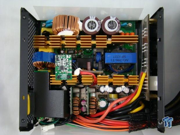

          Re: Fractal 1000w shut down if gaming
          It is very much similar to this picture.
            No way is that 1000w rated looks quite poorly built IMO.

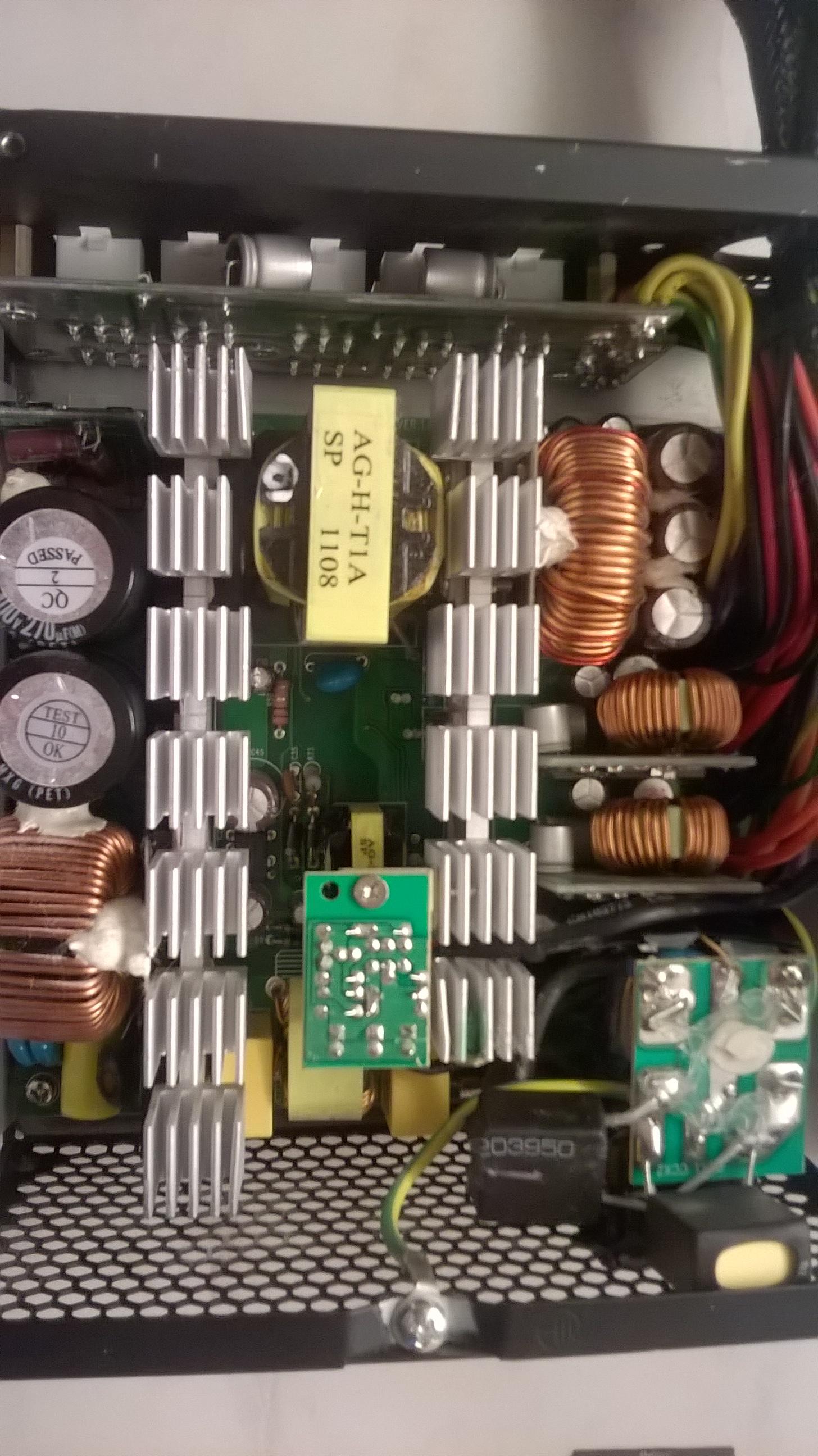

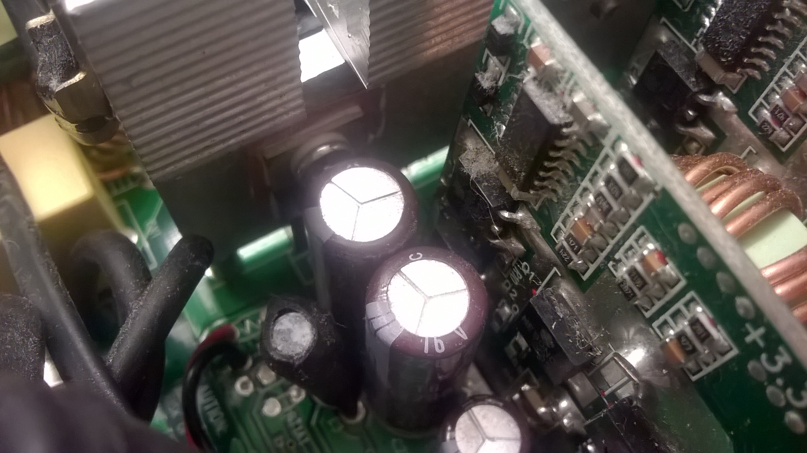

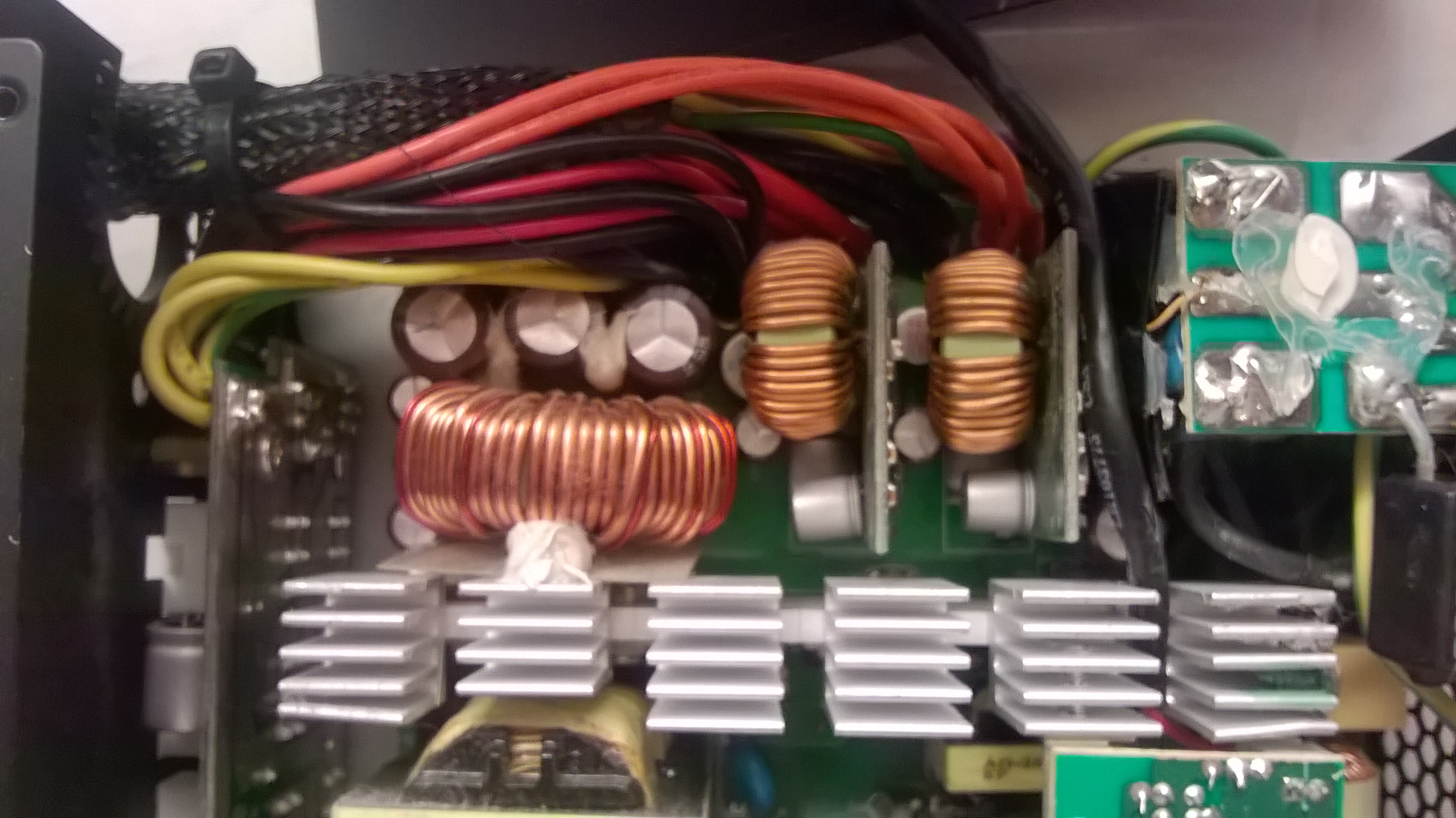

                  Looks like United Chemicon caps so probably not it then.
                  Did you try the computer on another powersupply, maybe try borrowing one from a friend if you don't have a spare?
                  As stj said it might be a problem with something else...
                          stj: I uploaded the photos.
                          drag: please attach the photos here in the forum instead next time.
                          For you quoted text it is not your failure condition, in that case the PSU would not turn on.
                          It could be a bad solder joint or simply dry capacitors.
                          But you need equipment to be able to test them (an ESR meter)
                          If you don't have one you could just change them all and hope for the best but I don't like your chances...
