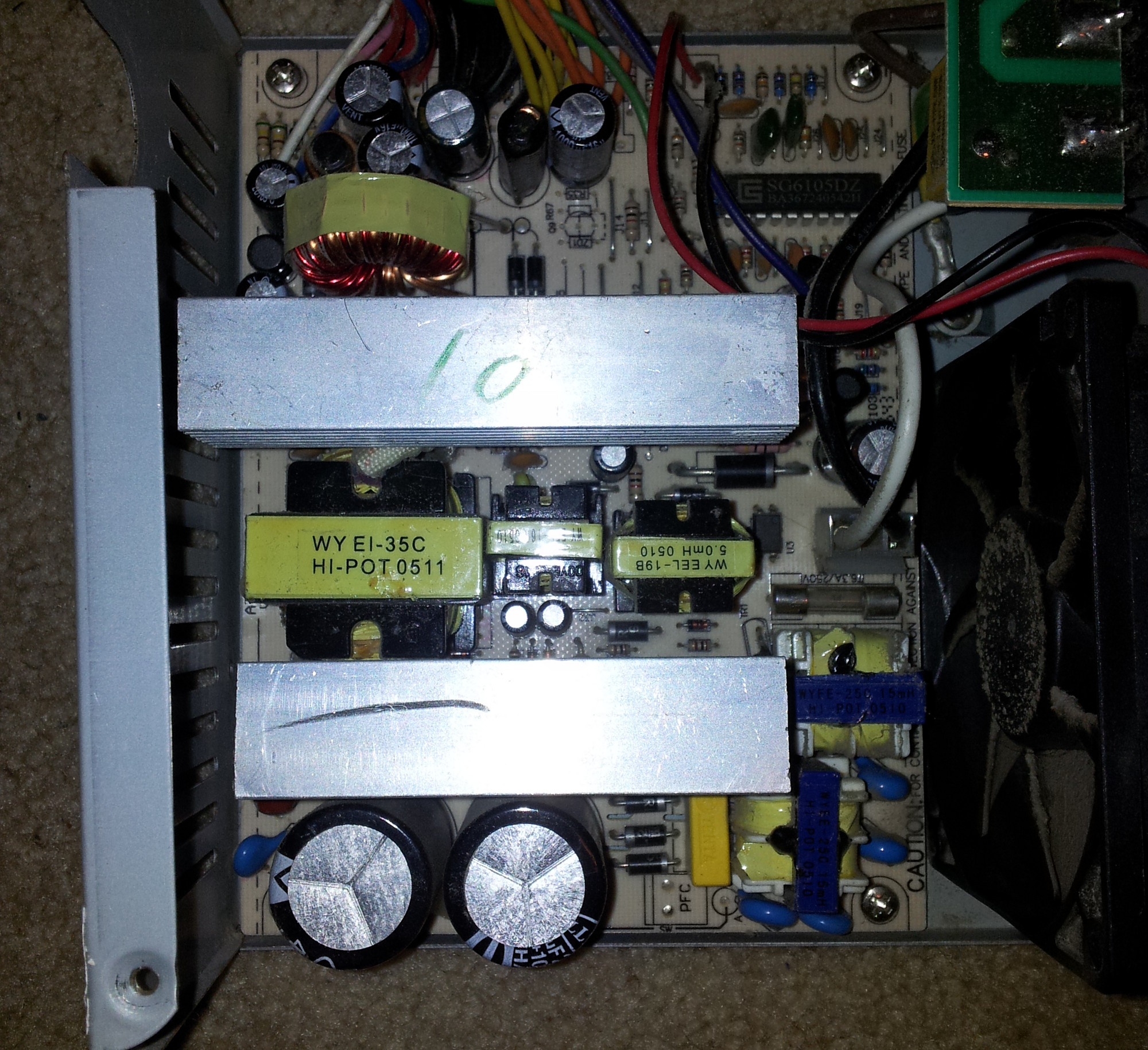

    I made a post about my now apparently dead MSI K8 Neo4 motherboard and it was suggested to me that I post about the PSU here first with some pictures.
    Basically, I turned on the PC and logged on, left the room, came back a few minutes later and the PC was dead. The system had been stable without any hint of what was coming.
    The PSU in question is a Usicase 330U-SCE.

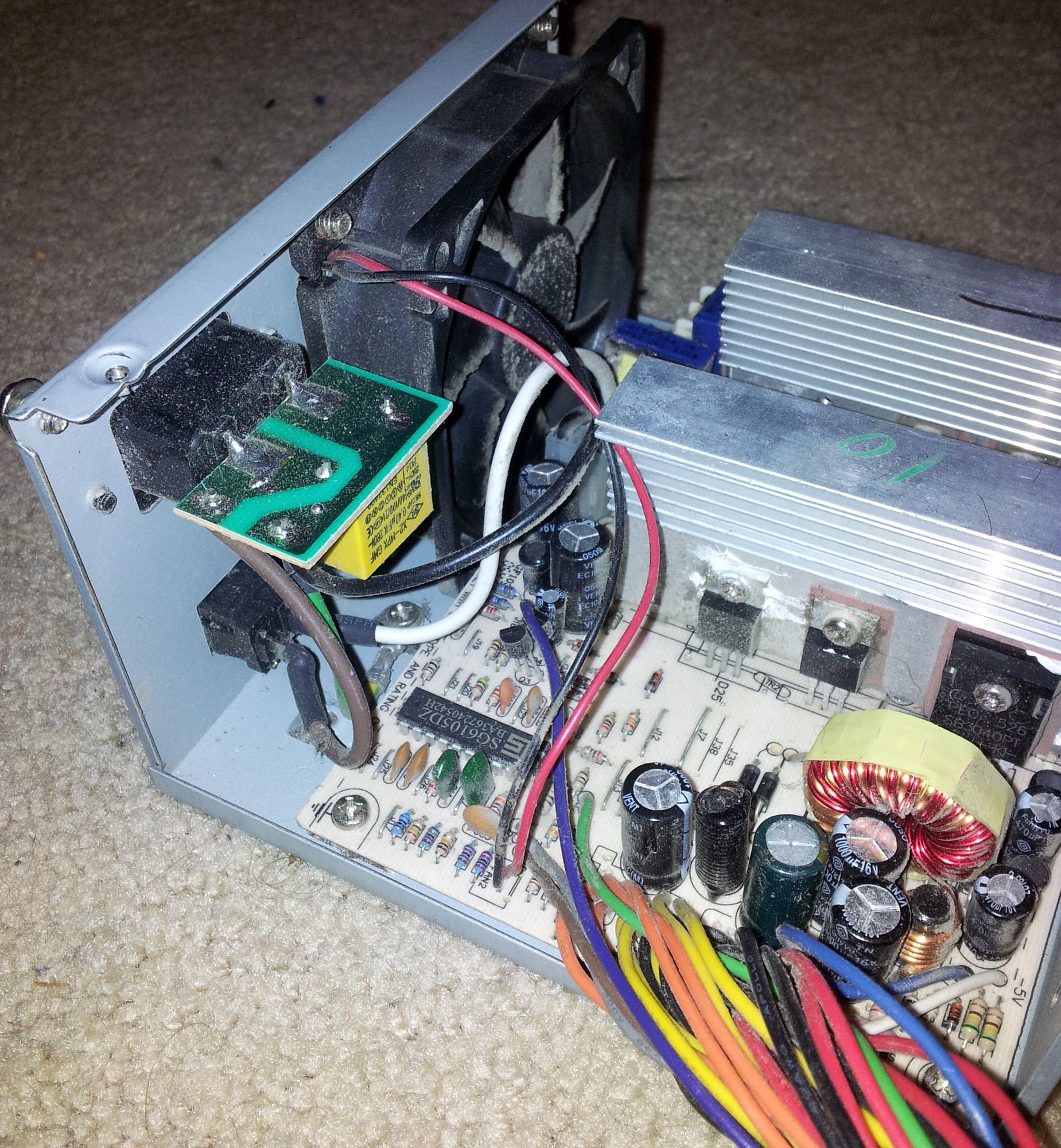

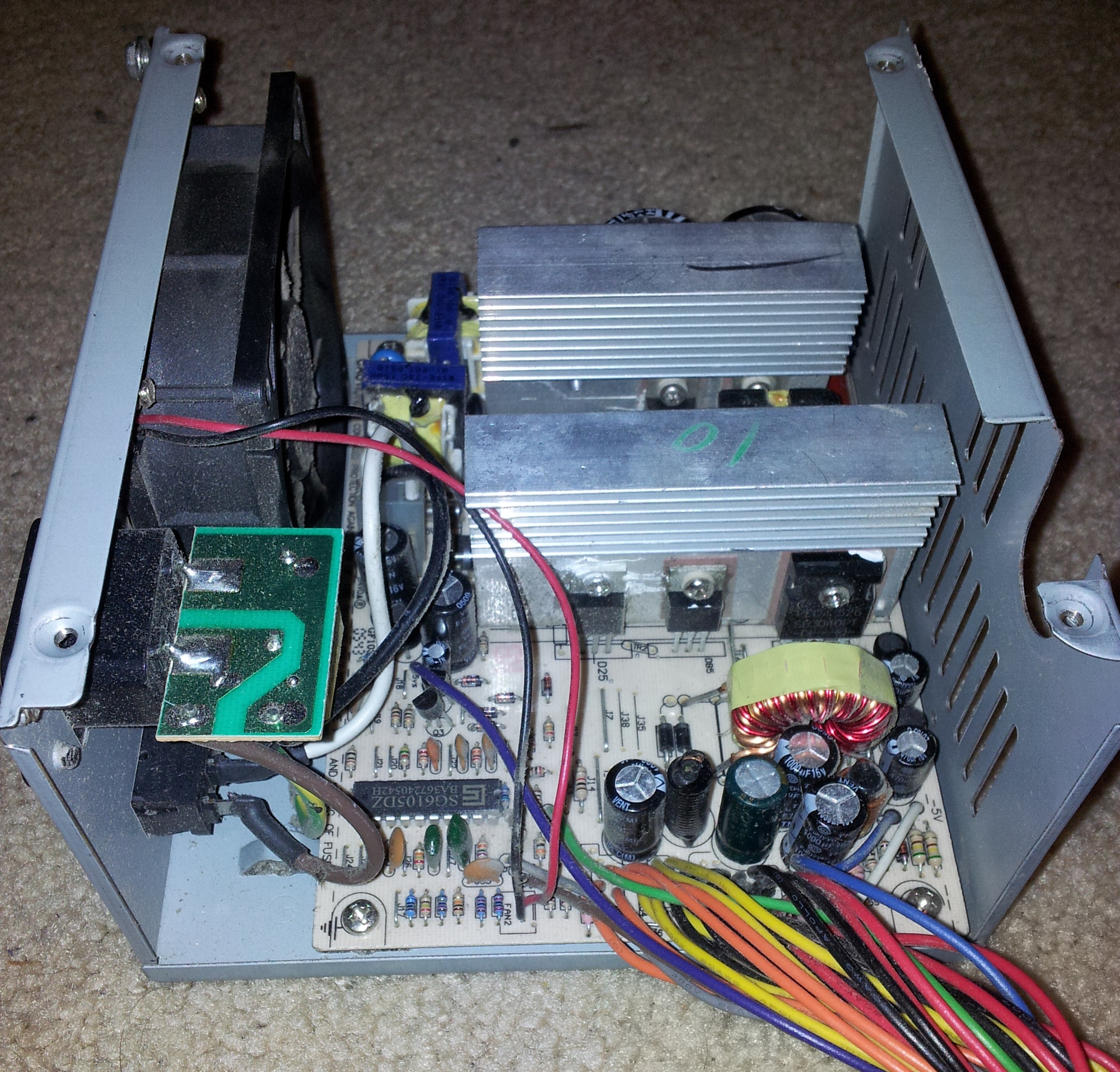

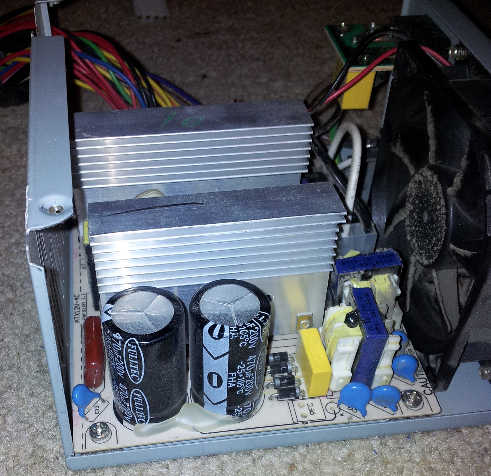

    I opened the PSU up and found one cap with a bulged top. I noticed another one tonight starting to bulge (very slight). I can see no scorch or burn marks anywhere.
    The caps are Fultec, Fuhjyyu and Vent. The failed two are a Fultec and a Vent, both down where all the pigtails join the board.
    Where I've gotten a bit lost is in the behavior of the PSU after the failure. When the PSU is not plugged into the motherboard shorting the ps-on pin to ground turns the PSU on as it should. When the PSU is plugged into the motherboard (both 24 pin and 4 pin connector) shorting ps-on to ground causes the ps-on pin to initially go down to near zero and then shoot up to 14 volts. Would this behavior be indictive of failed caps or something more sinister?
    I guess what we're trying to find out is did the PSU go bad all of a sudden and kill the motherboard in the process, or perhaps the PSU generally ok (just a couple of bad caps) and the motherboard is mostly at fault.
    I guess the PSU might not be worth saving in the grand scheme of things but if I was able to fix it and the mobo to get another month or so out of them while I build a replacement PC that would be good.

      wtf it has only one pi coil for filtering the secondary side? really? dont u wanna split that in half for the other rails as well?! /end sarcastic post

            As much as I like fixing cheap PSUs, this is one that I wouldn't - at least not for powering a computer anymore. The PSU above has a tiny output toroid, not enough filter caps on the output, and worst of all, the 3.3V rail appears to be derived directly from the main transformer rather than regulated by a mag-amp or a linear regulator (this is pretty evident with the high readings of 3.4V for the 3.3V rail).
            So all in all, I suggest not to use this PSU for powering a computer. It might be okay for running small DC motors, light bulbs, and other non-sensitive projects. Or you can use it for parts. Although this is a cheap PSU, at least it appears to have all of the input line filtering: two common-mode chokes, two X2-class safety caps between Line and Neutral, and four Y2-class safety. All of these are good parts that can be used to rebuild another cheap PSU that is perhaps built better on the output but lacks the input filtering. The PSU above also has an SB3040PT schottky rectifier, and that can be used to upgrade another PSU as well.
