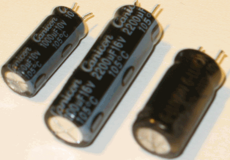

Here what I have found on a DEER ATX 300W PS:
Canicon TC(M) nom. value 2200uF 16V measured values 121.7uF 1.634 ohm
Canicon TC(M) nom. value 1000uF 10V measured values 111uF 1.95 ohm
G-Luxon LZ nom. value 2200uF 10V measured values 19.4uF 6.2 ohm
While the G-Luxon was bulged, the Canicon caps have no visible signs of their failure.
All the other caps that I have replaced, most of them were G-Luxon, were still within specs.
Is it possible that, due to the bad cap on 12V rail, tha HD of this PC has been damaged for the high ripple?
On the MOBO there are several caps and inductance to filter the PSU voltages but the HD is connected straight by the Molex connector and I don't think there are large caps inside it; the HD I have replaced had a lot ruined sectors.
What is your opinion?

and the progress bar was only more or less at 4% of the total disk space. I stopped it because I thought all disk was damaged.
