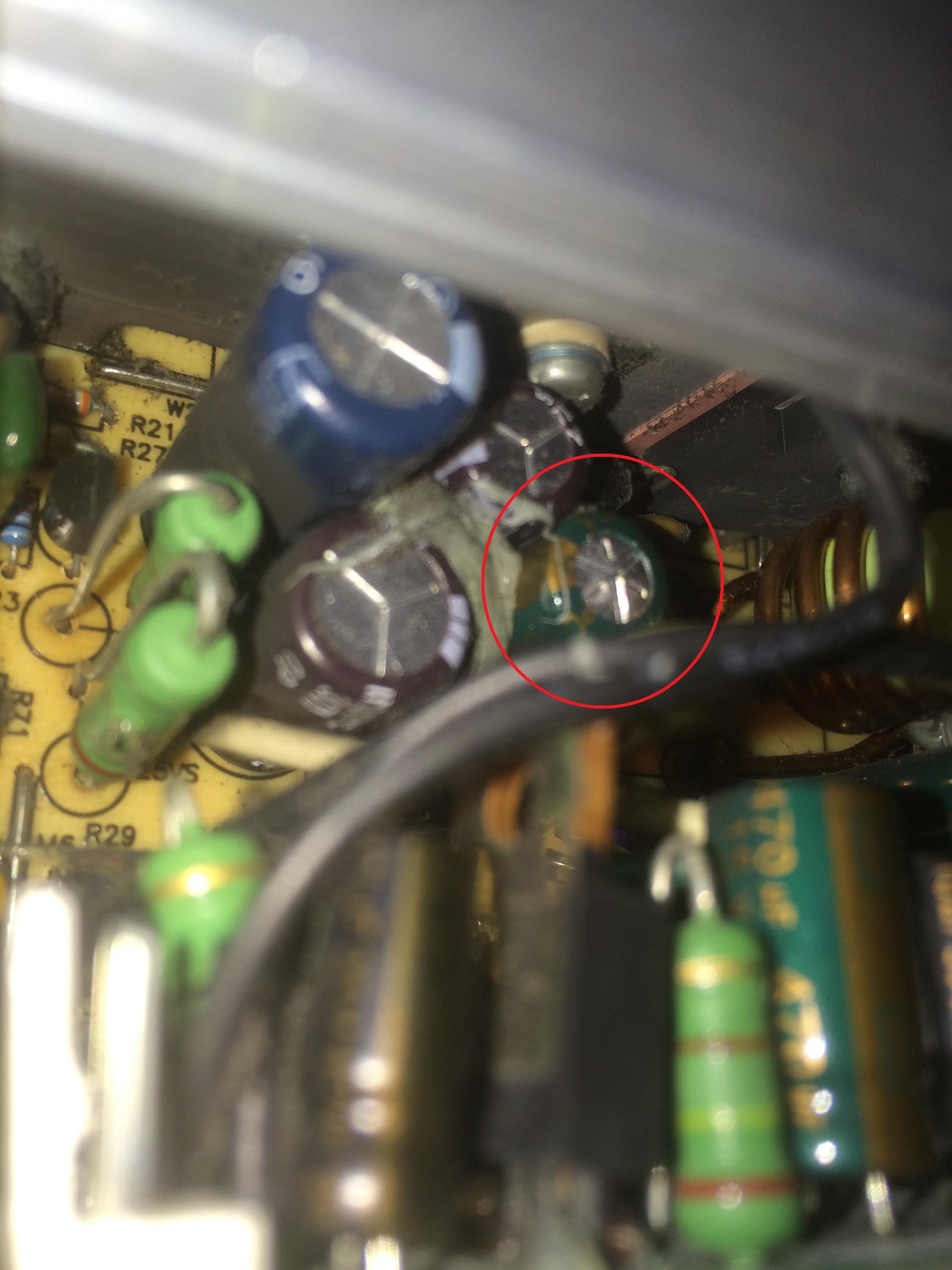

    Hello! I've seen quite a few posts on here regarding these PSU's. And indeed, there's quite a few places around the net of people having general issues with these supplies in their PowerMac G4's. Mine seems to exhibit a slightly different problem though.
    The usual problem is, the Mac won't turn on, lights might flicker etc. I've also seen some people experience their Mac refusing to turn on unless they had an ADC monitor connected. My problem is the opposite to the latter, it won't turn on with an ADC monitor connected, but it turns on just fine without it plugged in. I do have another identical ADC monitor that the Mac will turn on when it's plugged in but it will randomly turn off and lose power, sometimes a few seconds after the Mac is turned on, sometimes it can last an hour (the Mac stays on just the monitor dies).
    Everyone I've talked to about this has either been stumped or merely told me that my PSU is the likely culprit based on the fact I have a MDD and their PSU's are prone to failures. Some have suggested the monitor's probably have faulty inverter boards.
    I figured I might as well open the PSU up and look inside it though given, they are prone to failures. And I have found one cap that appears to be bulged:
    Here's a wider shot of the area with the cap hidden under the two black wires you can see, and then a close up with the apparent bad cap circled in red:
    I notice in the other topics regarding these PSU's that, it's generally recommended to replace at least the main cap anyway, and probably a whole spread of caps too to be on the safe side.
    The thing I'm wondering here is, is it indeed possible that one bad cap like the one I've pointed out (if it is bad that is) could cause the machine to refuse to turn on when there's an ADC monitor connected (but otherwise work fine when it isn't plugged in)? Or of course, power the monitor for a bit but eventually get fed up and die after a while as it does with the other monitor?
    Or is it more likely these oddities with the monitors is a result of faulty monitor inverter boards or something and the PSU is actually OK (well, apart from that one cap)? Anyway, much appreciate any help I can get on this, I am a novice with basic soldering experience and, maybe some ability with a cheap multimeter, so nothing spectacular as you may have guessed.

      Re: Apple G4 AcBel API1PC36 PSU has a bad cap?
      yes that cap is definely bad and i would suggest you to change it
        Thanks for the advice. I've finally got round to pulling it. It's a Teapo, 1000uF, 10v, "SC105°" and says 10/03 and A3 under that. I'm guessing 10/03 is the date of manufacture?
        Seen a lot of people suggest these Teapo caps can be a bit crap. Would anyone recommend a particular brand in it's place? I'm assuming I should go for a like for like replacement.

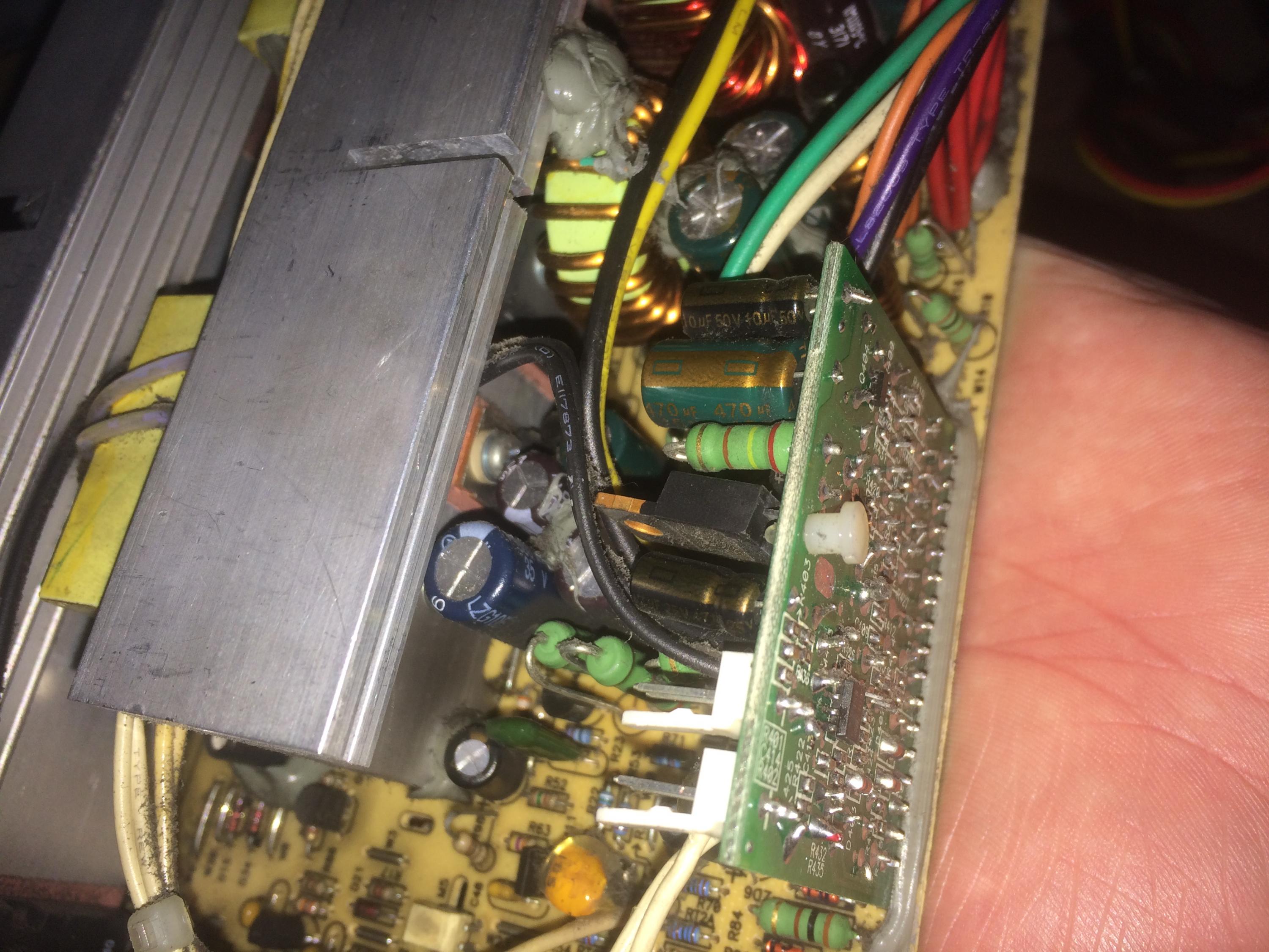

                      I got around to soldering the new cap in, put the PSU back together enough for it to work and hooked it back up. Unfortunately the newer monitor I have that doesn't allow the Mac to turn on unless I unplug/plug the monitor back in is still exhibiting those issues.
                      The older monitor that always did work but randomly used to turn off and remain off has thus far remained powered on while it's been in use. I'm not holding my breath on that though as like I say it exhibited the issue randomly; sometimes it'd work for hours other time it'd work for all of thirty seconds. Fingers crossed anyway that bad cap had something to do with it though I'm being pessimistic merely because most people that have repaired these PSU's have replaced quite a few caps across the board, not just one like I have, so I'd be silly to expect perfect results based on that knowledge.
                      Edit: On second thoughts having had it running for a while... I think the PSU is actually worse than it was before I started messing around with it. I've only just realised but it's making a prolonged creaking or clicking sound now. I think it did this before but I always assumed it was the hard disc but, it's not the hard disc as I've now realised since I leaned over to pick something up and realised the noise was coming from the PSU... Odd. Can't say I noticed it before either, though I'm not sure as it might have done it before but not as audible? If I move the mouse cursor around the screen the noise changes pitch too (hence why I thought it was the Hard disc at first).
                      At any rate, the oddities don't stop there. The system seems to hang now. OS X works, I can move the mouse around but that's about it. Works fine for a few minutes initially then I can't really do anything else except move the mouse around. Mac also doesn't seem to go to sleep properly anymore (it goes to sleep, eventually, if I press the button but all the fans stay on in the computer, though the PSU does stop making that weird noise). Before when you put it to sleep the fans would all turn off too and the power lights would start to glow.
                      Soooo... Yea. I guess I was right in thinking it needed more work doing to it than just replacing one bad cap. But, didn't think at all that replacing one obviously bad cap would actually make it worse... Or that it would have quite such an impact on the system as a whole.

                                        So I thought I'd come back to the old PSU and carry on rebuilding it. But I have a question to put to you experts!
                                        Before I took the PSU apart, it worked OK (the problem I had of course was the monitor not the PSU, even thought the PSU had a buldged cap it seemed to be functional in all other respects as far as I could tell). In the end I actually got another identical PSU as a bonus for buying some parts for the Mac so I left the old PSU as something to at a later date.
                                        Anyway to recap (pun not intended) all I did was replace one cap (Teapo) with another (Rubycon) of the same size, voltage and uF rating, (1000uF and 10v) just with a slightly higher ripple (1250 over the original 1080) and a lower impedance (0.041 over the original 0.065).
                                        It looked OK, put it all back together, powered it up but it was "squealing" quite badly. I'm fairly sure it didn't do this before I replaced the cap so, I just wonder what might cause that squealing noise to occur and, if it's because I made some sort of cock up with the replacement? Thanks.
