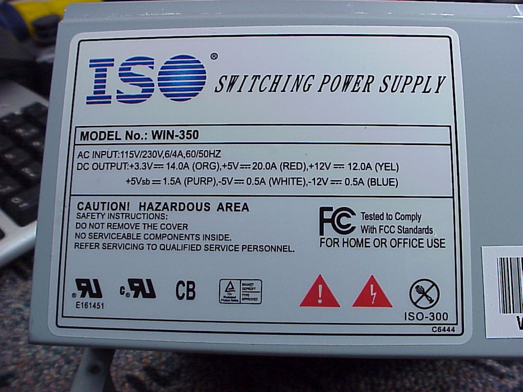

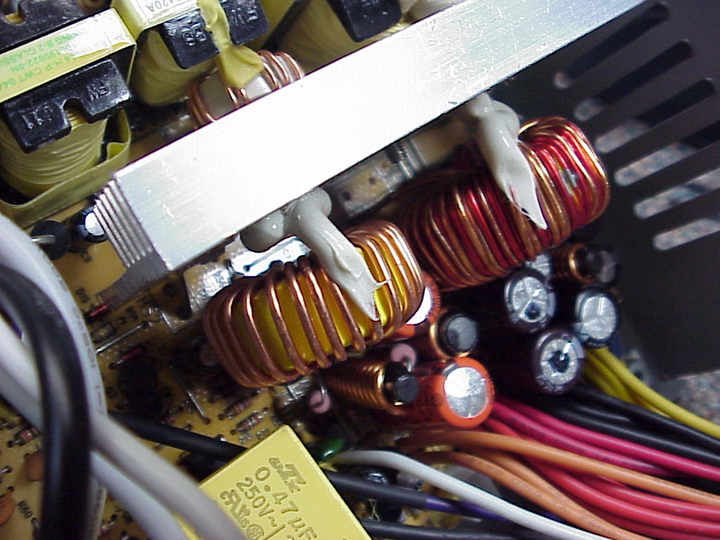

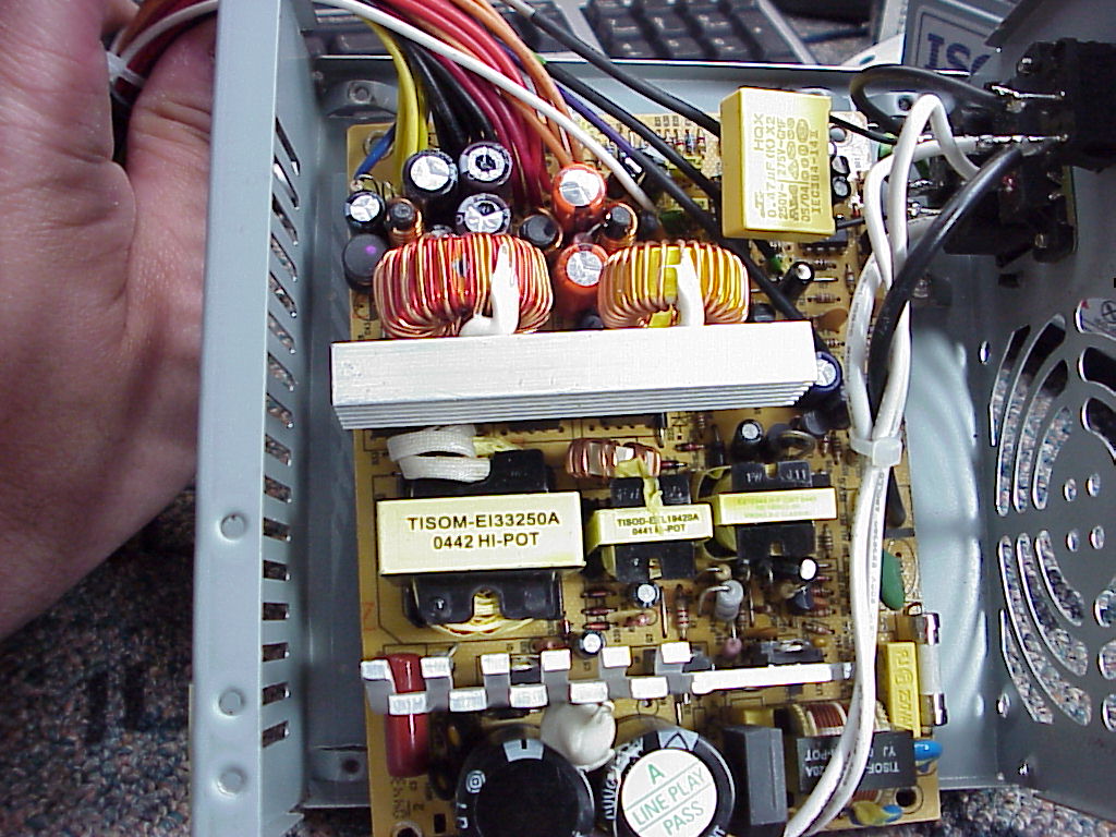

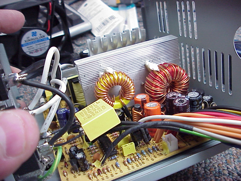

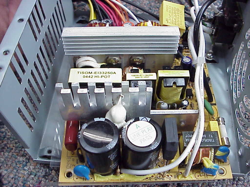

    iso win 350.orange fuhkyyu caps
    still crap no matter what color.

    Looks like F-U is up to their same old tricks. Everybody knows orange means quality, right?

      All Fuhkyyu? This is a psu I won't buy

        its passable other than fuhkyyu caps.
        has line filters,x and y caps ,ect.
        i doubt it will last if run near that "350w" rating though.

          Yep, thats an Apevia made "Turbolink powersupply". The PC I built my parents have a 500watt Turbolink that looks exactly like that. Orange Fujiyuu is leaking and bulged. I left it go though because my stepfather is too cheap and said it was my responsibility to pay and replace.

            Actually, ISO is Channel Well's budget brand. The Turbolink stuff you mention is worse
