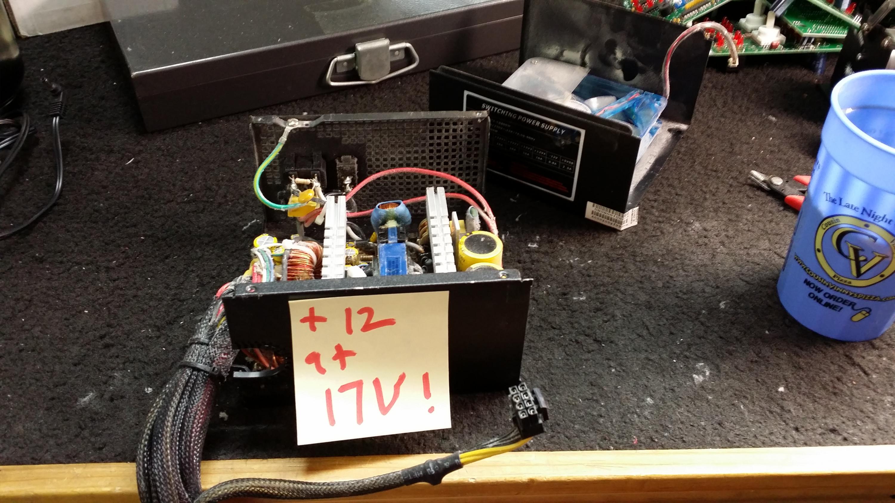

atx-cb800w.this hunk o junk cost somebody their system!
  • kc8adu
    • Nov 2003
    • 8832
    • U.S.A!

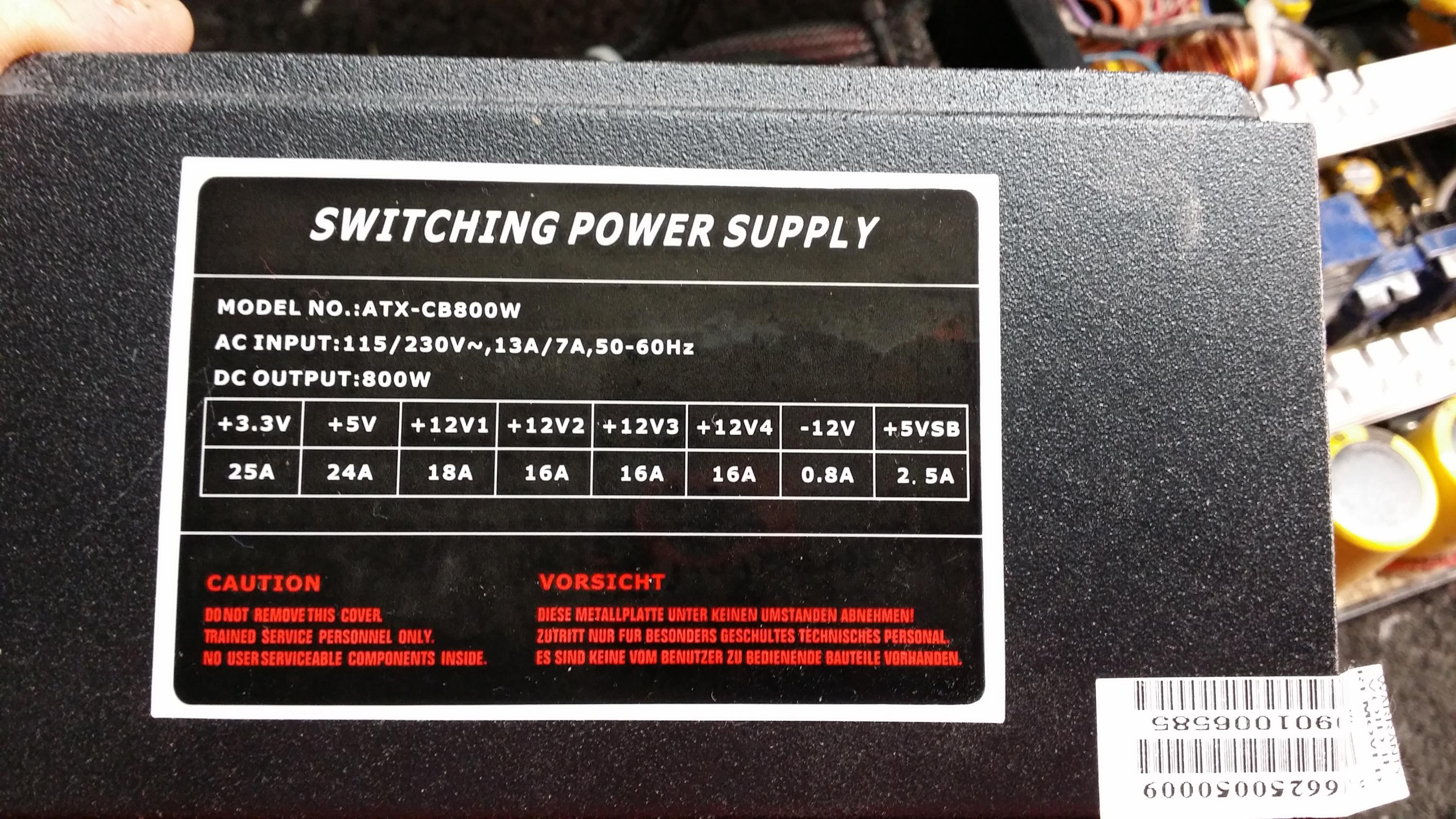

    seems to be an apevia sold by cyberpower.
    its a real loser.a 2004 design that was lousy then.fuhjyyu and capxon.
    but this steaming pile was found in a new build!less than 1 year old.and all killed.17v on +12.

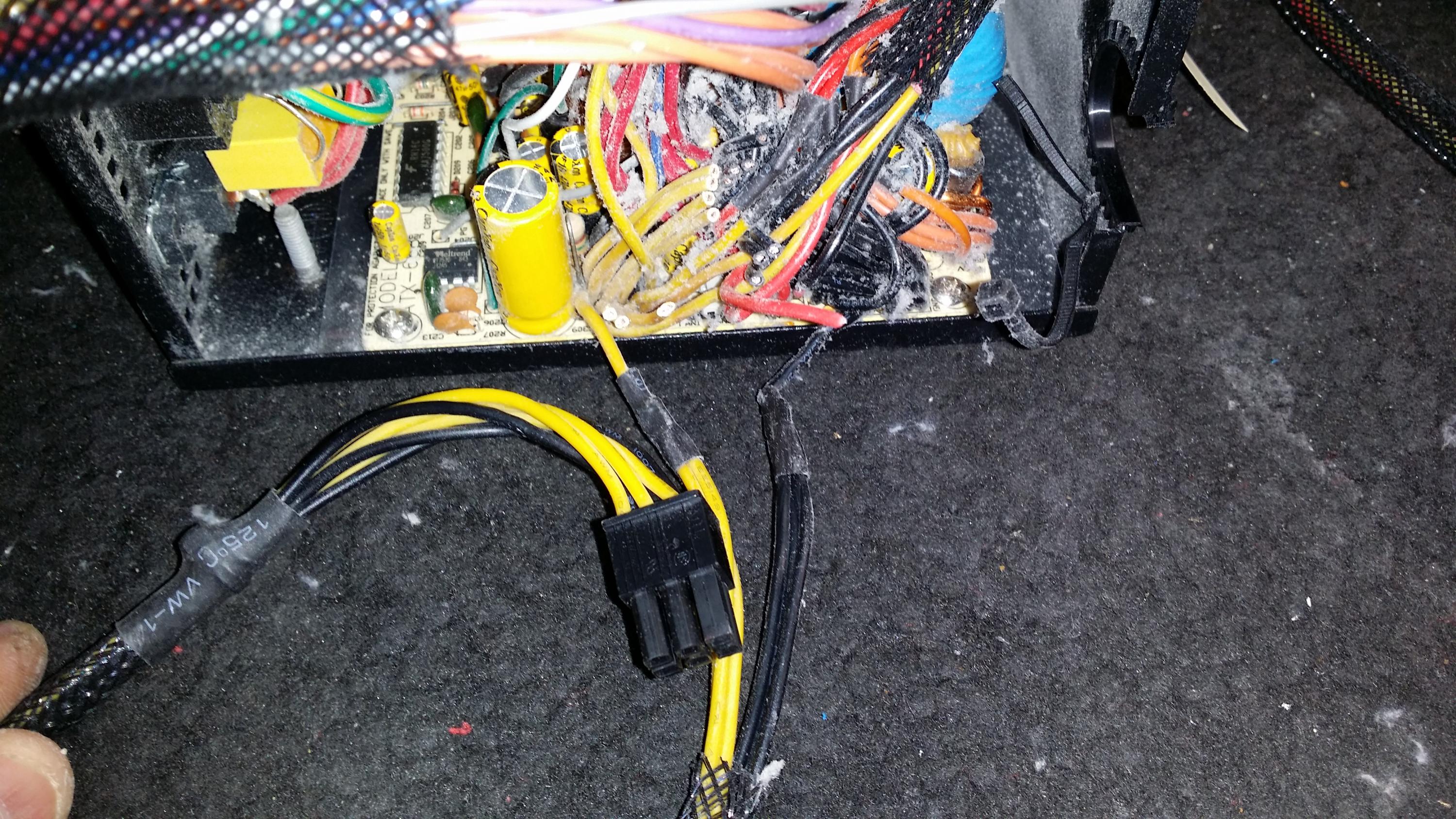

    What's all that white shit? Dust? Where in hell did it live?

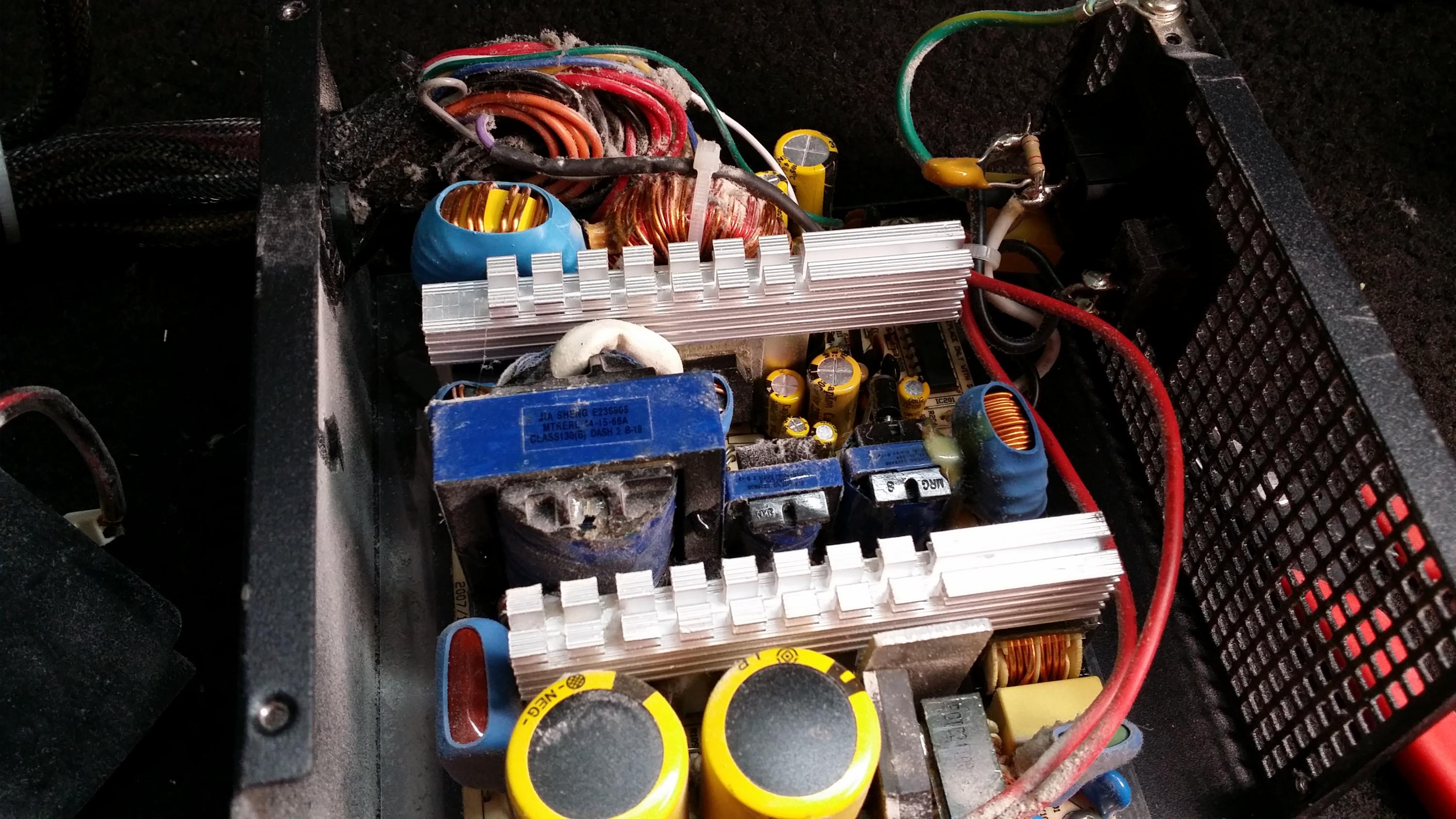

      Originally posted by kc8adu
      seems to be an apevia sold by ibuypower.
      Low-rent, lying scum. I've heard "stories" before; we won't go there.
      Why do I think those yellow capxons look more like fu-joos? More fake capxons- what will they think of next???
      (Hint to myself: they are fu-joos!)
      That's more like an incomplete (half-baked?) late 70's design- if there was summed feedback on +5 and +12, it should've cut back. Whereas when feedback is taken only from +5, everything else runs away if the thing "kicks harder" to bring a low +5 (from bad caps?) back up...
      Result= +/-12 runs away, (also -5, if used), and magamp (if used) sees excessive input voltage. Another deer than ran away...

          Wow, 17V on the 12V rail?!?!
          Component-wise, this PSU doesn't seem all that bad (minus the caps, of course). Probably good enough for 300-350 Watts if it was designed well. But I guess it wasn't.
          Any idea what the PWM chip was? And supervisory IC (if any?)
          Most newer half-bridge PSUs use SG6105 or 7500/494 with TPS3510 and both will shut down in most cases with an over-voltage on any rail.
          Seriously, it's 2016 already. The half-bridge design has been around since the 70's and well used in the 80's and 90's. It's so basic, it is laughable today. How the hell do you mess that up?! Even a Deer won't do that bad.
          *edit*
          I see. It has a 7500 PWM and Welltrend WT7510 supervisory IC. It's supposed to shut down with anything above 13.9V on the 12V rail (not that 13.9V is any good for your hardware... but still loads better than 17V). And it didn't!

              the +5,+3.3 have a big coil and a single cap.open of course.the47@50 fuhjyyu is also open.
              would not surprise me if ovp,ocp were disabled too.

                That 7510 supervisory chip should have caught the overvoltage condition on the 12 volt rail. Makes me think the 7510 chip is dead. I have seen 7510 chip failure when the two transistor 5vsb went overvoltage and killed the 7510. What voltage does the 5vsb measure?
                        I concur.
                        kc8adu indeed mentioned that a 47 uF 50V cap was open. I would assume that is for the 5VSB.
                        If not, I think it is also possible that the WT7510 could have failed from the open cap(s) on the output rail(s). If the 5V cap goes open circuit, I think that Weltrend IC could see some serious ripple and voltage spikes - possibly well above its maximum rated. Same goes for the 12V rail cap, which is even more likely to have gone O/C due to being under more stress.

                            Is it just that plastic thingy, or are the input caps bulging?
