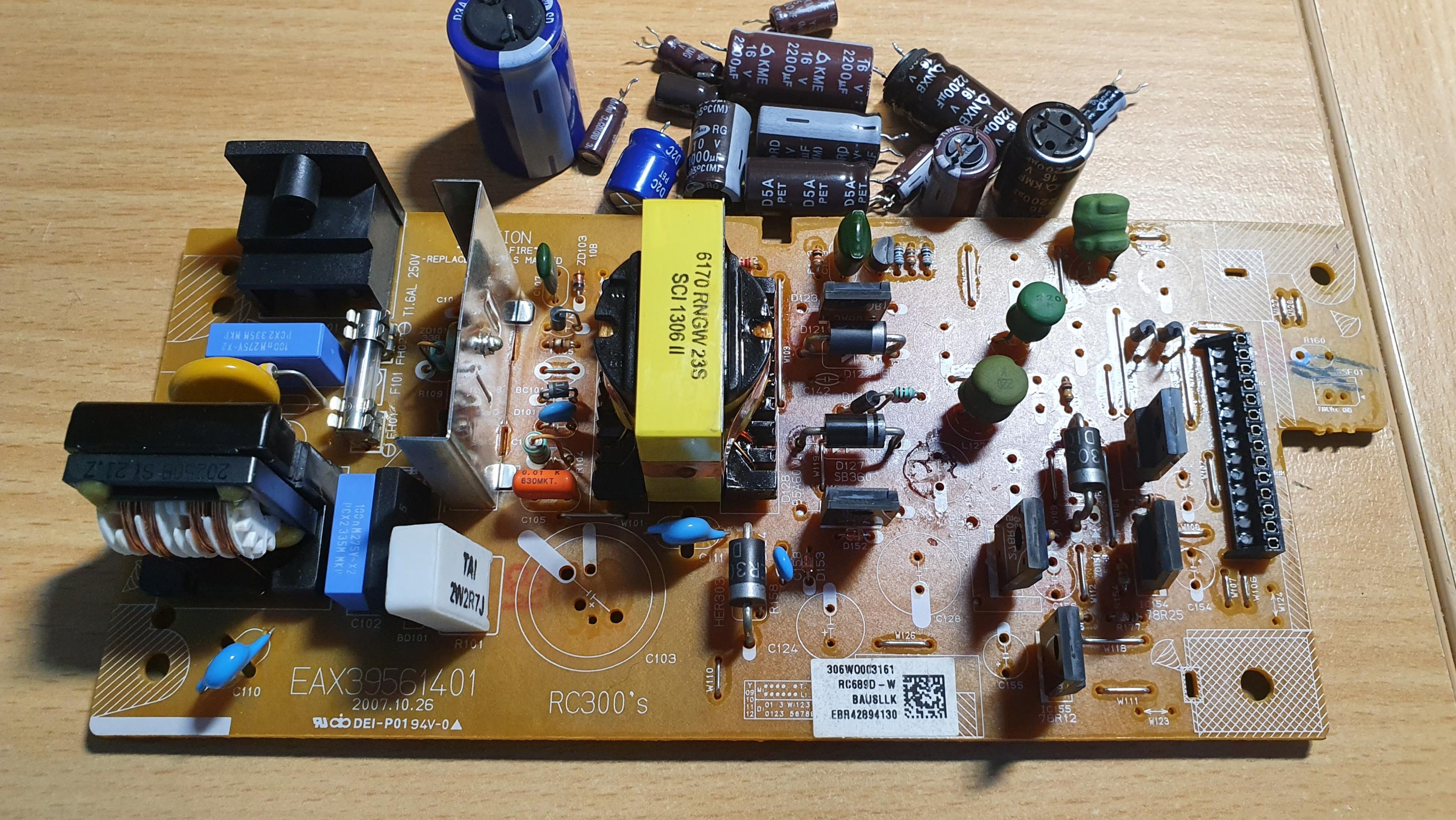

    Hi all, I have 15 capacitors to replace of varying voltage and uF I looked on RS Online but I can only buy them in the least of a 5 pack when I only need one or two or three of a type, so far I'm trying to get the price down from $47.10 and thats without postage so where online is a good place to buy caps in 1,2,3 or 4 at a time. They are all electrolytic caps and I'm choosing Nippon Chemi-Con or Rubycon or Nichicon etc. as long as they are good quality. I need the capacitors in a power supply for a friends DVD/VCR combo player so another question I have is, would all the capacitors be DC and not AC? Its for an LG RC689D I have a pic of the power supply below but all the capacitors are removed already and its had work done beforehand so I dont know if I should increase the voltage on all the caps in case this was done already. The highest value cap is 450V 68uF 85c from Samwha Im going to use all 105c instead.

    here lies the dilemma, yes buying small quantities are expensive, especially those high voltage units. Electrolytic capacitors are generally for DC and PSU boards are for the most part using DC so that's not an issue. Question is why you're replacing the capacitors in the first place?

        Thanks Mockingbird but I'll buy them from my country to save time and holding delay, eccerrOr I have to replace the caps as the output voltages from the power supply are under and its stuck in a loop of the welcome message on the display and wont play DVD's

          Don't forget to clean the PCB under the cap next to D127 & L127.
          Looks like you've got dried electrolyte residue there.
          Also check the traces on the back/bottom.
          Isopropyl alcohol & a cotton swab should take care of it.

            If you are doing small quantities your best bet is to find a local brick and mortar place. You can probably save a few bucks and skip replacing c103, those large caps tend to not go bad.
            If you see yourself doing repairs going forward, it's much cheaper if you just start stocking the common vaules. Increase the voltage if feasible (price and physical size) so you don't end up stocking multiple voltage values.
