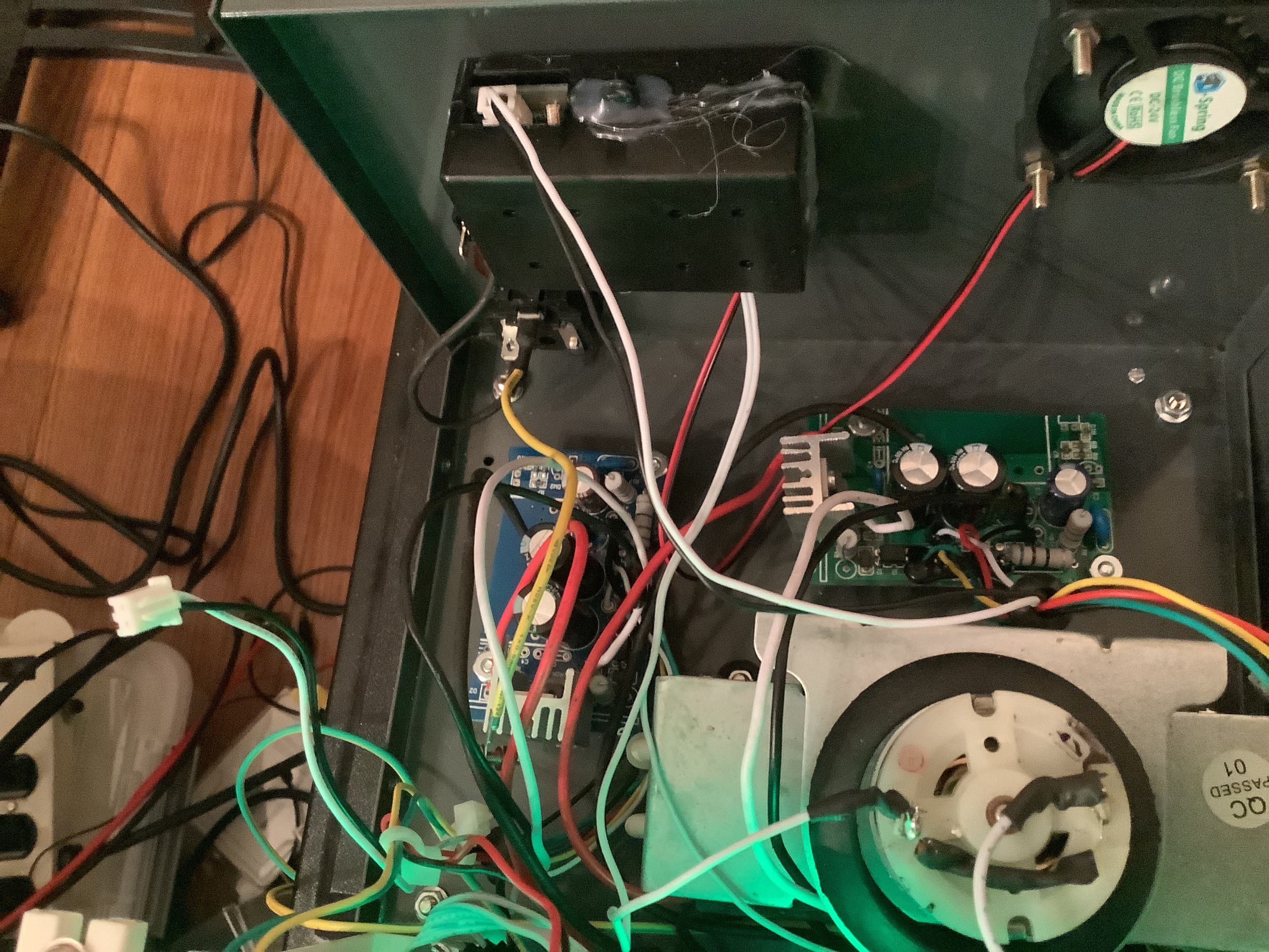

                New project for a 9 volt @ 40 amp switching power supply for a 8.4 volt battery pack that I am going to build for dual battery cells I want to build a 9 volt battery powered power supply for some 9 volt device that I have because I going to use some buck converter that controls voltage and current to charge the battery pack and a boost converter for the output
                I am buying it from the same eBay seller that I bought the 18 volt @ 20 amp switching power supply from
                They also sell a 13.8 volt @ 30 amp switching power supply that I also going buy in a couple of months for another project
                  • Jul 2011
                  • 6055

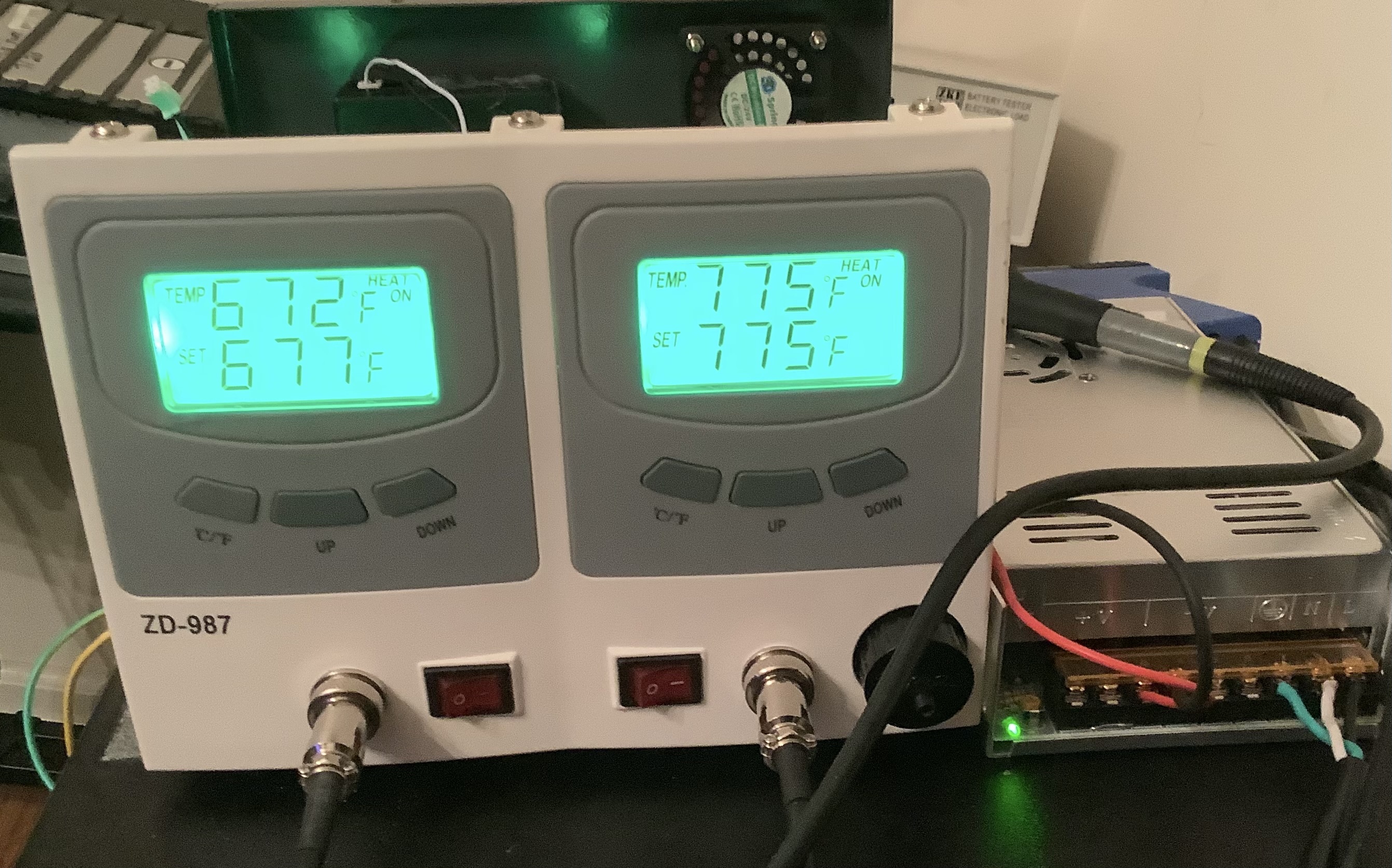

                  Well I got the second secondary switching power supply boards about 80% done and testing the second one for about an hour or so just to make sure that everything is good to go and then I will remove both original switching power supply in the dual soldering iron / desoldering gun station and put in the modified secondary switching power supply boards for the controller and the vacuum pump and the cooling fan and see how this works out if things go well then I will finish it permanently and put it into service and go from there
                    • Jul 2011
                    • 6055
                    Well I have not had time to finish this project yet but have not abandoned it some higher priority projects have gotten in the way but hopefully I can finish this project soon and put it back in service
                      • Jul 2011
                      • 6055

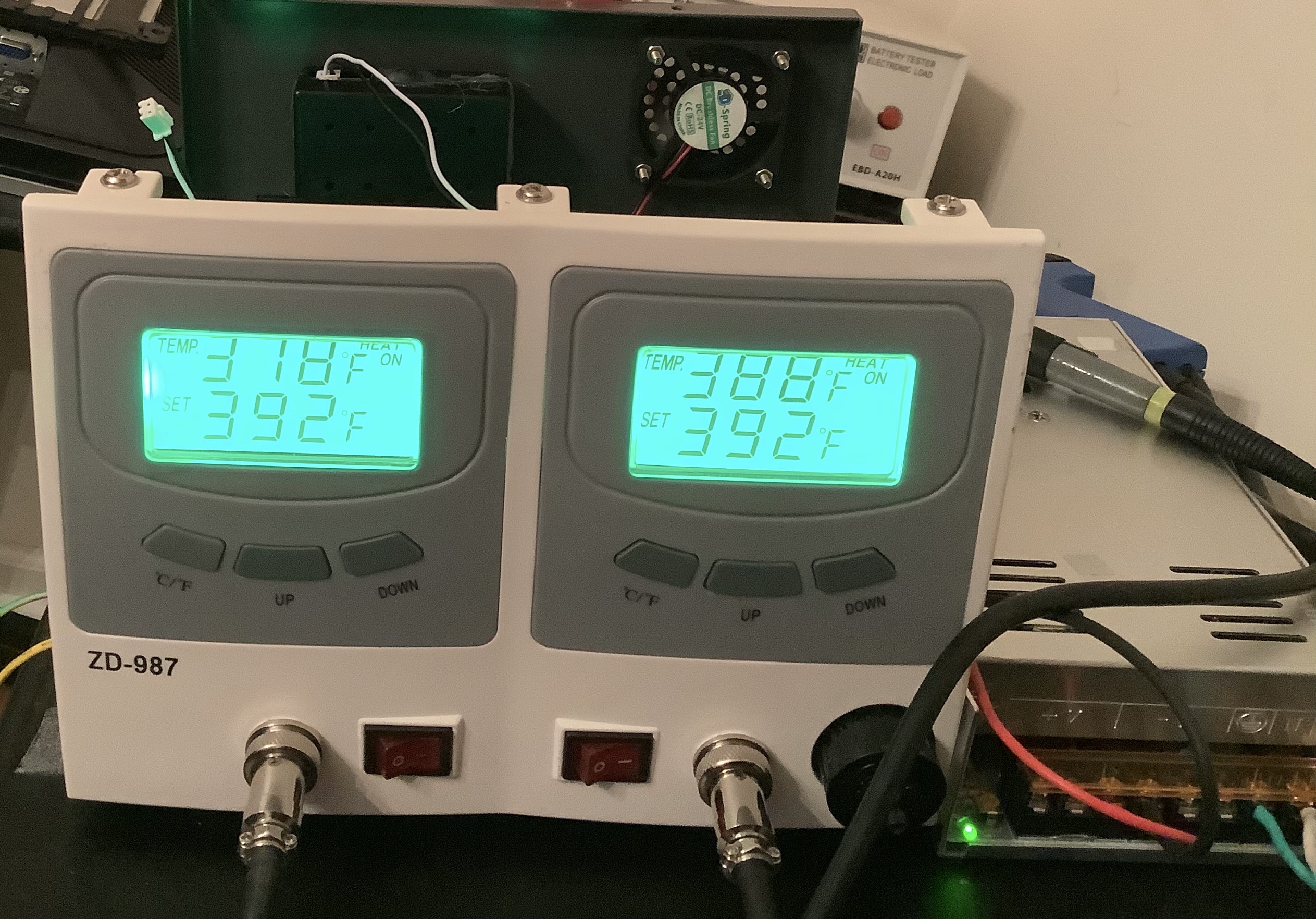

                      Progress on this project finally I am not done with it completely but I am getting somewhere with it though I put the modified controller power supplies in and I hooked it to the 18 volt @ 20 amp switching power supply and everything so far is working perfectly I even turned both the desoldering gun and soldering iron on at the same time and the vacuum pump as well did not even blink at all
                      I think I going to mount the switching power supply on the side of soldering station because that way I will not be tempted to put something on top of the cooling fan
                      The last picture is the soldering station in sleep mode so everything is working as expected
                        • Jul 2011
                        • 6055
                        I going to answer the question I posed in the title of this post and yes this switching power is well worth the money for this switching power supply and in fact I going to do another modification to a couple of more desoldering stations that I have so I can severely units so I can several different size tips
                        At least this is the plan for now

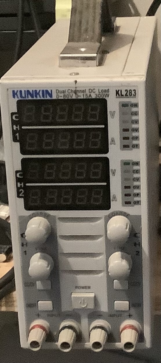

                              I need to find some time to see if I can repair a two channel load testing machine that has an issue on one channel because I have an idea of how I want to use it this going to depend on weather or not I can fix it or not I will be posting s post about it when I start working on it because I probably will need some help troubleshooting it to figure what is going on with this channel and why it fluctuating so much stay tune more to come later

                                  I hope to start working on it in a few weeks or it might be longer than that but I am hoping that it not too long before I can working on it
                                  Here is a picture of the load testing machine I plan on working on very soon I hope
                                  If I have to buy another one I going to buy the same model number except that it is the A version which instead 80 volt version this one is 150 volt version
                                  https://www.ebay.com/itm/12654203712...Bk9SR4SG-uy6ZA
                                  It is only slightly higher in price than the original version that I have now
                                  Here is a post on another forum site about this load testing machine
                                  https://www.eevblog.com/forum/testge...ectronic-load/
                                  There is actually a review of this load testing machine on this forum as well
                                  https://www.badcaps.net/forum/troubl...c-load?t=86168
