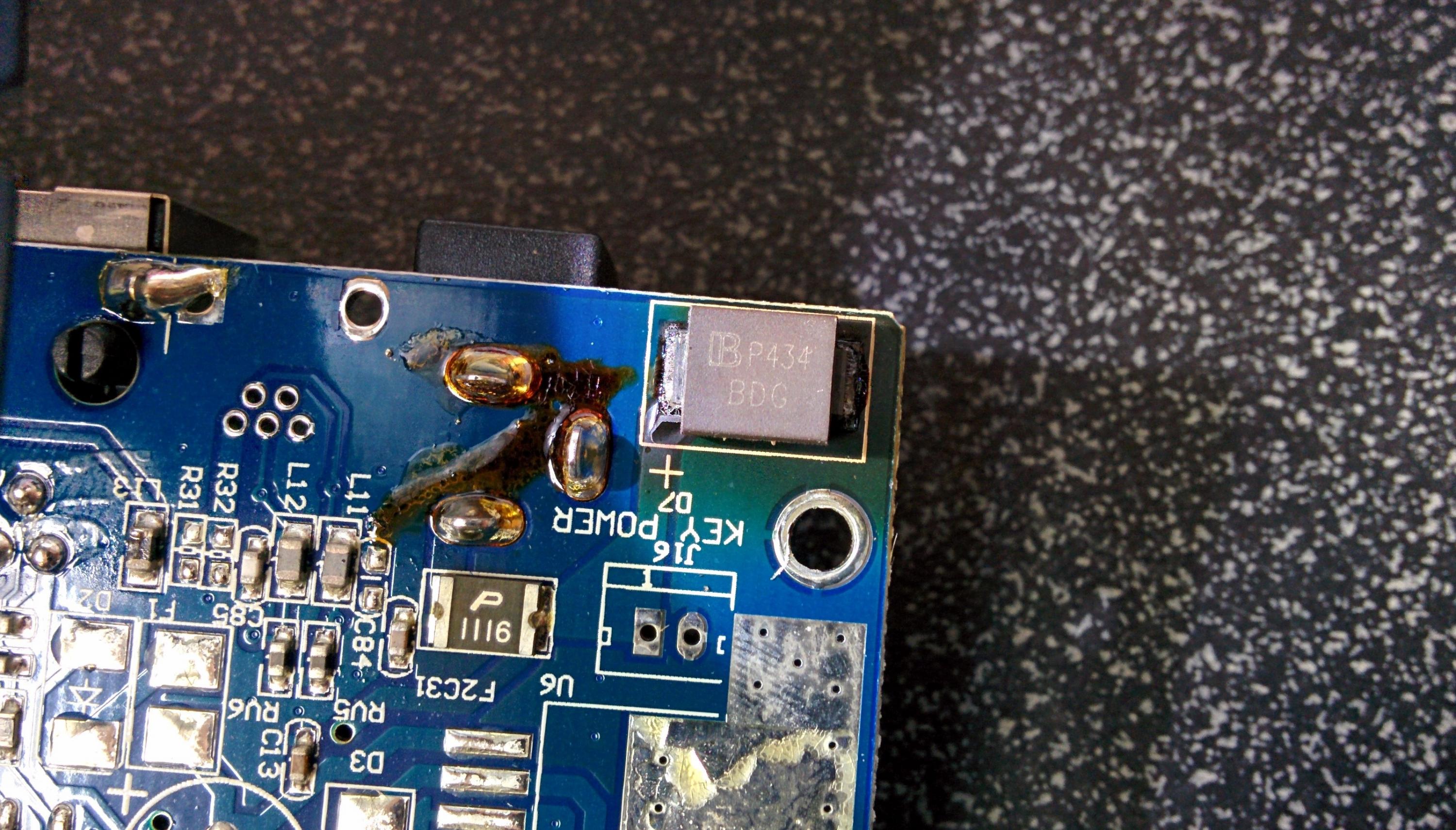

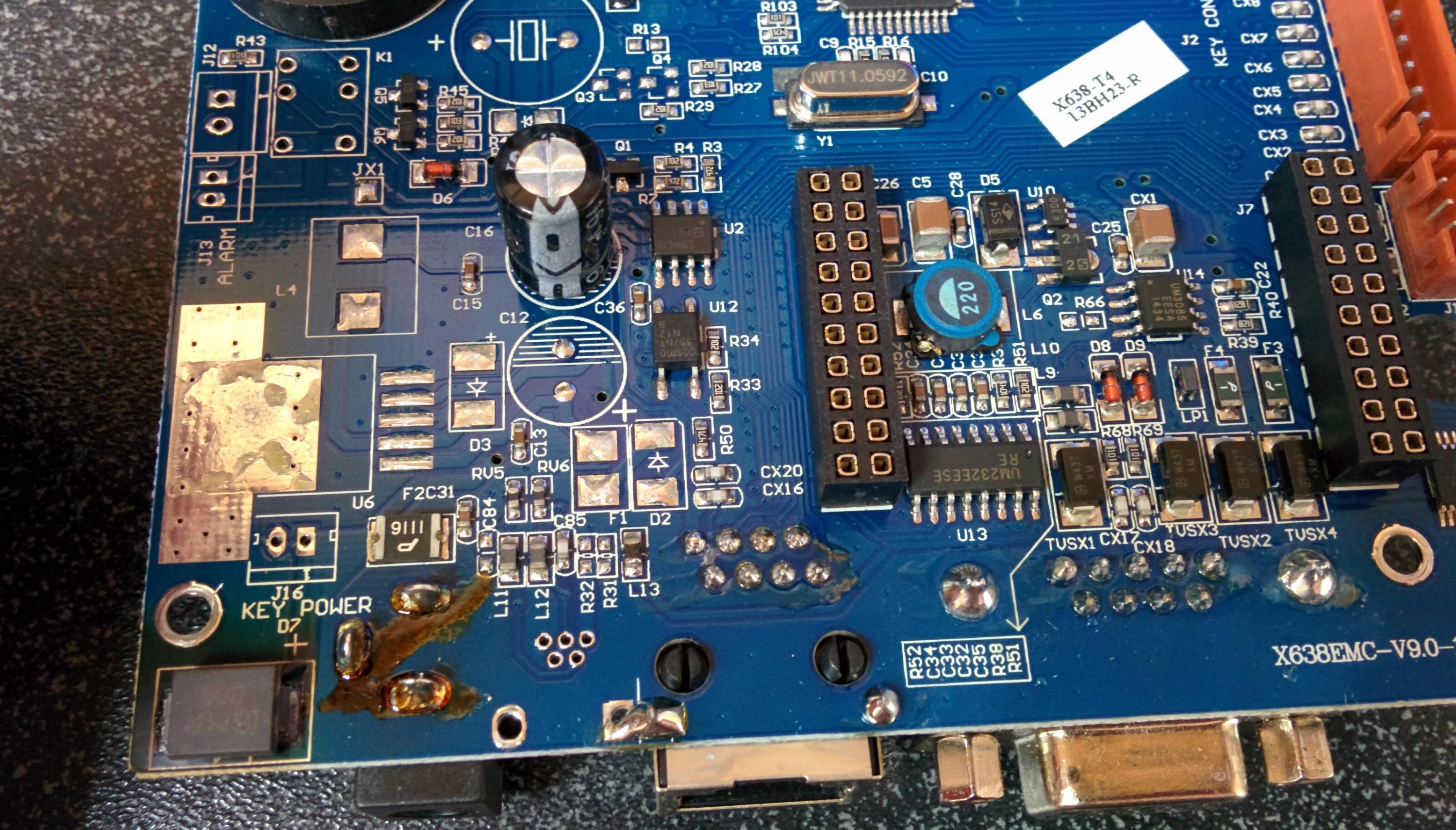

    This device had a 6V adapter attached to it, and it looks like it toasted a diode.
    I was wondering if anyone would be able to help me identify the diode, and a suitable replacement for it? I have attached some pictures of the board. Thanks in advance!

    did you check the diode? that is a protection diode (transient voltage suppressor)(bdg) looks like . I would check the fuse (f2) and see if it is open.
    I would think the diode could handle 6v but if it activated it would blow the fuse. Fuse [P] looks to be a 3amp.

      f2 is not open, the diode has about 7ohms resistance in both directions...
      Thanks for your help!
      *Edit* Just tested the power adapter that was hooked up to it, and it looks like it was putting out over 10V!!!
