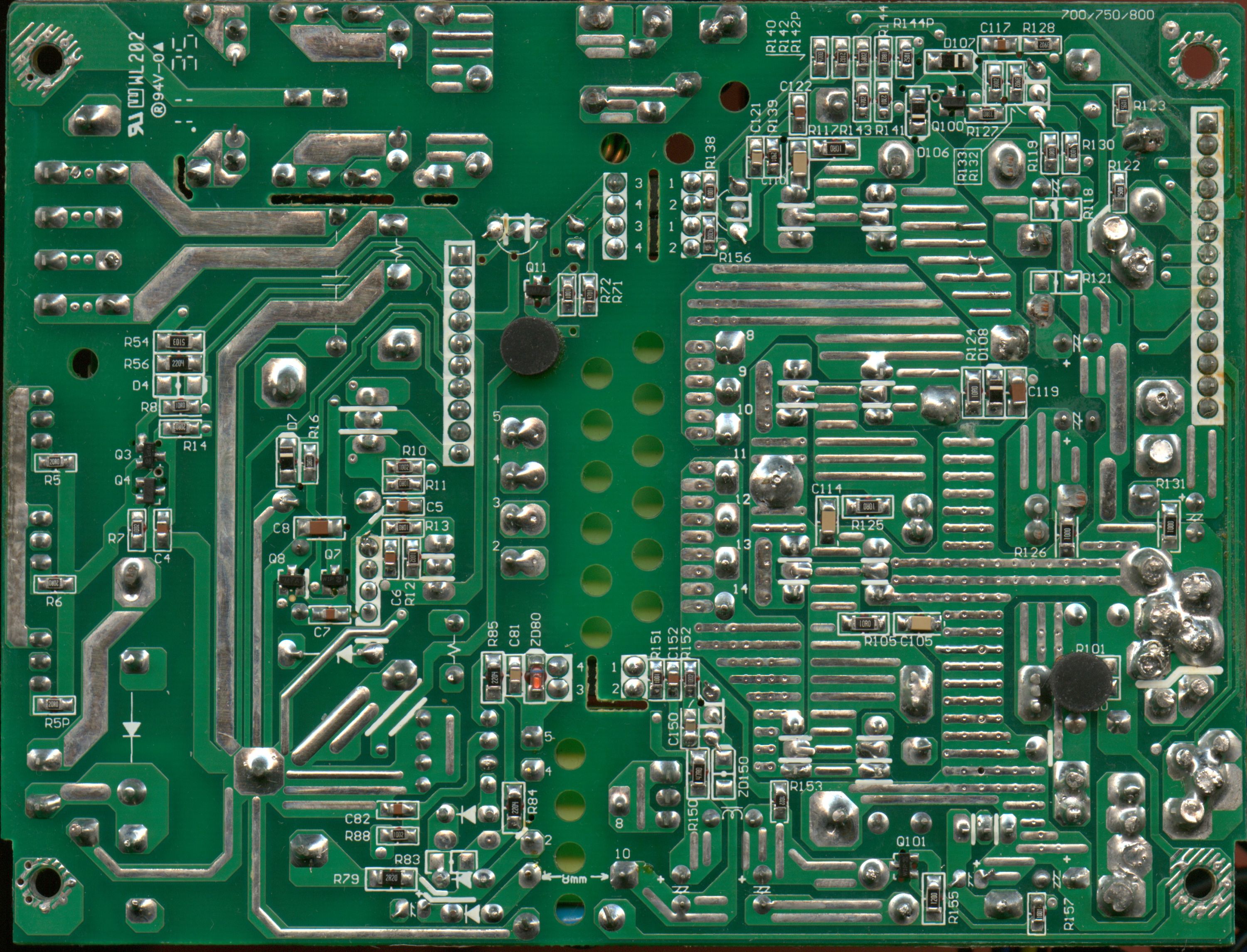

      Re: Thermaltake ATX supply goes BANG! - TR2 RX-750

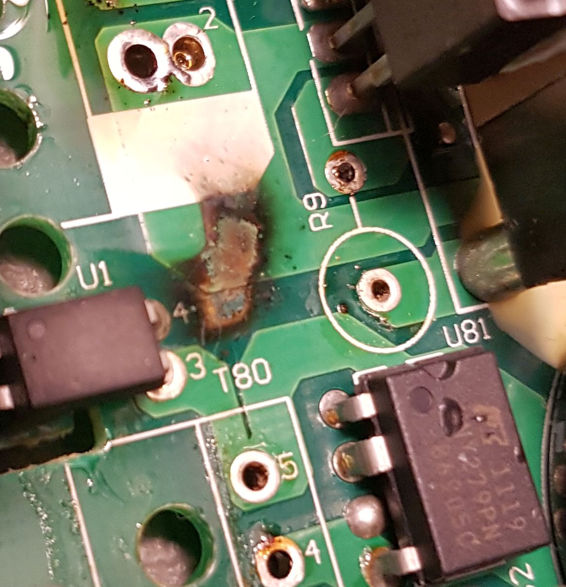

      Is this not a skid mark around this transistor? I do believe whatever this is has puked it's guts.
      Popcorn.
        Originally posted by bcstedt
        Must be the lighting, I don't see any from here.
        No

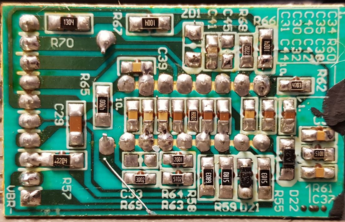

        You have a lot of bad soldering joints when you see a ring around the joints those need to be reworked
        I would recommend replacing all capacitors that are less than 100uf
        at a minimum
        It would be better if you replace all the caps except the the main capacitor

              I definitely notice a gap in the solder joint right under R7!
              R7 looks okay to me.
                It's below R7 and to the right of R6.
                  Yeah that's a shadow, little dip in the solder.

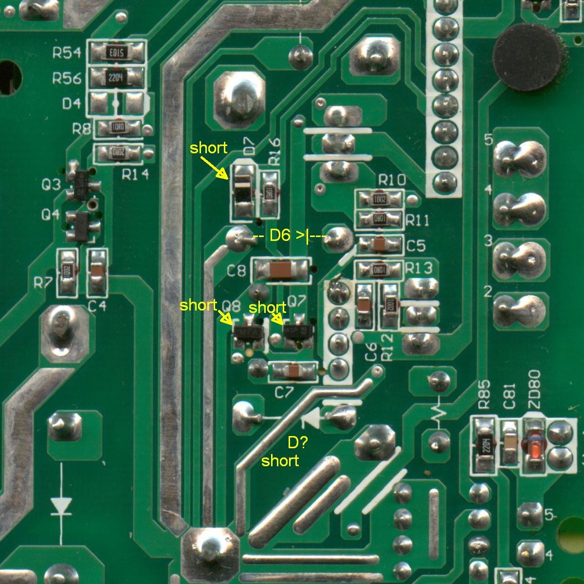

                    #29
                    Found some shorts!
                    Q7, Q8
                    D7, D?

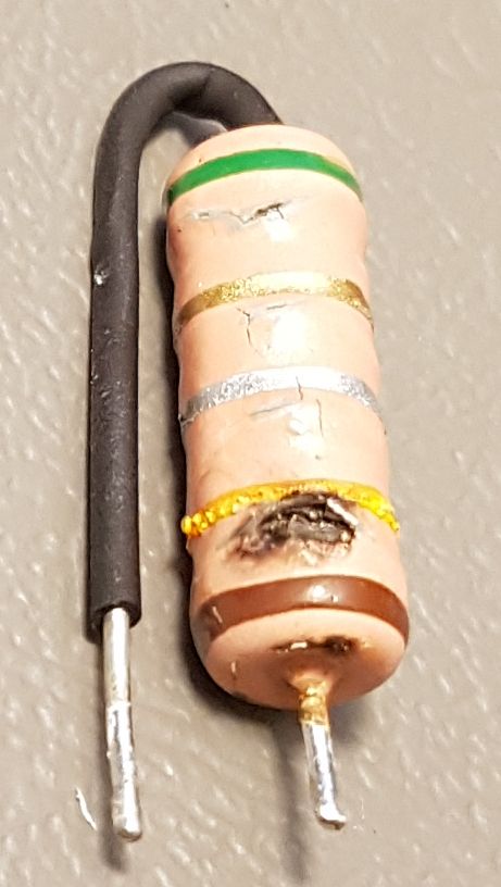

                      #30

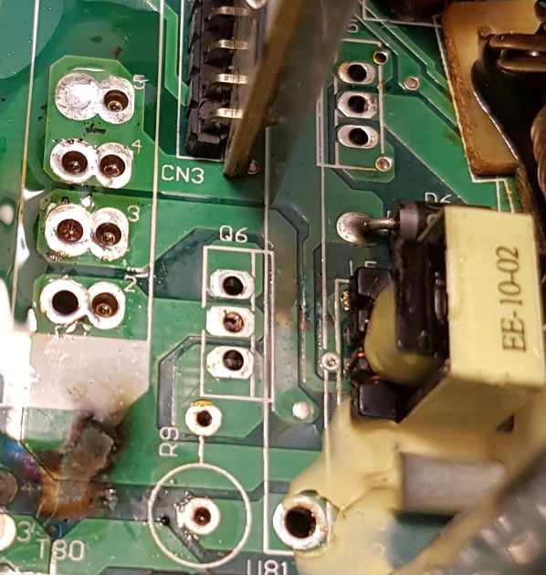

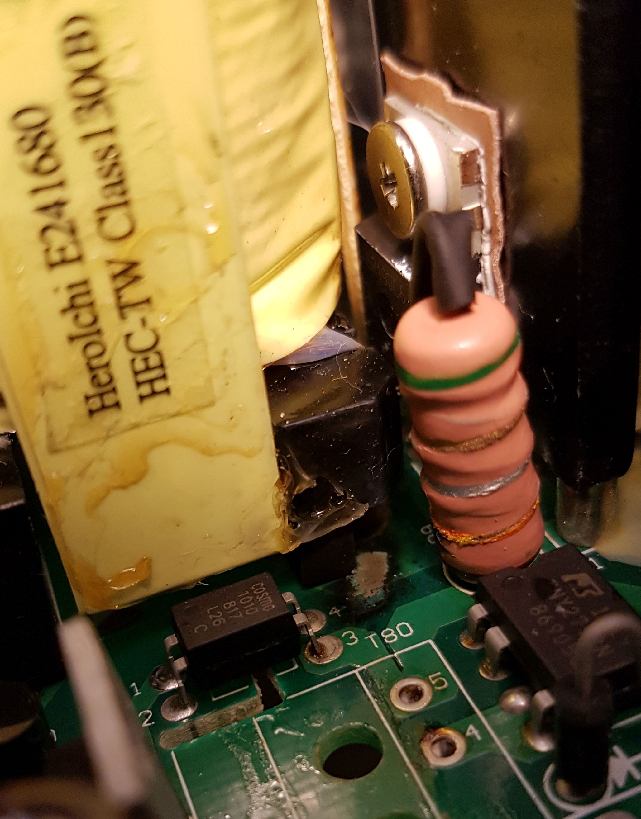

                      Well, I found some of the bang! Looks like R9 spilled it's guts because ... ?

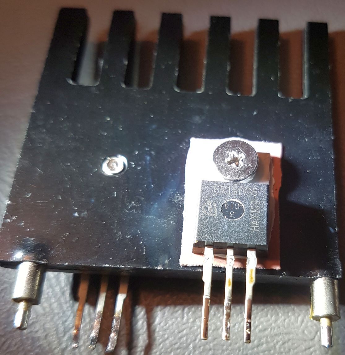

                        #31
                        ... Q5 and Q6 are shorted. 6R190C6

                            #33
                            Originally posted by stj
                            and q5 & 6 are driven by what?
                            that has to be checked next

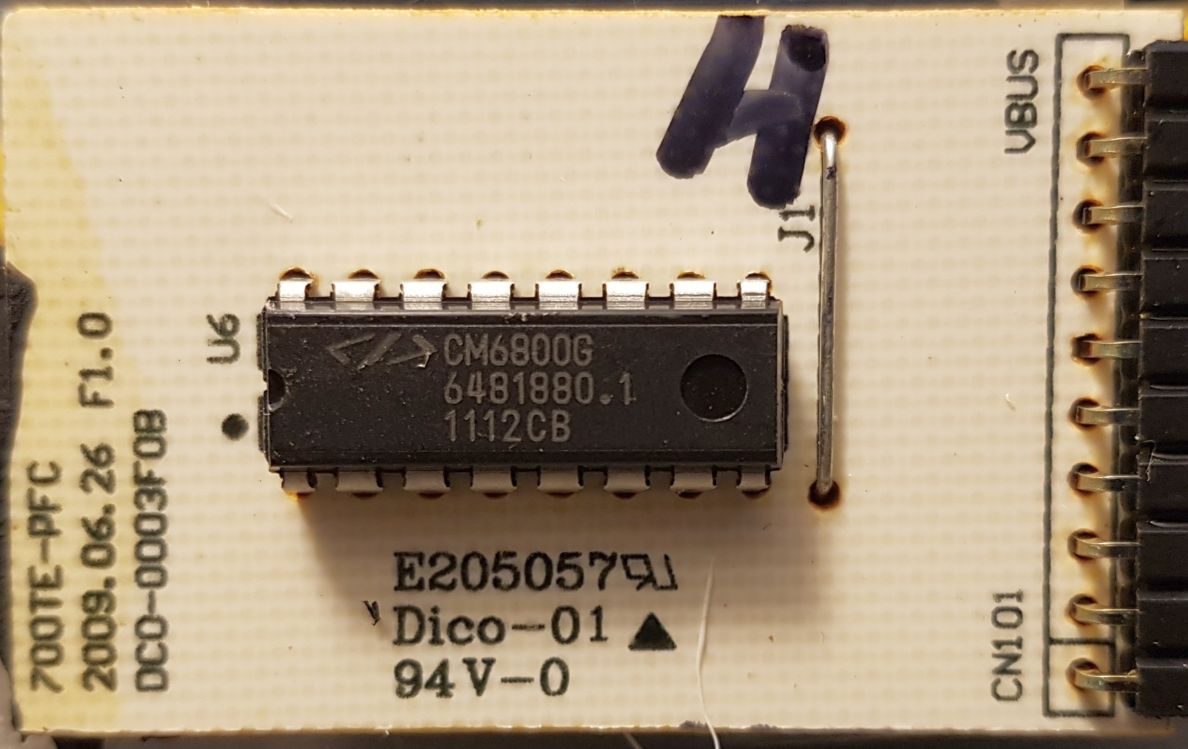

                            Driven by CM6800G!

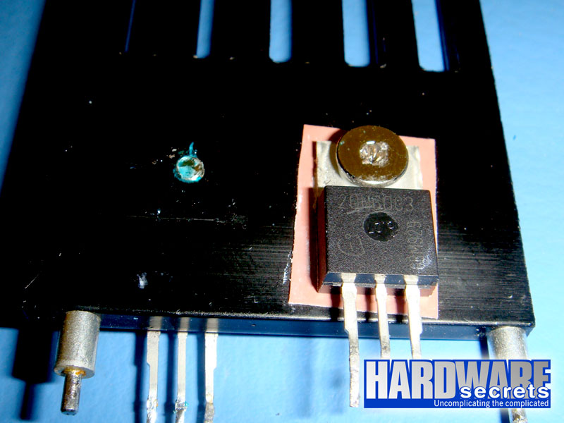

                            Any thoughts on replacing the 6r190c6 with 20N60C3 or FCP20N60 (ON Semi) or ... ? I'm searching for details on issues or reliability related to these FETs and found a few situations where these substitutions were made. Also, in one review of this PSU they show the 20N60C3 instead of the 6r190c6.
                            Just curious.
                            • Behemot
                              • 4845
                              • CZ
                              #34
                              Yeah me thinks IPx60R190C6 and 20N60 look like equivalents.
                              Think that 500V FET should be fine as well, it's two-forward when it has CM6800 without even looking, and most of them usually only had 18N50s (or 20N50s when over 600 W). Depends on what you can find around.
