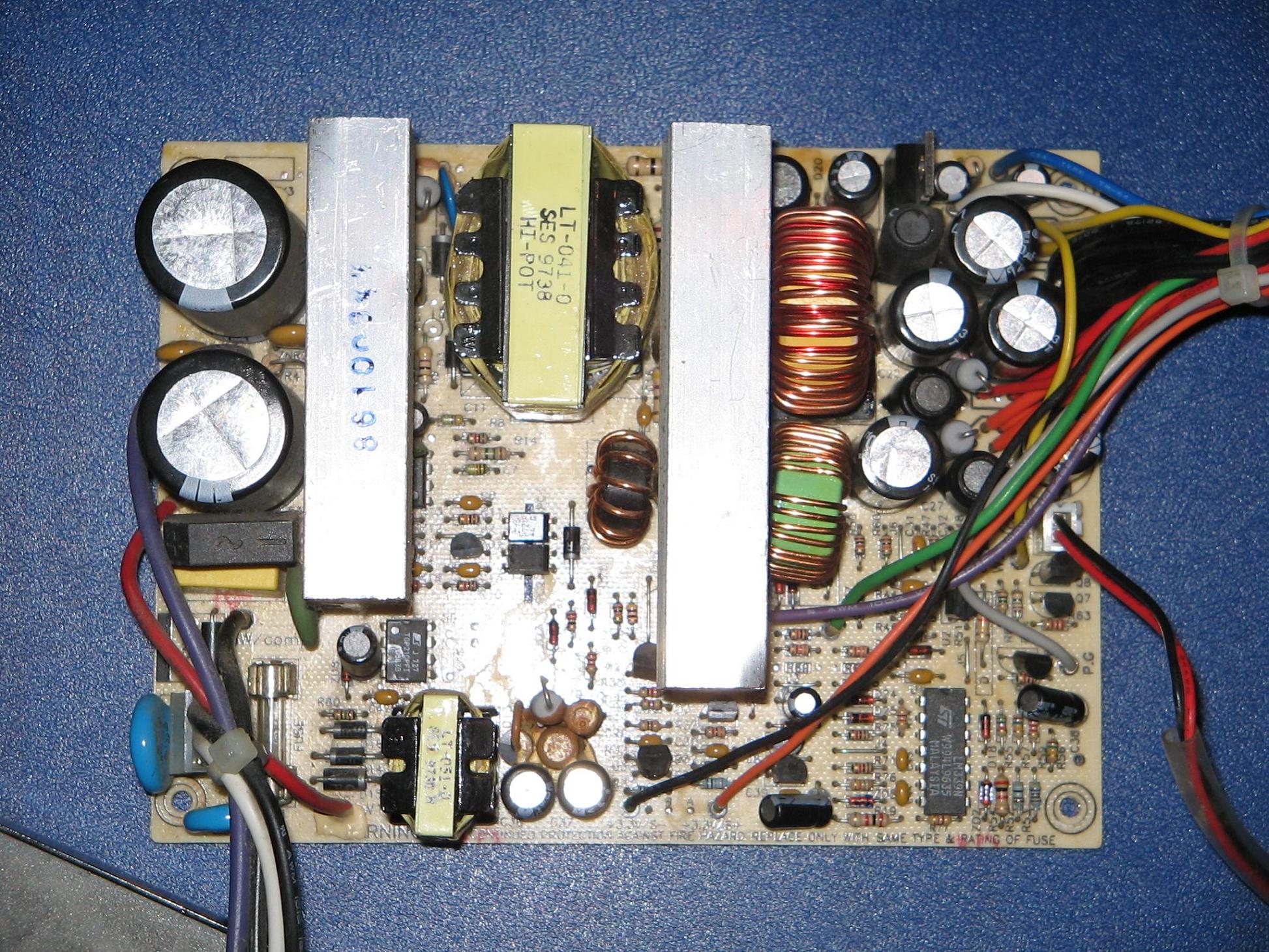

    Picked up an old case for free (using it for my in-progress HTPC ) until I get a proper one
    It came with an old enermax PSU - "hey this could be good" I thought...
    Not wanting to risk anything, even on an enermax I decided to take a look inside, nothing seemed amiss, in fact I spotted a couple of rubycons in there
    I proceeded to hook up an old (80MB) hard drive for loading and started it up. no smoke or fireworks, but 12v was sitting at 11.04 and the hard drive just didn't seem to be able to spin up fast enough to actually get going.
    Checked the other rails which all seemed fine, but -12v was way out at -8.6v
    Now nothing is visually wrong, all caps *look* fine (though we all know that can mean nothing) - on second look though, not all of them are rubycons for some reason... some are CTC (I think is the brand)
    Any ideas on what would cause this otherwise good PSU to act in such a manner? the caps perhaps, or could it be something else?

      But back to the PSU in question - I've attached a photo, hopefully it shows what you were interested in, if you want me to take anything more specific, just say.
      Bottom right is your LM339, top right is LM3905 which regulates the -5v rail which is taken directly from -12, and in turn comes off of the 12v at some point, it seems.
      voltage reading from the output of the +12v rectifier (STPR1020CF) showed 10v, which is probably not helpful to the state of things. Can't get a reading on the input (maybe i'm doing it wrong?)

        I think you may need more load at the 5v & 3.3v rail. Those PSs are group regulated, thus if there is no load at the low voltage rails, 12v will stay low.
        A HDD is not considered a load of any meaning for the 5v rail.
        Apart from that, if -12v is important for your setup, just check voltage before the -12v linear regulator. If it is is in the range of a little higher then -12v just replace the VR.

            is this measured or via some onboard monitor?
            remember +12 will be low with little/no load on +5

                I think you're completely right, I retested it with 3 hard drives and a motherboard, +12v and -12v were both sitting happily @ 12.01v
                Honestly though, I have never seen any PSU that did this before. I've run a lot with the only load being my voltmeter and they've all been fine. suppose I should remember this for next time - and here I was thinking there was something faulty with an enermax ...
                Well, if you guys reckon CTC are junk I guess I should get rid of them if I plan to use this PSU... which is likely
