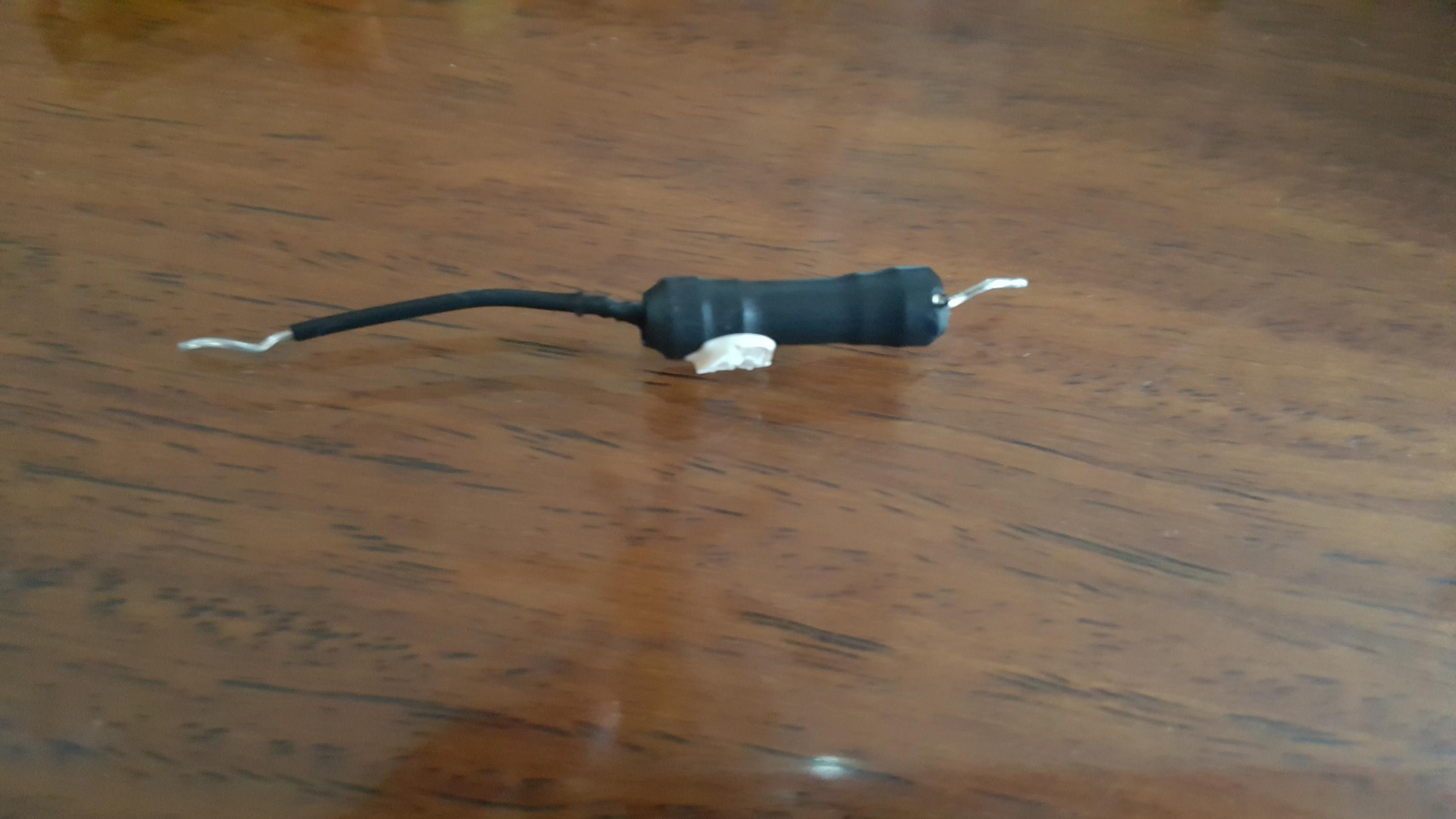

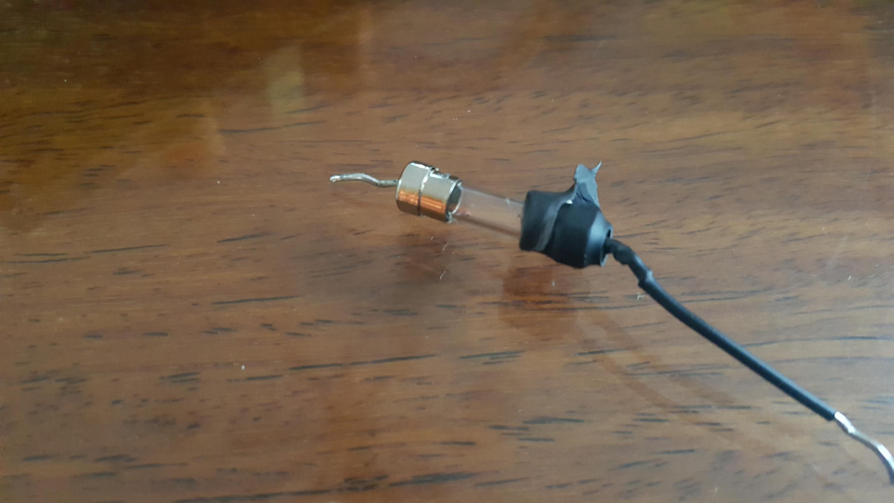

      Re: Varistor for Bestec ATX0300 D5WC
      Update.
      Changed my varistor to 200v
      Found out that there is a fuse covered with black rubber that does not give a reading on the multimeter. That fix my problem. Thanks everyone.

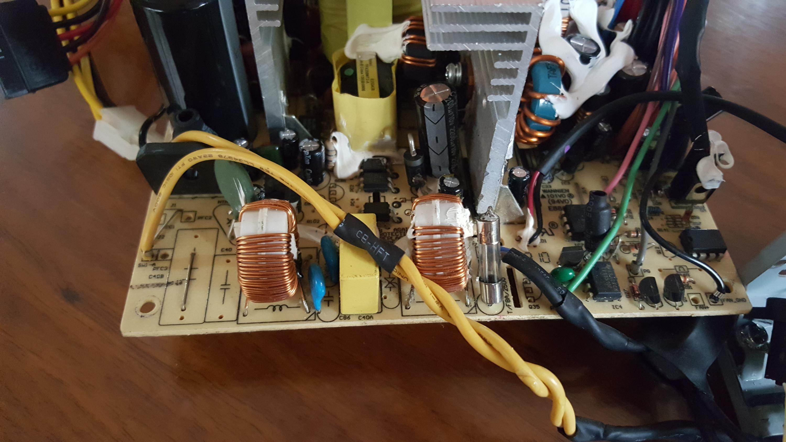

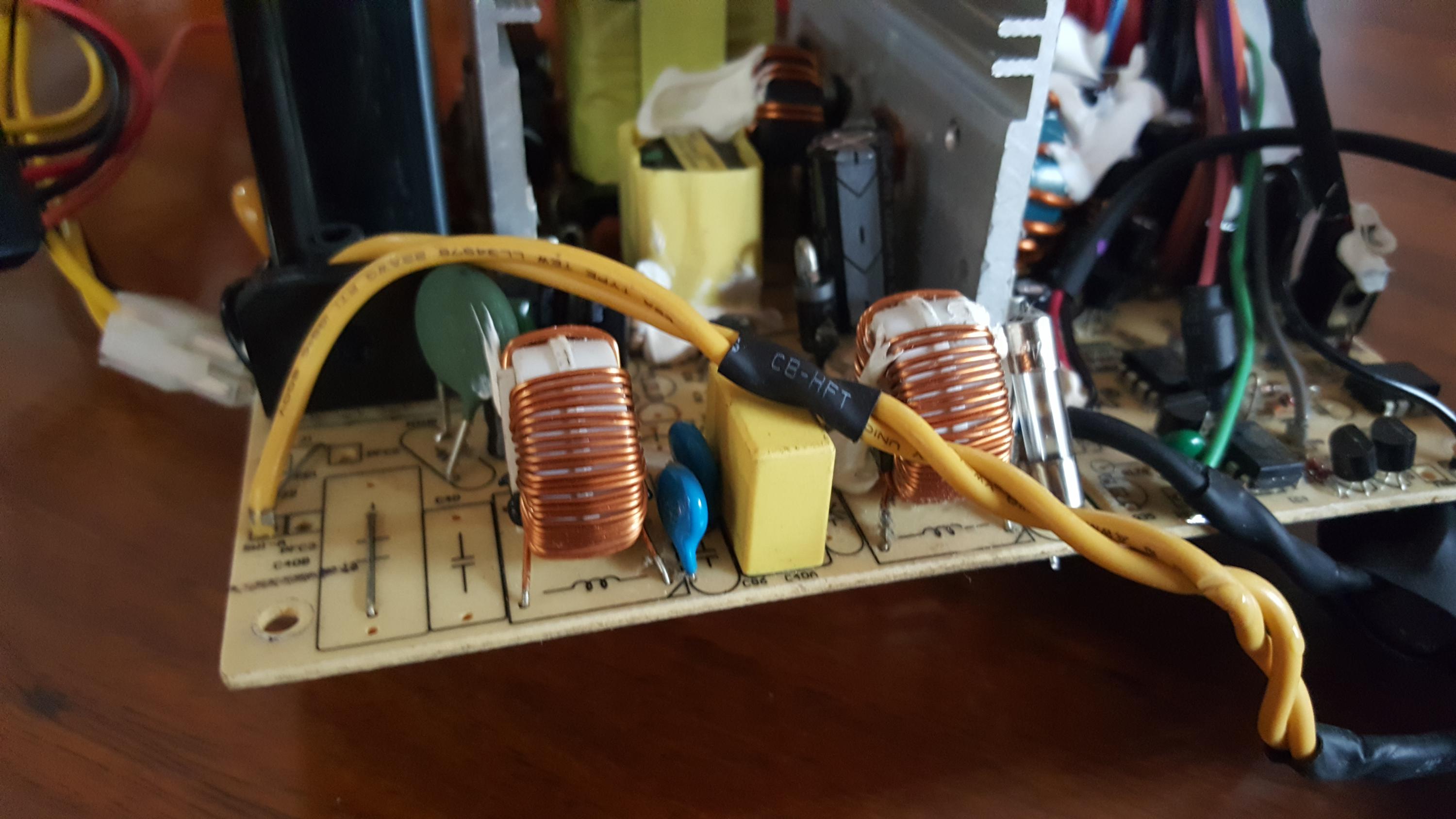

        Other pics
          Originally posted by docchan2000
          Update.
          Nice work.
          Yes, the fuse is covered like that on many Bestec PSUs. Make sure to insulate the new one, too, especially if it is a glass fuse (which looks like it is).
