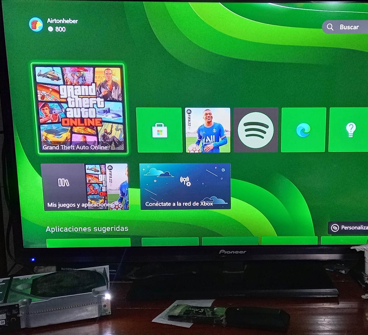

    i need to identify the burned varistor RV001
    line voltage 220Vac
    smps model: 1921
    code on pcb: PA-1181-18M1
    REV:A

      Re: varistor indentify xbox one s
      PSU is working right now but MOV is not connected
      the console died on a stormy night
      i want to put the original MOV, i need the identification code
      thanks for your time
