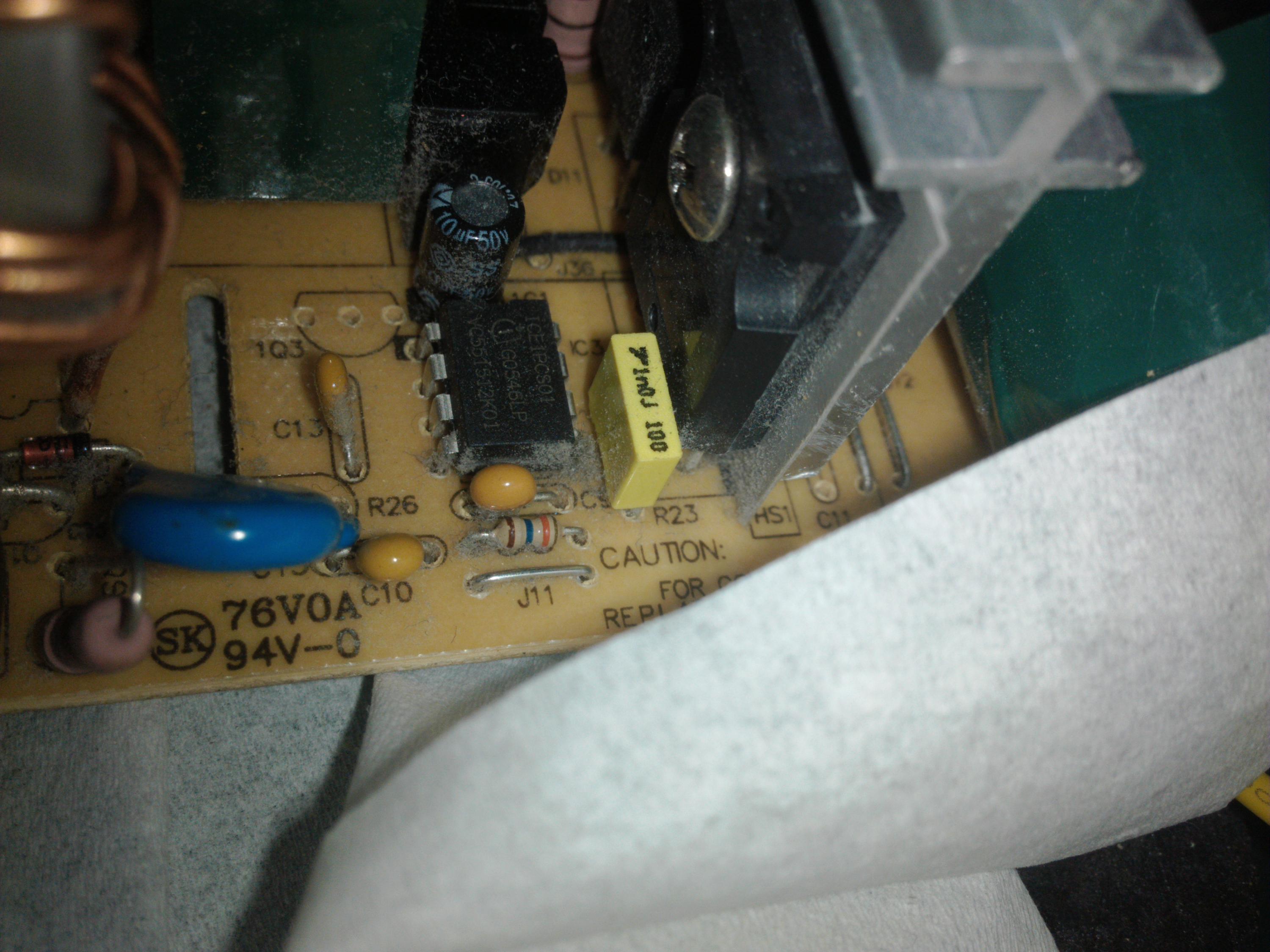

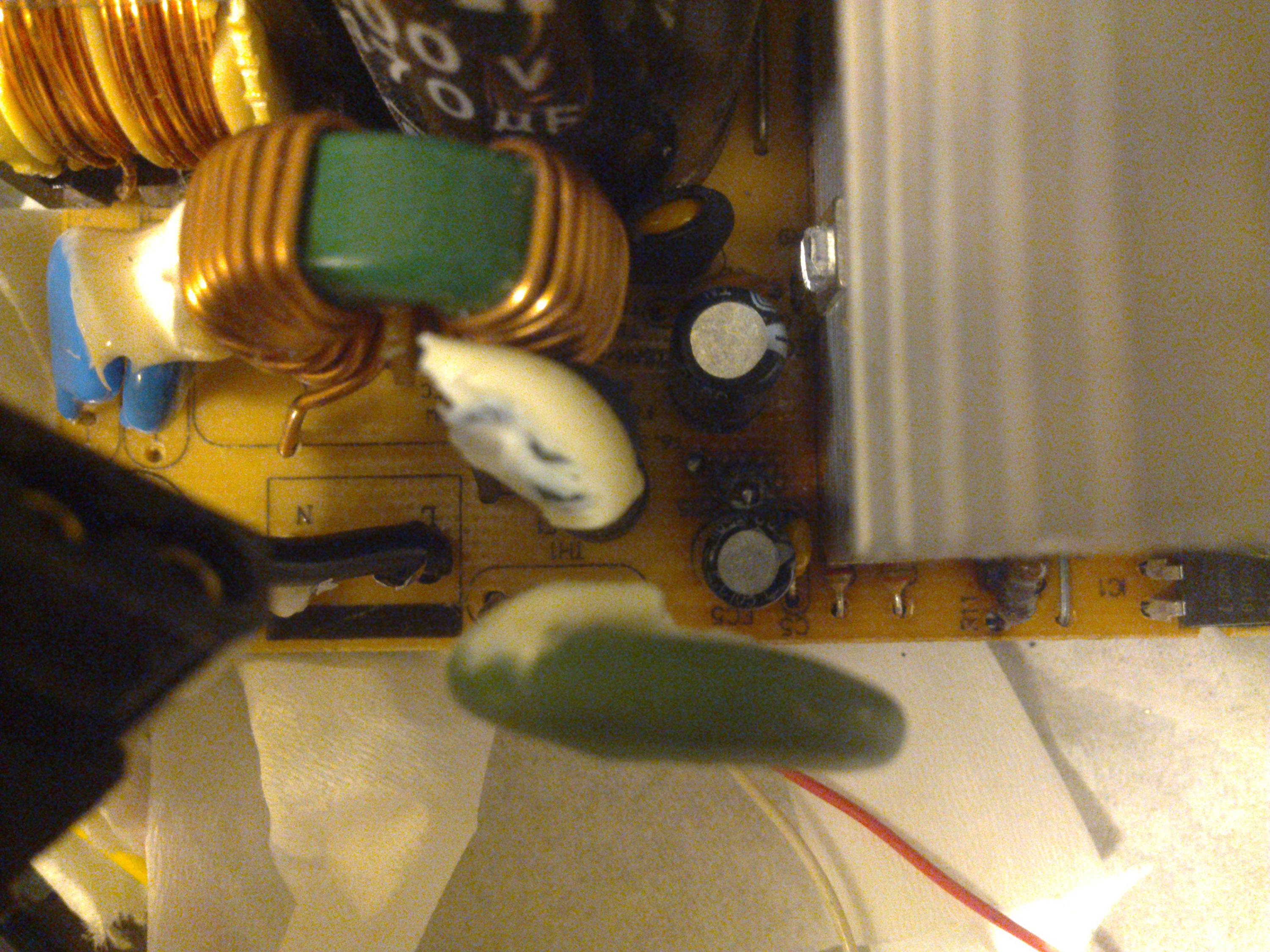

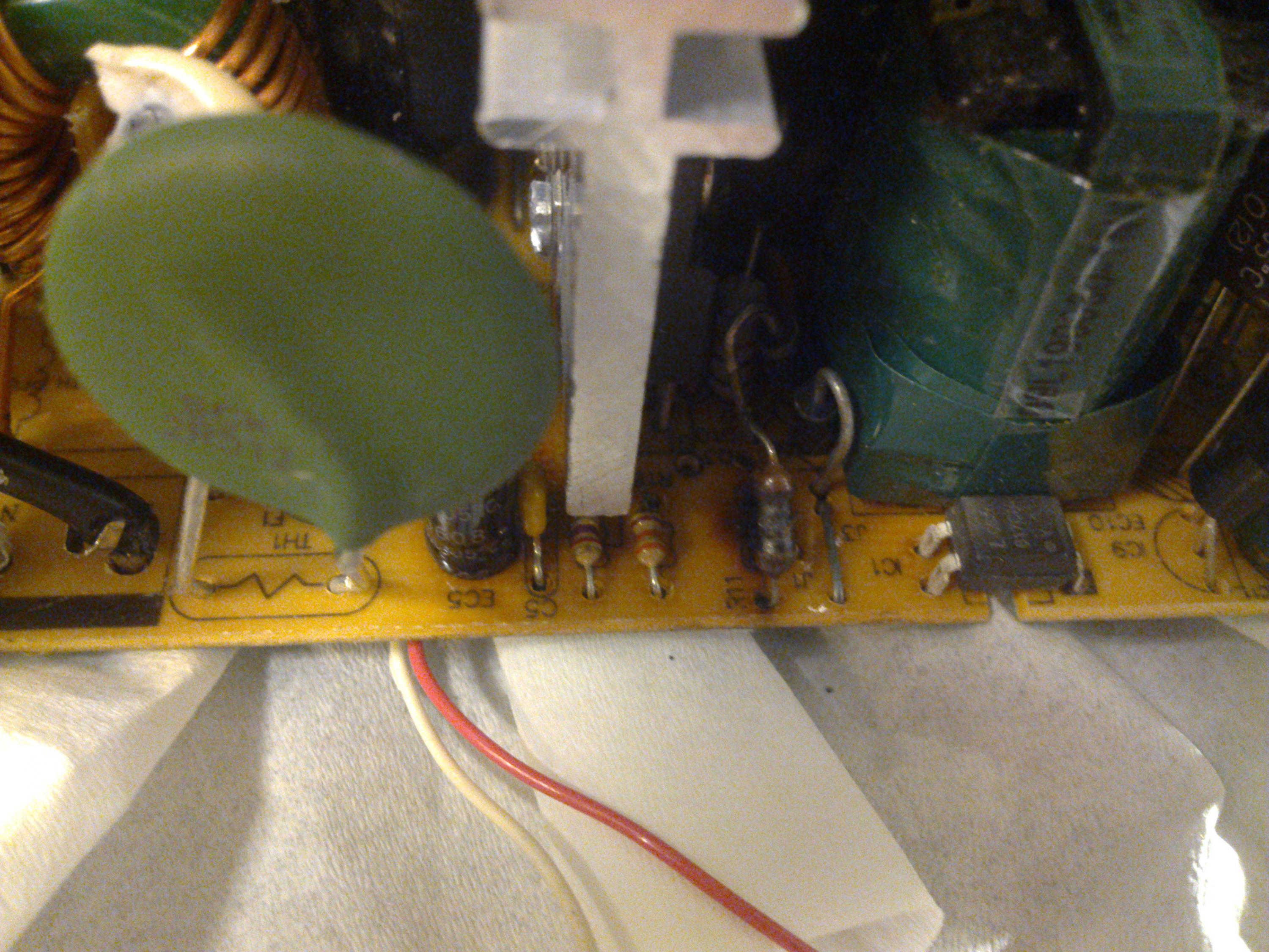

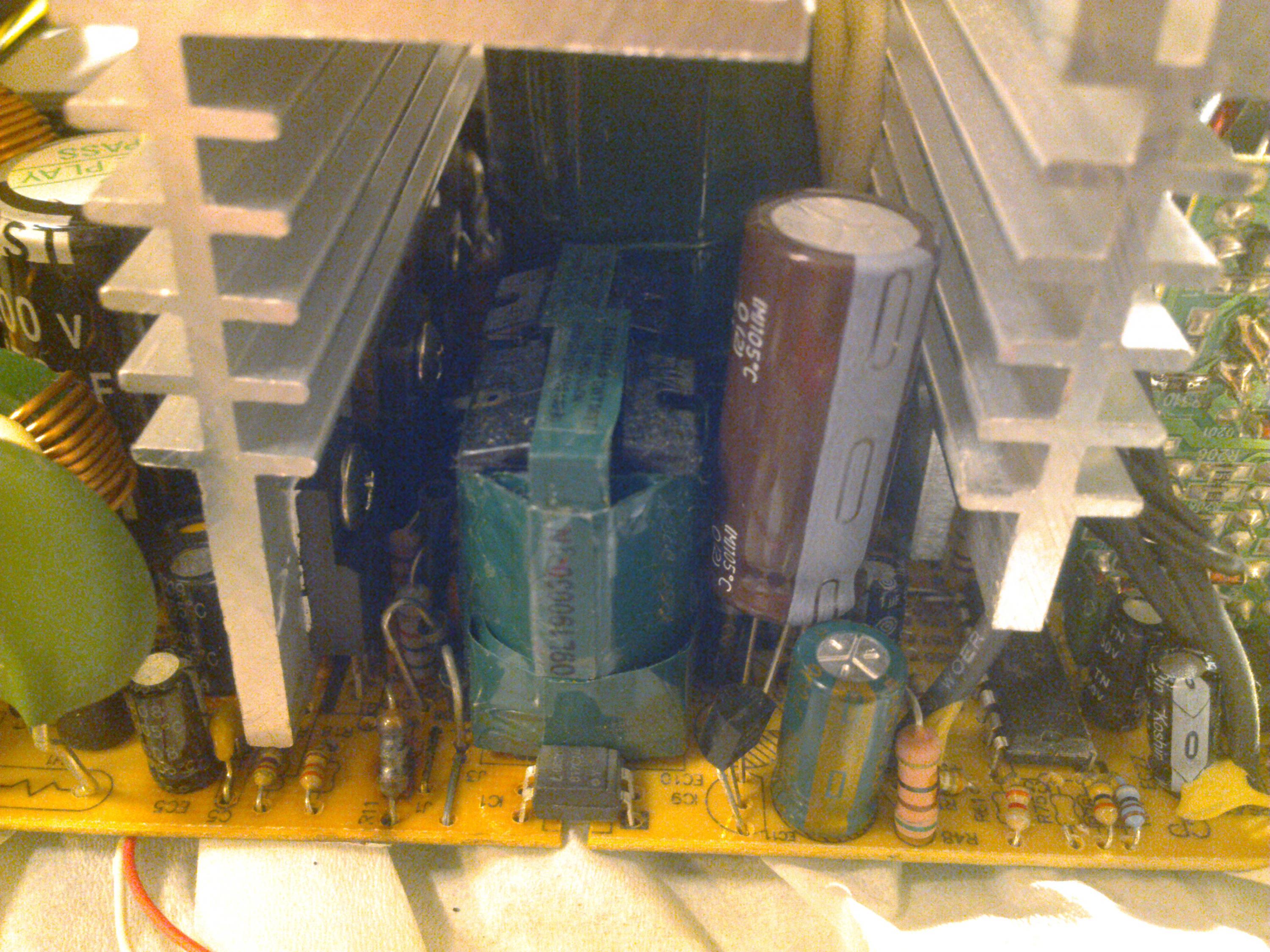

    I got this Antec smartpower 450W (SP-450p), non working power supply, for free from a friend sometime ago. What I found in it, was a bad cap (EC10), which I replaced (picture No.1), a fried resistor (R11) and a shorted 1n4728a zener diode (ZD5). I did some research and I found that the resistor had a value of 5.6 Ohms. I'll post links to the forum threads that I found this information from tomorrow. After replacing the diode and the resistor, I plugged the power supply in and not very surprisingly, the resistor started smoking. I traced the traces and found that the resistor and diode are connected to one another as well as a MOSFET, which is between other components and I can't see its model, but it doesn't appear to be shorted. The resistor also goes to a CCM-PFC (ICE1PCS01) datasheet: https://cdn.badcaps-static.com/pdfs/...a448f3ad78.pdf
    Now to my question. Because I couldn't find any faulty components I desoldered the diode and lifted one of the resistor's legs and the power supply worked! I tested it in a PC running prime95 and furmark and it ran stable for about 30 minutes. Why is this happening? Isn't the CCM-PFC mandatory for the operation of the PSU? Or is it that these components are used for something different entirely? Also, do you have any ideas why the resistor keeps frying if connected? And one last thing, is it OK to use the PSU like this, if it's stable?

    Re: Antec smartpower 450W (SP-450p), working with missing components
    pfc isnt needed to be running on 230v systems.
    look at the schematic of any pfc datasheet.
    it's a parallel circuit.
    btw, i had a smart-power with bad pfc, the fet was shorted and the coil was cooked!!
    they really are crap psu's

                      The voltage would most likely bee too low for the switchers to keep secondary voltage. But with 230 V after rectification the voltage is close enough to the original boosted voltage.

                        Measure the voltage on the bulk capacitor, with 230VAC feeding you will have: √2*230=325VDC
                        So if the voltage you measure is higher then the PFC stage is active.
                        The energy storage of a capacitor is related to the voltage.
                        So if you feed the single bulk capacitor with just √2*115=163VDC
                        That will not provide sufficient hold up time.
                        Remember that a SMPS can only charge the bulk capacitor when the incoming line voltage is above the voltage of the capacitor!
