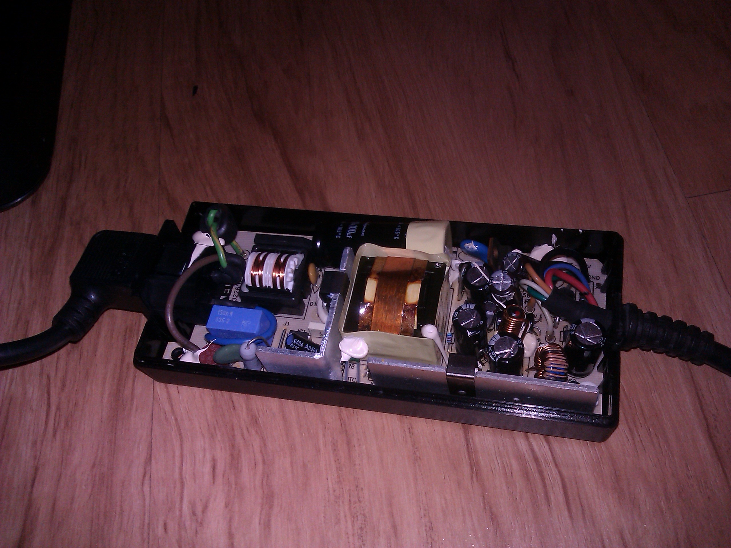

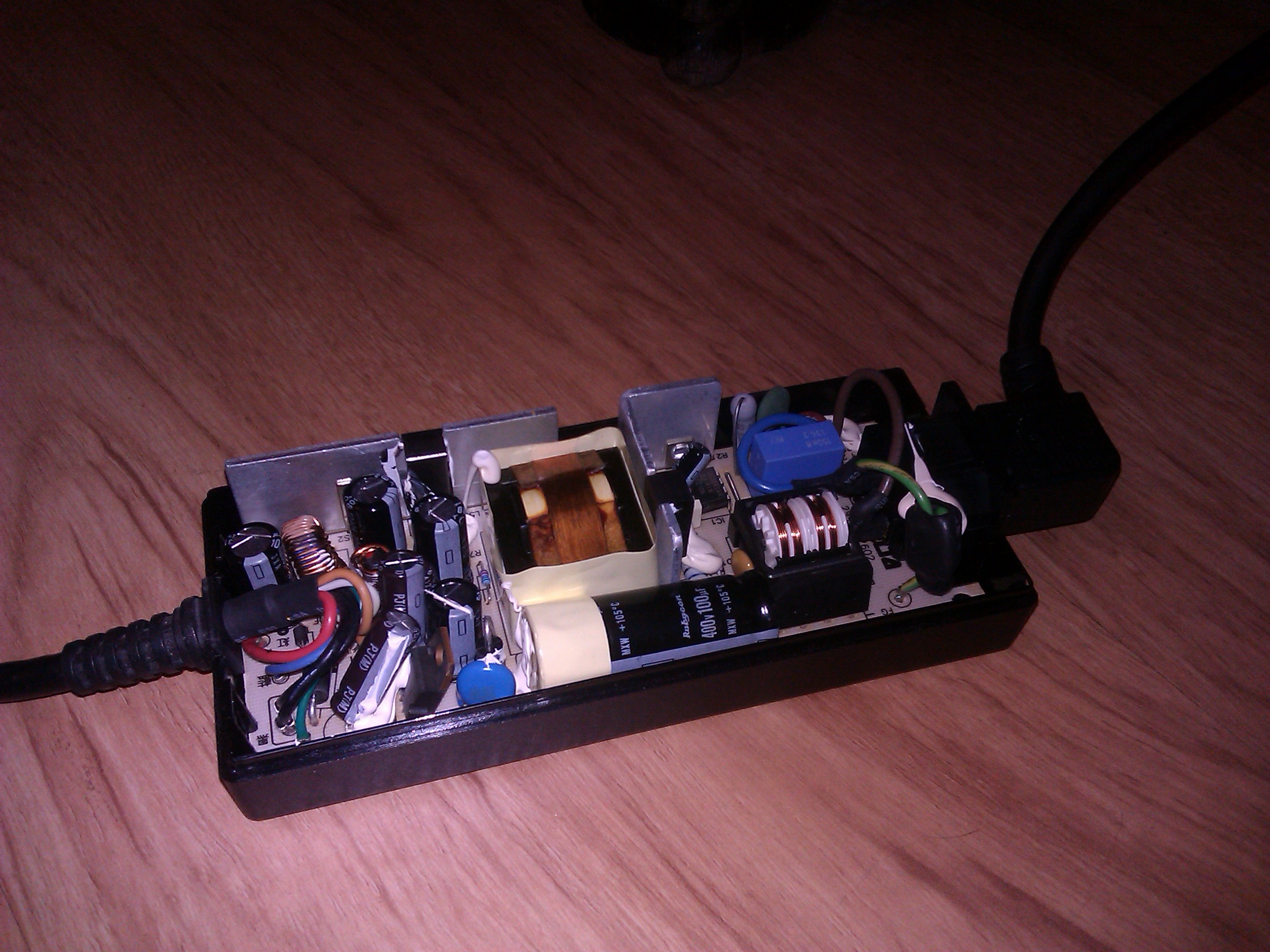

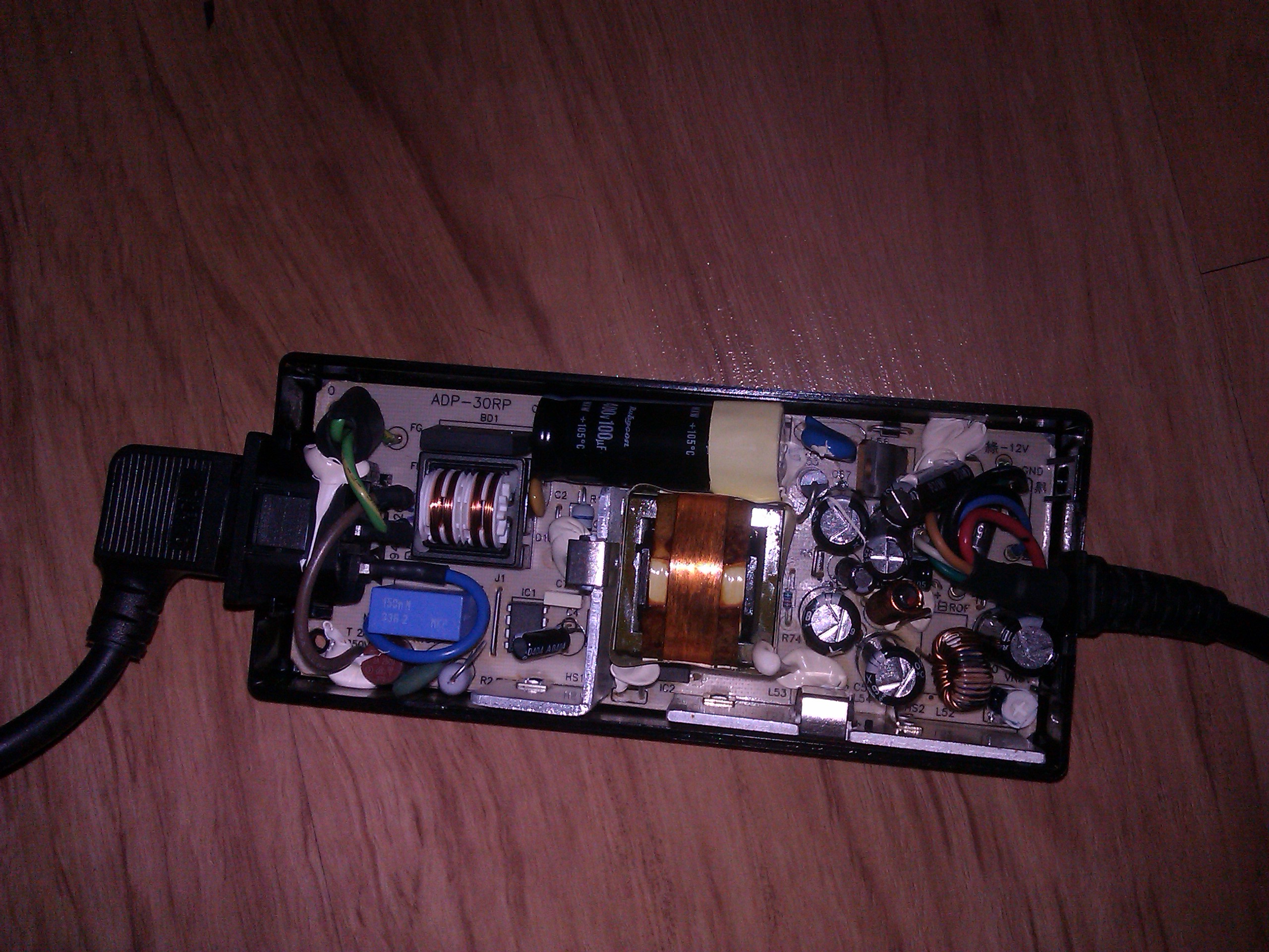

    Hey there !
    Been a while since I visited this lovely site ! Hope everything's alright, saw some red notification up there, hope the admin & badcaps store ain't in no trouble !!!
    So I wanted to start my cisco trainings and stuff, hooked up my FW mentioned above to the PSU, worked one day. Did the same thing the next day, nothing. Dead. Tried the spare one - worked.
    Disassembled, investigated. The PSU looks OK, no burnt spots or parts. Providing the picture. There is one indication of a failure, fortunately. The place with caps and the regulator is ''ticking'' (not like a bomb ), producing the sound twice per second. I think it is the regulator, but that's why I'm writing in here - to ask you guys if I'm right. Providing pictures.
    Appreciate the help in advance !

    ticking is either a shorted output, or a bad startup capacitor.
    change the small cap c4 next to the control chip
    and check the diodes on the other side of the transformer

      The diodes show 470 and 778 values on the diode test. The regulators (the ones attached to the heatsink) show values between 400 - 650 when you measure the leads, but one of them shows 600 on one leg and beeps (short) on the other leg - which to me (since I'm an total amateur) is not a good sound. But I believe that removing the parts and measuring them outside the circuit is more reliable, thus will remove them and measure.
      Should I continue replacing the C4 cap if this has been discovered?

        it will last longer if you do, even f it's not the problem.
        make sure you use a low impedence one like a panasonic FC/M/R or a rubycon ZL for example

                                  Replacing the mentioned capacitor did no help. I've acquired all the other capacitors as well, I'll try to replace them all.
