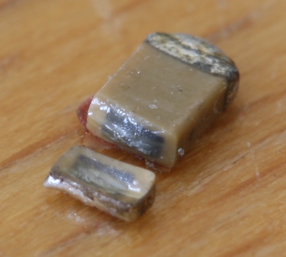

                        The Corsair CX400 lives again!
                        I did a cursory Google search and found this post on eevblog:
                        https://www.eevblog.com/forum/repair...uld-i-do-next/
                        In it user JeanF describes how he found that ceramic capacitor C107 had gone open circuit, well the exact same fault exists in mine, it has actually cracked!
                        I mentioned how mine did not work with a 5VSB transformer from another unit:
                        I found a transformer with at least the same dimensions and similar naming: VEE19FRC3
                        On my meter I got the exact same readings as the original transformer.
                        The pinout was different though but I hacked it together by installing the transformer upside down and just used long wires for it :P
                        Seems the auxiliary winding does not come online though, the voltage is oscillating from around 8v up to 12v.
                        That's the limit where the chip is supposed to switch from charging the external capacitor using it's internal Vstr pin to where the transformers aux winding should take over.
                        So either I got the cables reversed or this transformer is too different to be usable.
                        Actually my hunch was spot-on:
                        I did have the polarity of the cables reversed, I had to switch polarity of the AUX and 5v output winding and then it works!
                        (I guess I could also have just switched polarity of the mains input side and it would have had the same effect).
                        I found a transformer on Mouser that would have been a nice fit, I thought I ordered it but by mistake I had replaced it with another one in my shopping cart so I guess it will just have to live with this upside down transformer
                        I have tested it up to the rated 2.5A which is actually overloading that transformer a bit (it's rated at 2 amps) but it works fine!

                          Re: Corsair CX400W 5vsb goes into safety loop
                          interesting, never seen a ceramic cap open before.
                          i didnt know they had a "core", i thought they were layered.
                          • redwire
                            • Dec 2010
                            • 3912
                            #33
                            It looks like a MLCC terminal thermal crack but it includes the electrodes as well. Seems to be from a bad soldering process?
                            Gideon MLCC Failure Analysis also see SEM Lab Capacitor Failure Analysis
                              The layers are so thin and close together that they aren't very visible in a picture like that. I've seen the small value high voltage caps cracked open (huge case sizes like 4040 just for the creepage distance), and those do have clearly visible layers.
                              • PeteS in CA
                                • Aug 2005
                                • 3583
                                • USA, Unsure of Planet
                                #35
                                The outer surface of an MLCC is a protective insulator.
                                Non-polymer-termination MLCCs don't like PCB flexure, the larger sizes (>0805) especially.
                                  Yes exactly, I tried my best but even with my EOS 40D DSLR and the Canon 100mm F2.8 Macro lens this is the best I could do, it is after all a tiiiiny SMD part
                                  Thank you for those links, yet another thing to keep in mind when repairing electronics!
